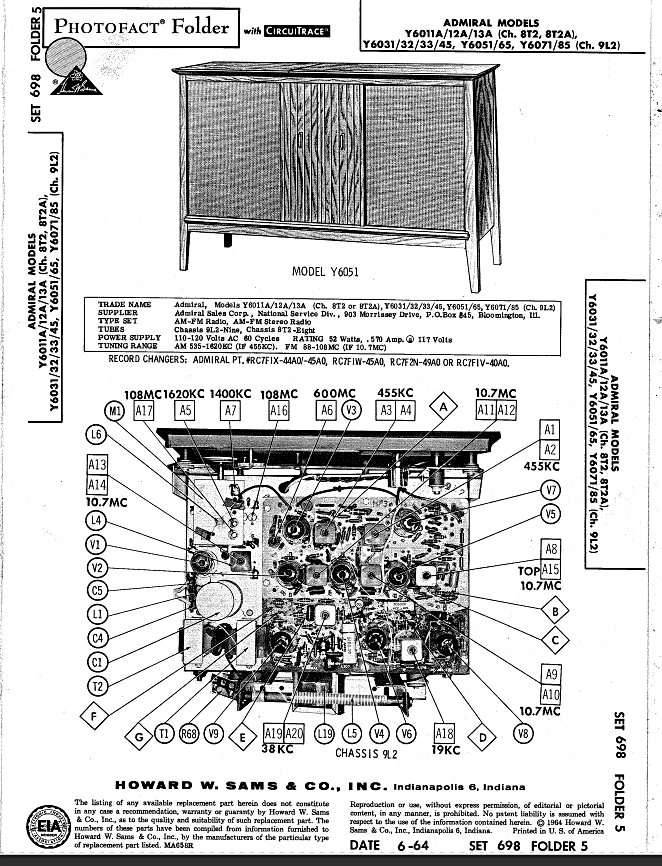

Greg is correct on all counts re: value.
I'm not 100% sure if that is a V-M record changer.
It might be one of their cheaper versions.
The Sams photofact says there is an Admiral-made
changer there.
Here is the Sams photofact electronics
service file face page published in 1964.
changer there.

Now that I look at that again, I think you are right. I don't see another knob that should be there for a VM changer. Old age, I reckon. Good eyes, Mr. Mogul.......
The one I worked on had a VM changer. Maybe it wasn't original? Or maybe they used different changers for different years/models? That looks like what I remember of the chassis. I remember it being a middling performer, nothing that great.

Thanks for all the input from everyone. Is this the right document to identify/troubleshoot what may be going on with the speaker that is inoperable.
Is this the correct document to troubleshoot the issue with the speaker?
https://www.dropbox.com/scl/fi/pt9iqcsr ... r8kzm&dl=0
Thanks.
Thanks.
- Posts: 5419
Re: Admiral Y6071
Yes, it is, and for you to have an original factory schematic is amazing. Where on earth did you get it? Since you have the schematic, I assume you will be working on this yourself? Will this be your first time working on vintage electronics? If so, feel free to ask as many questions as you need, and we will do our best to walk you through it.
