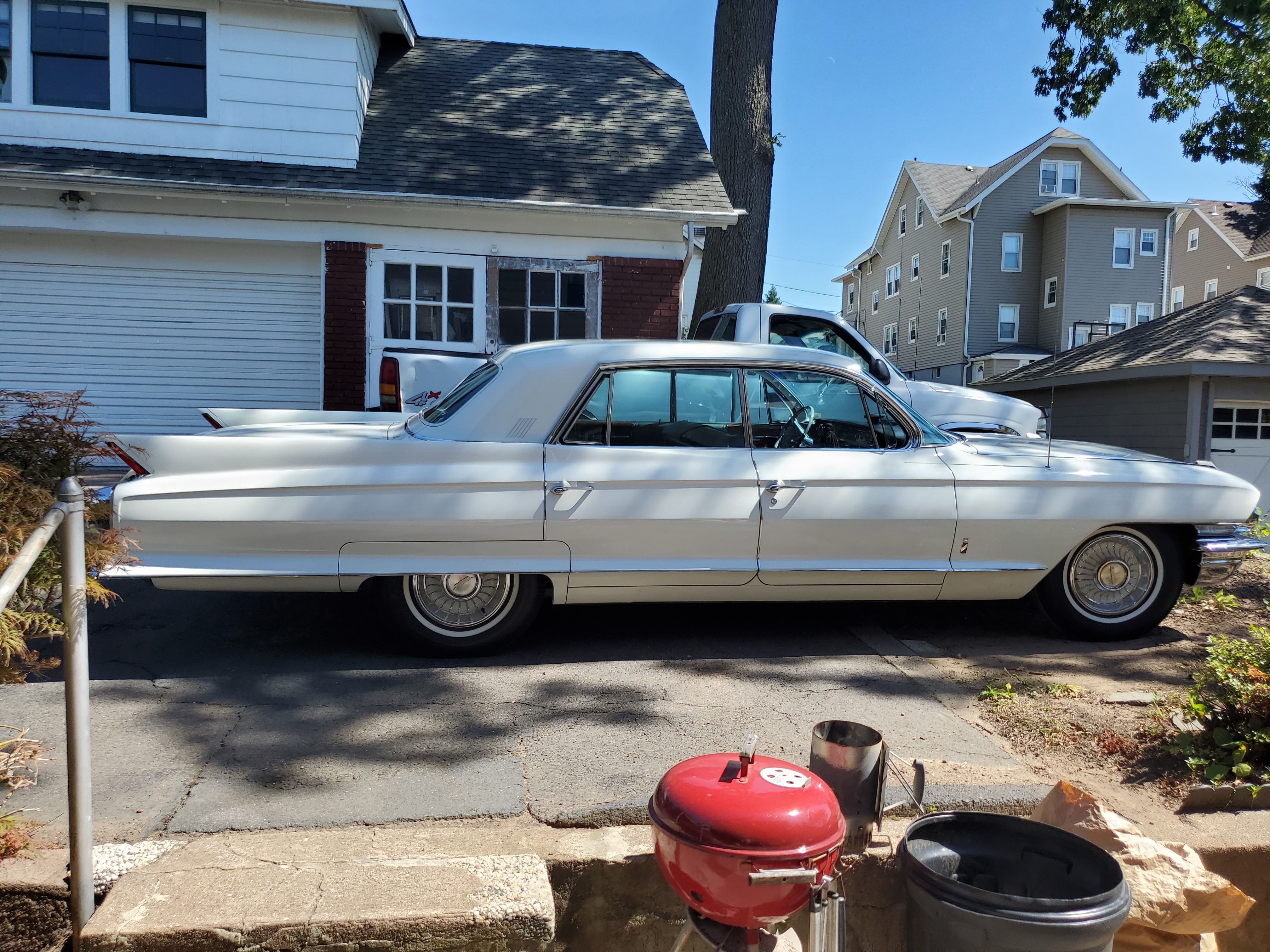

Took 4 years but I FINALLY got the '62 Fleetwood out for a good ride. 120 miles with cruise and air from Scranton to Jersey.... and anyone complaining about bias tires needs and alignment.

Wow, makes the pickup truck look tiny....
Re: Maiden voyage
Overall, it's the same size as a 77 to 92 GM C bodied car. The wheelbase is longer because they cut back on the front overhang.
Seriously, it's quick, powerful, lithe and, if you're used to driving a late 70s boxy GM car, this is a breeze.
One noticeable thing is, despite rather tiny mirrors, there is honestly no blind spot on this car even without a passenger mirror.
