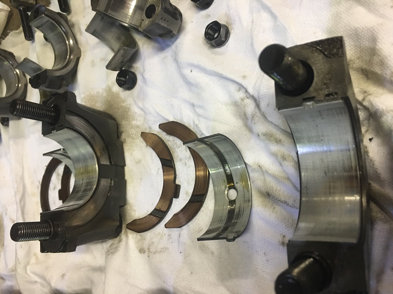

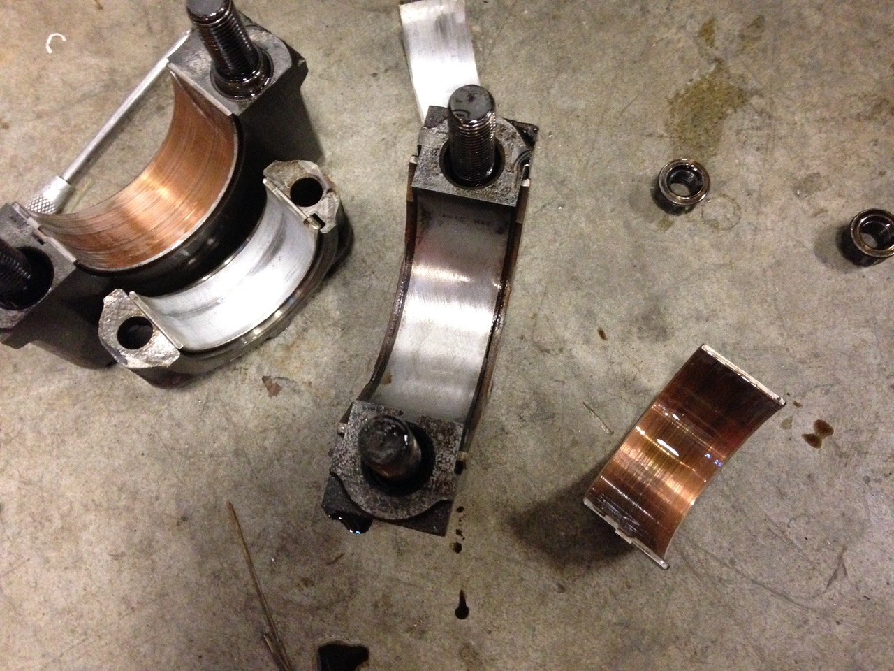

Hello Guys, Ok I will throw in my 2 cents worth of opinion but back it up with 3 cents worth of photos.
Around 2014 a bunch of my gearhead friends decided to go Lemons/chumpcar racing with a old Mini Cooper 1973 I think. Anyways we started off with a fairly mild engine but it still would hit 102 mph at the end of the straight we do approximately 500 to 700 miles in a race weekend. The first 5 or 6 races we used castrol 20-50. This is what the bearings looked like every 2 race weekends One of the guys is a engineer and he suggested/specified that we run mobil one 15/50 the engine showed no signs of dropping oil pressure so we kept running it until after 5 race weekends I finally couldn't stand not knowing if it would make it through the races. So I dismantled it. This is what I saw We have run about 20 races since then. I used to do the added zinc in castrol to break in the engines . But now I dont even bother I rebuild (Rings/bearings) the engine put in the mobil one it goes straight on the track.This engine is probably 10-20 percent stronger than the original engines also. Nowadays I put mobil one in everything I have. It leaks out of the seals more but thats the only down side. Hydro

Re: Repair Time
Wow, that's encouraging. I've been using Mobil 1 for about 25 years, mostly on the strength of general reputation (and also because it lets me extend the change interval, meaning I'm not lying under the truck in February). It's nice to have some visual affirmation of its effectiveness in severe service.

Re: Repair Time
That is impressive, Hydro. My 2020 SUV's owners manual has one using a synthetic blend. I might change to all synthetic just because of what your photos show.

Re: Repair Time

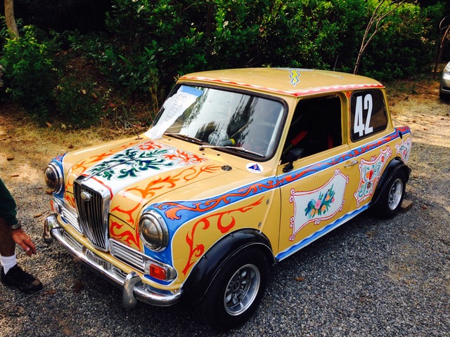

Hello again, Just a little more explanation is needed to clarify couple of things. First this is a three main bearing engine I know weird, a four cylinder should always have five... but a lot of British engines do this. Second you can see the rod bearings in both engines and they all look good so its not a heat or oil breakdown issue as the rod bearings look good even with lower pressure. it purely is a surface film loading issue where because there is only three main bearings taking all the load. The mineral/conventional oil just can't support the load but the synthetic can. Third I was being a bit vague but I actually use two engine's both fairly identical. Instead of doing repairs at the track we will swap out the entire engine/transmission assembly. I bring it complete in the back of the truck and we can swap the whole thing in less than an hour. except head gaskets we will replace a head gasket without swapping the engine. Thing is I dont keep track of which engine is in there. But they seem to do about the same hours with the same results. The two photos above are the same engine though since only one of the engines has the center tang bearings. Last race was at Laguna Seca in jan 2020 just before Covid so haven't run in 2 years now. During Covid I have replaced the entire gearset in both transmissions of both engines. Running well over 5000 race miles the last few races we were getting strange gear breakages that I could only attribute to metal fatigue. This year also we are upgrading to aluminum heads. not for power or anything but the old cast iron (no seats) heads were costing a ton to continually freshen up. so I am going to see if the hardened seats in the aluminum heads will last longer . Here is a photo of the mini
- smaller 42.jpeg (161.8 KiB) Viewed 2111 times

Looks like a fun car and project!
