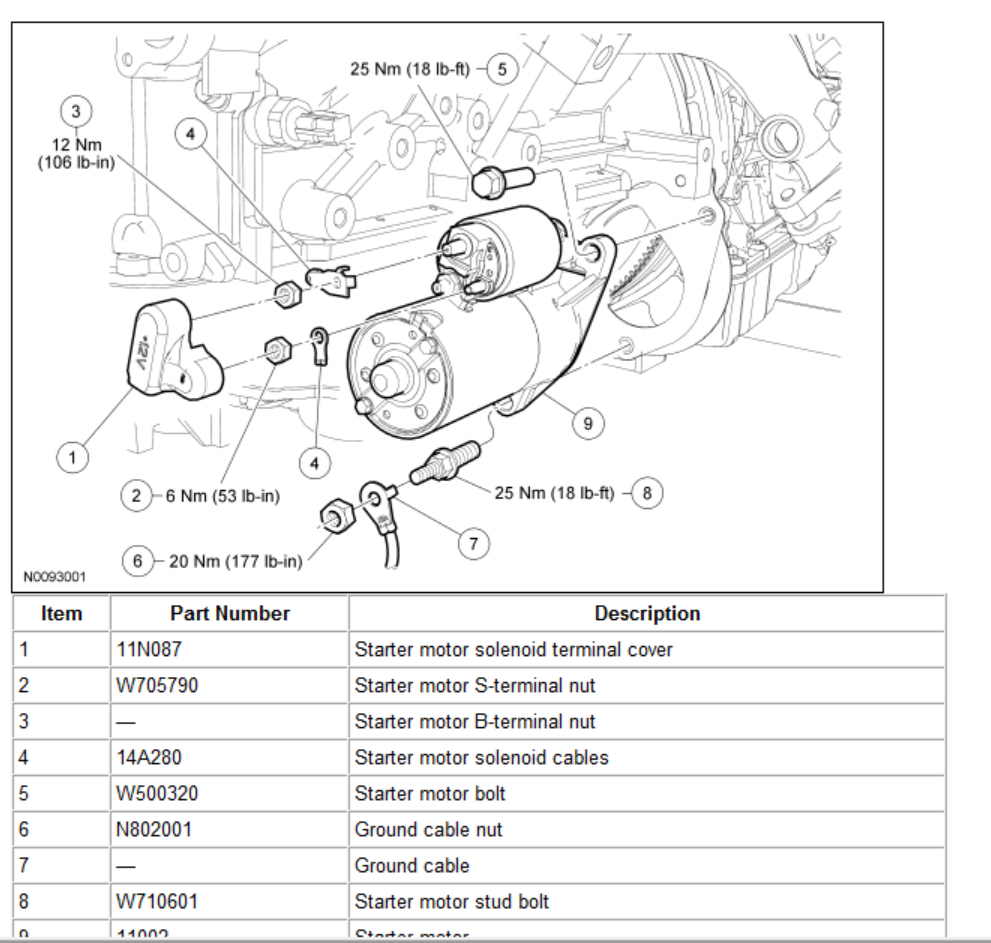

The starter in the explorer is starting to become balky at engaging the flywheel. I've ordered another on Amazon. They beat Rock Auto's price. $59. RA had the same unit for $88. I checked the reviews on the product and the majority are favorable. Now if there is some decent weather this weekend, I'll try doing the exchange.

What engine in is the Explorer? What major components, if any, need to come out to change the starter?

4.0 V6, It looks like it should be at least somewhat exposed.

You probably heard of the mustang from me. No more o' that crap. Here is the layout for the explorer.

It looks like your starter might actually be replaceable fairly easily. I see Ford ran the ground battery cable directly to the starter mounting bolts on that model. THAT was a great idea.

I got a good start on it yesterday. The fasteners were on so tight, when I was able to get one loose, it let loose a snap like I hit the motor with a hammer. I could not budge any other fasteners on it and when my hands began to cramp badly, I put the fastener back on and went on to change the oil. I had mentioned it to my sister and this morning my great nephew called to offer to help on it. He is an excellent mechanic. He has a later model BMW apiece for his wife and he, having bought them as basket cases from their frustrated owners. He had it changed out in short order. Man, am I feeling old this evening. He has also offered to help me with changing out the struts all around, so I feel a bit lucky too.
