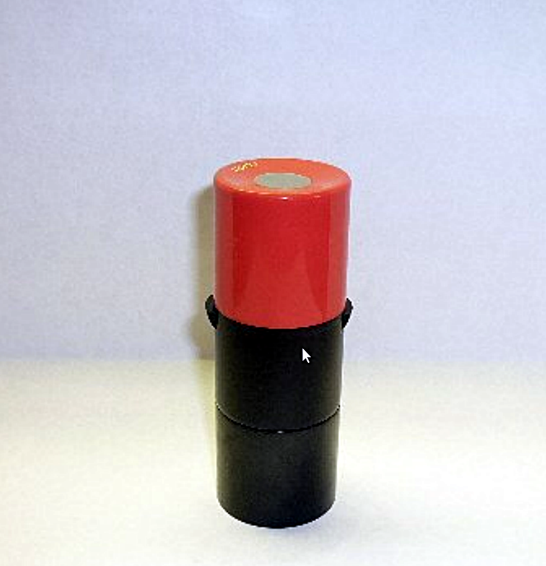

I have 2 of these that each had one side of the
separator knives and record support shelves collapsed.
I was curious about what would fix that.
Upon dis-assembly, I found that each adapter had been
broken inside the centerpost body assembly.
This appears to be due to someone forcing the adapter
onto the record spindle in the wrong mounting direction.
I'm disappointed, but now I can pass along that if you
have one of these adapters as described above,
there is no repair fix for it.
V-M 45 adapters are similar, but much more metal
used in their construction.

The part that is damaged is the centerpost body
as I wrote.
If both sets of knives and shelves are sticking out
from the 45 adapter, then most likely the
centerpost body is OK.
I did not know how to better describe the broken adapters
than that the knives and shelves on one side
had collapsed into their opening.
This photo from the V of Music shows the shelves in
proper position in a good adapter.
