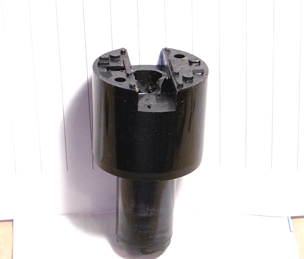

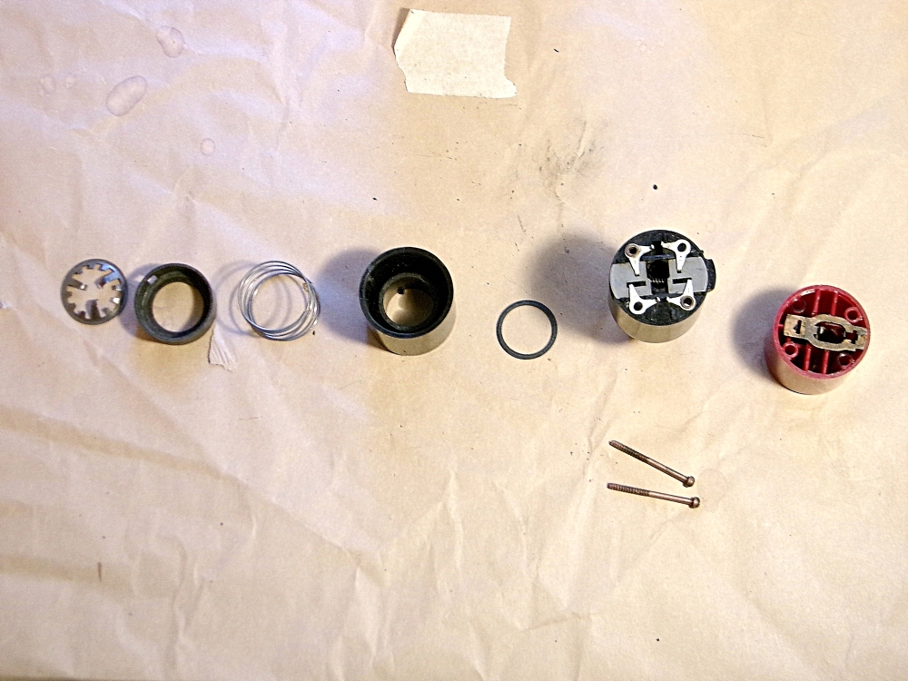

I have 2 of these that each had one side of the
separator knives and record support shelves collapsed.
I was curious about what would fix that.
Upon dis-assembly, I found that each adapter had been
broken inside the centerpost body assembly.
This appears to be due to someone forcing the adapter
onto the record spindle in the wrong mounting direction.
I'm disappointed, but now I can pass along that if you
have one of these adapters as described above,
there is no repair fix for it.
V-M 45 adapters are similar, but much more metal
used in their construction.
