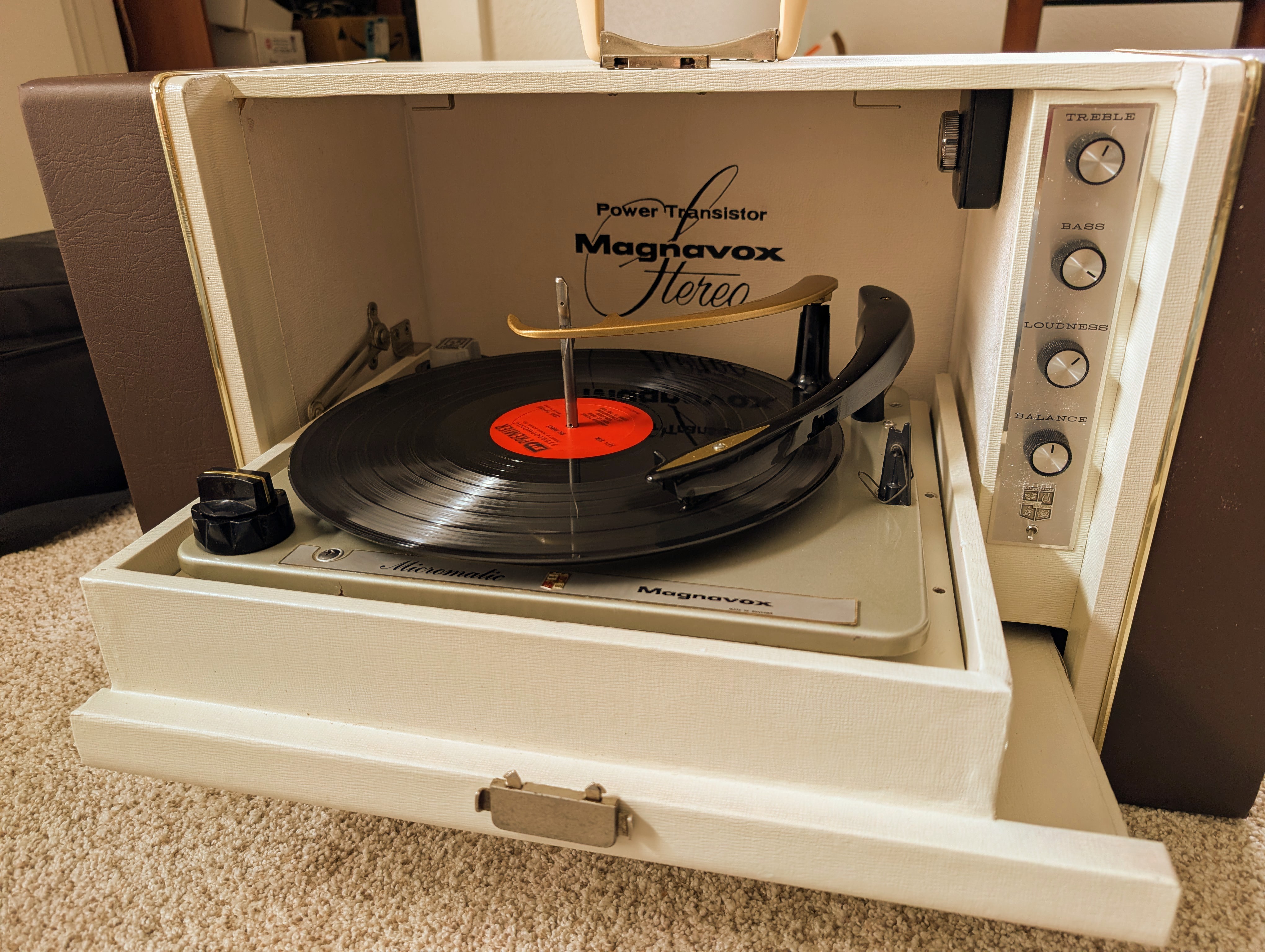

Replaced the cartridge in the changer with the Pfanstiehl P-226D in Gary's kit, managed to get all the tiny fiddley pins soldered, had to widen the slots in the provided plastic mount, plus the little screws were longer than in the pictures of the instructions provided, but after all that it sounds good and tracks properly. So the original EV cart was indeed defective, I think the compliance was just shot, even though electrically it was OK. Set tracking at about 4 grams, a little higher than I wanted, but seems that what it needs. Changer detects sizes and drops records correctly, after adjusting the spindle pusher. The service manual has been very helpful!.

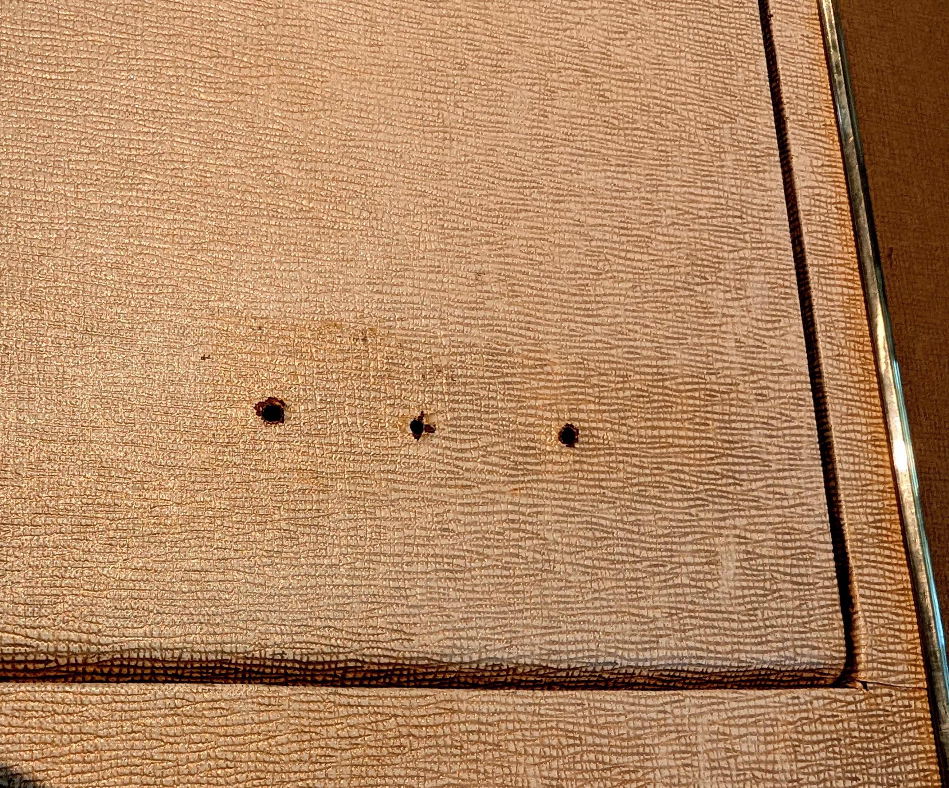

The unit is missing it's Magnavox emblem, I think it may have looked like this (screenshot photo from a different model).
The holes in my unit look like this, the two holes on the left are 1" apart, the third one is 1 1/8" from the middle one.
I saw some joker on eBay offering two for $250.00, and they're plastic! :shock:
Anybody have any suggestions on where to find one?

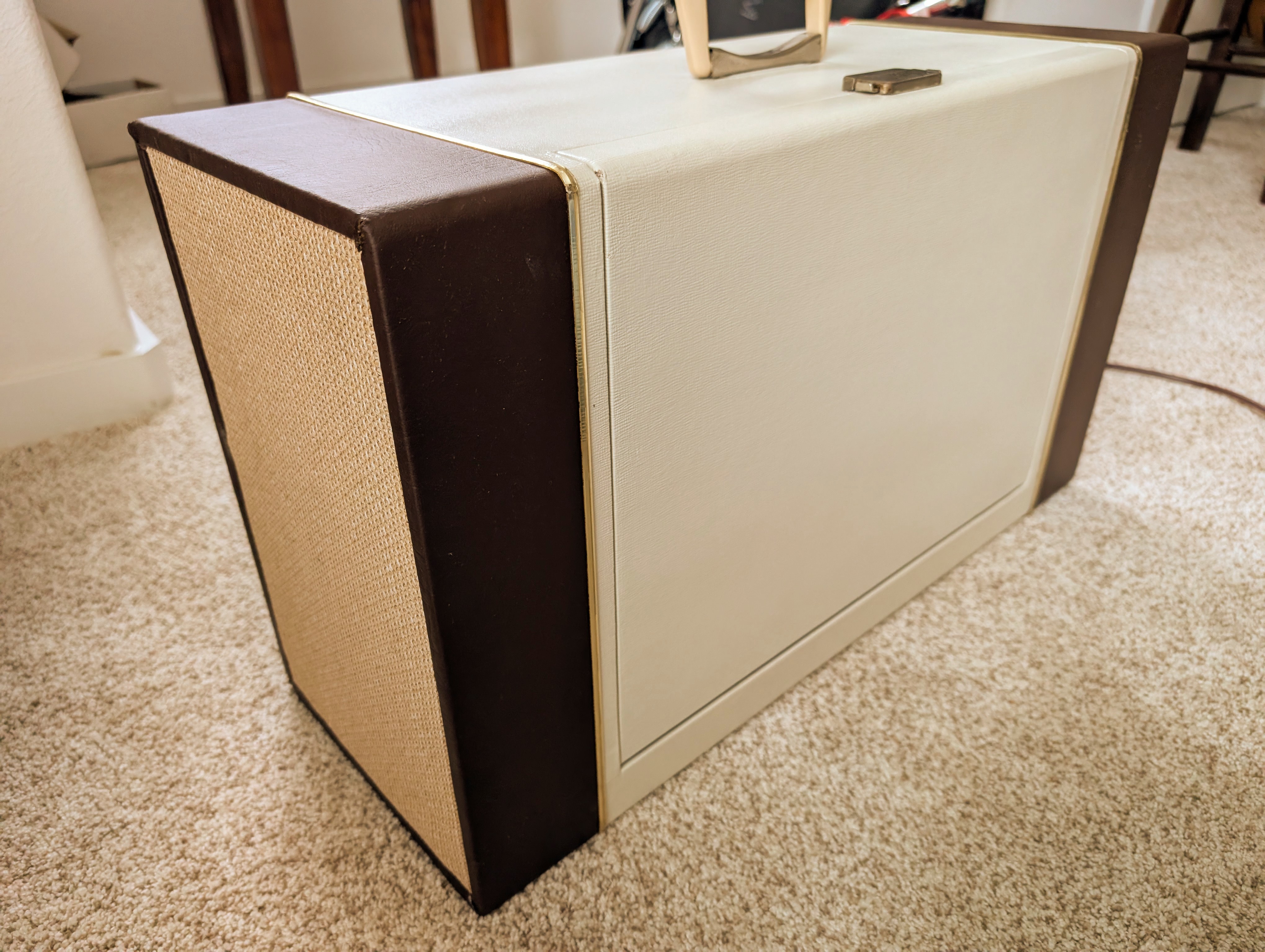

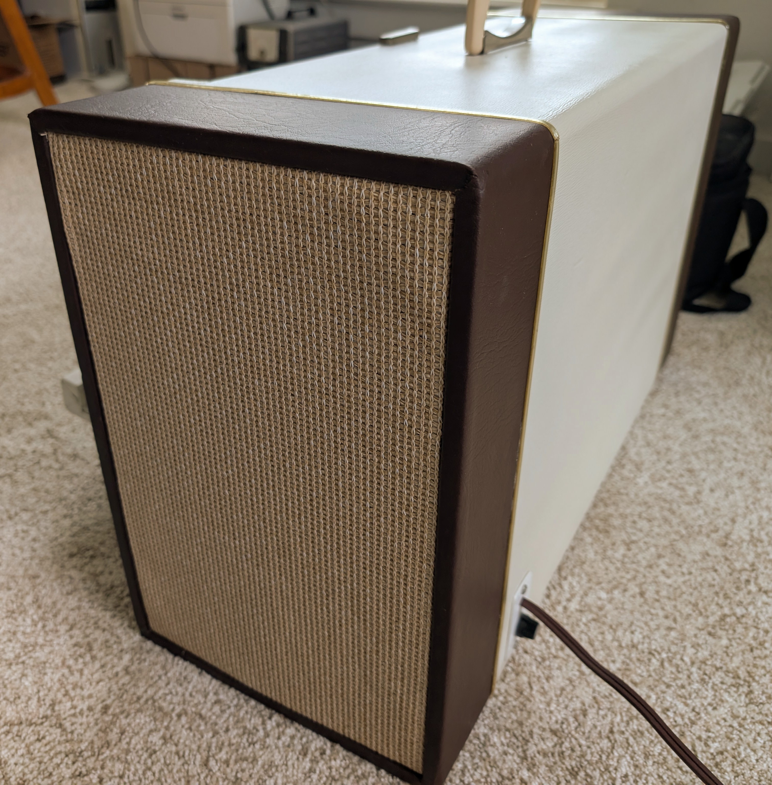

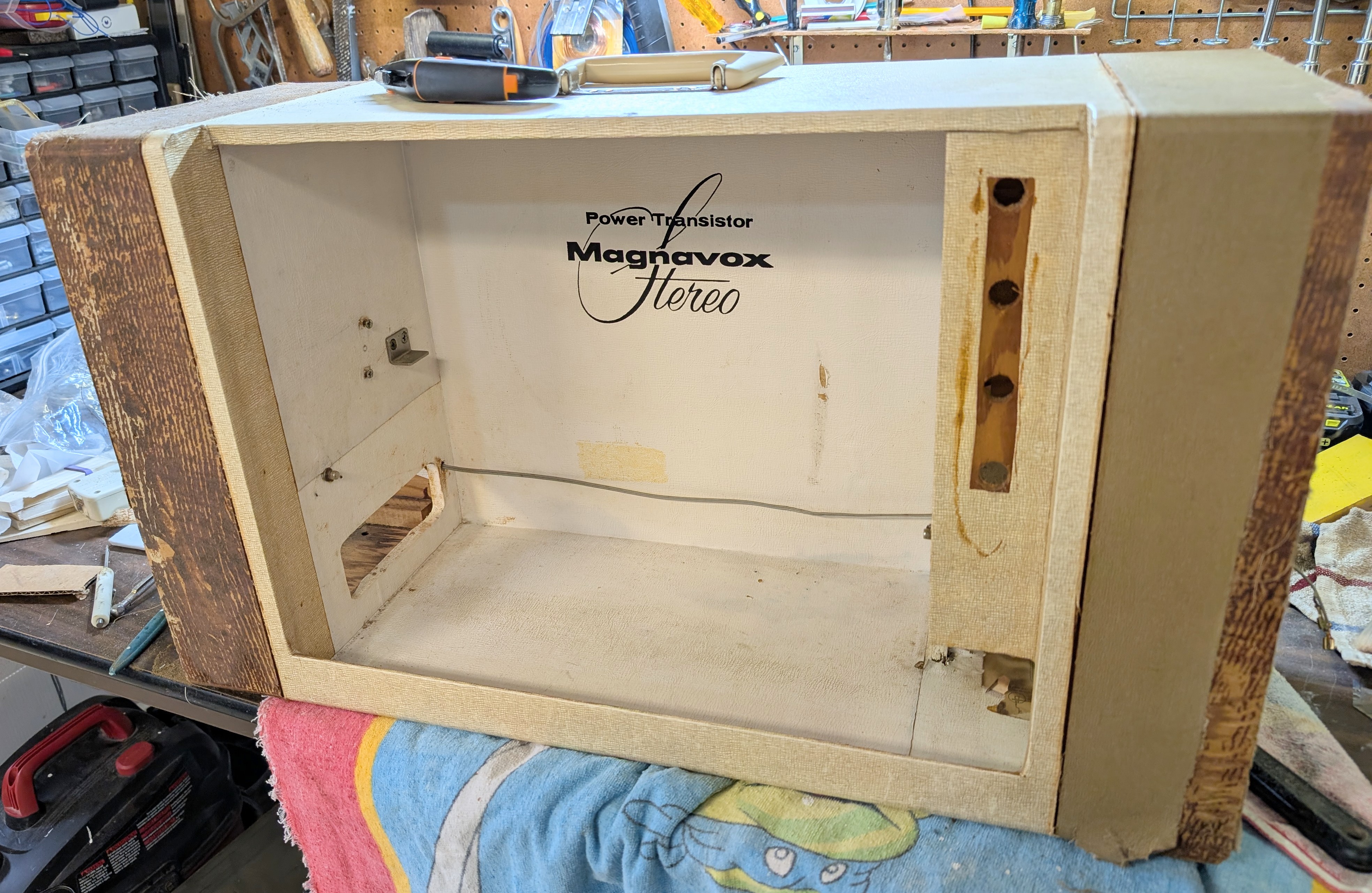

Now to the cabinet--boy this thing is heavy! All plywood/Tolex. I stripped off the roached (water damaged) brown Tolex on the end pieces and gently pried out the gold plastic trim that separated the two colors.
Left side Tolex & both gold trim strips removed
Scrubbed the heck out of the rest of the tan Tolex, but nothing would remove the grime that was embedded in the crevasses of the pattern. So, maybe it's heresy, but I ended up spray painting the tan Tolex with some Ace satin enamel in ivory color, after patching some of the damage and little dents. For the end caps, I picked up some brown Deco Vinyl Fabric from Hobby Lobby (on sale, less than $3 worth!), glued with contact cement. The original grille cloth was also totally unsalvageable. But I had a lot of "Sahara" colored fabric from an old Coolaroo "shade sail" and it works great as a grille cloth, actually pretty acoustically transparent!
The latch that secured the fold down door had one broken leaf spring inside, but after some internal mods, I was able to make it work with a compression spring from a ball point pen. Cleaned the rust off the hardware, looks a lot better! The inside of the changer compartment is white Tolex, I cleaned it up and was able to touch up the ripped area with some white glue, plus white-out mixed with the ivory enamel.

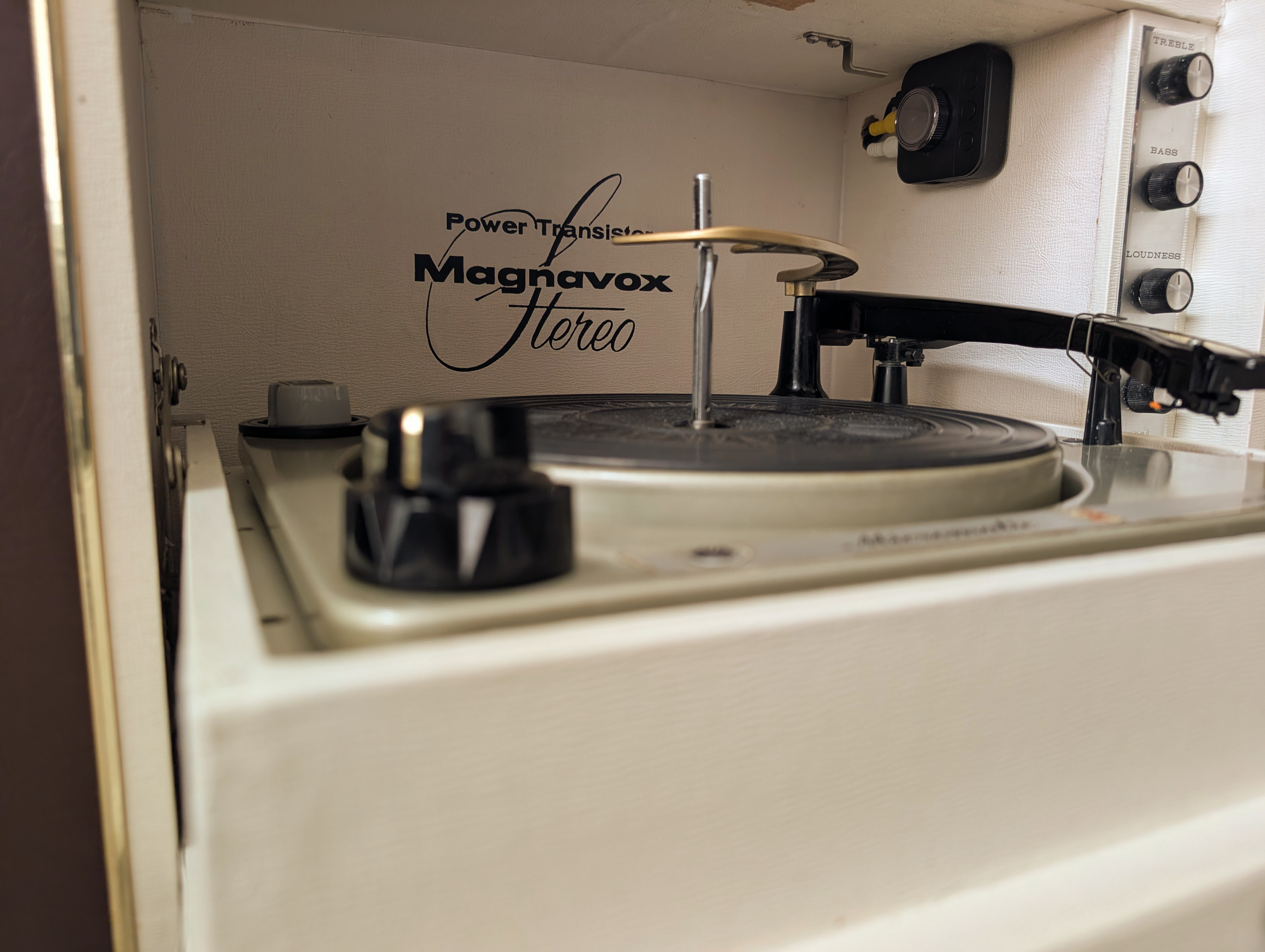

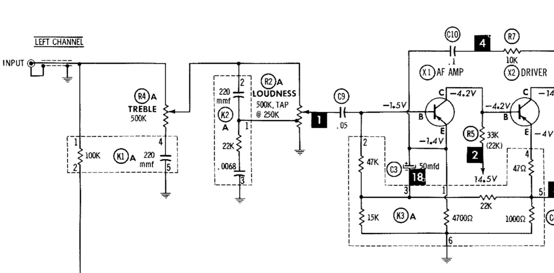

I've bought several types of Bluetooth adapters from Amazon over the years, but the one I installed on this project works really well. It has a "3D" button which sounds like it boosts bass and treble, and that makes it sound really good on this unit. After some experimenting, I ran the Bluetooth audio output (low impedance) directly into the tone tap on the loudness control instead of switching it into the phono input.
That approach loads the front end such that the audio from the cartridge is suppressed as long as the Bluetooth is powered up, but when power is removed from the Bluetooth adapter, its output becomes a high impedance, so it has no effect on the audio from the cartridge. I added a small switch so you can disconnect the power to the 5volt USB Bluetooth supply when playing a record. When the switch points to the changer, it turns off Bluetooth.

Sound wise, I think it suffers greatly from the side firing speaker arrangement. Sounds pretty dull when listening to a record from a position in the front since all the treble is shot out sideways. I'm also wondering if the replacement cartridge has different enough characteristics compared to the OEM cartridge, perhaps the front end was "tuned" for the original EV cartridge's impedance characteristics. The bass control has to be fully clockwise to sound even halfway decent. It basically functions by adjusting the input impedance seen by the cartridge, maximum bass is the highest resistance, and even disconnecting it to give a maximum input impedance sounds the same as in- circuit at max. Definitely a low cost method for creating a bass control!

Thought I would wrap this up with my final work on this guy. I ended up replacing the Pfanstiehl cart with a Tetrad EVG 5632. Sounds MUCH better. 78's sound really good on it, too! I put the Phanstiel in the Motorola SK29 restoration that is in progress--I think the input impedance of this transistorized Magnavox is too low for the Phanstiel to match up well, but it sounds good in the tube SK29.

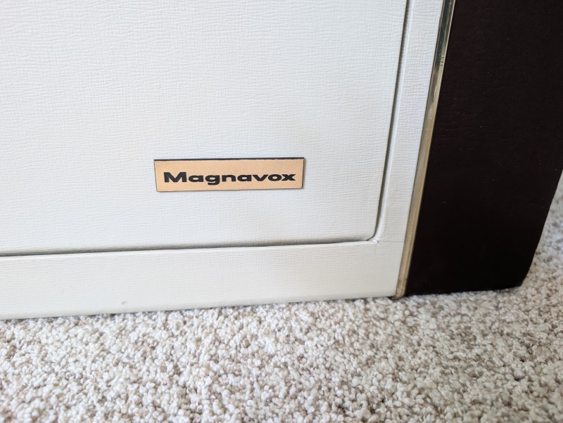

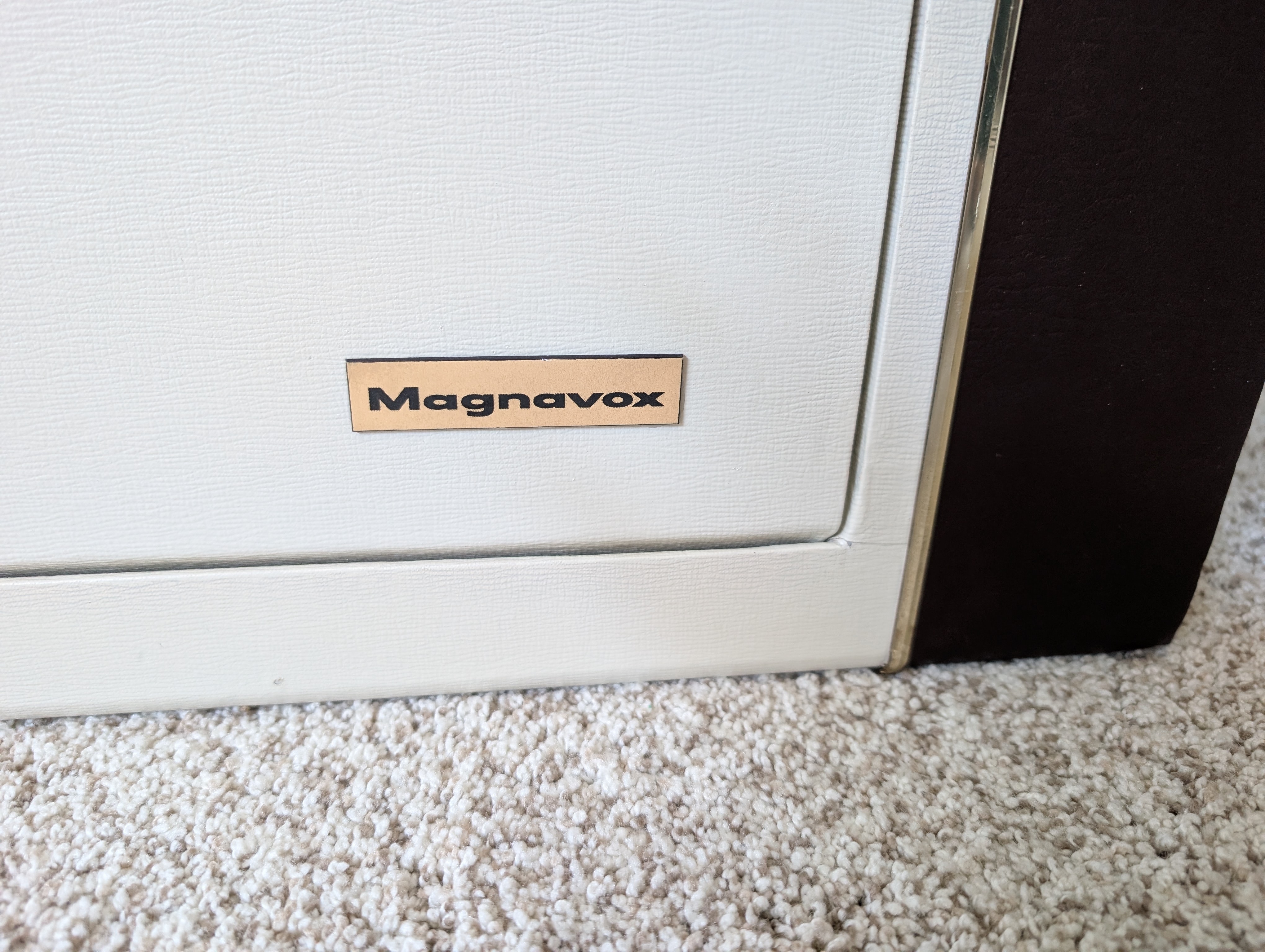

Decided to make my own logo for the front, turned out pretty good! I took a photo of the logo inside the unit, cleaned it up in Photoshop, and laser printed it on metallic gold, sticky back paper that I got off Amazon. Stuck that on matte cardboard (used in framing artwork/photos), trimmed with paper cutter, lightly sprayed with lacquer, darkened the edges with a magic marker, and glued it on.
