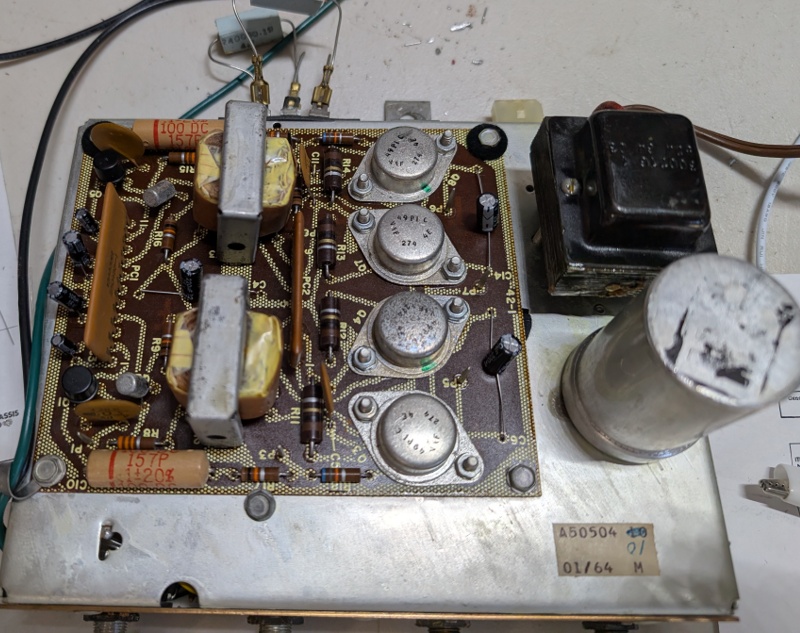

Here's a few shots of the works, maybe that's a chassis number? The PT in the amp is tiny, and no heatsinks on the output transistors, so only a few watts per channel, I suppose. All germanium, but RCA hopefully. Anybody have a source for a schematic? I couldn't find one in Downloads, and elsewhere on the web I looked were close, but not specific to this model. Lots of electolytics to replace, for sure.

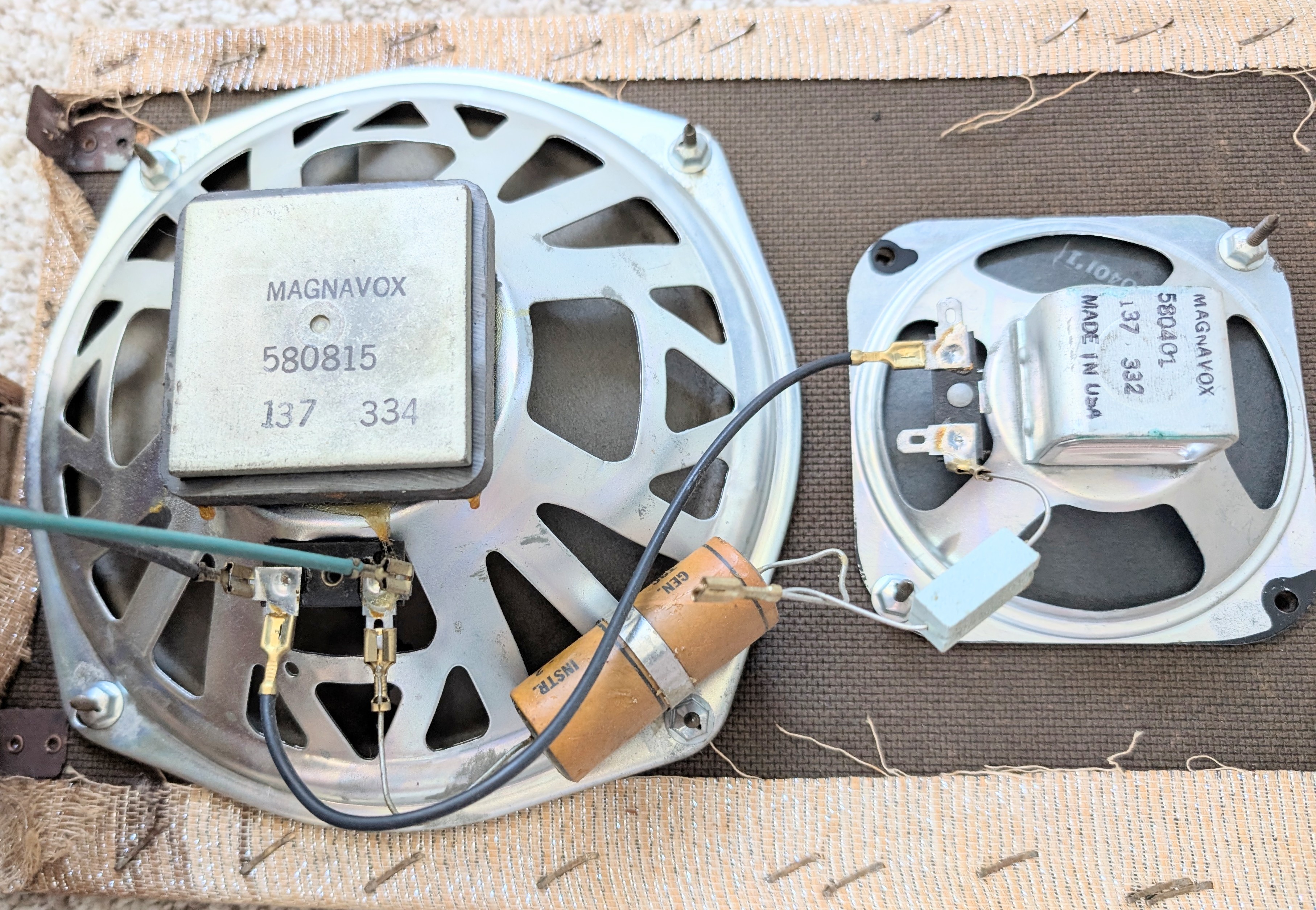

Sams 644 may get you as close as you are gonna get. The speakers were made by Chicago Telephone Supply in the 33rd week of 1964. If the stereo currently works, you may be able to get by with changing the components using the values that are there without a schematic. Good for you for attempting to save it. Good luck...... :D :D
Magnavox was vague with specifics on model numbers. They did a lot of "mixing and matching" with the various components. Many times, it is nigh impossible to find the exact schematic you need, so you have to use your imagination a bit. I never did find an exact schematic for the radio tuner or the TV chassis in my Stereo Theater.

From the photo, it looks like the amp's output transistors are transformer-coupled to the prior stage. My Heath AA-22 is the same.

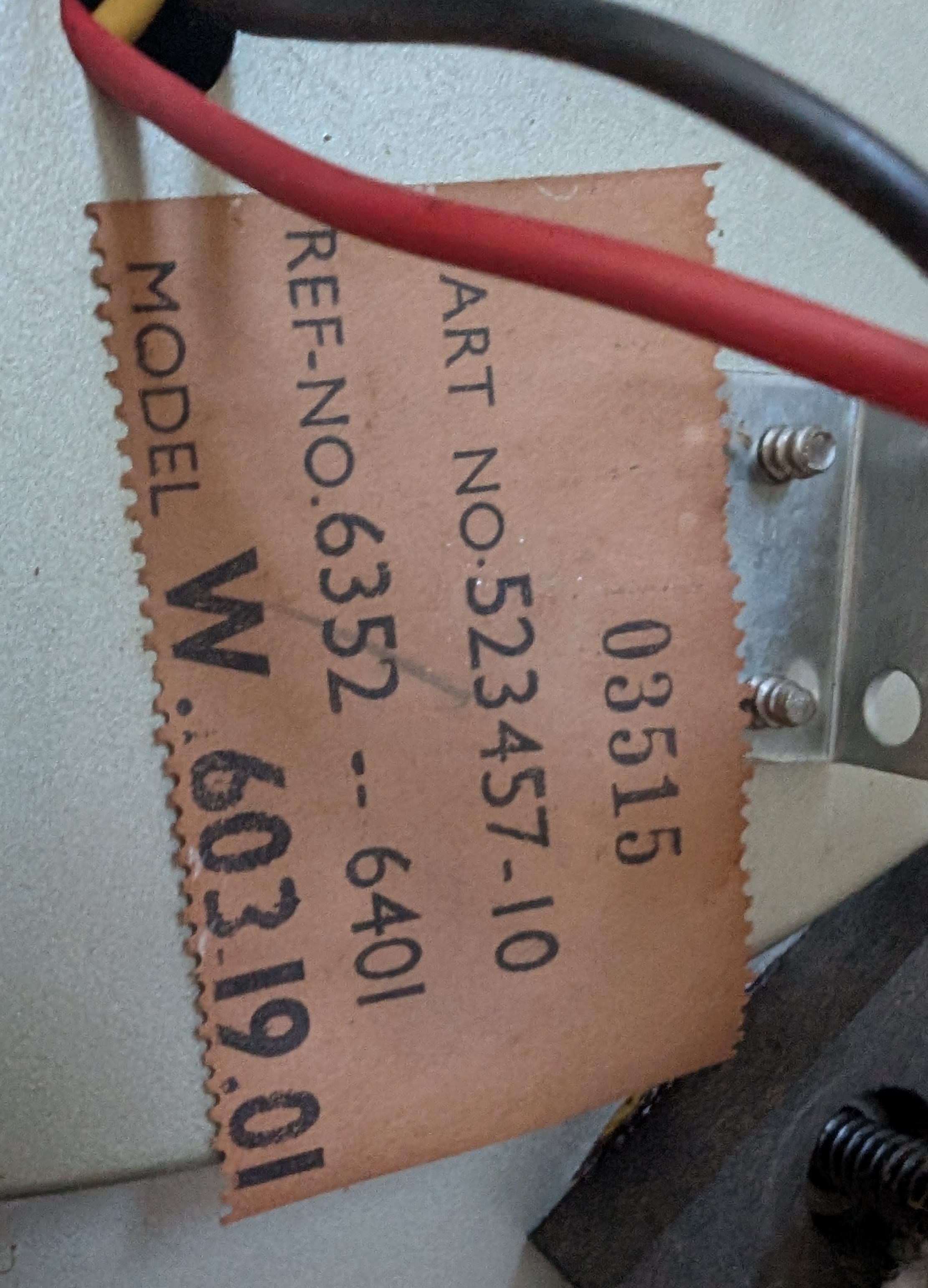

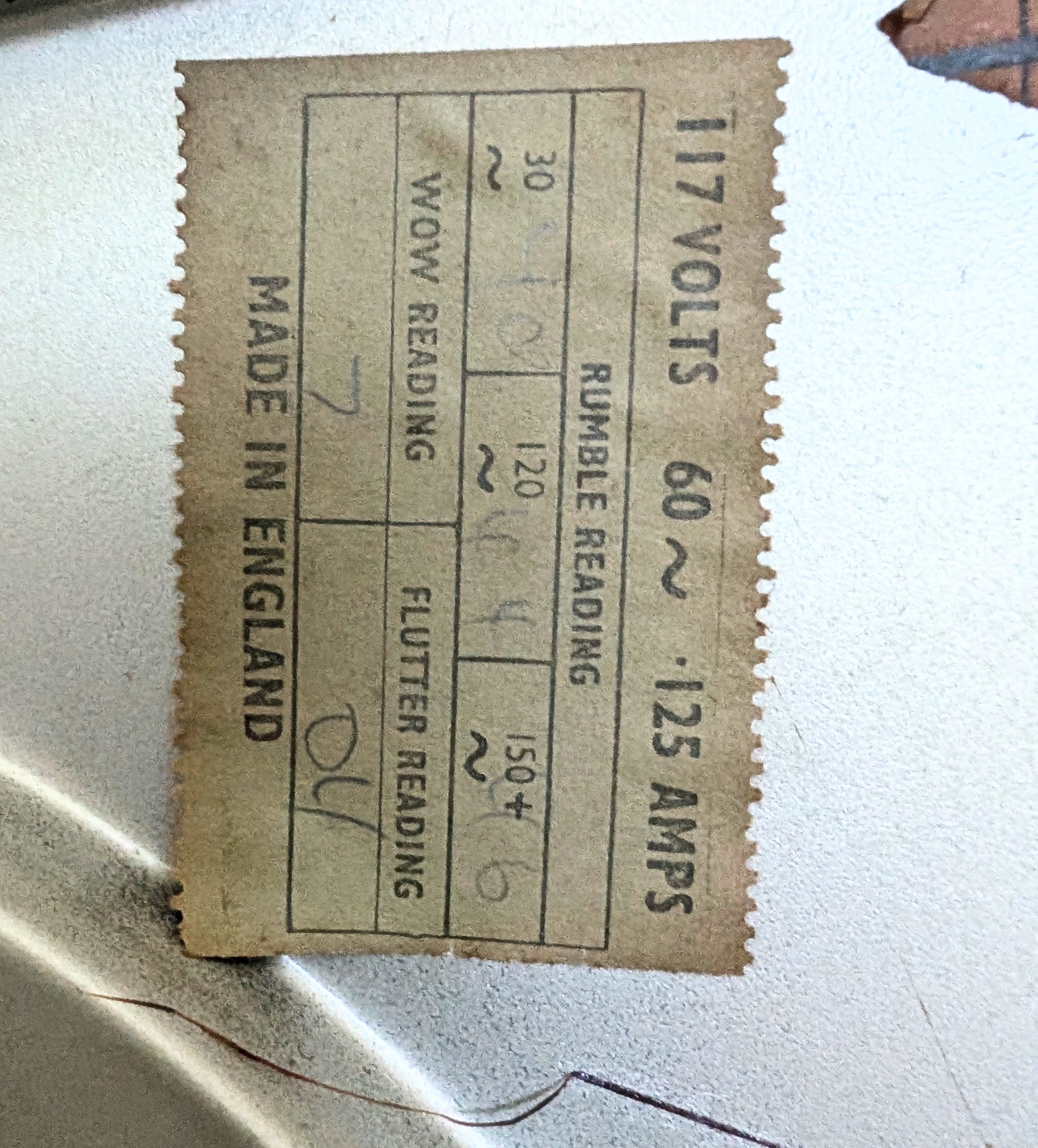

Removed the changer, here's the label. And, I was bummed when I first got this guy, no 45 adapter. But, turns out it was hiding at the back of the changer drawer! I'm impressed that they measured wow and flutter at the factory. Does the W prefix signify something different than the M, K, & L prefixes?
Posts: 3690
Re: $5 Riviera Deluxe
Post: # 27419Post TC Chris »
And rumble at 3 frequencies. Collaro was a competitor with Garrard in the changer world of the time, I think.

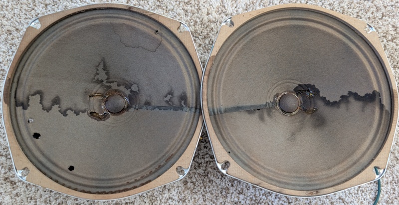

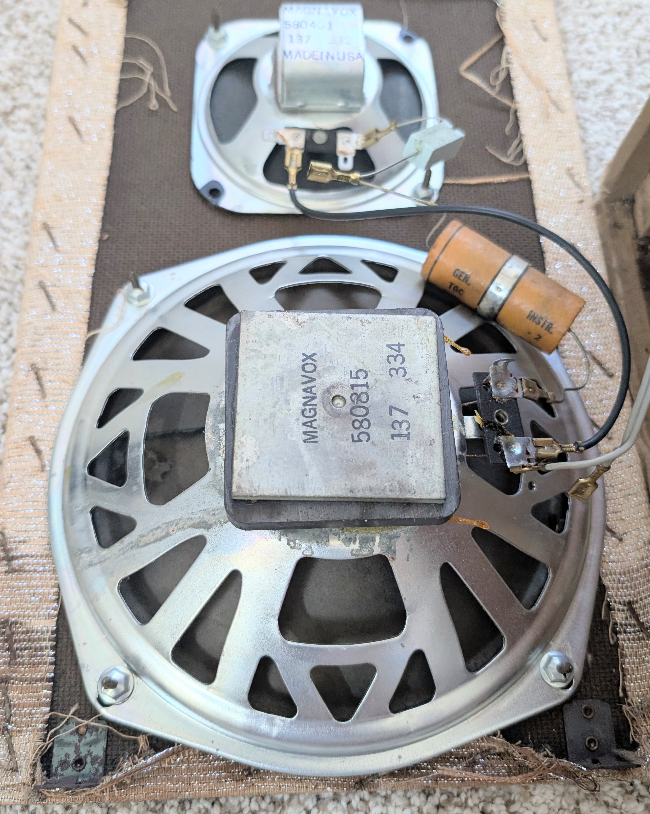

Well, turns out both of the 7.5" (they are not 8") speakers are shot, one is seized and both cones are rotten and insect-eaten. This thing must have been sitting in water at some point. Good news is the changer and amp weren't damaged by water. The 4" tweeters are perfect.

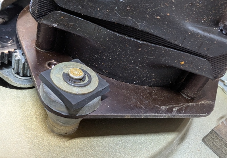

Somebody must have worked on the changer at some point, the grease is not in too bad shape. But they lost the E-clip that holds the platter and spindle in place which explains why the platter was not seated when I first opened it up! I had an o-ring that works (like VM uses) to secure the platter and the spindle works just fine. After a little oil and grease on a few places, cleaning the idlers, and shoring up motor mounts, it works like a champ--selects the correct record size, drops record, shuts off, etc. The motor mounts were pliable, but a little short, so I used some rubber from on old squeegee to add a little thickness (I know, this is a kludge, but I'll check for motor noise later). It ran a little fast, the idler was partially hitting the 45 portion of the speed spindle, so I adjusted the height and now it's spot-on! Tracking force was already set at 3 grams, on spec. I know I'm lucky that it was in such good shape! Waiting on the stylus.

I'm working on the amp now, all electolytics replaced and controls deoxed. Out of curiosity, I checked the speakers for continuity: 3 out of 4 open! I'm guessing the output caps were breaking down and feeding the 18 volts VCC directly to the voicecoils sometime in the past (no power cord when I got it).

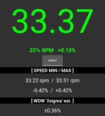

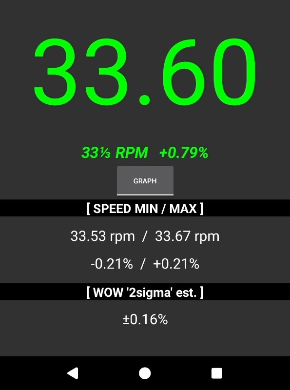

The changer was making some rustling noises while running, coming from the platter idler. I didn't want to spend $ for a replacement, and the original was pretty pliable except for a hard, uneven glaze on its edge. So I chucked it in my drill and ran it against a 100 grit sandpaper block until all the hardened edge was gone and "fresh " rubber was exposed. Now it's silent running and the numbers are much better! I have some intermittent connection issues with the cartridge which I need to fix before I can see if the audio will be OK when actually playing a record.

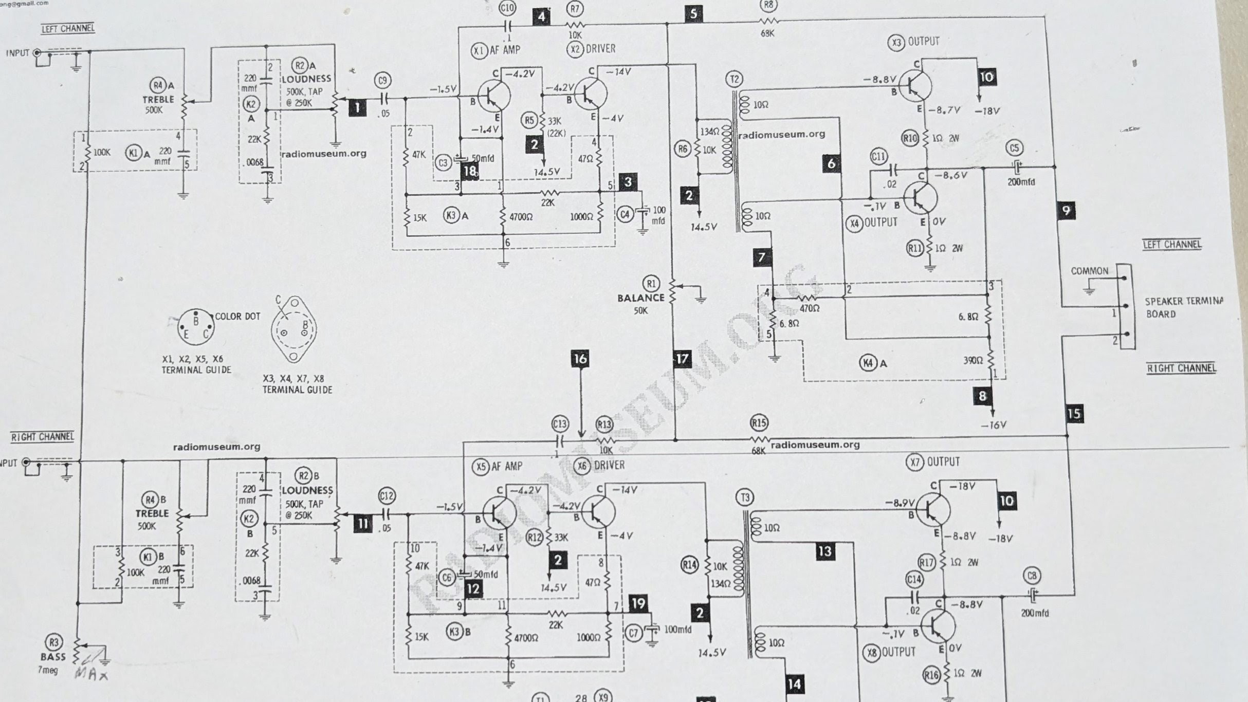

Well, the oscillation was because my left channel test speaker had a loose connection on the rear terminals, and I didn't realize it, so that channel didn't like an open circuit load! :oops: Now the little amp appears to work just fine.
It's not a very sophisticated amp, of course. What's really strange is that the cartridge inputs are connected together through two 100k resistors, with their center tap going to a 7 meg pot to ground, which is the "bass" control (lower left corner). Must be highly dependant on the particular cartridge electrical characteristics in order to work? And the balance control is a single pot connected between channels which just fades one channel or the other to ground. Methinks this is to save $ on pots!
Thanks to RadioMuseum, here's a schematic (I paid and joined up after I downloaded this)
Post: # 27767Post stbasil »
Correction on the balance control --it's connecting the negative feedback circuit of each channel together through that pot! I can't figure out how that works, and in practice it really sounds crummy: there is a significant change in the fidelity/loudness as the control is rotated, with the center position actually sounding weaker and worse!
Also had a strange low frequency oscillation occur when I connected a larger speaker to one channel, varying from about 30 to 75 Hz, depending on the positions of the volume and balance controls. I don't know what the impedance of the original speaker array was, since they are shot, but apparently the amp prefers a load above 8 ohms. The oscillation doesn't happen with the two 8 ohm test speakers in series.
