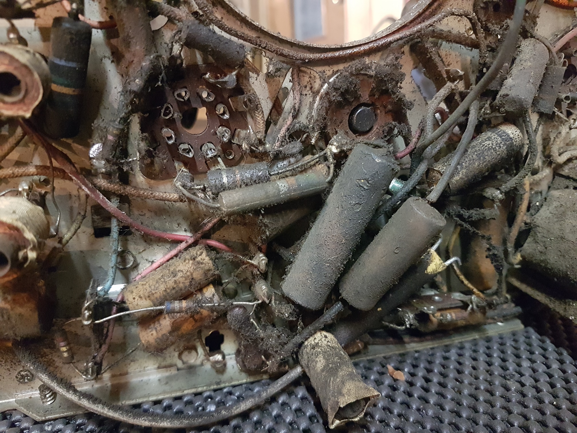

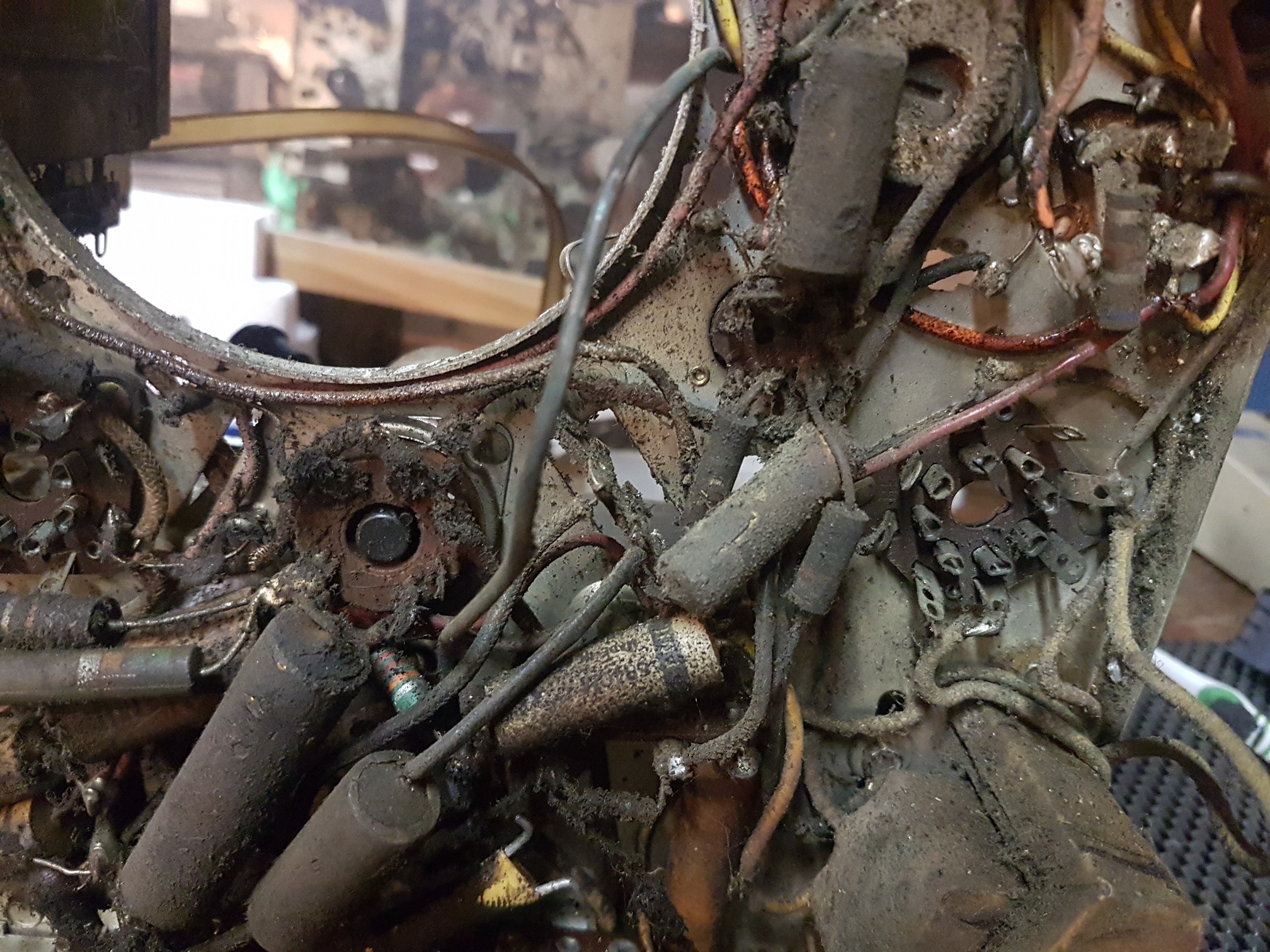

I took a couple of picture to better illustrate my problem:
https://i.postimg.cc/qr1pJMgg/Caps-01.jpg
https://i.postimg.cc/NYVYXJ6c/Caps-02.jpg

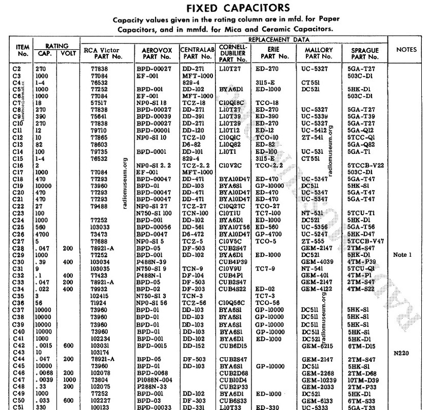

And here's a screenshot of the "Photofact Folder" list I've found:
https://i.postimg.cc/Fst2B6pk/Caps-03.jpg
Sure I understand that logically C3 must be 0.001Uf and therefore either a Mica or Ceramic cap, but why not just mention it?
The fact that I have to "guess" each value is kinda ridiculous...
Also what about the voltage?
Anyway, wish me luck!
I'll make sure to update you guys, but that'll be a very long project, haha.
Actually I also bought an "Admiral T-103" at the same time and it's in MUCH better condition so I'll probably start with this one.
Oh and btw, the plastic "yoke cover" on both my 14-S-7070 and the T-103 is broken just like yours was, so I'm pretty sure those cover are broken in every single 50s TV.

I made it easy on voltage values on caps. With the exception of the high voltage caps, such as the boost filter and that, I used all 630 volt caps. I think the boost filter on that chassis is 1000 volts and the vertical has a .001uf @ 1600, and the audio has a 1600 volt cap as well. Tiny value caps are either mica or ceramic. You won't need to mess with them. There are several paper caps in that chassis. I left the HOT, damper and HV rectifier out then ran the chassis without yoke and CRT like a radio to test the front end and audio. I did this so I could check the operation of the horizontal multivibrator before I stuck the chassis back in. After you get the chassis and picture tube separated, the chassis is not bad to work on. Be careful working under the shield for the IF strip. You can do more harm than good messing around in there......
I made my yoke cover out of stuff I dug out of the trash at the store. The plastic is the lid from an expensive brand of ice cream. The cardboard came from rolls of industrial toilet paper. I can be more specific if that will help you.
And just as an aside, passing along good advice I was given....
Use orange drops in the sweep circuits. The "little yellow caps" that we all use for radios will be fine in the front end. But for the boost and sweep circuits, these don't hold up as well as the orange drops. For what it's worth.....
