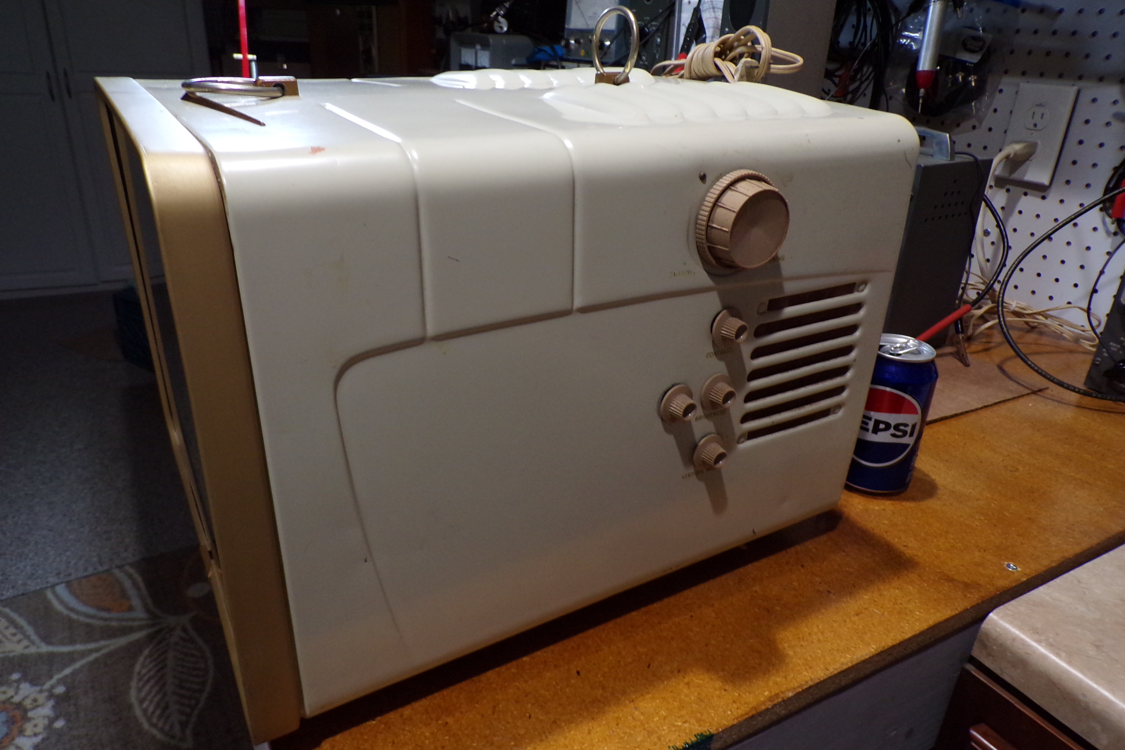

This was my parents' TV set. I remember watching Gunsmoke on this set. I remember it having a great picture, but also having really awful sound quality. I lived with my grandparents. Their RCA console TV had two 12" speakers and P-P audio and had really good sound. This new RCA TV was considered to have a huge screen, as my grandparent's RCA console only had a 10" screen. My parents got a new TV when the wife and I got married, and we inherited this old RCA. We used it until 1971 when we bought our first color RCA TV set. This old set went to the bedroom first, then the wife's sewing room, then the garage, then abandonment and storage after that. The wife thinks it may have been 40 years since it was in regular use. Like other items we still have, it just never got thrown away.

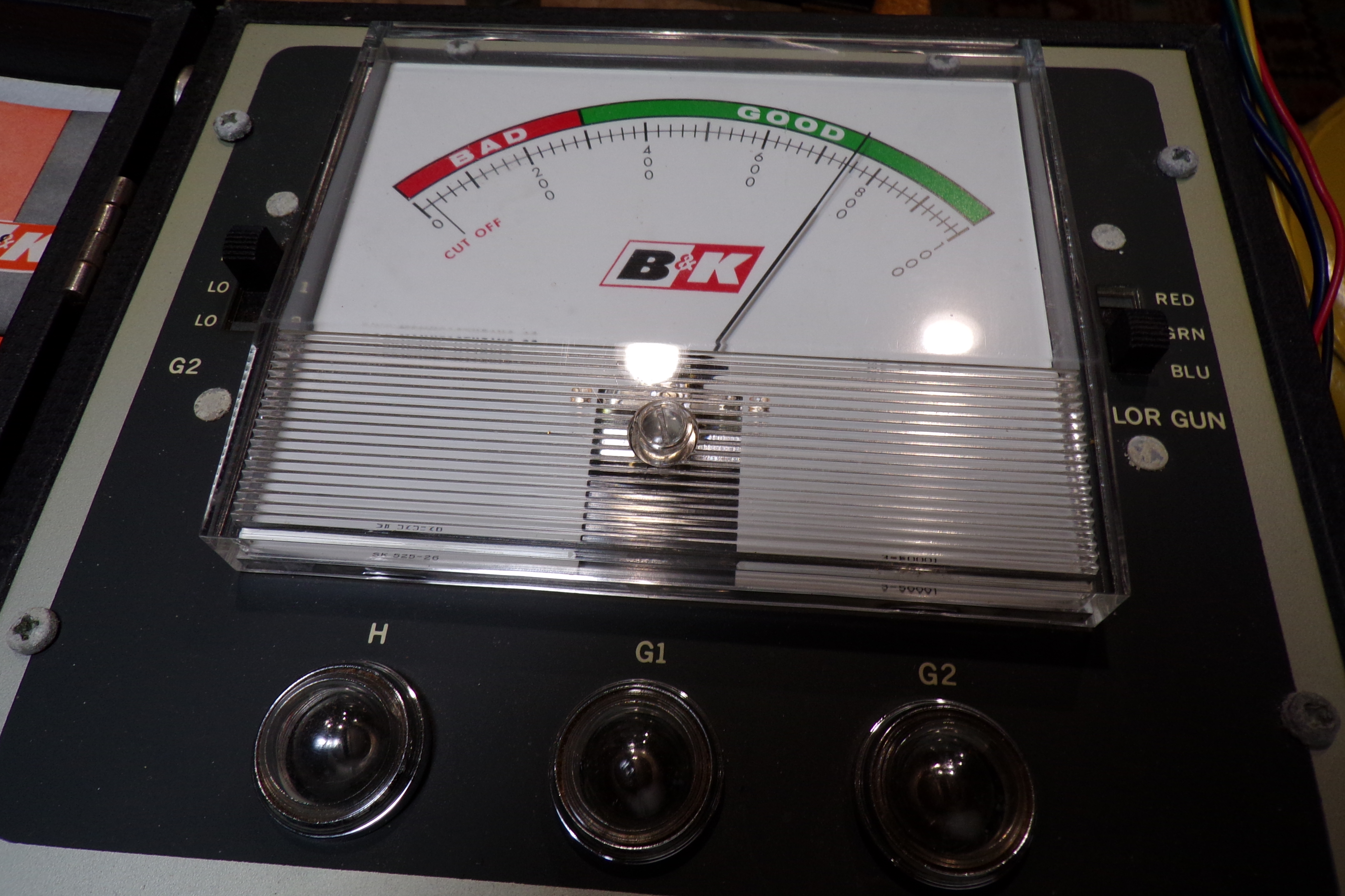

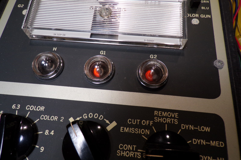

I am digging thru items I don't use much. I decided to see if this thing would be worth putting time into to get it running reliably again. The model number sticker is partially missing. I think it is a model 14-1075 with some letters in there someplace, but don't quote me on that even. The chassis is a KCS 102F. It has a 14" 14RP4-A picture tube, 14 tubes, transformer power supply and a chintzy "clock radio" 4" speaker. This set is one of those you have to pull the picture tube and chassis out the front of the cabinet. I'm told they are a pain to work on. This one is in fairly nice condition considering it has been largely abandoned for 40 years. I tested the picture tube. Cutoff and emission are both excellent, about like a new tube. It is date coded the 46th week of 1956, so that would make it a 1957 model, consistant with family memories. The story goes it was bought new from Cousin Calvin the RCA dealer right after my sister was born in January of 1957. The tubes I removed and tested were all white-letter RCA with the exception of the 6AX4 damper tube, which is a Raytheon. I don't remember whether red letter tubes or white letter tubes are the replacements. All the ones I removed had white letters some of which were pretty faint. The only date codes on tubes I could read was on the 6AQ5 vertical output tube which was the 43rd week of 1960, so there has been some service performed over the years. I'll need to remove the chassis to check for "fuzz" before I can make a determination of the approximate hours on this set. I'd say it got a lot of use, but there is little tungsten boil-off in the tubes. From what I can tell at this point, it should be worth rebuilding and maybe enjoying a bit going forward.

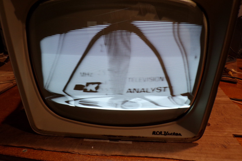

I'm in that process now. I'll contact Moyers and see what they have to say. I also want to source a yoke just in case. This TV basically works. I have a raster, a bright "jug" (picture tube), horizontal and vertical deflection that is stable. I can have Don hot rod the case, paint it two colors maybe. The cover on the yoke is really delicate. I was going to can it until I remembered all you went thru with your Imperial. The TV guys seem to think I need a test picture tube to get this to work, I don't have that, so I'm going to have to improvise.
Initial start-up It's an image from the 1077B. Not much of an image, but it is there and it's stable at only 140 volts B+

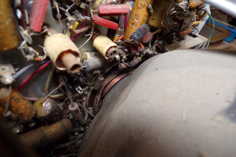

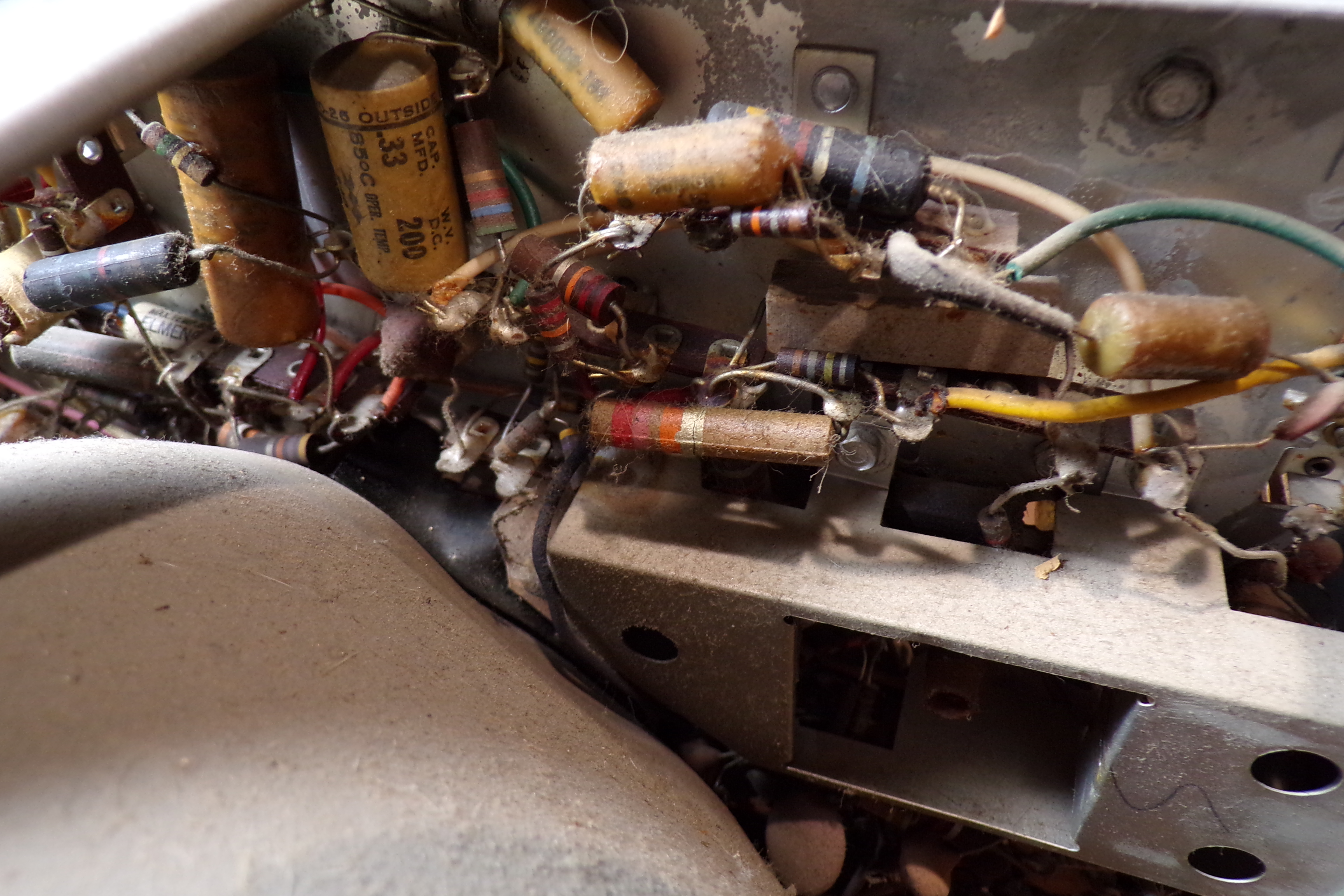

I got three or four hours in on this set today. I ran the resistance chart, checked all the resistors, recapped the sweep sections. I need three caps that I don't have the correct value for. I hesitate to substitute values particularly in the vertical sweep section. My next step is to power up and see what I've got. I need to figure out a way to get a bit more room to replace caps without removing the picture tube. Then I need to order parts and go from there.

Yes. The TV guys recommend, after you get a baseline, to start with recapping the power supply first, then recap the sweep section, the vertical and horizontal sweep sections. These are the areas that the capacitors are most likely to fail, and they are the areas that component value and condition are most critical. And they are the areas where component failure is most likely to lead to the breakdown of the major components, such as transformers and coils. It is recommended that you do one section at a time, then check performance. The theory is that this gives you a better chance at troubleshooting if you have made a mistake.

I don't care what the "experts" say, this thing needs a power transformer. Spec on B+ is 255 volts, I have 168 volts B+ after the high voltage comes up and the picture tube lights. I don't have the tuner cleaned yet, nor have I completed the recap, but the image on the screen is bizarre. This set will never work right with only half the power transformer working, only half the rectifier working. I'll continue with the recap and check after each section, but it's not going to work right with such low B+. It is almost 100 volts below spec....

I don't know why I even messed with this TV. I think my utilmate goal is to not kill the yoke taking the chassis off the picture tube, then to not explode the picture tube trying to fix the yoke. I also hope you guys who know more about this stuff than I do will lend your expertise as needed. My first challenge is getting the chassis separated from the CRT. Actually fixing the chassis will likely be the easy part. Then I have to get it all back together again. I would like to learn to stream to these old TV sets. Other guys do it, so I need to know what procedures I need to use.
