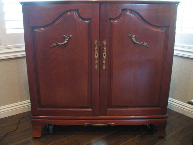

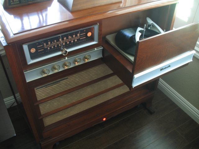

My New Orthophonic SHF-3D
She sure is puurty...

That is a beautiful RCA, Gary. The cabinet looks like brand new, did you find it in that condition?

Hi Bill.
Yes, the unit was in this condition. It was owned by an elderly couple who had passed back in 2000 and their grand daughter finally decided to sell it May of this year.
I did a complete overhaul of the changer and electronics. I also decided to fan cool the chassis compartment since it ran so darn hot! Lots of out of spec resistors as well as a couple of open plate load ones feeding the tuner and amp af stage. I replaced all of the old electrolytics and wax caps too.
She really rocks!

That is a beautiful piece and I'm glad it found a new home with you. Sometimes we can get lucky and find a unit that has had tender loving care, and sometimes that is not the case. Most of what I have the cabinets have been in pretty good shape. My Motorola 3 channel in the Drexel cabinet was not the case. I looks like a truck ran over it. The good thing, I only paid 10 bucks for it.

I really like the styling on that one ... very elegant ...

A pretty formal design, in beautiful shape. What's the speaker complement (pix?).

A pair of 12 inch woofers wired in parallel and a pair of 3.5 inch cone tweeters mounted on angled horns also parallel wired.
The amp is a pp design with 6V6GT finals. It really rocks with that big old fat vintage tubey sound.
I love it..back to mono!

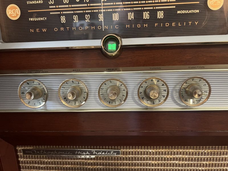

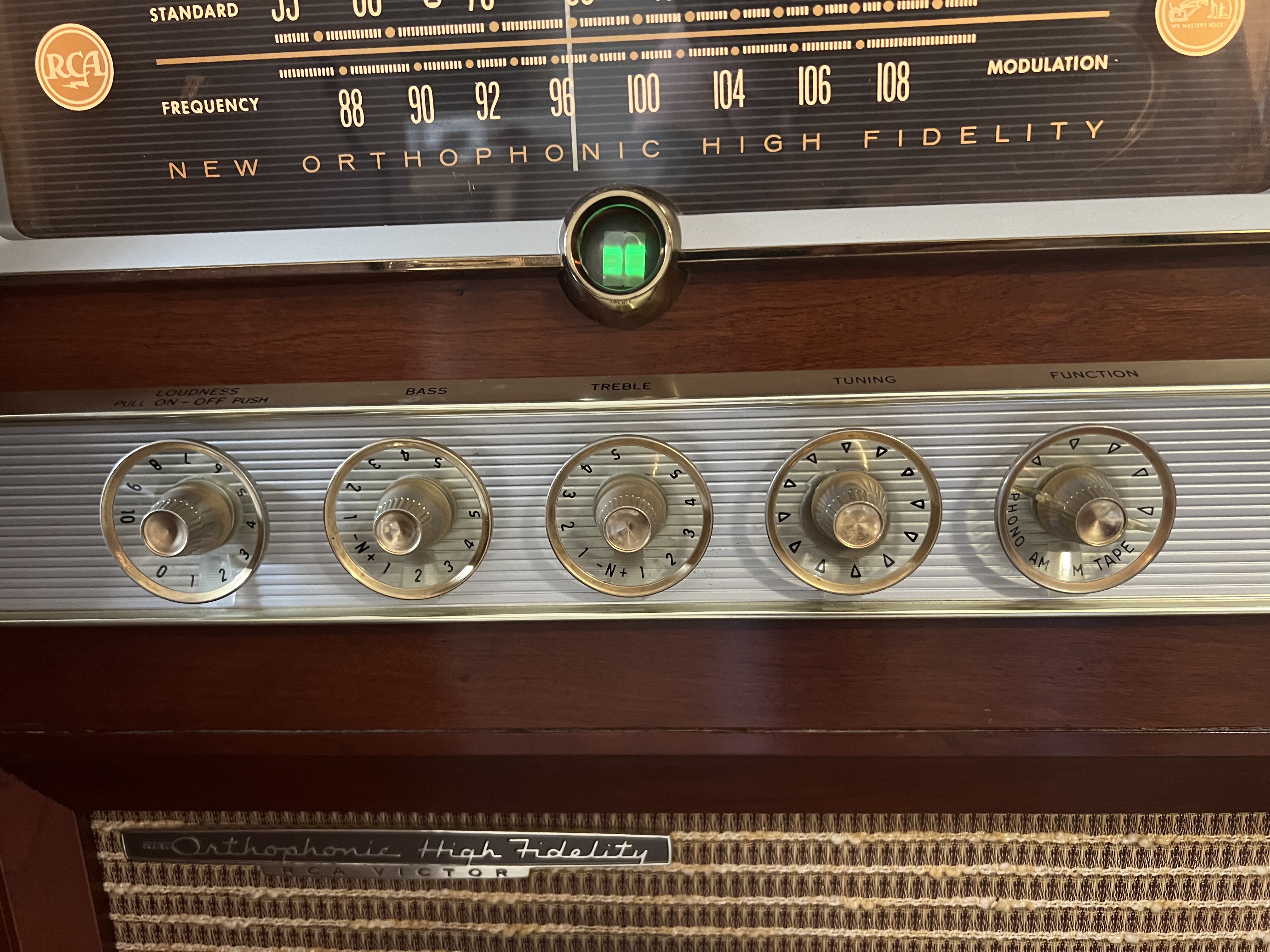

I have the same one I inherited from my grandmother. I wish I knew what year this one was made I love it!

If I were to guess, I would say 1957-58 It's stereo compatible and may have the stereo switchable amp. Could you please provide the model number on the back, or maybe a photo of the back side so we can see the amp/tuner?? That series from RCA was in their deluxe series and were great performers. I can see why you would love it.
