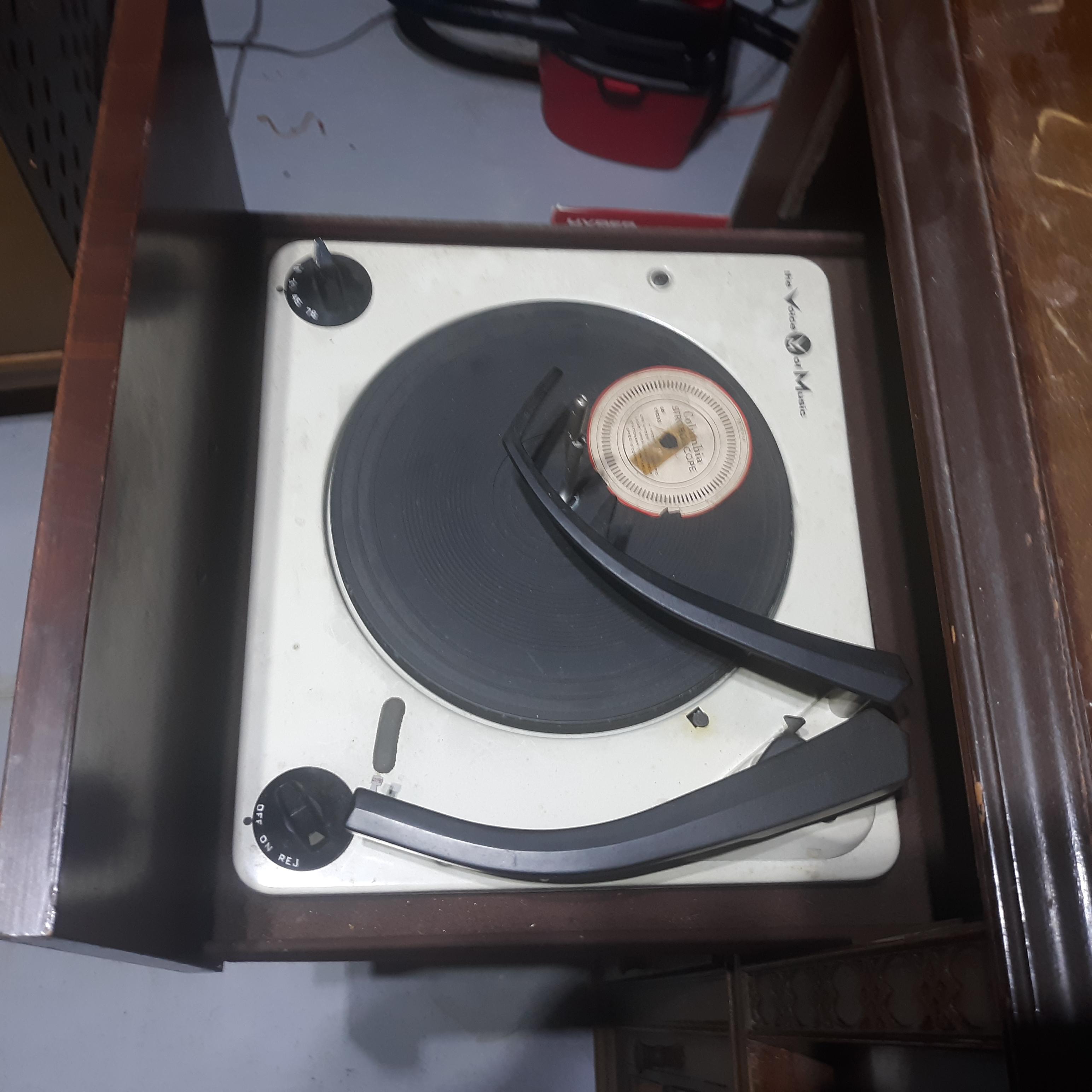

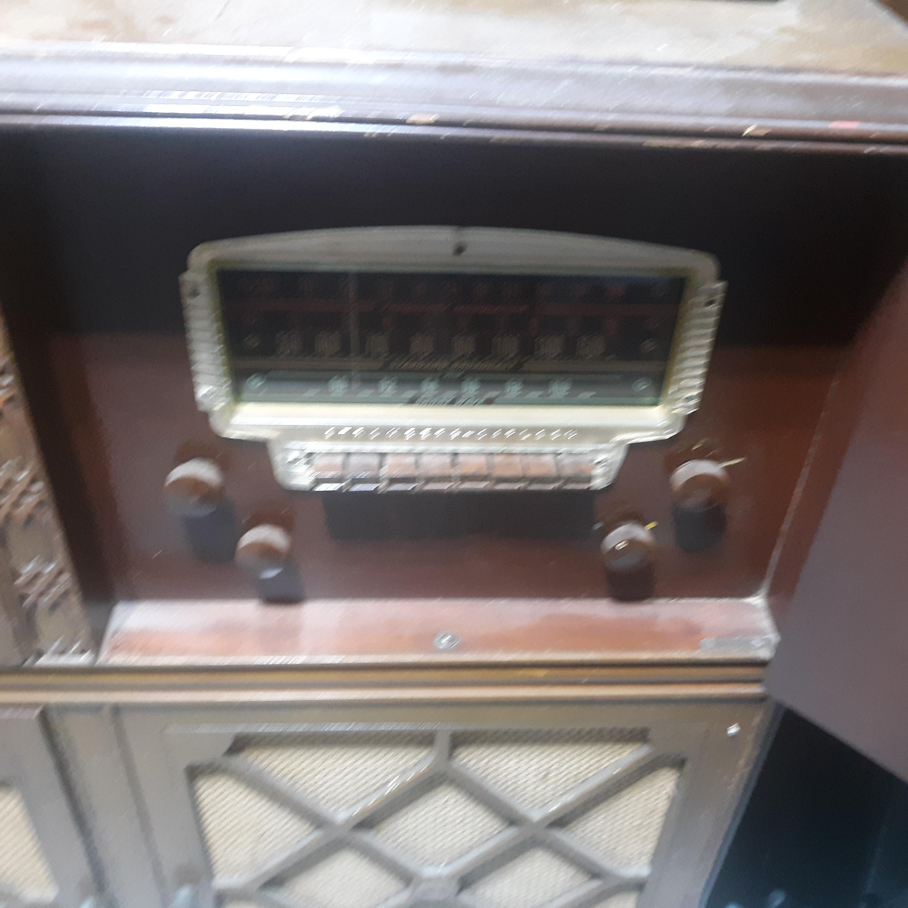

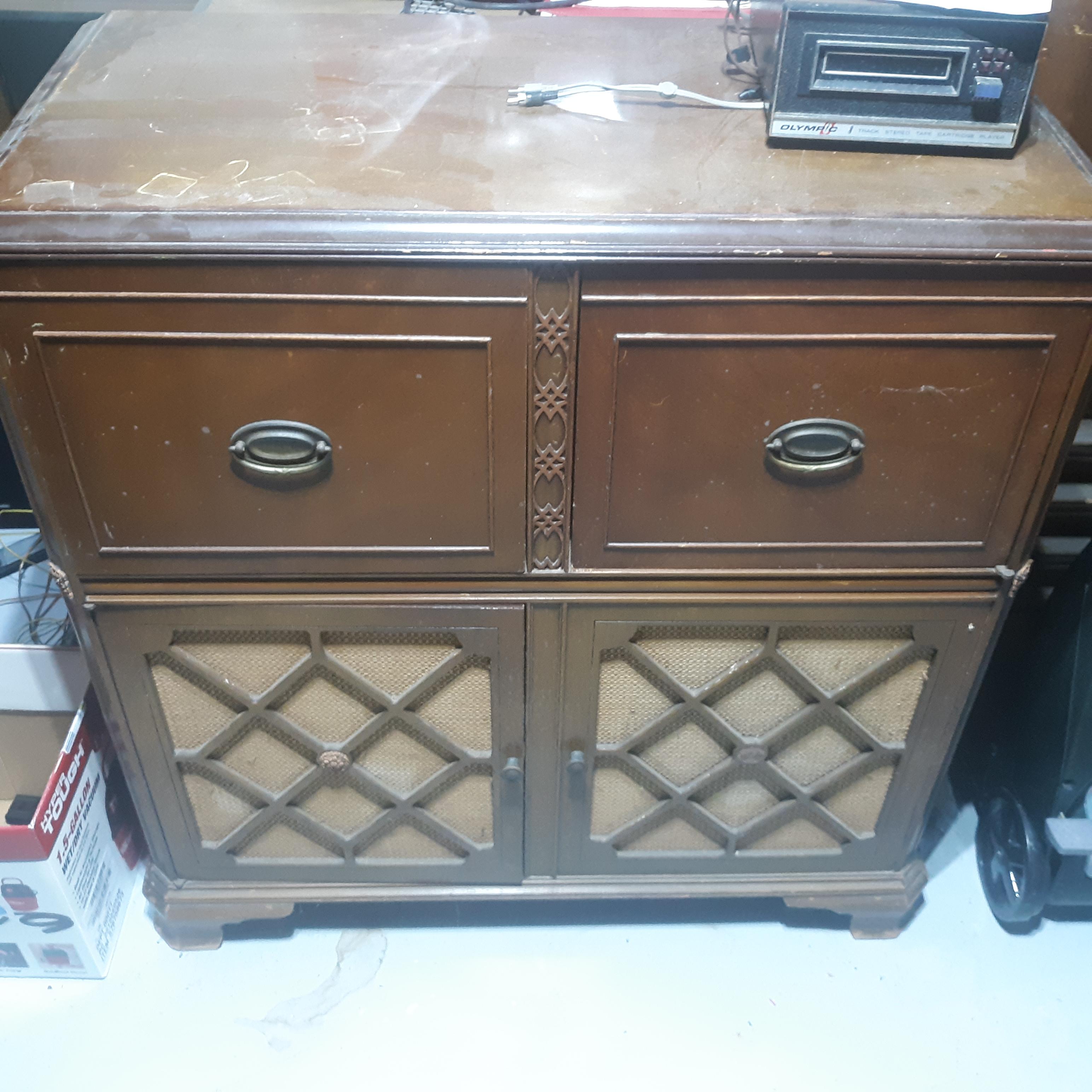

I have one sitting in the basement ... it has both the old and new dial for FM... someone removed the changer and replaced it with a VM 1200... I think it starts with a PLM12 something ... cant get to the back of it , is buried under a bunch of other stuff ...
Re: Stromberg-Carlson 1121 console
PLM is a style of cabinet like my 1210-PLM, a year later than the 1121, which uses 7-pin tubes as Greg noted. Bet you have the same 1121 I do, Ill get a picture up. I seem to have lost the file.

That one is identical to the one I have. Mine has a Garrard changer. A SC-branded VM is on my bucket list. Mine is a tremendous performer. Almost as good, maybe as good as my Philco 40-180, at least before I moved it. The original changer, of course, was a 78-only plow. I'm guessing a lot of them had the changers replaced sometime in their lives. I used a 24' aluminum step ladder for an AM antenna on mine. The original antenna is missing. Somebody hotrodded the one I have then Bill rescued it.
I believe the changer was added later ... you can see where someone joined both sides of the cartridge to make it mono... not sure what kind of changer it would be ... unless SC used VM changers?

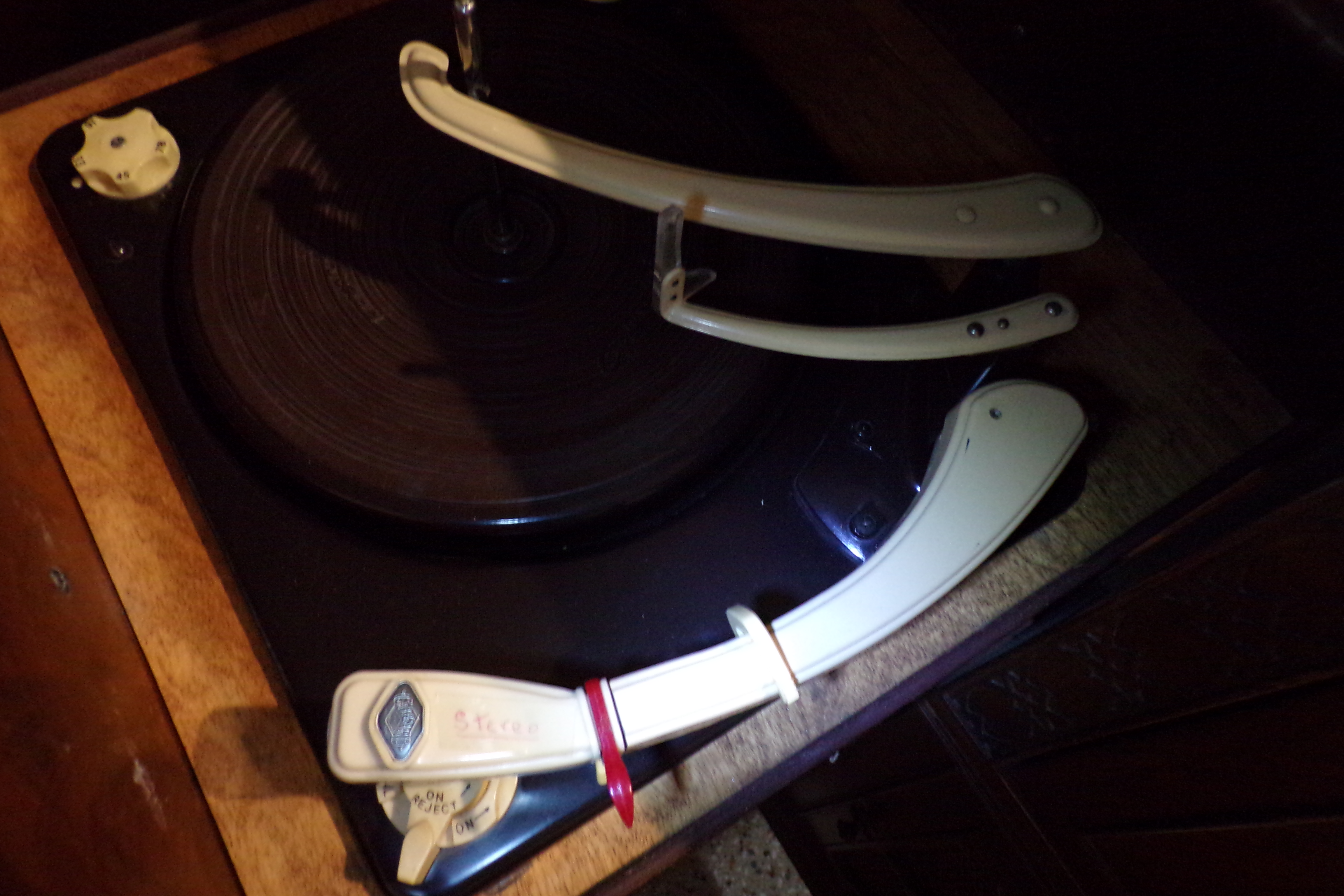

Dave was talking about his 1121, and it gave me inspiration to tinker with mine a bit. The changer in mine is a Garrard RC 121, Mk II. It has a Shure M44C stereo cartridge. The changer is seriously kaput. The speed control is frozen. The platter doesn't turn. It acts like it is in perpetual reject. I put the KAW on the power cord and found it draws 11 watts when you turn it on, but the motor doesn't run. I have never tinkered with a Garrard changer before. I have spare VM changers around here, which may provide a better setup than this Garrard. I'll post some pictures when I get them downloaded to the computer.
- Posts: 9074
The Shure M44C tracks at 4-5 grams. That isn't horrible, but it's not gonna work for a turntable, it would work okay for a changer. This changer is stuck, period. I pulled the platter and found that the motor does run. The speed turret is stuck, so the drive tire is a quarter of an inch away from the motor shaft. I got the platter where it would turn, but the changer is stuck in reject. I was gonna rob the cartridge, then toss the changer. I'm not going to fool with this changer. I have a VM I can use which will be easier to live with. Elton's has a VM and maybe I can find a VM that is Stromberg-Carlson branded. I'm guessing that the Shure cartridge is a ceramic. I'll have to look that up.

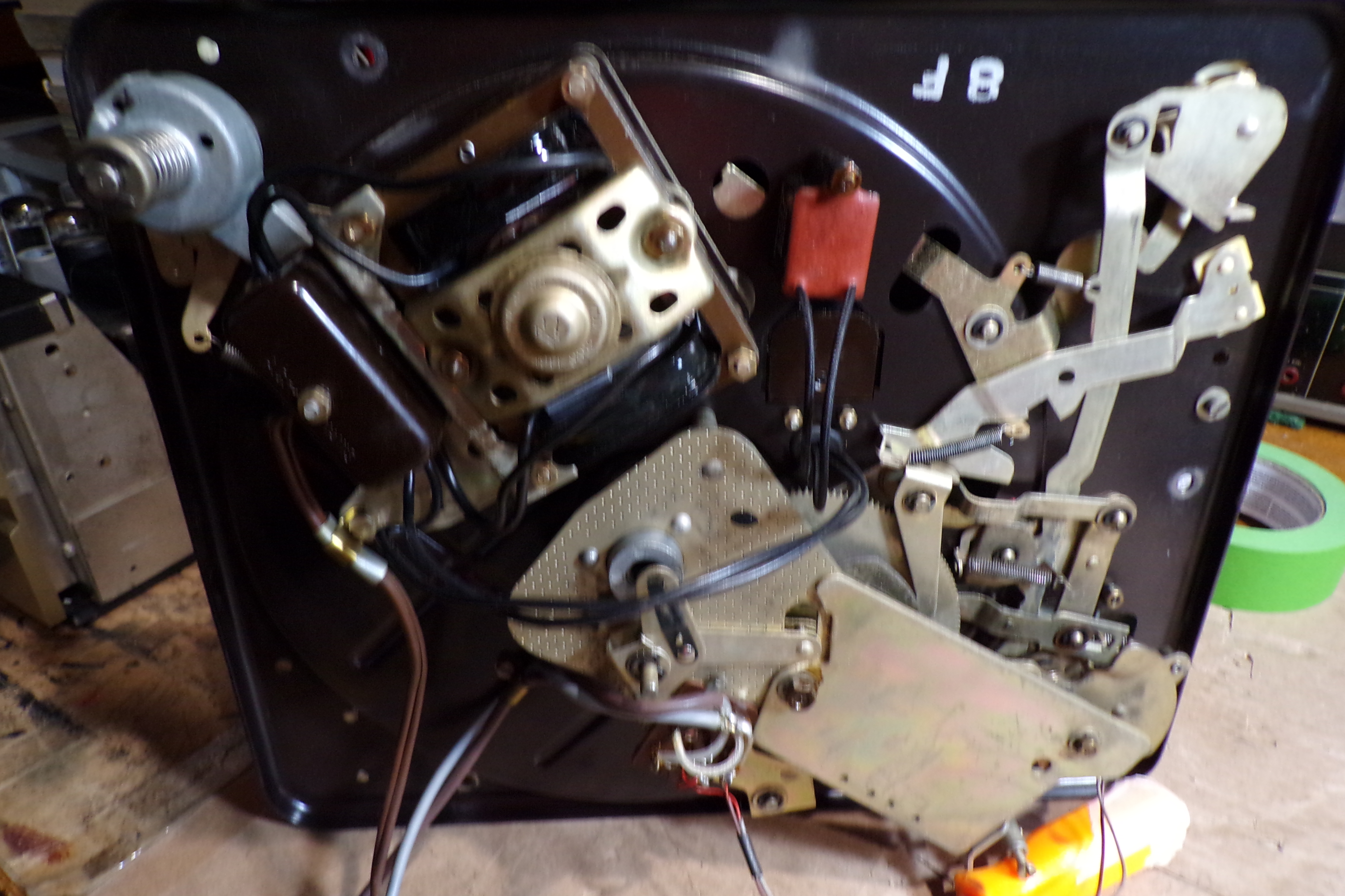

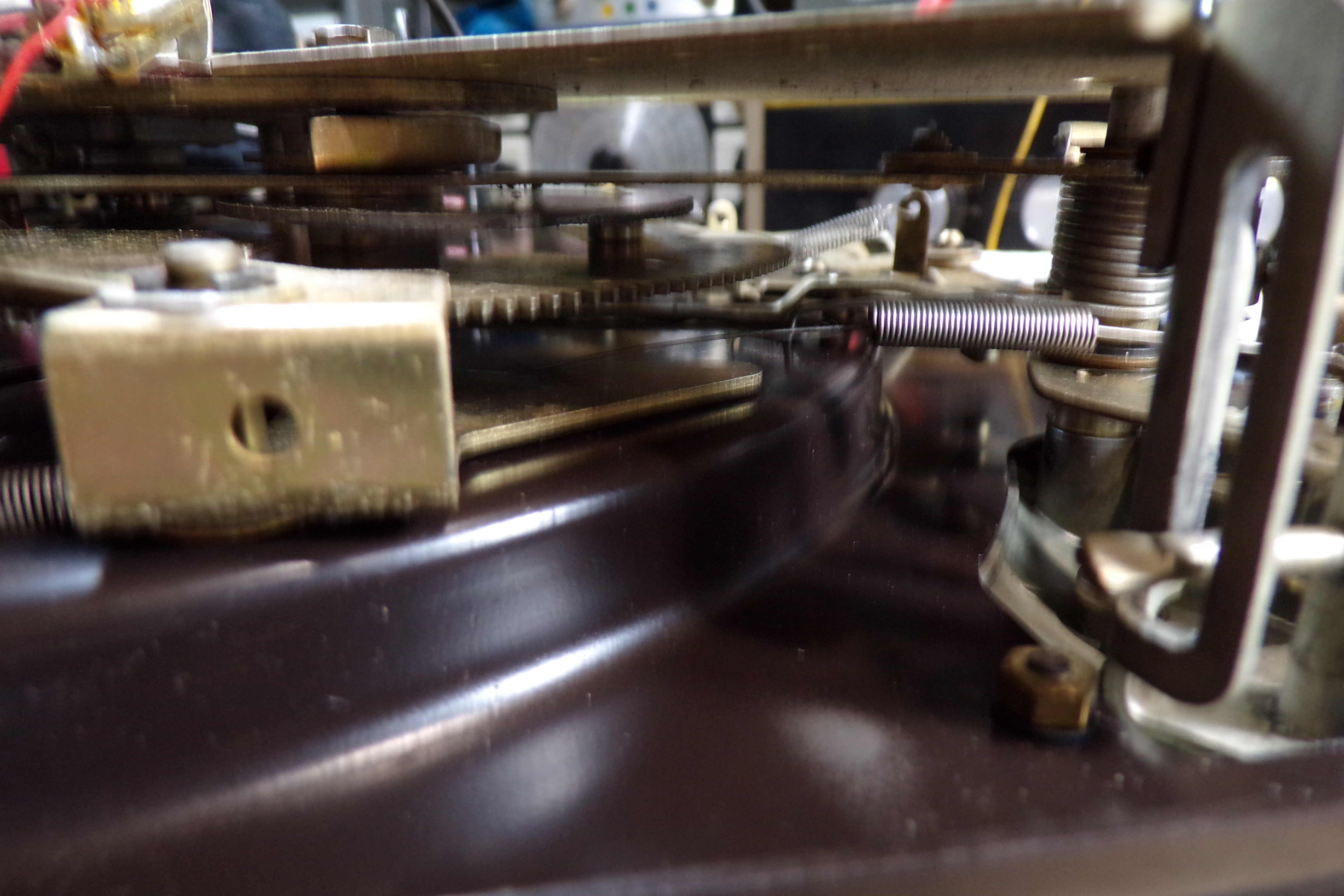

I had a fit of mental illness this morning, and decided to dig into the Garrard changer to see if I could make it work. Since I have a VM changer standing by, and I don't really care if I get this thing going or not, I figured I had nothing to lose. This changer isn't worth all the much to the audiophile crowd, since it is usually found in "worthless" old console stereos. I've never had a Garrard changer before, certainly haven't tried repairing one before. This thing looks a lot like a Collaro from the bottom with all its "unnecessary" levers and linkages. It has a nice four-pole motor. The drive tire is still soft and pliable and the motor mounts are in reasonable, usable condition. After I did a bit of cleaning, I found that the changer as a whole is in excellent cosmetic condition, nary a mark on it. The platter mat is still pliable. It looks to me like the biggest challenge may be to figure out the cartridge wiring. The output looks stereo, the cartridge wiring looks mono. And, of course, it has the stereo cartridge.
Let me say right off the bat that I am "shooting from the seat of my pants" as all I have in the way of service literature is watching a few Chris Cuff videos. My first effort was to try and get the speed control unstuck. It was so stuck it wouldn't let the drive tire contact the platter. I figured out how to remove it. I removed the drive tire and a small linkage with a spring that was really happy where it was. Removing the motor might have made the removal easier, but I didn't want to take several things apart at once until I "got my bearings" as to how this all worked. There is a forked retainer with a tail on it that fits in the control knob on the top. Removing the retainer lets the assembly fall out from the bottom. I like how they did the speed control. Instead of having the usual stair step arrangement, it has a two-piece aluminum assembly. The stepper half turns inside the stepped half. The shaft in this two-piece assembly is what was stuck so tight. I soaked it in PB Blaster overnight. Then I used masking tape to protect the moving part while I twisted it with Vise Grips. It finally came apart after about 45 minutes of patient, gently twisting. I sanded the shafts with 150 grit to remove the black gunge that was making it sticky. I used some turbine oil on a Q-tip to apply just a tad of lube, then put some Phono Lube on the part that turns. It works really nicely now. The drive tire meets the motor shaft, and it seems to run essentially in the middle of the step on the motor for each speed. It is a four-speed changer with a "neutral" position past the "16" position. This was where it was when I started, and I thought maybe something was broken for the control to be past "16". In the neutral position, the drive tire is not in contact with the motor shaft nor the platter, to keep the tire from flat-spotting. Kind of a neat feature. I gave the drive tire a spot of oil. Now I need to figure out why the sleeve the platter sets on has a sticky spot in it. It was really stiff until I gave it a shot of PB BLaster. I'm guessing I will have to remove the spindle to get this sleeve off, but I don't know that yet. That will be my next task.
- Posts: 9074
I only have one speed that works, 45 rpm. 33 will work if I hold a linkage. I suspect a spring not being strong enough. The other two speeds won't work at all. I have no idea what's up with that.
The tone arm is stuck and won't move in toward the spindle at all. I think I see what ails it. There is a shaft with a spring around it that appears to be bound up. I took a picture of the top assembly that I have to remove to get that shaft to move again. I think that will let it cycle and let the tone arm move. As you can see, I'm trying to get this thing to work with a minimum of disassembly.
For the problem with only one speed working, I have read where shimming the motor mounts with fiber washers to make sure the motor shaft is running straight with the drive tire may need to be done. Further investigation has also revealed that the cartridge wiring is for the stereo cartridge. The cartridge connections are unhooked and there is only one common wire used. I will need to check how to rewire the cartridge, then connect the two commons together. I think the shaft with the spring around it is the one holding everything up.
