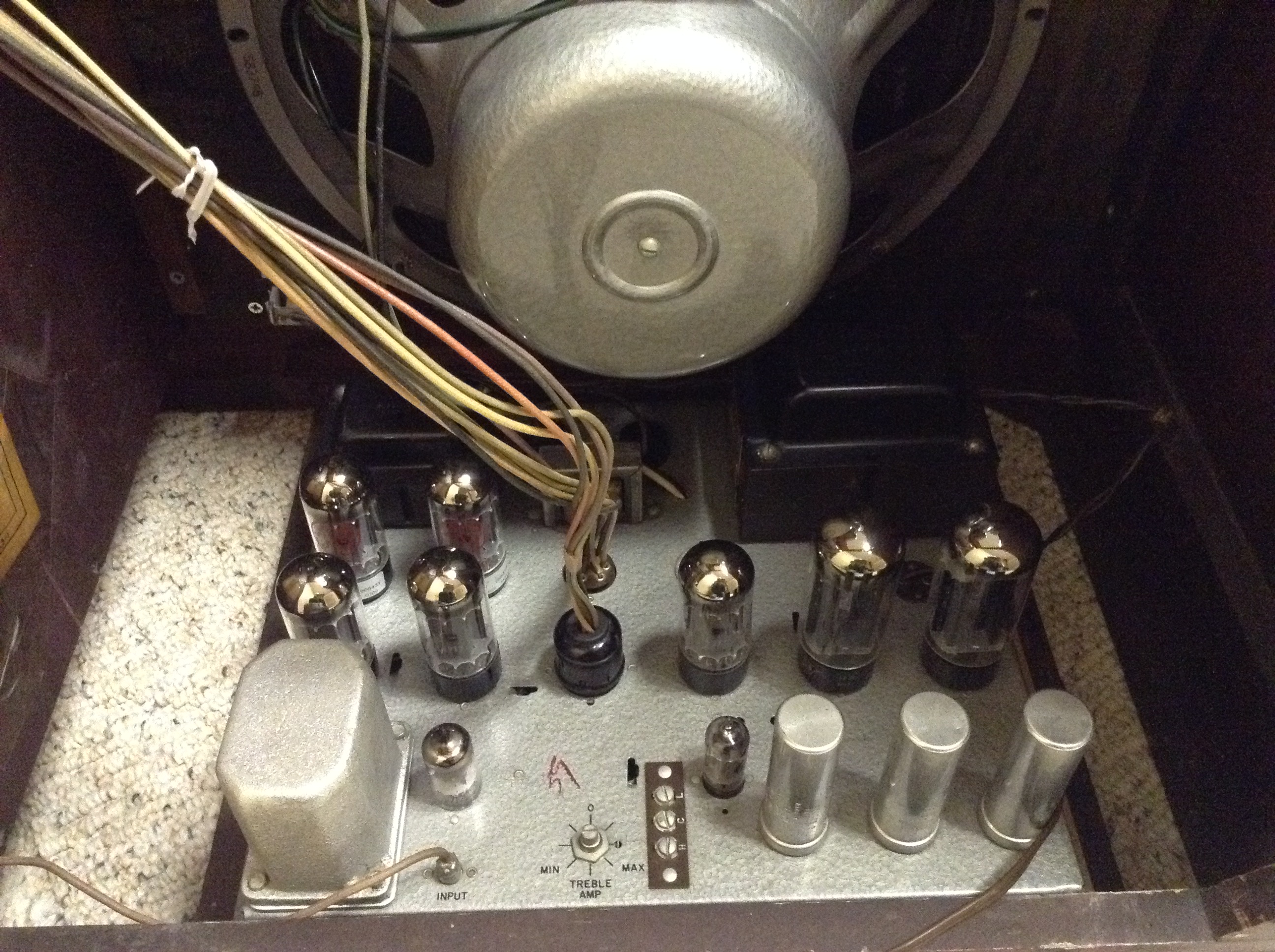

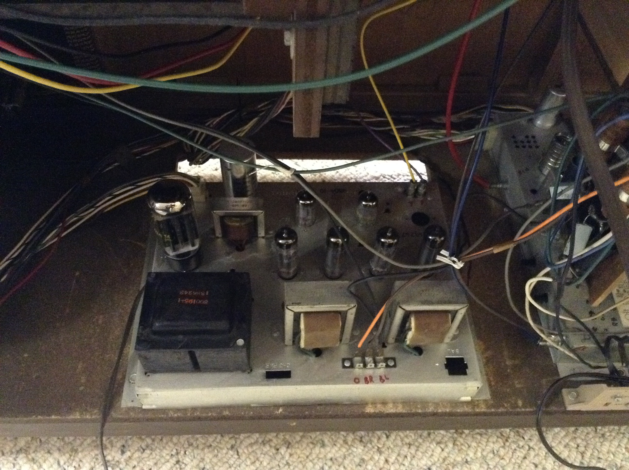

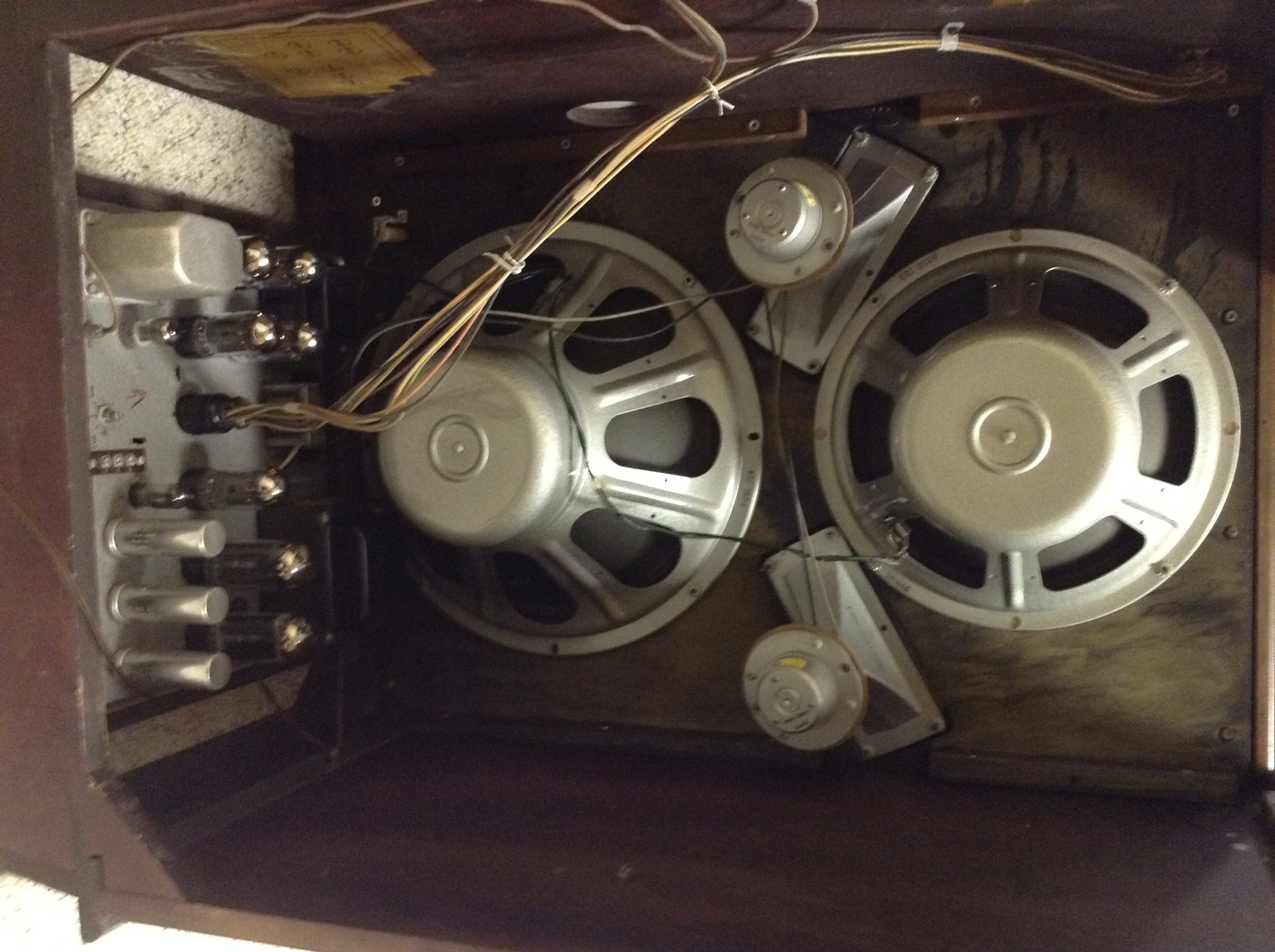

Re: Magnavox amps
Per Rogers request, here are a few photos of the amps that are in two of the three Maggie's I have. The single photo is of the 9300 series in my Symphony. The other two photos is the 150 series amp that is in my Magnavox Berkshire which is a mono unit. Sorry, no photo, at least not yet, of the 8100 series amp that is in my Imperial. It's a royal pain in the butt to take the back off and deal with the weird way Magnavox did their remote speaker hook up. There are all kinds of wires that hook to terminals that are attached to the back.
