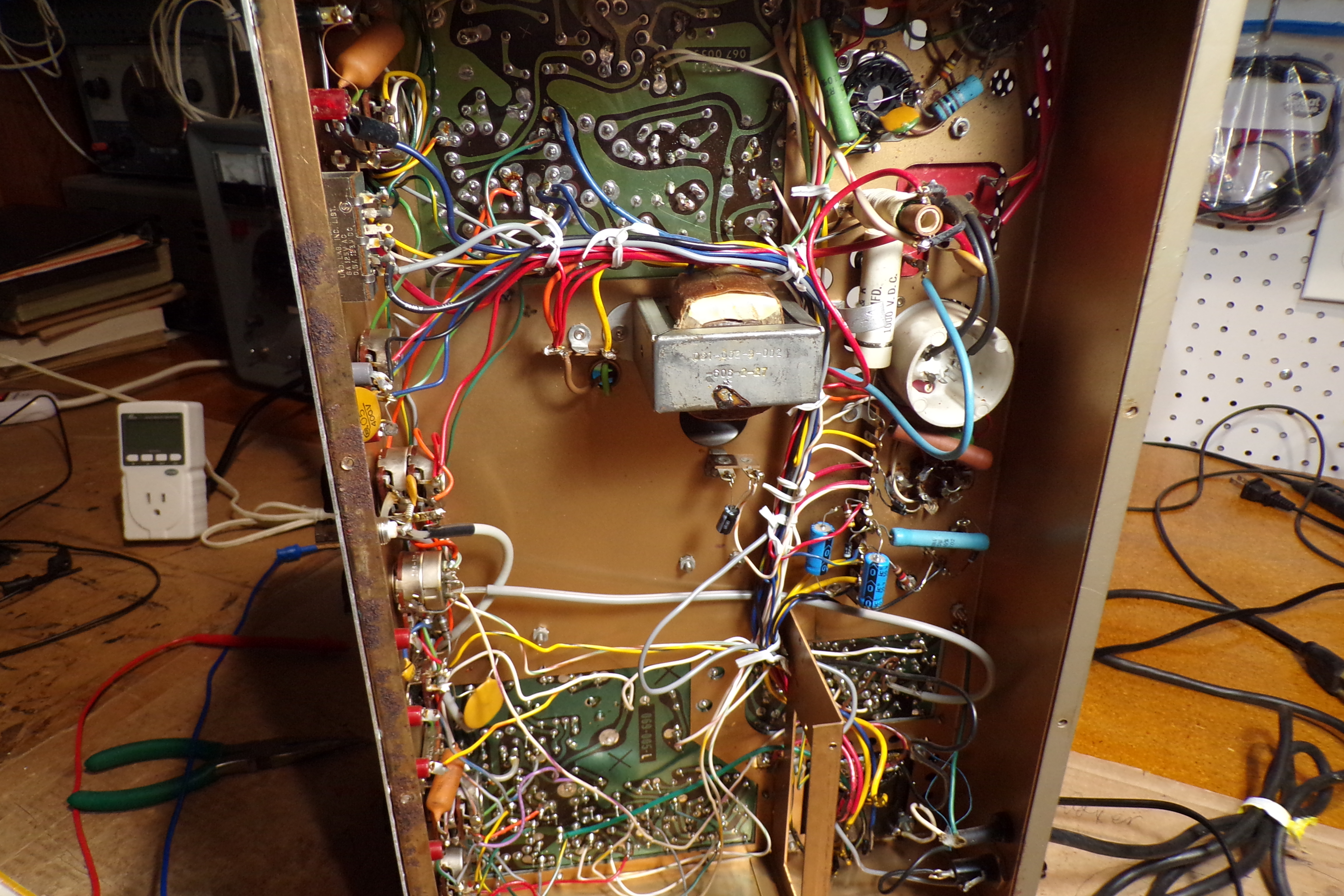

- Posts: 9059
Re: B&K 1077 TV analyzer
I have found that the vertical oscillator is not running. The 13GF7A serves as the vertical oscillator and the vertical output tube. Pin 9 of the tube is the grid of the oscillator which should have -13 VDC on it. It has nothing. There are two transistors ahead of Pin 9, they have no voltage on them, either. I do have B+ on both sections of the tube. I'm running on by Variac and KAW. Draw is 104 watts at 116 VAC line voltage. There is a bunch of caps I haven't replaced and some resistors I need to check, located under the neck of the CRT. It will have to be removed not only to replace the caps, but to check the resistors. I'm getting 75 VDC decoupling boost voltage. I don't see a spec given for it. Anybody have an idea what it should be?

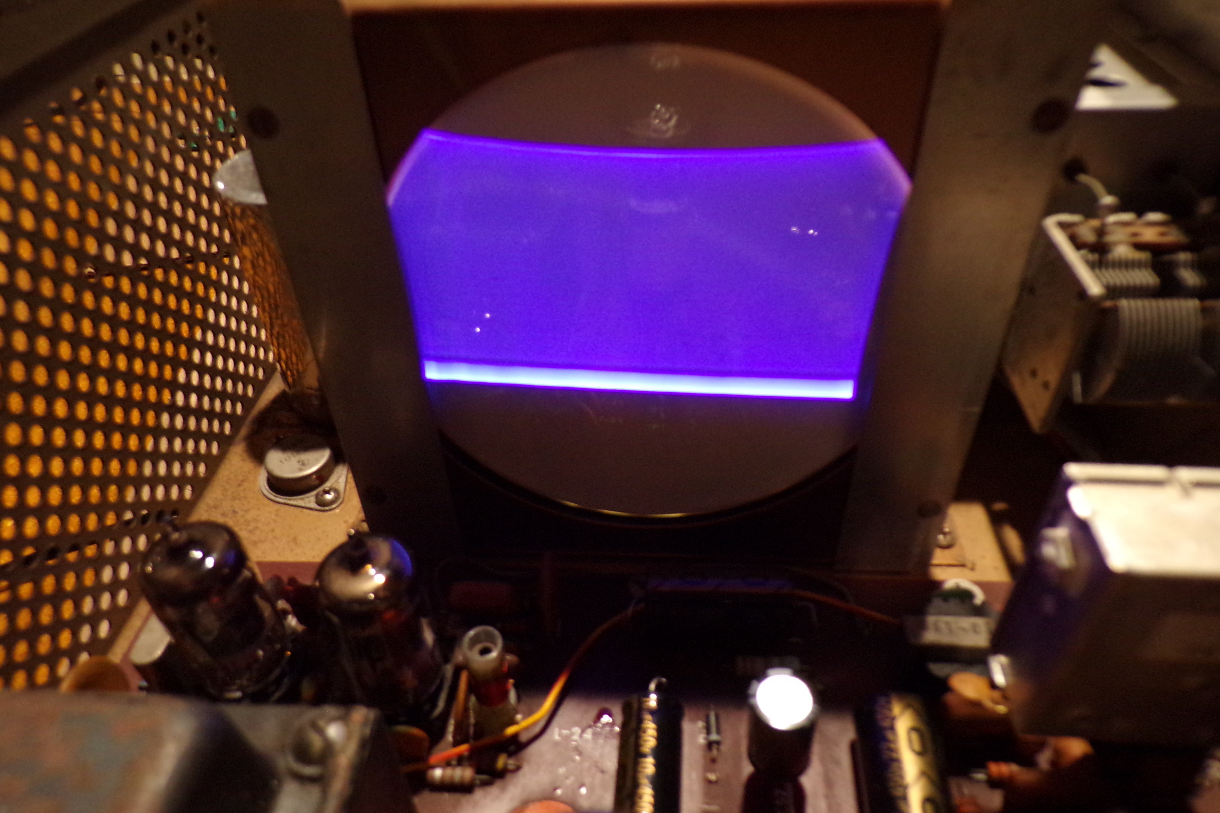

- Posts: 9059
I worked on this thing all day today. It's better, but still not enough vertical deflection to fill the screen completely. The bottom one third of the screen doesn't give any response. Reading online about these things, about all that is left is that it has a shorted turn in the windings of the yoke. Element voltages are spot on, and the vertical oscillator is running now. It has served me well, but I believe we are at the end of the road.

My guess is that if I need a yoke, it probably should be attached to a different instrument.....
The thing that has me thinking about having a shorted yoke is the bright white line at the bottom of the raster. Since that is an ultra-violet CRT, it shouldn't display a bright white line at all. Something is diverting the beam to one spot. Bill made a comment that will cause me to try one more thing, something I need to check to be finally sure. I don't really know how to check a yoke for shorted turns. Looking back at older photos, this thing has always had lazy vertical deflection, but was good enough to be able to use it.

- Posts: 9059
I found this video. My instrument may not be as broke as I thought. The white line may be overscanning. I think I still have a problem, but it may not be as serious as I feared. Stand by.....

- Posts: 9059
Changing the 10uf@ 450 VDC boost filter cap again did nothing. Changing the .1uf @ 1000 volt cap actually did help with vertical deflection, but on the top side. I was able to turn the height control down considerably, which is a step in the right direction. The white line is decreased, and I'm convinced it is vertical foldover. I still don't have the proper element voltage on the plate of the vertical oscillator. I began checking voltages on every connection in the boost circuit. There is a 4.7K ohm resistor with one end connected to the boost filter. There is 450 volts on the resistor, but only 75 volts on the positive end of that electrolytic cap. There is a 1/4 inch long trace between the end of the resistor and the positive end of the cap. That little trace has to be open or compromised, maybe by heat from soldering? Connected to the same point as the 4.7K ohm resistor and the boost cap is a 390K ohm resistor connected then to the plate of the vertical oscillator. The ground lugs all check good, but I may warm them with the soldering iron just to be sure. Stand by......
- Posts: 9059
I don't know what to do next. Every component in the vertical circuit checks fine. I have run jumper wires to make sure there are no bad traces. I wonder if the specs I have for the voltages on the 13GF7 are right. I have 87 VDC on the plate of the vertical oscillator. There is a 220K ohm resistor connected to one end of the 4.7K ohm mentioned before that is not on the schematic and appears to be added aftermarket. I may lift one end to see what that does. I have 405 volts on one end of the 390K ohm resistor, 87 volts on the other. The resistor checks 349K ohms. That seems like a lot of voltage drop for a 390K ohm resistor. There is more than one version of this tester. I wonder if the schematic I have is appropriate for what I am working with. IF one of the 560 ohm resistors across the yoke was open, what effect would that have on the raster? I hate to remove that CRT to check, but where else should I look?
