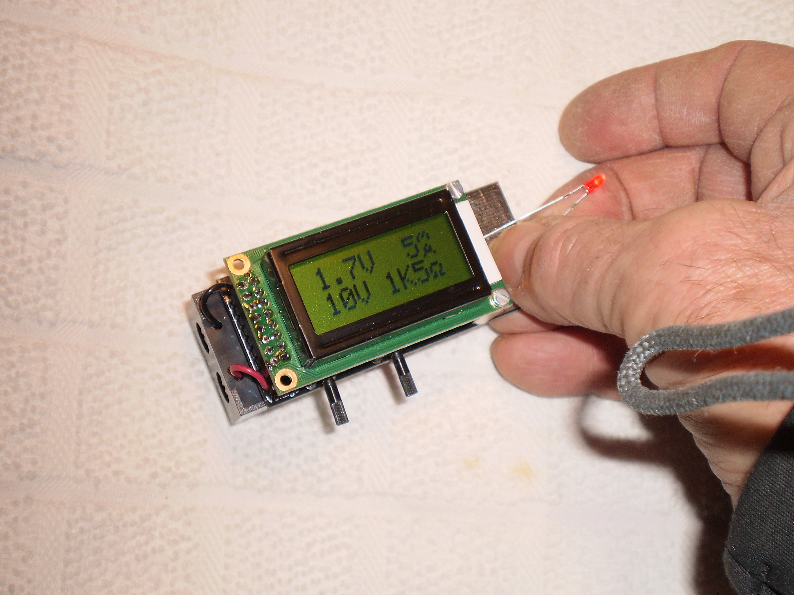

I finished the kit tonight and it works. Here are pix of the circuit board I assembled, and the LCD screen board that was preassembled with surface mount components. There's a 6-inch rule for scale.
Then I put the two sections together. Add a 9-volt battery, turn it on and it greets you with "LED BUDDY" on the screen before saying "Touch LED." I did. First try, it did not show anything, which meant I had the polarity reversed. I knew which was which for this new LED, but with a mystery device, it's either dead or backward. With the polarity right, here's what I got.
It had two little pots, one for voltage and one for current. You can vary both and it calculates the LED's proper voltage and the series resistor to match your E and I. Very handy. It will allow me to use LEDs more readily.

It's not so much to test them good/bad as to test how to use them in a given circuit. Figure out what the voltage is where you want to use them, and it will calculate the series resistor you need for the LED you are hoping to use. It will let you fiddle with current to get the brightness you need. You can see all the data it gave me on the screen in the photo. I set the voltage and I set the current.
I suppose its helpful to know the max current rating for the device under test, but it will let you choose any current, which affects brightness. There are probably limits--exceed the current rating and it will likely die like an incandescent subject to over voltage.
