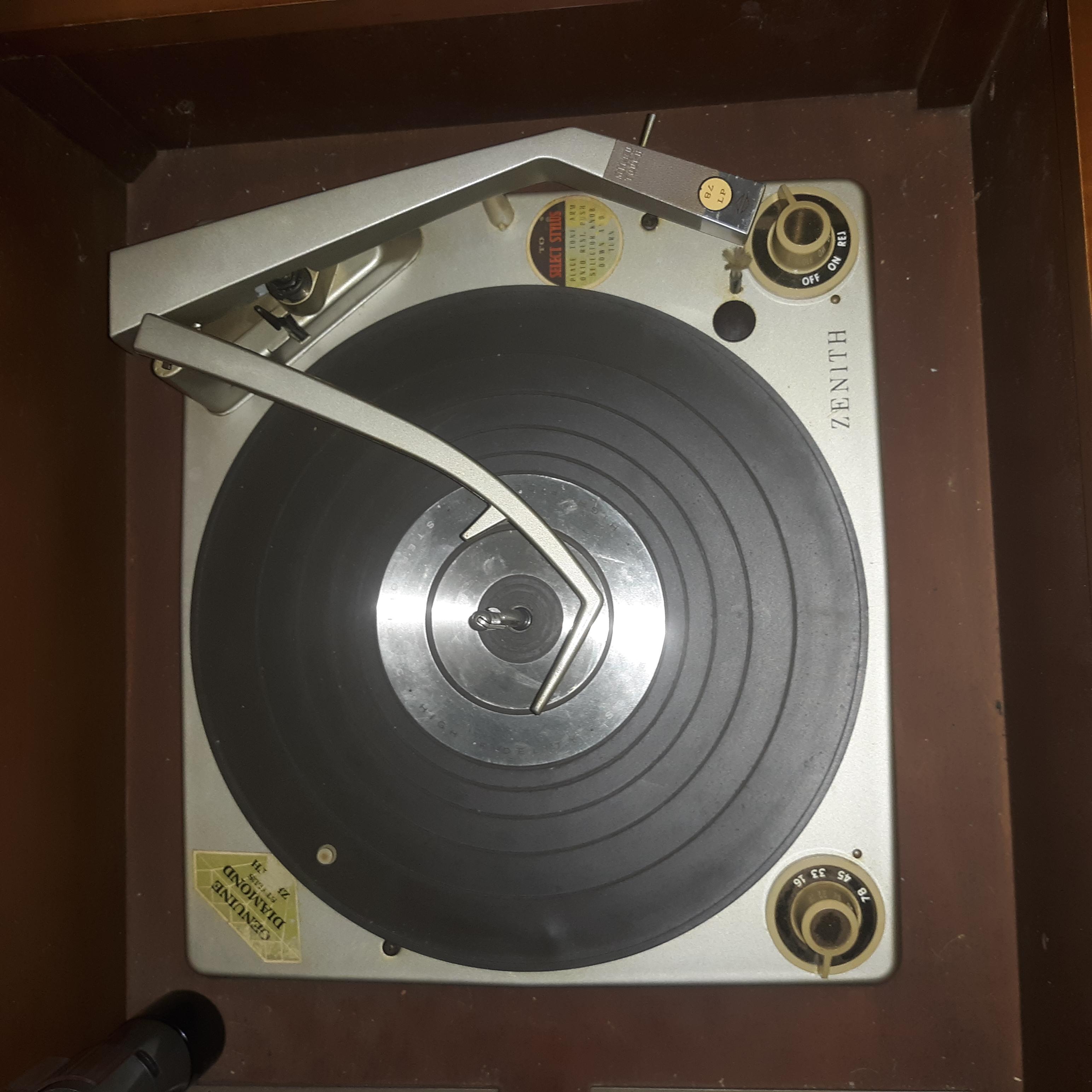

The adapter for my zenith absolutely refuses to drop 45's ... you can hear one side of the record tries to drop but record does not drop... now if I take that same adapter and try it on one of my 1200 series changers it drops flawlessly.... every time.... the spindle on the zenith is pushing but the 45 does not work.... do zenith micro touches use a special 45 adapter?

Elton, can you please provide a photo for your Zenith changer and the 45 adaptor?

Wish I could help with an answer, but my Zenith has the fold up 45 adapter in the platter.

I spoke to Gary about it, he says the adapters like the rest are driven by the actual VM model number of the changer... I use to know which one this was , but have forgotten ... hate to drag it out and pull the back cover just to see what the model is... what I should do is replace it with that VM changer I picked up last week , once again after rebuilding it , the speed is right on the money and the tone arm tracks at 2.3 grams just as good as the zenith, and the zenith table is garbage anyway... it will not play a 45 without dancing all the way across the record ... plays 33's great... not 45's...

that is exactly what the zenith acts like... someone has cranked the anti-skate way up....but there is no anti-skate on it... but only skims across on 45's ... 33's play fine, I have changed the stylus, cartridge, different weight adjustments... etc , nothing worked , Gary @ VM says some tables will not play modern records, but my 45's are all from 50's 60's....?
