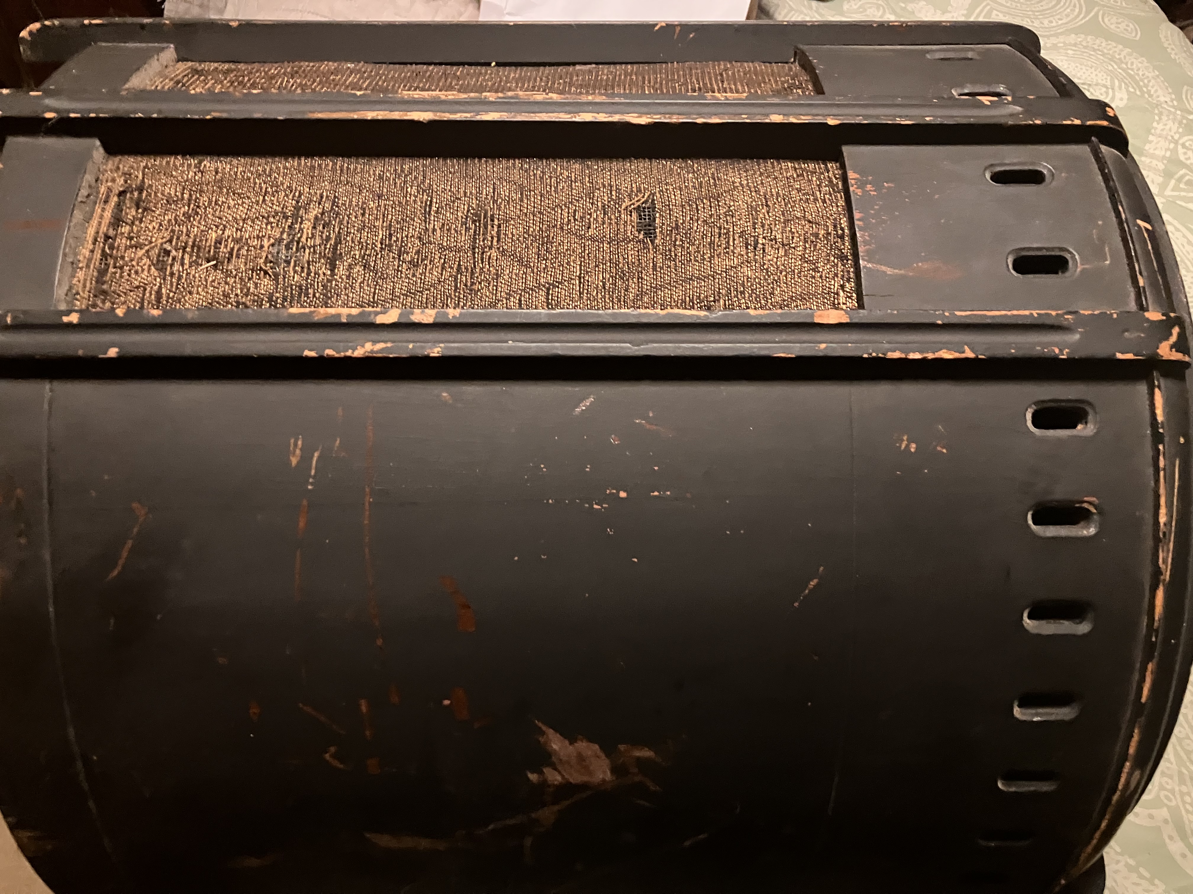

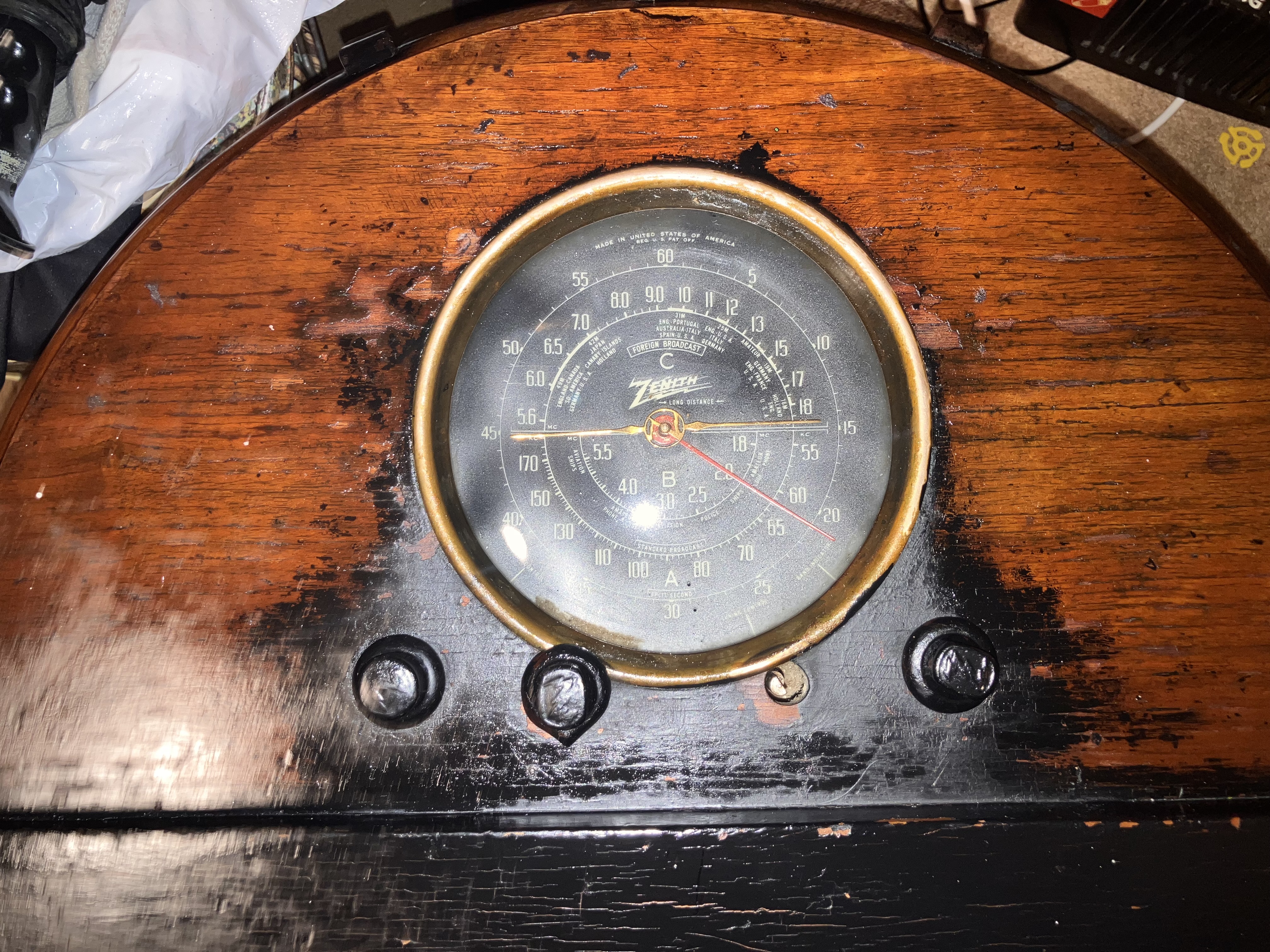

Today I have acquired a 1938 model Zenith chairside radio that’s in kinda rough shape, although I know the chassis can be worked on, the case on the other hand was painted black for some reason that’s now lost to time… and I’m wondering what is good to remove that paint? I am also missing a dial too…

Re: Zenith 6S238: removing a bad paint job

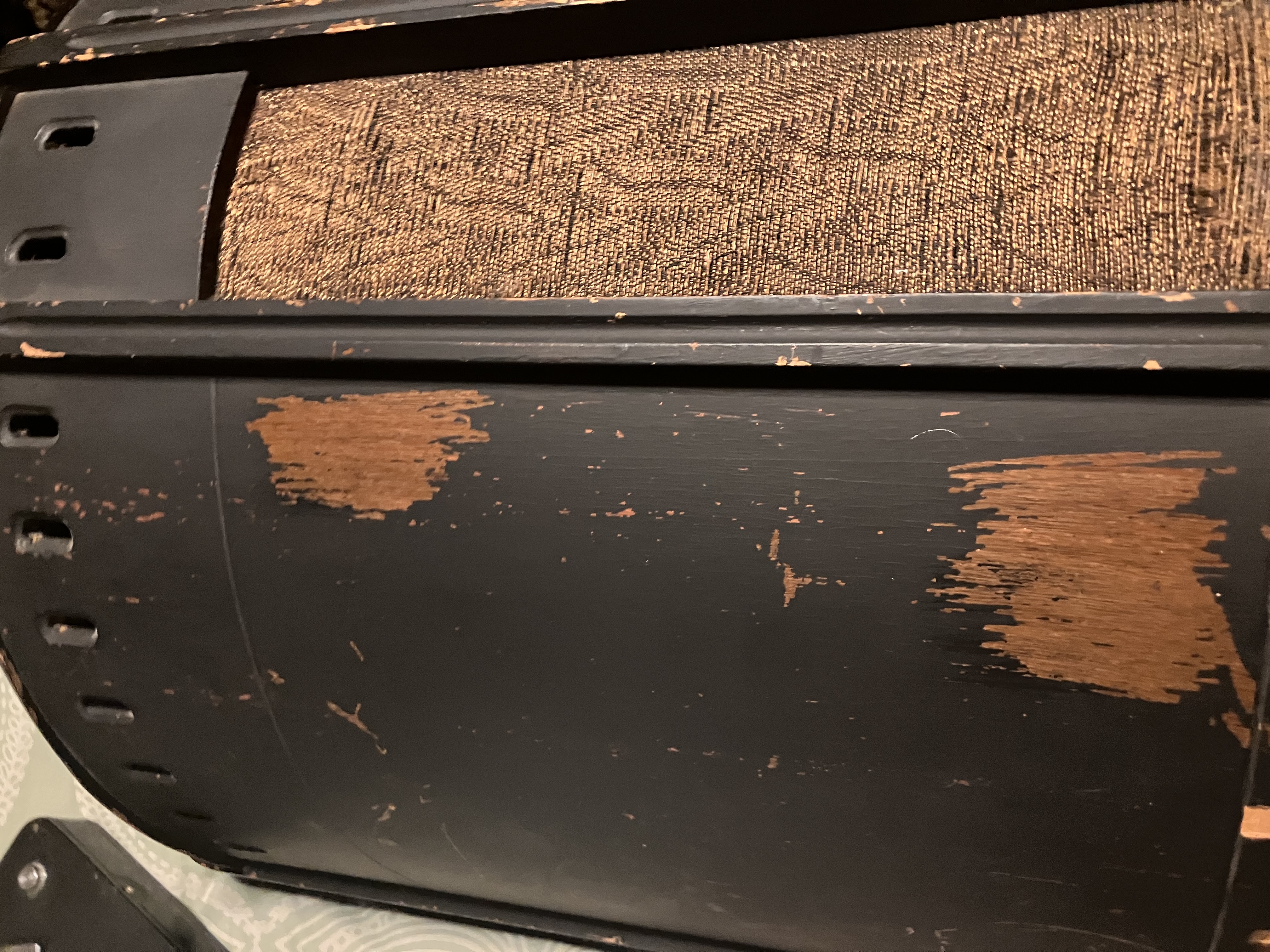

Now I may have solved my own issue. Just plain ol alcohol is making whatever paint this is come off! This may be easier than I thought.

Alcohol? Maybe the black stuff was shoe polish!
Whatever the black finish is was put on over the old lacquer. A 50-50 mix of lacquer thinner and acetone should take everything off down to bare wood, but should also save the stain. Any toner may be lost, however. That cabinet looks really good under the black stuff! Good luck!
Thank you! I have no idea why somebody would put whatever they put on in the first place! Something I'll just never know!.electra225 wrote: ↑Fri Jan 02, 2026 10:59 pm Whatever the black finish is was put on over the old lacquer. A 50-50 mix of lacquer thinner and acetone should take everything off down to bare wood, but should also save the stain. Any toner may be lost, however. That cabinet looks really good under the black stuff! Good luck!![]()

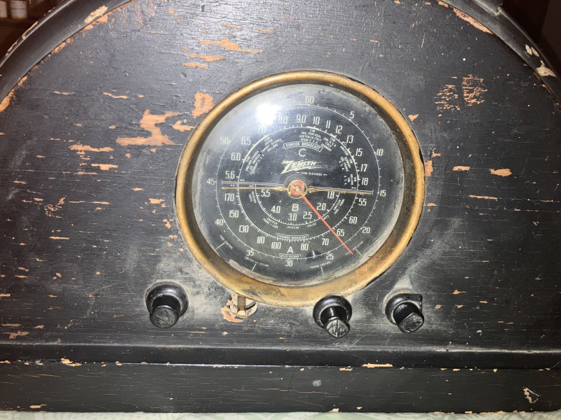

Did some more paint removal…the knobs don’t seems to fit in correctly they are VERY loose. And I noticed a gap between the escutcheon and dial. I’m guessing whoever had it before me didn’t secure the chassis properly? I took a photo of the bottom too.
There is usually a little springy doodad in the knobs that gets flattened out and won't grip the shaft. They can usually be "sprung back" so they grip the shaft better. If not, a hunk of 3X5 card between the spring and the shaft can help the knob to fit tighter.
The wood looks like it's in great shape. That ought to make a beautiful old radio when you get it cleaned and refinished. What finish are you thinking of using?
Honestly, I don't know. I've never truly refinished something as in stripping old finish and putting in new before. I mostly just used goop and 0000 steel wool. All that sanding and stuff I have never done and not sure I even have proper tools for that.electra225 wrote: ↑Mon Jan 05, 2026 1:43 am There is usually a little springy doodad in the knobs that gets flattened out and won't grip the shaft. They can usually be "sprung back" so they grip the shaft better. If not, a hunk of 3X5 card between the spring and the shaft can help the knob to fit tighter.

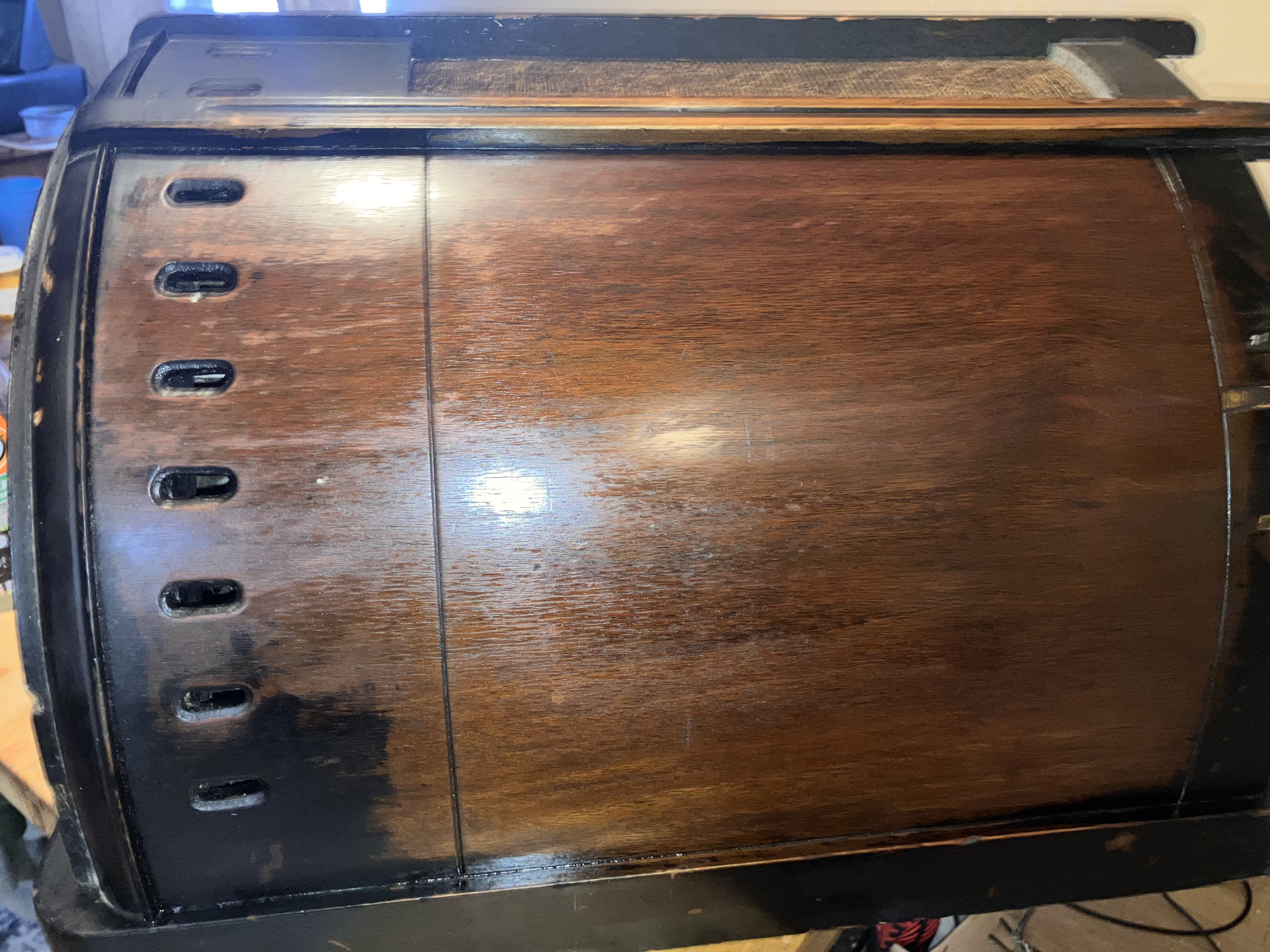

Got more paint off the face of the radio this morning…

When urethane paint finishes became popular, the Model T and model A Ford guys resisted vehemently. They wanted to use nitrocellulose lacquer, which is what Ford used originally. Lacquer shrinks and cracks. It is also easily damaged by almost any compound known to man. Bird droppings, "acid rain" which used to be common in cities when they burned a lot of coal would damage lacquer finishes. Urethane is a lot tougher. The polyurethane we use on cabinets is a cousin of the urethanes used in auto finishes and provide similar benefits. You remember the days when you had to "Simonize" your car every six months? That was because GM used acrylic lacquer finish on their cars. It was pretty, can't argue with that. But it was also delicate. You had to keep it waxed so deposits wouldn't harm the finish as easily. Sorry, Chris, but we will have to agree to disagree about lacquer.
