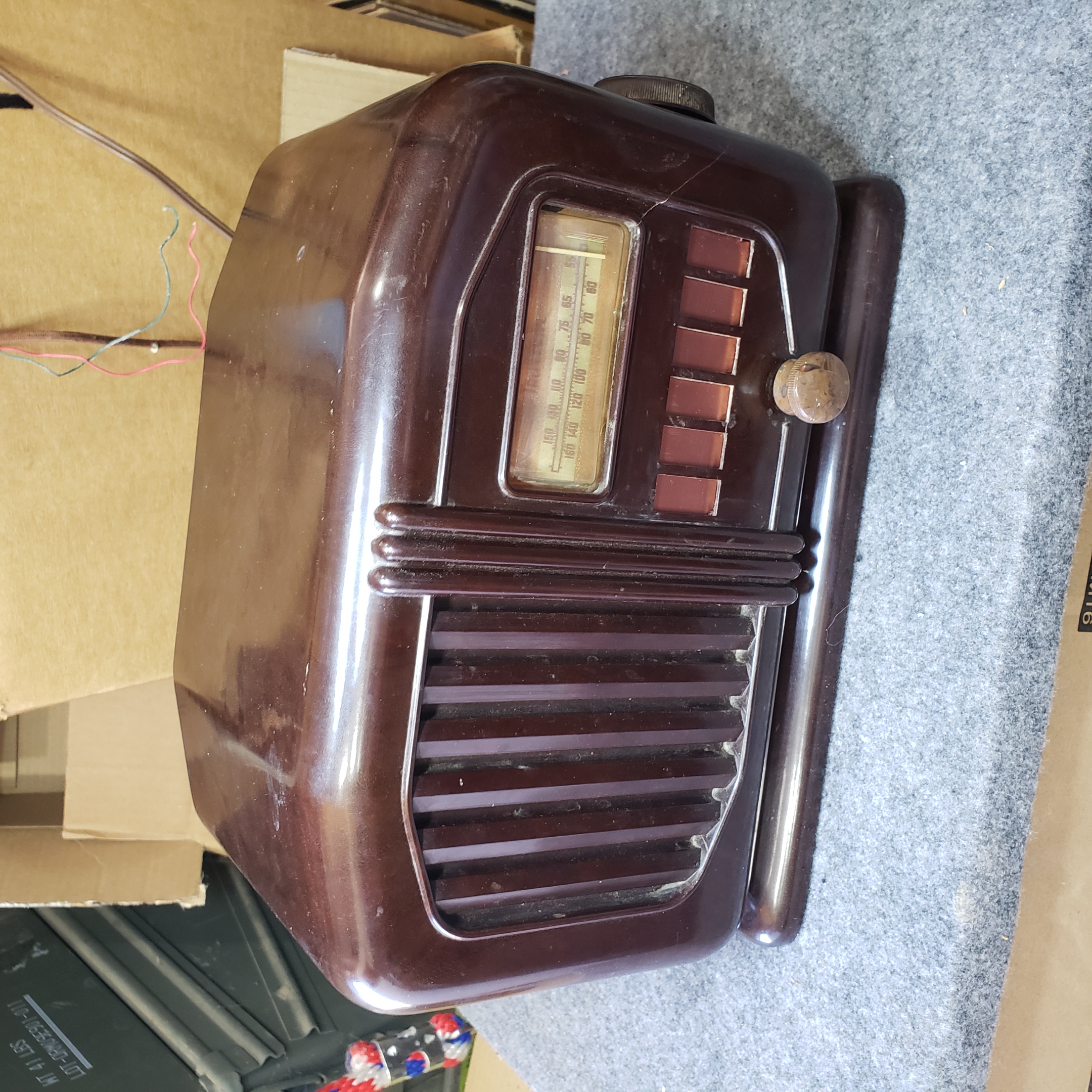

This set was bought by a good client of mine's Mother new in '42.
It had seen a lot of use in her home, and a repair shop at least once in it's 80 some-odd years. Even dropped once and repaired at some time.
I spied it at his home in Flagstaff, and asked if it worked. He said no, so I got him to agree on my getting it going again.

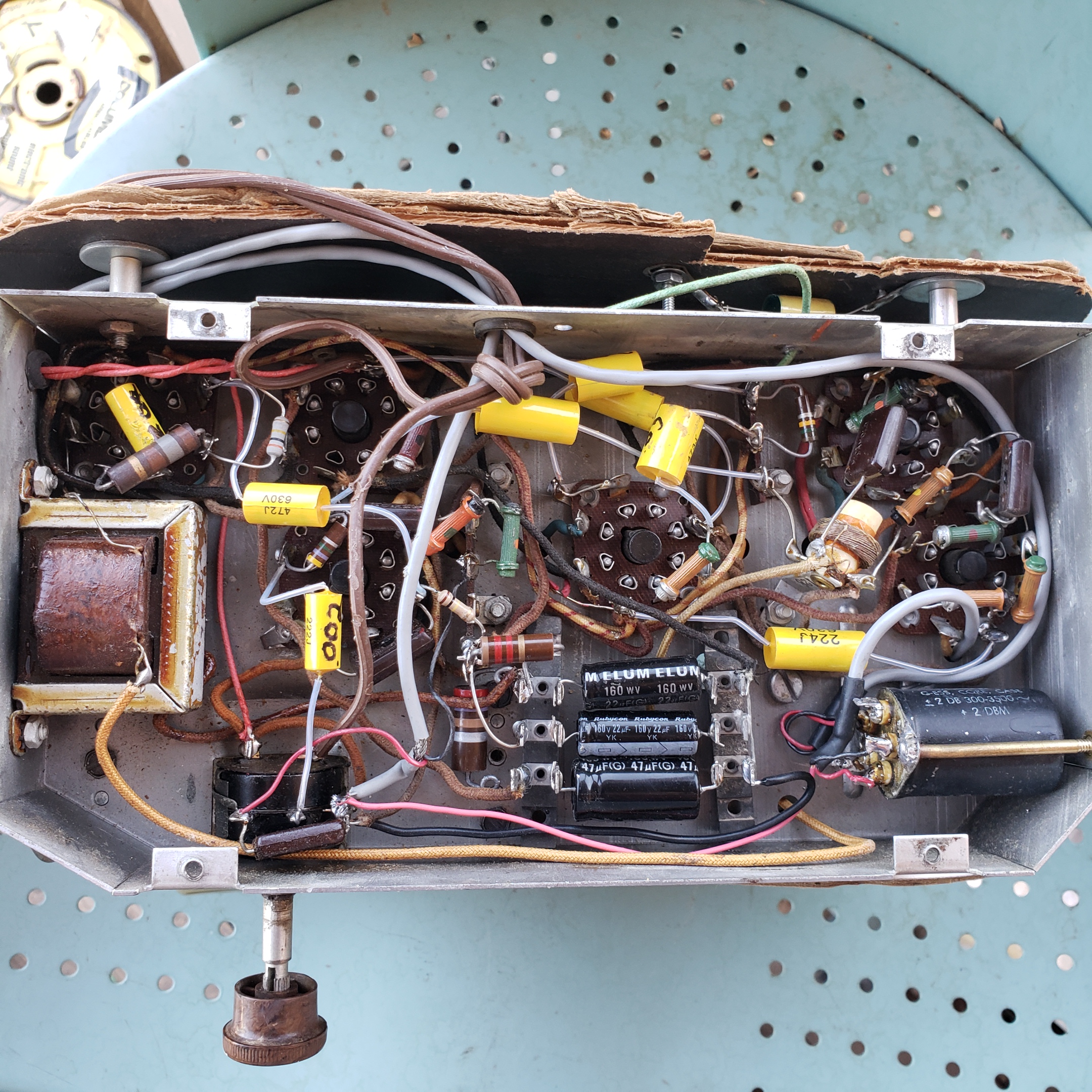

A bunch of caps, some resistors, a couple tubes, and it was working fine. I swapped the 35Z5 for a 45Z5, as that is a easy fix for our higher line voltage today. I deleted the preset mechanism & buttons, as they were frozen solid and unusable. Reproducing the dial scale on our color copier came out OK, as it was beyond hope with wrinkles. Then hours of interfacing a Bluetooth receiver, a 12V PSU, and an audio transformer to isolate the different voltages now into it. Done since there really isn't much on AM in Flag worth listening to.
Now it sounds great on BT, and the AM side is good, if it's in a place without lots of RF noisemakers.

So I see 6 tubes--maybe an untuned RF amp? And Fahnestock clips so you can remove the coil antenna for servicing, instead of letting it dangle until the wires break at the solder joints....

Yep, untuned first RF stage.
Originally, the loop was separate from the chassis, and all the wires were broken or shredded because the cardboard corners failed and it just hung there. It was a good electronic design, with mechanical failures due to age and cardboard usage. Course, they never thought it would live over 80 years: It now plays better than most table sets of the early-war era.
Backed with a piece of heavy fiberboard, and screwed it to the chassis with spacers the loop is stable, without having to worry about that any more. The BT/AM switch is on the back, with a gob of connections as well. BT tech is so much easier to implement than a flea-power TX to play things thru old sets with a cellphone, as it can travel anywhere.
I wish I could get the pix to show right-side-up, but there is some kind of orientation lottery going on everywhere I post them.

Is that a Wells-Gardner chassis? If it is, there might be radios like it with different brands on them. Airline, Coronado, Firestone maybe?

I've no idea who actually made it. Could be WG...

If there was a tube diagram on it somewheres, it was lost in the frey previously. I used Riders data for the job.

Sorry I'm late to the party ; https://radioatticarchives.com/radio.htm?radio=11820 and https://radioatticarchives.com/radio.htm?radio=12670 are birds of a feather. Schematic is https://www.nostalgiaair.org/pdfs/Weste ... -D2615.pdf, z
Sharp eyes noticed a lack of 3-gang tuned RF stage, but this is a better than average receiver
This radio was made by Belmont for W-A and I had one once! The restoration you did was absolutely brilliant as those in the UK would say. The isolated BT input is a very important step.
