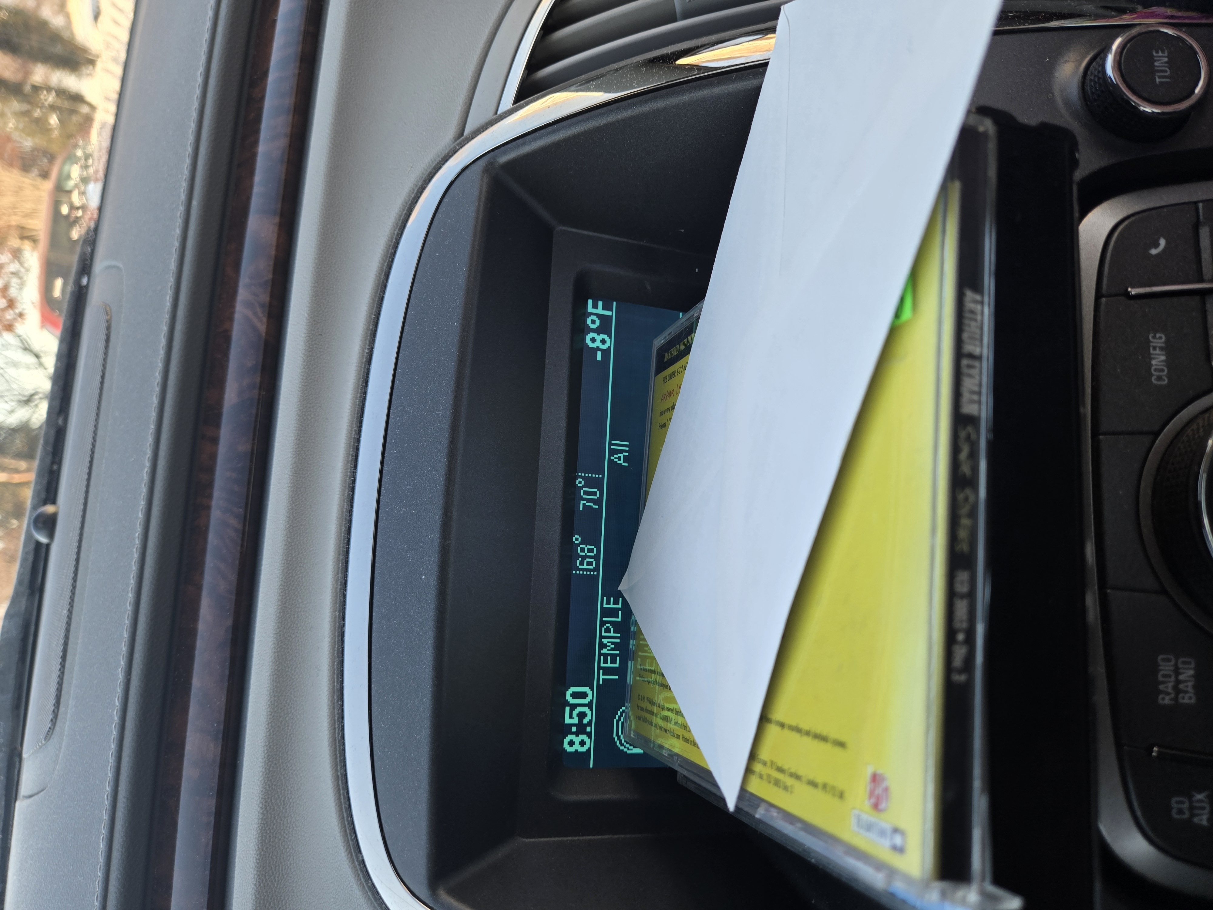

I thought maybe it would get above 20 deg. F. today but it missed by a degree or so. Temps at my house slid below zero one night. Farther inland it was well below zero. The radio morning news guy pointed out "It could be worse--you could be in Wisconsin." They are on the wrong side of Lake Michigan, so they are not protected by its moderating effect in W and NW winds. Here on the downwind side, we are warmer but wow, are we getting lake-effect snow. I shovel the sidewalks and driveway, a.m. and p.m., twice a day. It's continuous, and it's all powder. At least until the cars mush it down, that is. My city, which used to be quite adept at snow removal, seems to have forgotten how to do it in the age of climate change. Between the mushy streets and cold temps, I have not been biking to work. The nice red truck starts happily and reliably even below zero. Driving is slow and the snow muffles the noise. All of my coldest-weather clothing has been deployed. I decided to walk downtown to an MLK Day concert at the City Opera House so as to avoid parking hassles. It's only about a mile away. It was 5 deg. out but the right clothes made the walk comfortable and I got some exercise.
