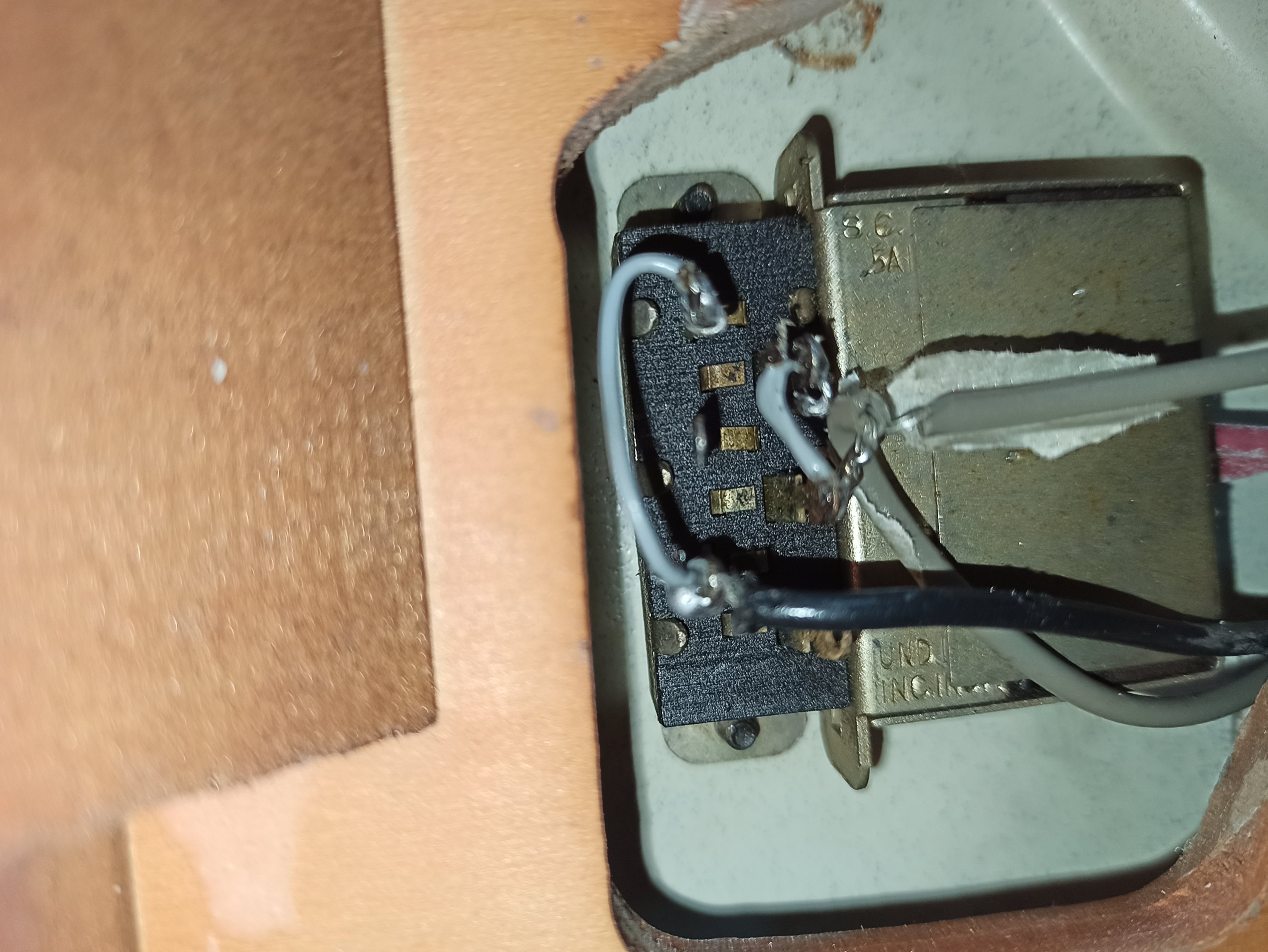

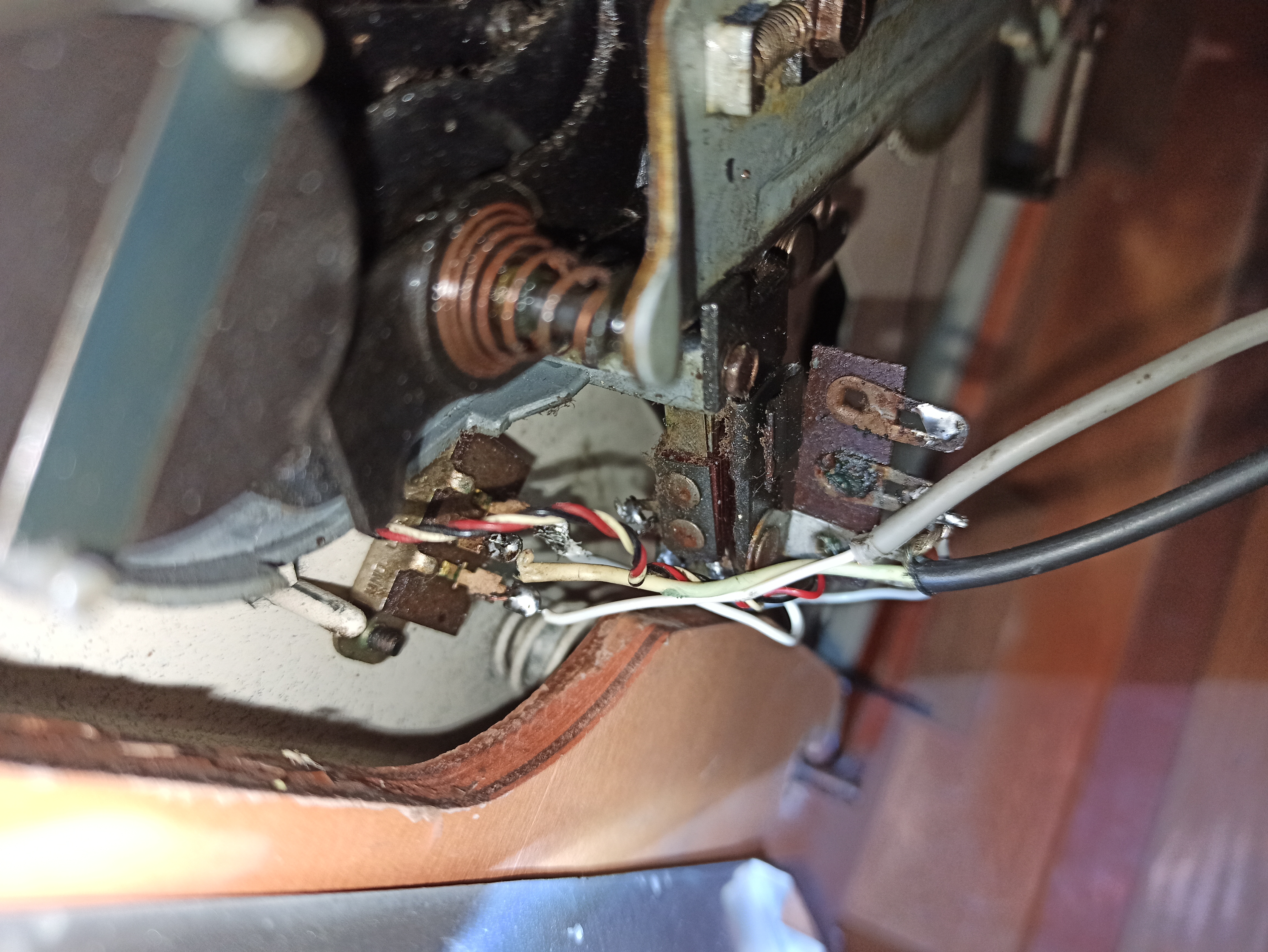

Here are two photos of the switches I took from the bottom of the record changer, without removing it.
The red-white-black wires on the Mono/Stereo switch seem to be the ones coming from the cartridge.
Will try to trace each wire and post more details soon.

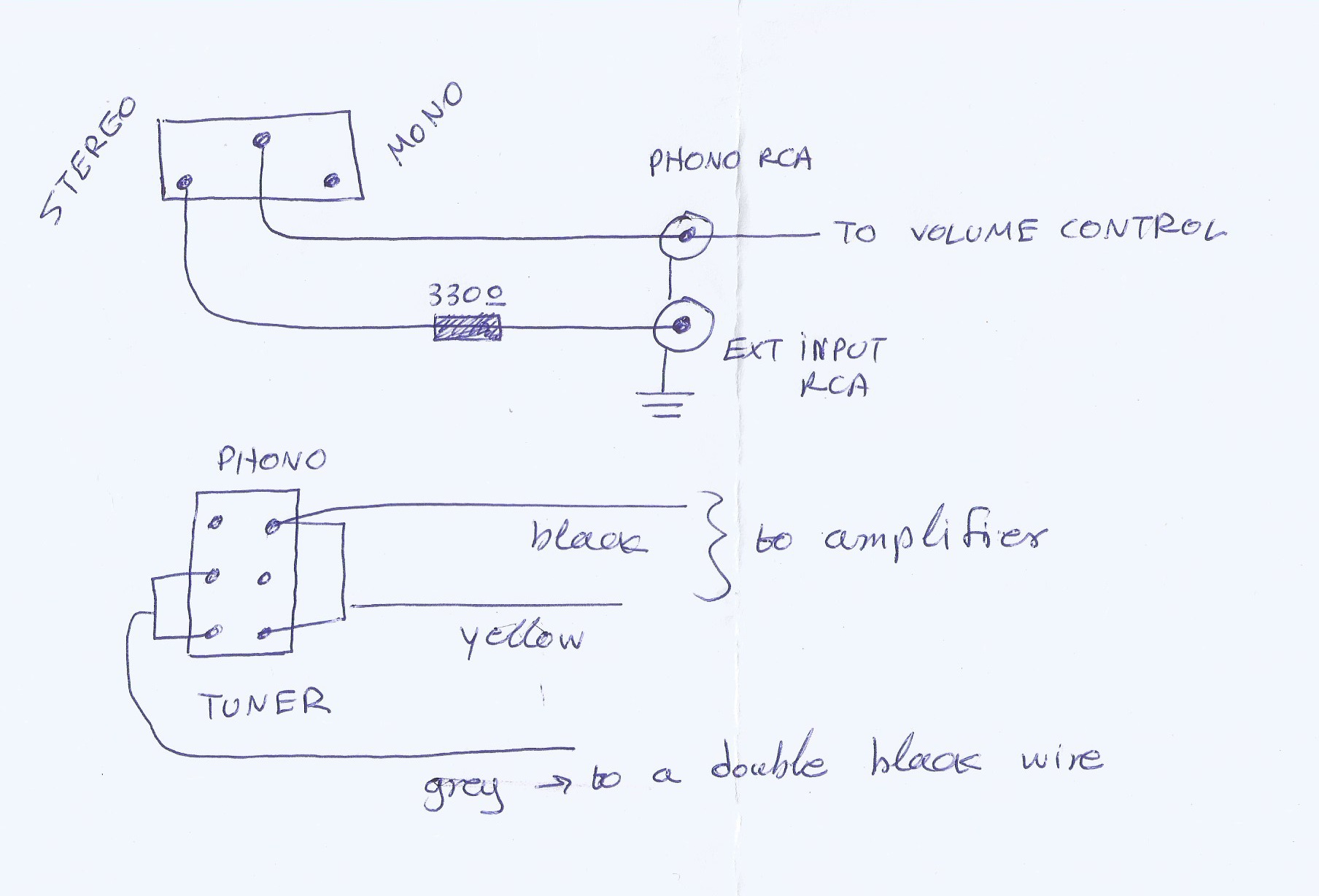

Here's a draft diagram of what I managed to see.
Will try again tomorrow with daylight...
- Posts: 5460
Re: VM 570 Mono/Stereo switching
I am sorry to tell you Andreas, but that is not wired correctly. The tuner/phono switch is definitely wrong and the photo of the mono-stereo switch is to congested to see what he did. Your diagrams are good, just not right. Since my camera and iPad are both old school they no longer work with the forum so I can not provide a photo, but I can send you an email because that seems to still work with my computer. When you get a chance try and take a few more photos of how it is wired and then I will explain how it should be wired.

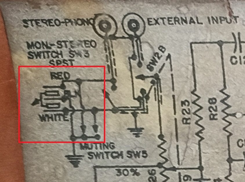

The way I suppose it should be wired is that the three wires from the cartridge (the part in the red rectangle in the attached image?) go to the Mono/Stereo switch. Suppose Black is GND, and white and red are Left and Right.
In the Mono position, L and R channels are combined and connected to the amplifier.
By the way, are they just connected together? Would it be better to use a simple circuit like this? https://content.instructables.com/FWE/X ... o0MDowMi4w
In the Stereo position, one channel goes to the amplifier and the other goes to the external speaker connector (is it the two-pin connector at the side of the amplifier)?
Is my understanding correct?

Hey Andreas. What ever your guy did he made a mess out of it. Of course, maybe someone else was there first and he only followed what they left behind. Anyway, in order for it to work as VM had intended you will need to reconfigure all of it. Please give me a few days and I will email you a diagram of how it should be wired at all points. You will need to remove the changer to make the correct changes and you will need soldering tools. Stay tuned.

It is not hard, and since it is wired all wrong I will walk you through putting the wires where they belong but I will probably need a few more photos once the changer is out. Once I see those, this is to make sure that wiring is not messed up, I will be able be able to walk you through it.
