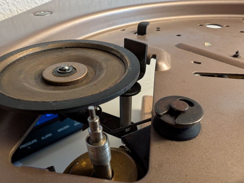

After accomplishing that work, it still had issues. For one, the turntable would stall or slow down during a cycle. I found that the 10" sensor leaf spring was bent and dragging a bit on the changer base, but after fixing that, stall was still present.
10 inch sensor leaf spring
10 inch sensor.jpg (33.58 KiB) Viewed 81333 times
