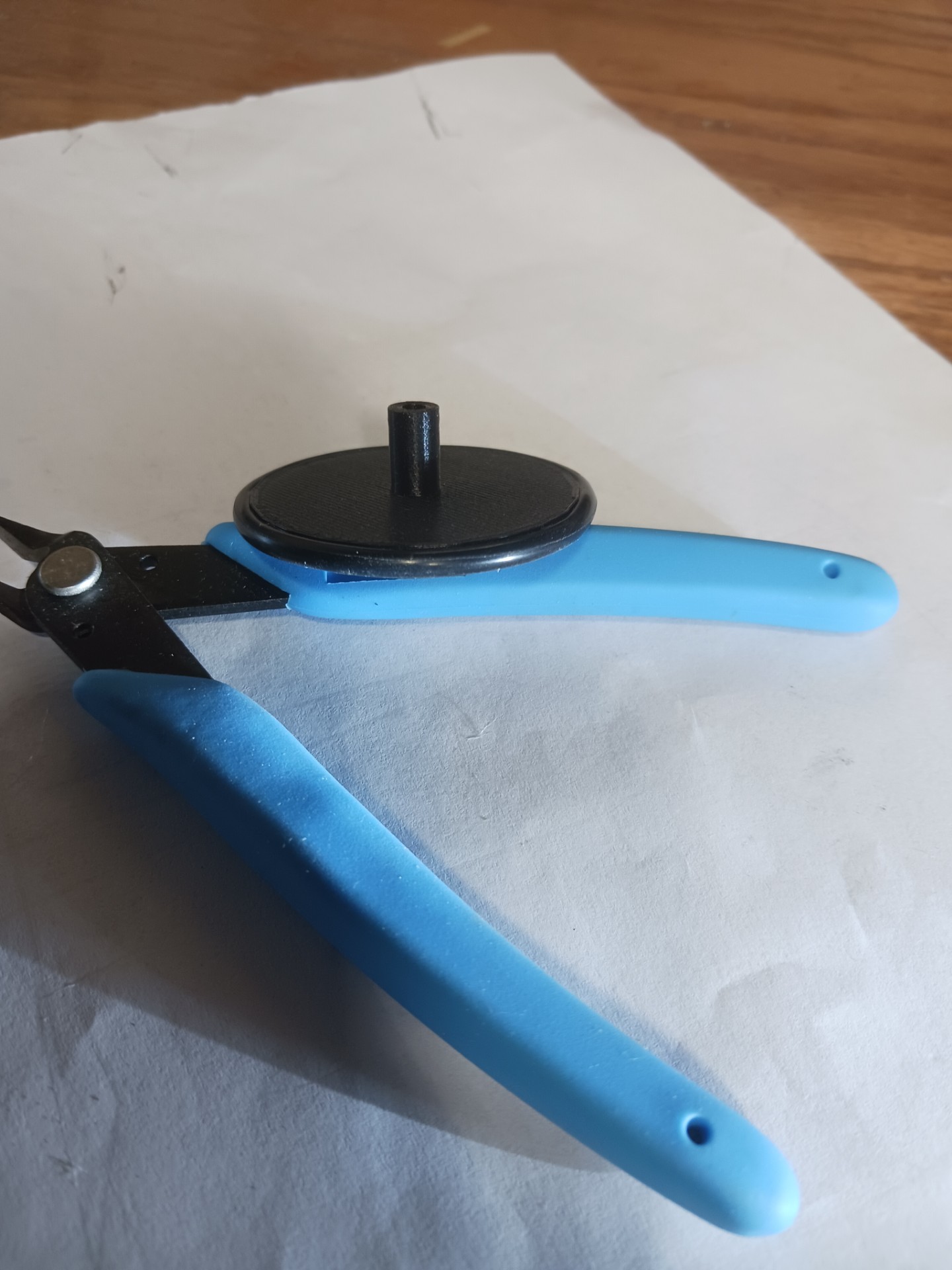

Ah yes ... the bane of all VM changers... the idler wheel .... wintergreen and alcohol does give you a temporary fix but it will harden up again... but I can't blame you ... with the increase in prices for them and if it will be mostly a shelf queen, the price is not worth the repair ... I have been messing around with the 3D printer and made one with a rubber O ring to drive the platter, and it works ... but all I have is PLA plastic, I guess the better stuff for an application like this would be the PET plastic ... still experimenting ...

PET plastic is supposedly made for rough applications... supposed to be of the same type of plastic they made gears out of for VCR's transports ... but I think a brass insert would be easy enough to make for a plastic idler... I am a long way from giving Gary @ VM any competition on them...stbasil wrote: ↑Sat Jan 18, 2025 5:12 pm Yep, the wintergreen trick doesn't last very long. The dent never worked itself out, probably was burned in, and it was evident by a regular thumping in the bass. I removed the wheel and noticed that it was hardening up again, but it still ran without slipping. I sanded down the dent with a flat piece of 220 grit sandpaper by mounting the wheel in a drill press, making sure it ran true. Also cleaned the motor spindle steps with emory paper. No more thumping; the speed and wow/flutter is still good.
Neat trick using a 3D printer! I guess you intend it as a low-hours part, since the "bearing" is just a hole in the plastic (unless you figured out how to put a brass insert in!)
Re: VM 1245 for my Motorola SK-111 console
They are cool.... when they work right... setting them up to print is a exercise in patience .... the plastic injector nozzle has to be perfect across the whole hotbed about .01mm or the thickness of an ordinary sheet of paper , or the foundation layer will not stick to the hotbed and it will fail... then you have to find tune the temps of the plastic and the hotbed usually the nozzle is 200 C or around 390 F ... hotbed is around 60 C or about 140 F ...since the printer is in the basement , the temps are below 70, so I have an enclosure to retain the heat , otherwise jobs will not stick to the bed , they are that finicky ... basically a 3D printer is a fancy hot glue gun, but uses plastic instead of glue , I was given mine from my son... glad I didn't buy it... a few times of trying to get it to print right I got so frustrated I felt like reenacting the scene out of office space with the fax machine and a baseball bat in the field ...

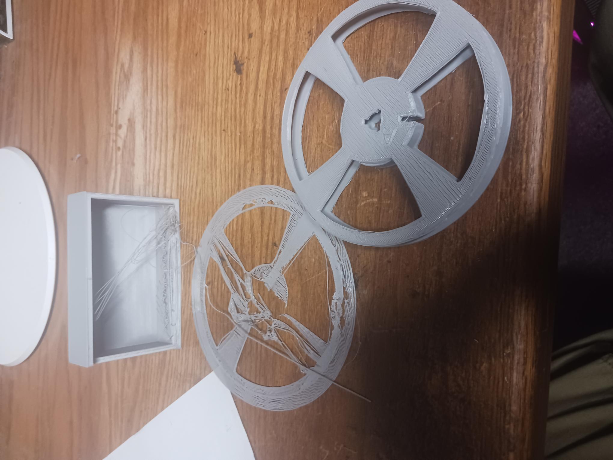

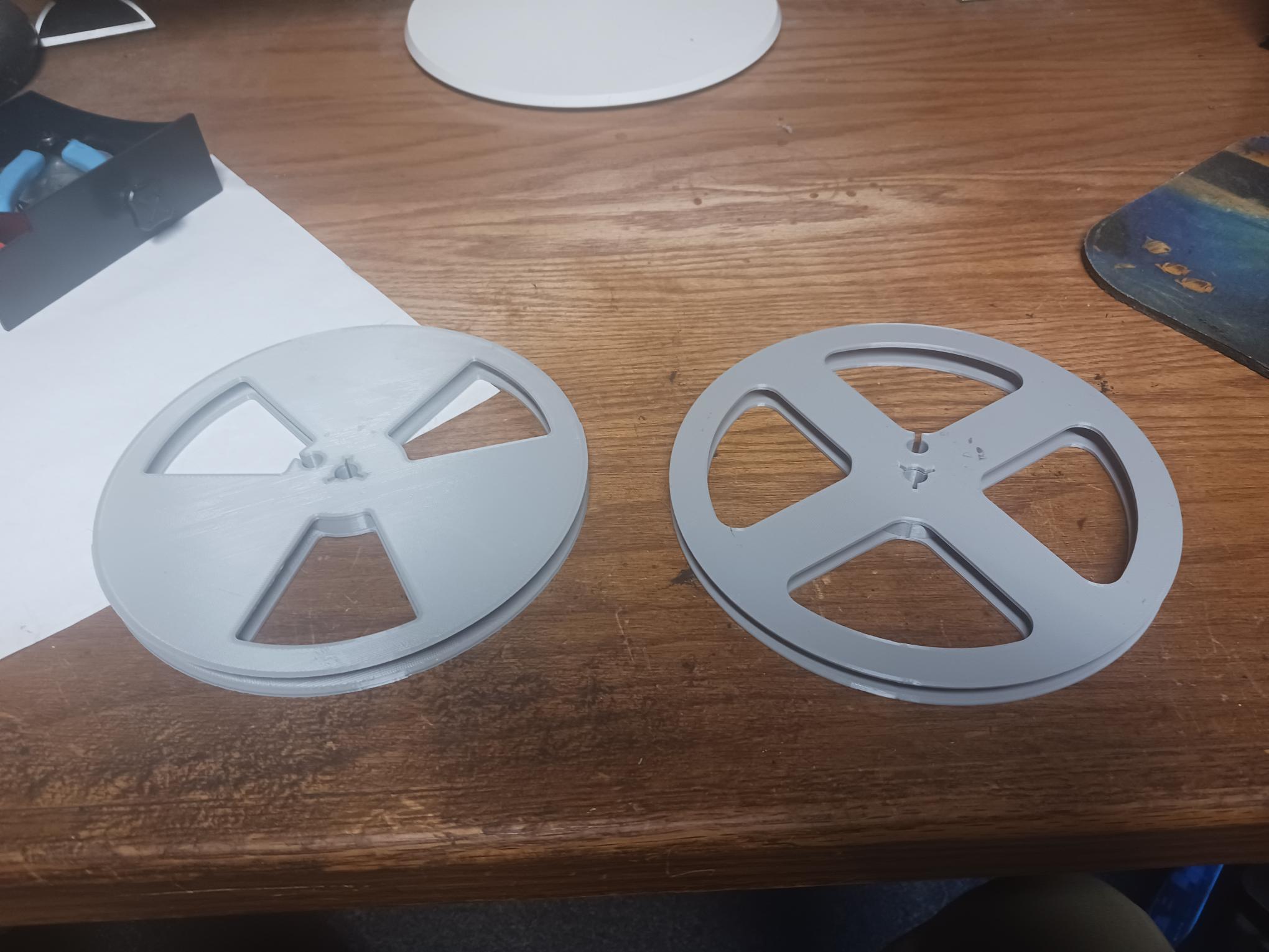

here is an example of when the printer works.... and when it doesn't .....printed up some reels for the R2R... some came out great ... others not so much, the half reel is an example of when the foundation layer fails to stick to the bed... also the box in the picture failed right at the end of the print which takes about 3.5 hours
