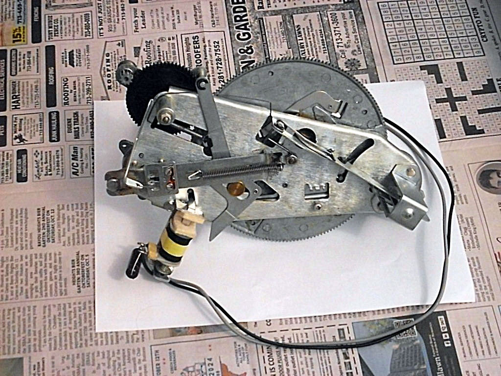

Hello all,
Well, here's my latest never done before item.
Young guy brought me this changer with the
remote solenoid from a 1966 Magnavox
Imperial 1-ST694 with the remote control.
The console cabinet looks nice.
I found some fascinating reading on how these
different remotes functioned.
The solenoid looks simple to remove, but I'll
find out if I HAVE to remove it, once I start
the sub-plate removal process.

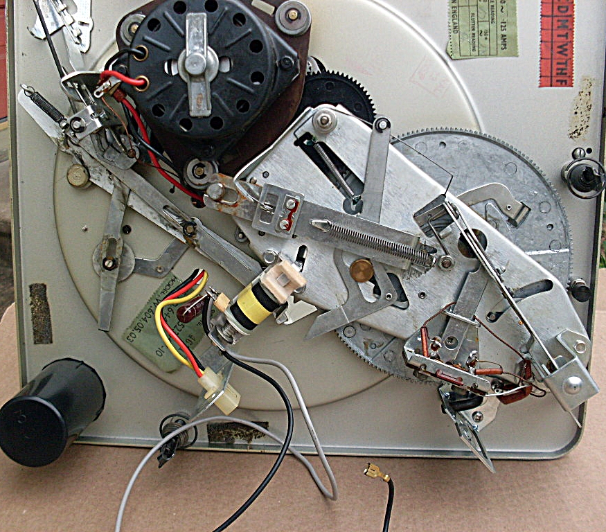

1. Preliminary check out had me notice that one
channel of the P-156 cartridge was kaputski.
I did some continuity checks on the tonearm leads
and they were all good.
When I looked under the changer, I remember I had
earlier noticed that a tonearm lead looked out of place
around the mute switch.
It was not only out of place but it was shorting signal
to the changer base.
How in Hades had it got to that location ?
2. I powered up the motor, and BOTH the idler and
drive wheels work well. A nice surprise.
The motor has some gunk in the bearings, as it
took a minute or so for the speed to come up to
appropriate RPMs.
appropriate RPMs.

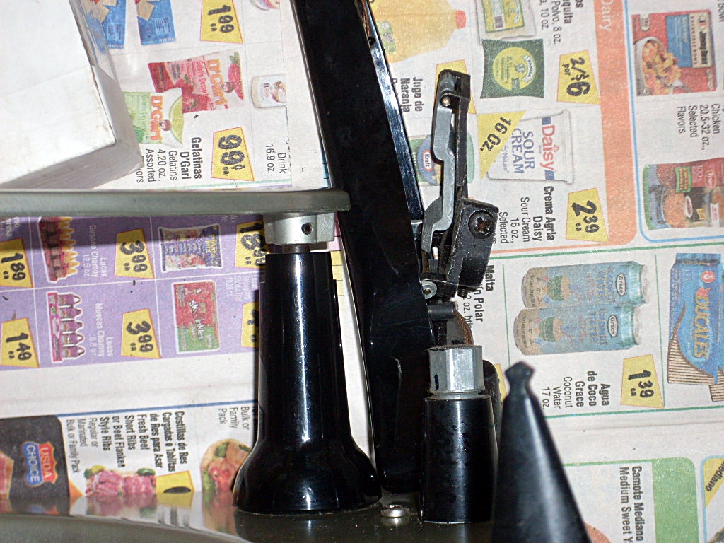

Getting into the dis-assembly of this W604, I noticed
some changes from the earlier W600's I thought to
mention for others servicing these changers.
The tonearm in this 1966 model is secured onto the
tonearm mounting bracket from the side with
a Phillips head bolt.
You must mark a reference line on the pivot
mount to line up with the split on the tonearm
mount.
Earlier W600s had an external hex nut and a
keyed bracket, so you could not make an error
when remounting the tonearm.
The photo shows tonearm on its side and the
black line marked for reference.
mount.

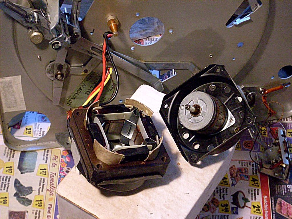

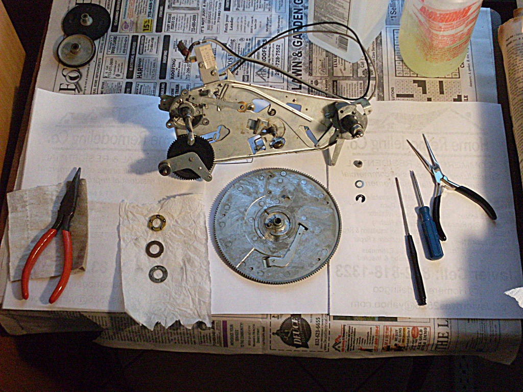

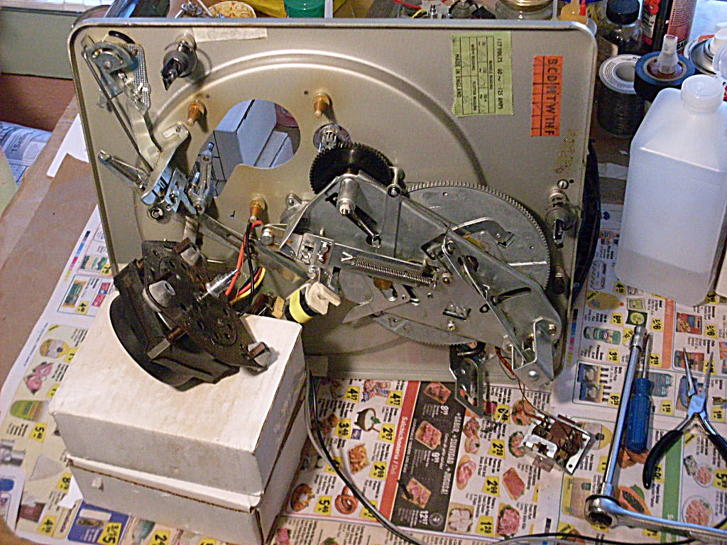

- Posts: 1364
Re: Magnavox W 604 with Remote Solenoid
Just about finished with this changer.
I did not have to remove the solenoid from the
sub-plate assembly.
As I posted previously, the motor needs to be pulled
off the mount pegs first, to allow removal of the sub-plate.
Not a great amount of original lube to clean off
of the linkages and the cycling mech in the
sub-plate.
The motor rotor not too dirty, and zoom spout
turbine oil applied to bushing reservoir after
cleaning.
I have to re-assemble the mute switch.
I'm waiting to re-mount the tonearm until I
receive the new styli for the cartridge.
sub-plate assembly.
sub-plate.
cleaning.

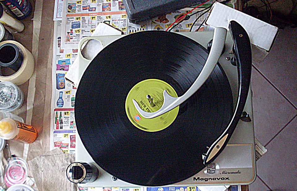

This one's all done.
Idler and drive wheels back in, and a
new stylus.
Playing like a Collaro should !
new stylus.
