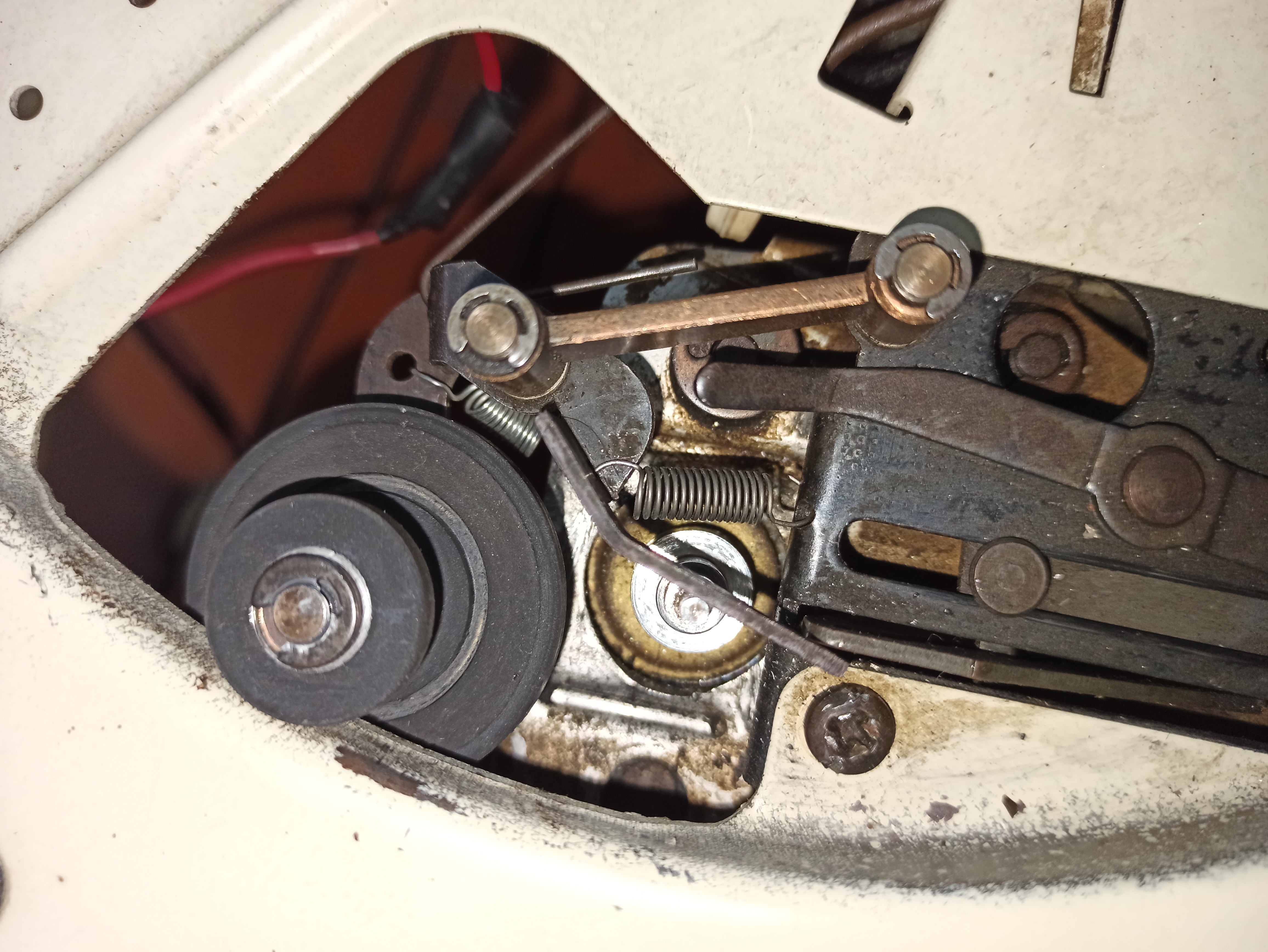

Ok, just removed the plate.
Placed a photo and video here:
https://drive.google.com/drive/folders/ ... sp=sharing
Shouldn't the idler wheel be in contact with the record speed selector/shaft?
The motor mounts were not replaced, as far as i know.
Anyway, I pushed the idler wheel a little so that now, when I turn the switch to the ON position, it comes to contact with the speed selector and turns normally.
Uploaded a video and photo of that one too.
It seems that the problem occurs if the OFF-ON-REJ button is turned counter-clockwise, i.e. before the OFF position.
Now I must manage to put the plate back in place to test it :-)

A picture of the bottom side of the changer may lend a bit more information. Sounds to me like a linkage is sticking. Is that white grease I see on the drive tire, under the clip that holds it on? That doesn't look right to me. I'd like to see the motor mounts. Some changers have a feature that removes the drive tire from the motor shaft and the platter so the drive tire doesn't flat spot when it's not running.

Doesn't look like grease - if I understood about the location correctly...
Posted a couple of photos of the bottom side of the changer in the same google drive folder.
Hope they help!
- Andreas

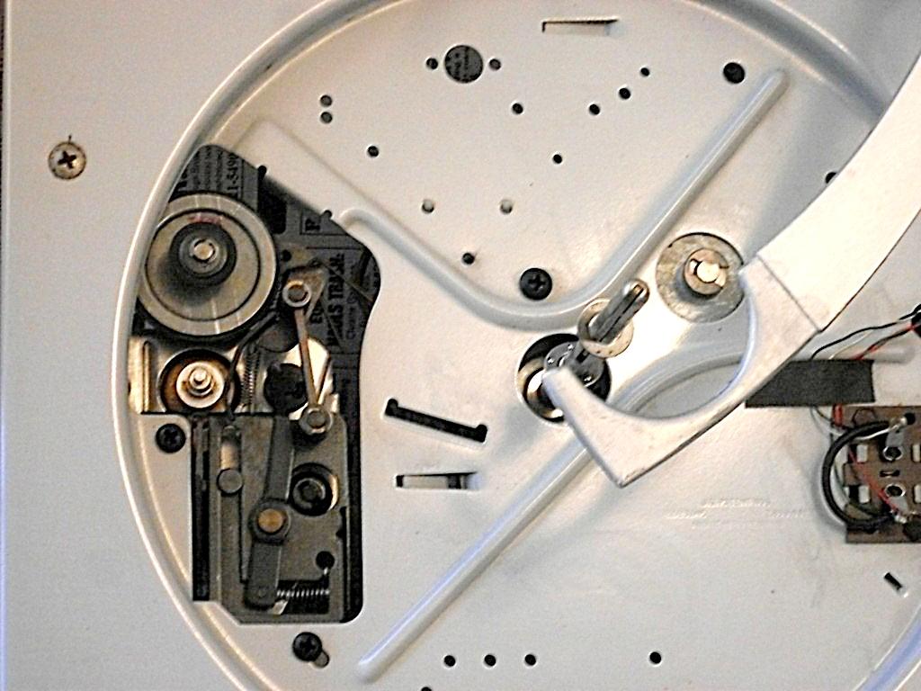

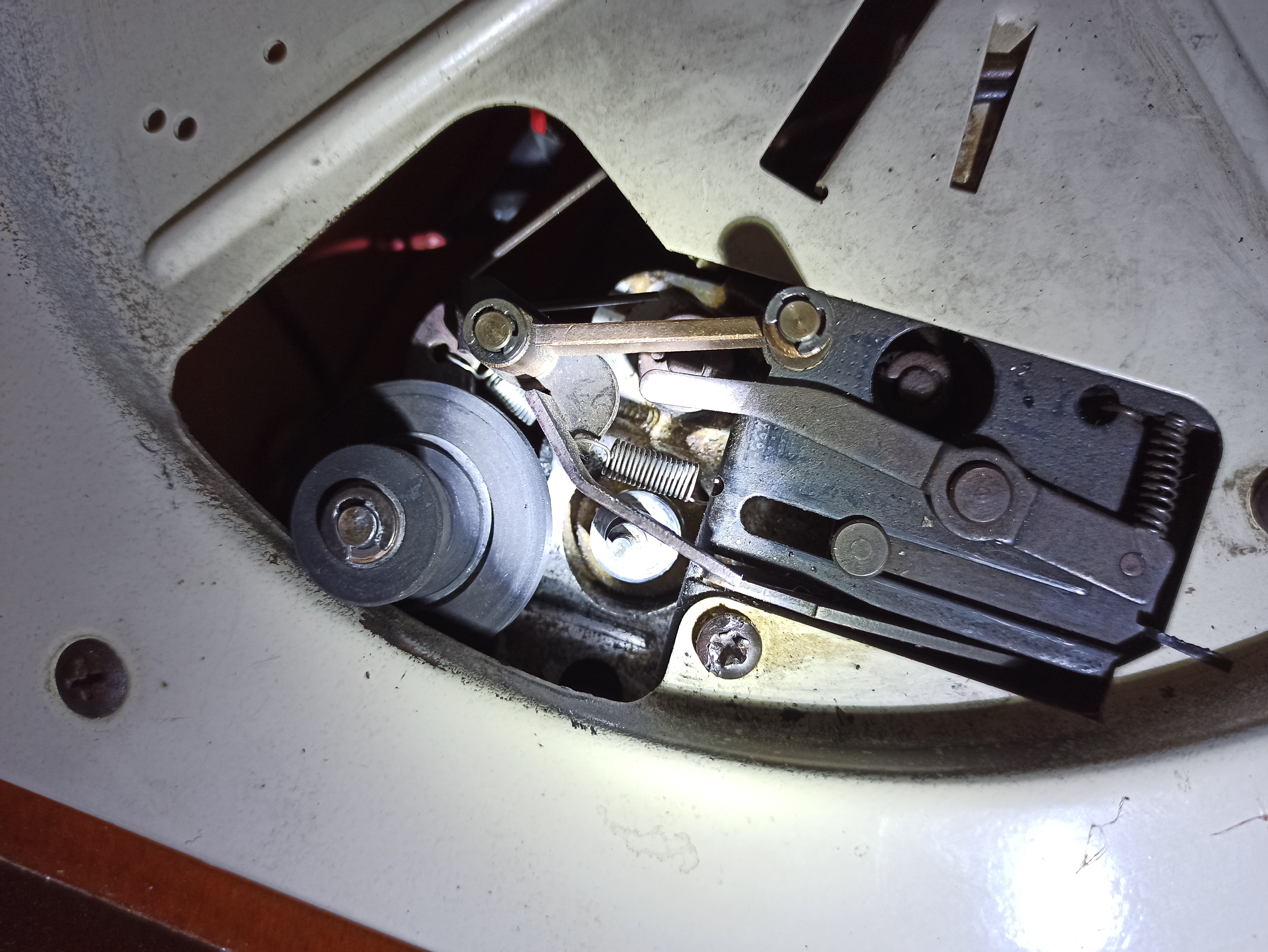

In your photo of the idler wheel motor plate assembly (3rd down):
The idler wheel retraction spring is not mounted on the motor
plate assembly correctly.
The left side of the spring in your photo is what I refer to.
There is a milled hole in the assembly edge near where
the spring currently is mounted.
In addition, the idler arm assembly is located incorrectly.
The "blade" of the assembly should be to the right side
of the motor spindle.
The first 2 of my photos show the correct orientation of the
idler arm assembly and the spring.

Andreas. What Mr. Mogul stated is correct and his photos are spot on so that should help you solve your problem. And, as electra225 mentioned, you do have the system that pulls the idler away from everything when the changer is in the off position. I would also suggest that you get some motor mounts from Gary and change those out if they have not been already changed.

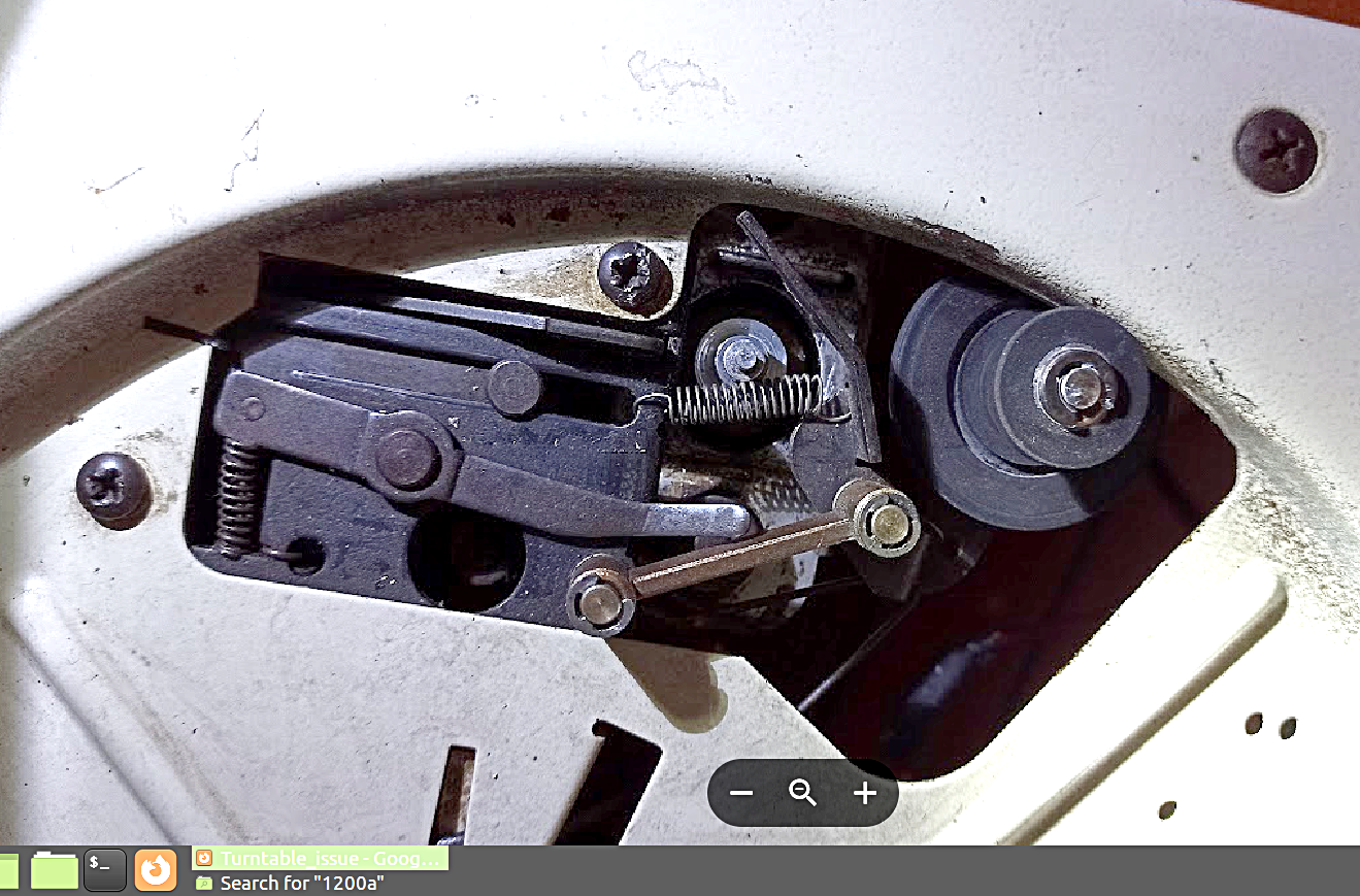

I managed to fix the spring location and the blade location (see photo), but the spring came off after a couple of tests.
Maybe the spring needs to be replaced?
Will try again, anyway, and see.
- Andreas
spring location fixed

The spring looks fine.
Bend the open ends of the spring closer, so it will
not slip off the mount holes.
The idler wheel is in the correct position
per the photo you posted.
Please turn the On/Off/Reject knob to Off position, to
verify the idler is pulled away from its position in
your photo.

Managed to attach the spring more securely now.
(A pair of forceps really helped. )
Also managed to put back the plate and it works again now!
