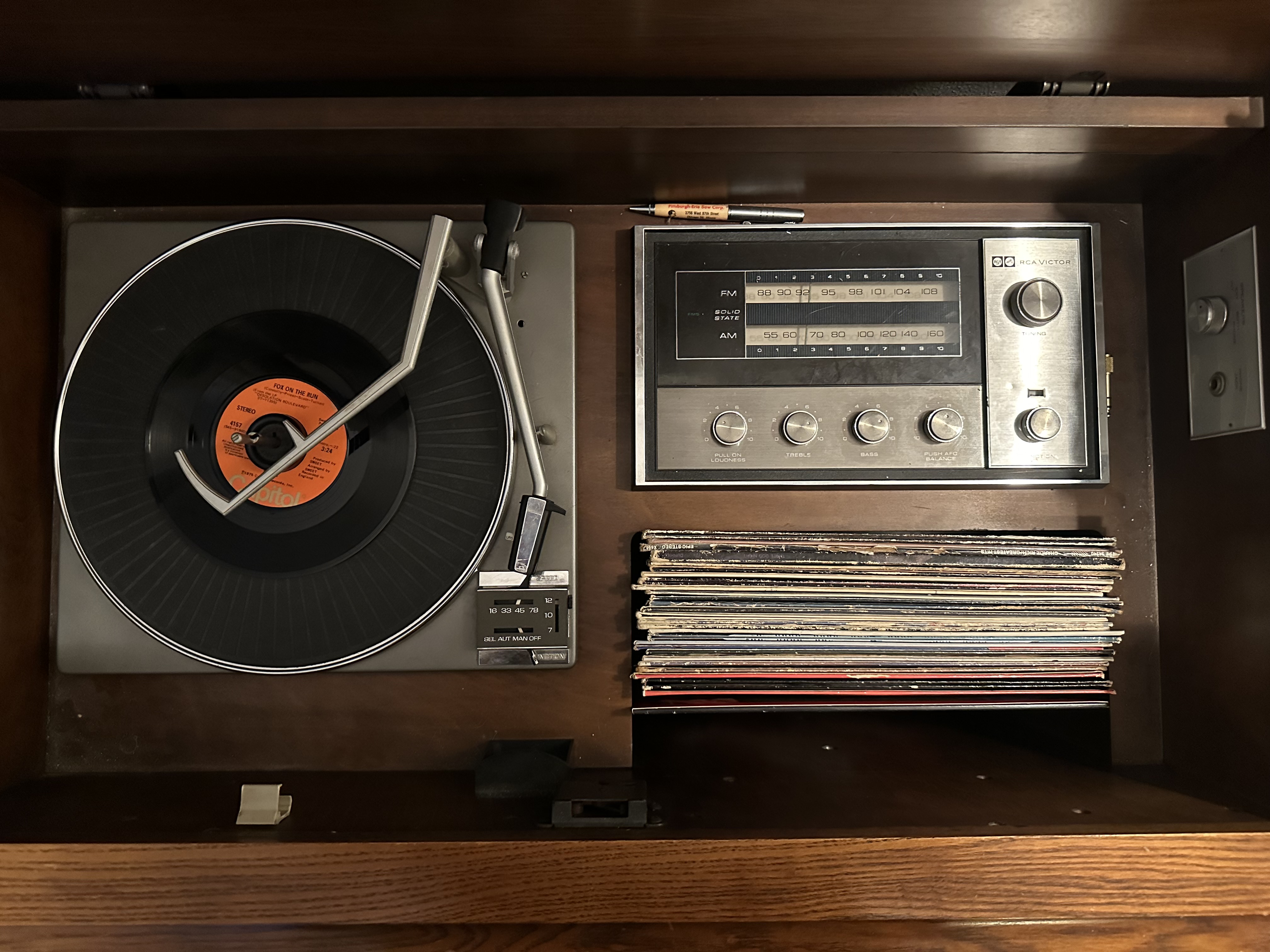

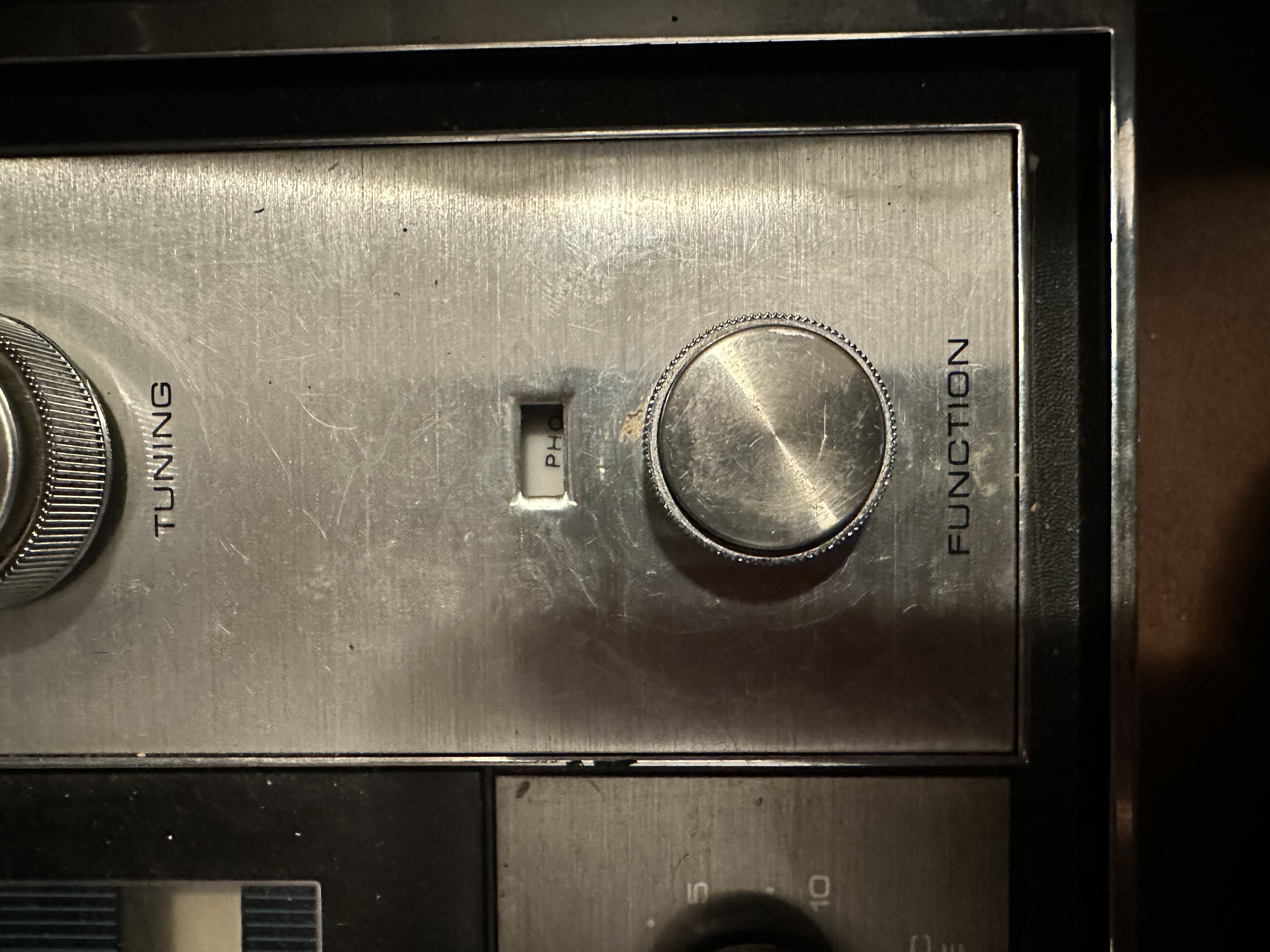

I have an VLT-51, it works and sounds good besides the function switch being very finnicky. Any time you rotate the knob to switch between tape, pho, fm, fm-s, and am, the left speaker will crackle and turn off and only play on right side. I found out that tapping or shifting the knob/applying pressure to it, it will come back to normal but it takes a couple trys and the entire time it is producing fuzzy/crackling sounds from the left side

Welcome aboard! We hope you enjoy the forum. As to the problem with your stereo, it sounds like you have a function switch that is dirty. Spraying it with contact cleaner should help. Good luck...

Thankyou for the responses, I opened up the back of the stereo and I’m not sure how I should go about getting at the switch, is there a way to remove the knobs and lift off the faceplate on the radio that anyone knows of or how I should go about it? Thanks

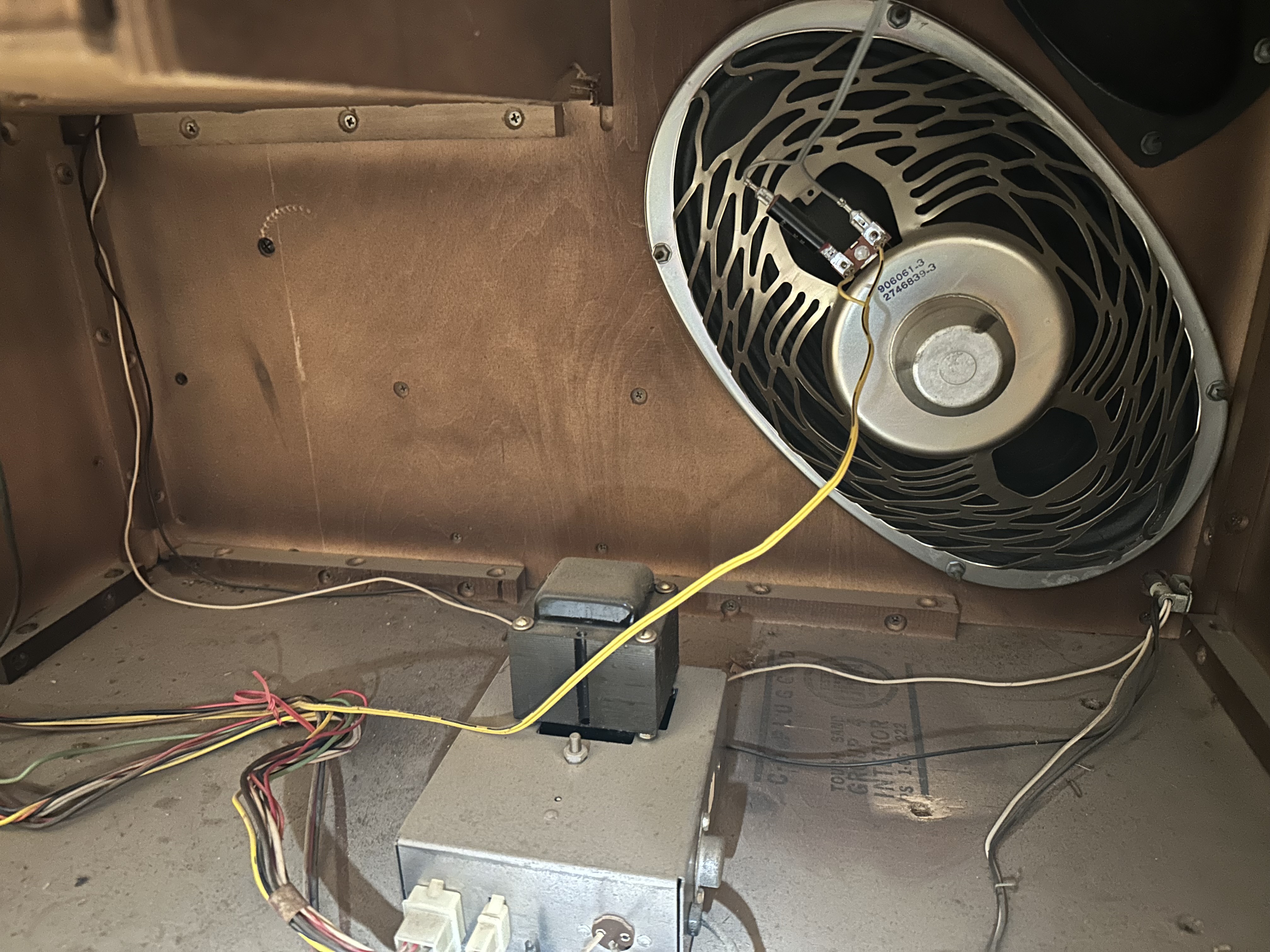

Judging by what I can see in your pictures, I would suggest that removing the knobs then removing the chassis might be the best option. I don't see screws that come out on top to remove the bezel. You very likely won't be able to clean the function switch with the chassis in the cabinet. Good luck...

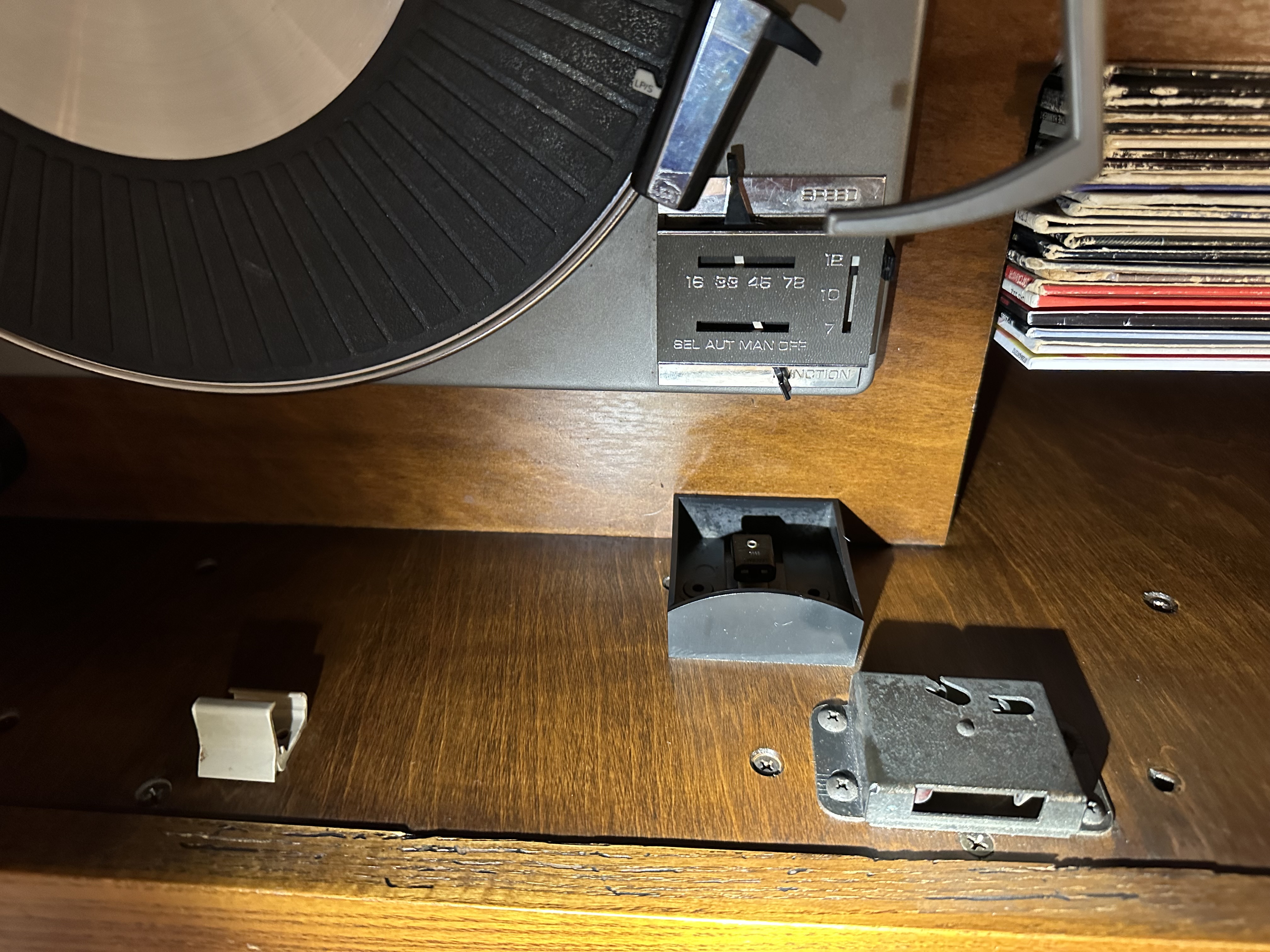

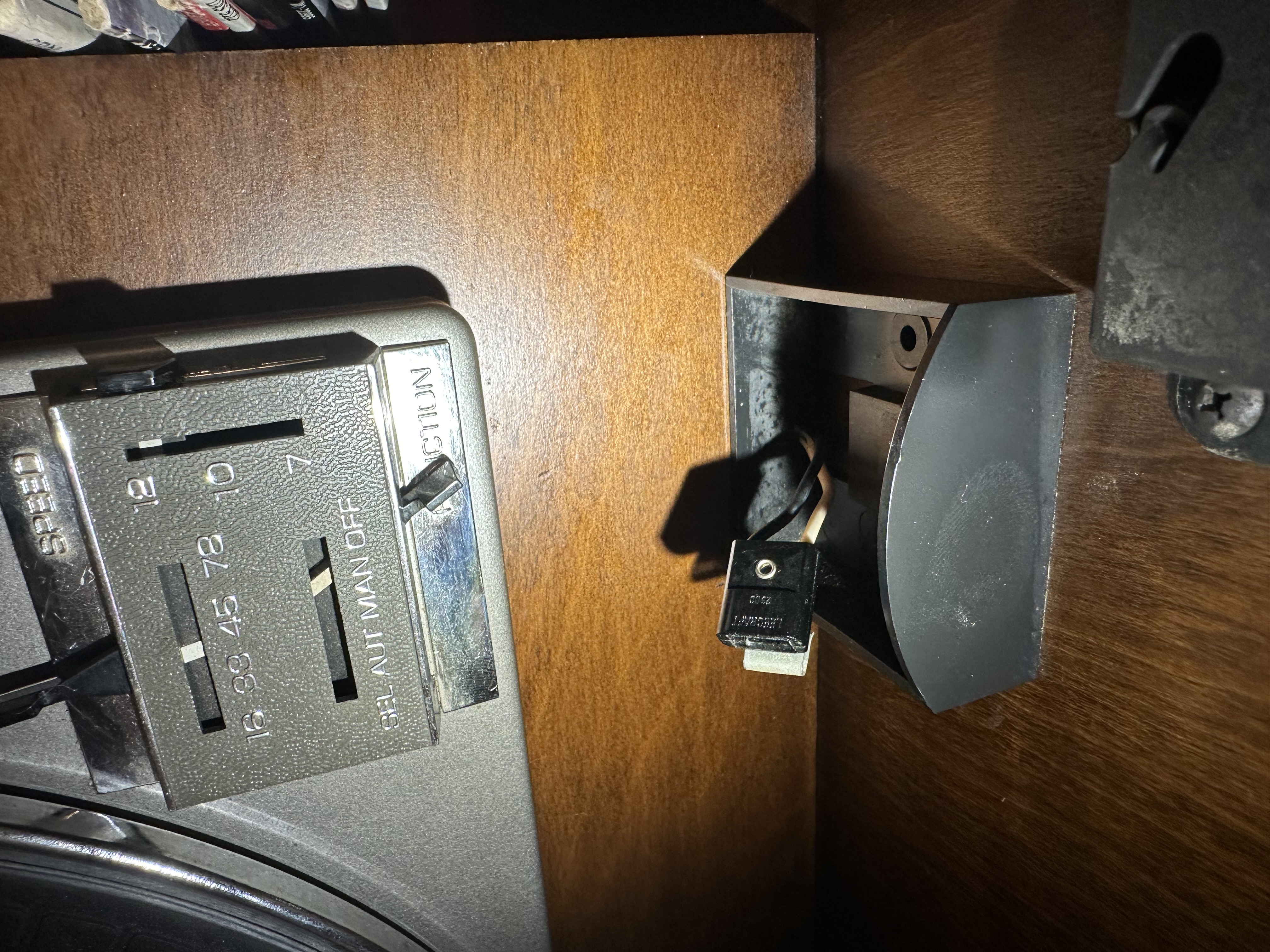

Thankyou everyone I cleaned the function switch and its working a lot better. lastly does anyone know what the black box and the white clip are for, there mounted on the front inside the black box has a wire connection. thanks

I am GUESSING here. Maybe a light of some kind? A light to illuminate the record changer compartment. When you open the lid, the part on top, the latch, has a switch of some kind that makes the light work? Some of the guys will know in case I am wrong, which is likely....... :oops: ;)

I think you're rght about the light. In the photo it looks like there's a receptacle for the push-in style bulb like the little automotive ones (license [late lights, side markers, etc.).

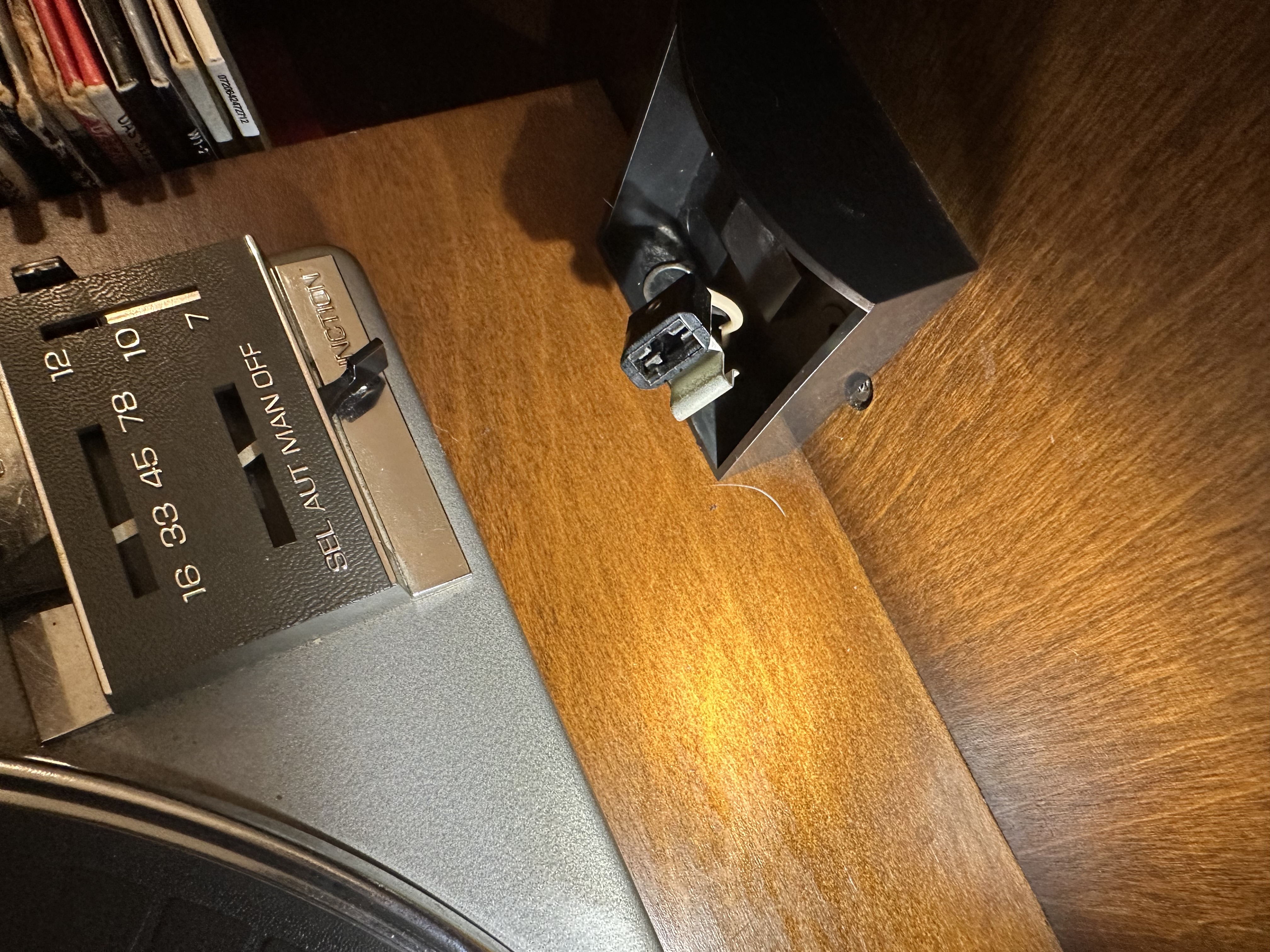

I opened the back and it looks like the black and white wires connected to that socket, tie into the green indicator light that turns on when the radios on. Turns out the socket is just clipped on, and the socket says leecraft 2300 on it. I found a pic online showing something connected to the white bracket also.

The bulb would go into that black socket, then it looks like it clips to the black piece. I don't see holes for a cover, but it may have had one. The thing in the white bracket looks like a 45 rpm adapter. The pilot light (the green light) is typically red or orange. Never saw a green one. The light in the changer compartment comes on with the radio, then?

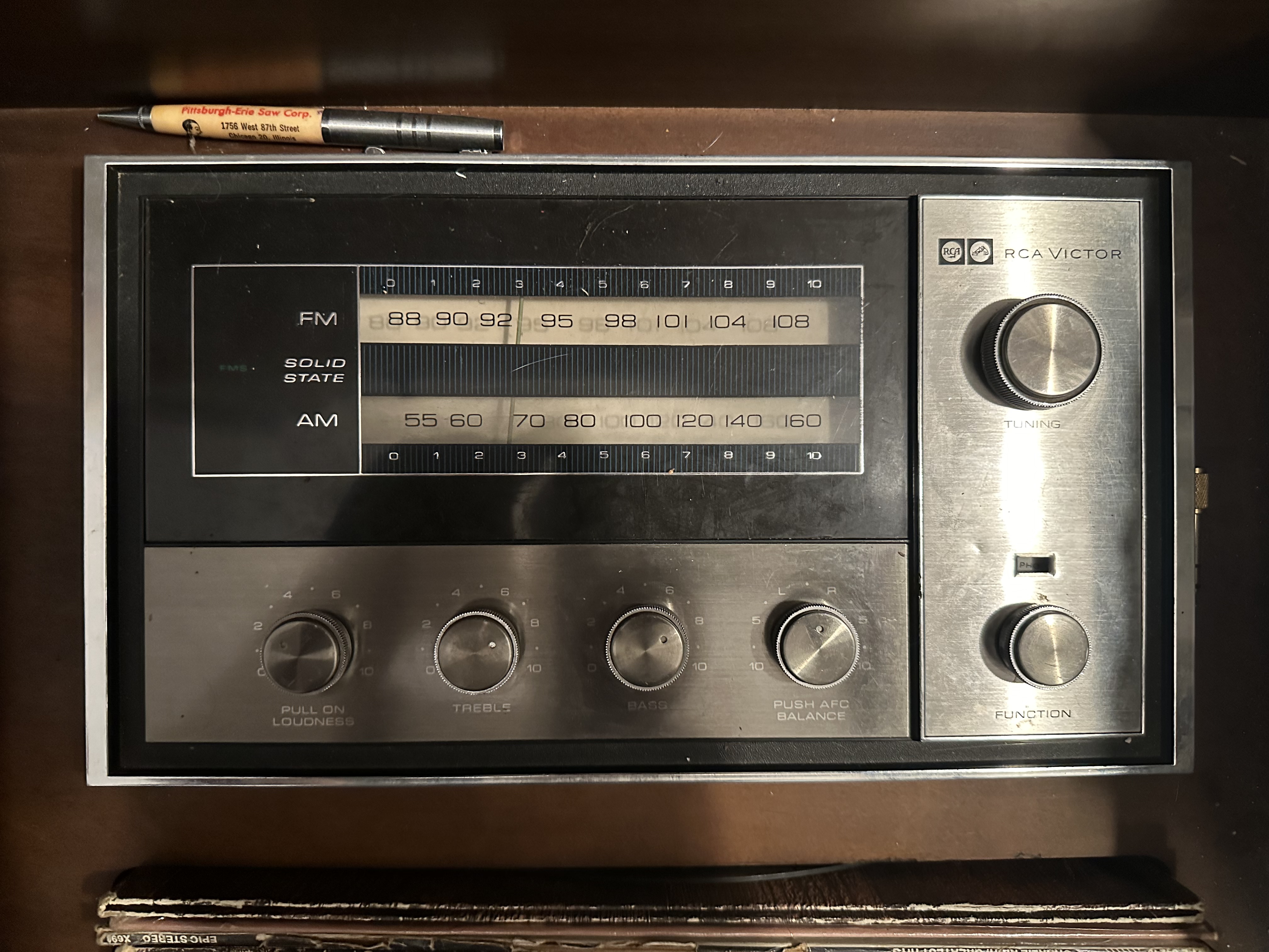

The light does come on when the chassis is turned on and there is, apparently missing on yours, a white cover that friction fits that covers the light. I see your RCA stereo has the oval woofer like mine does. Is the black thing above your oval woofer a horn tweeter?

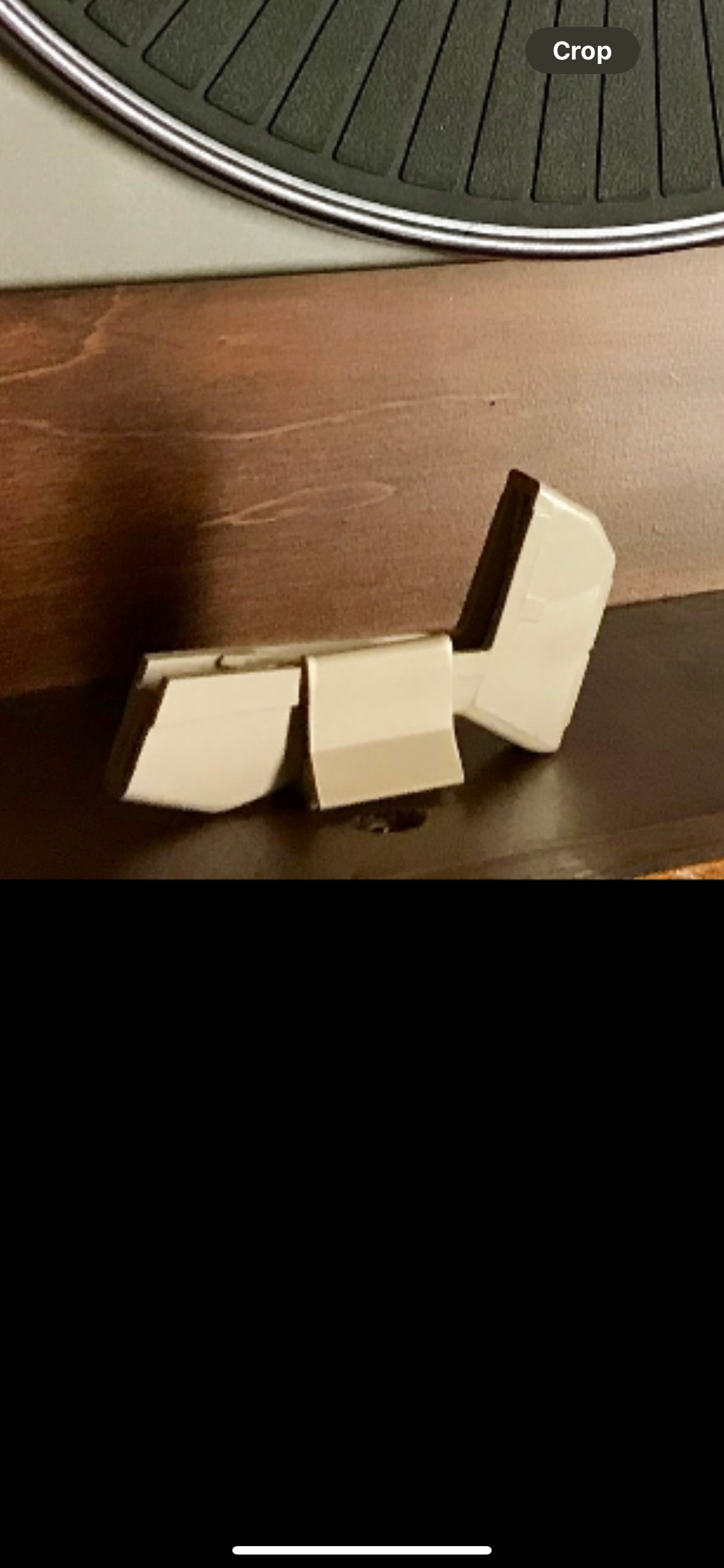

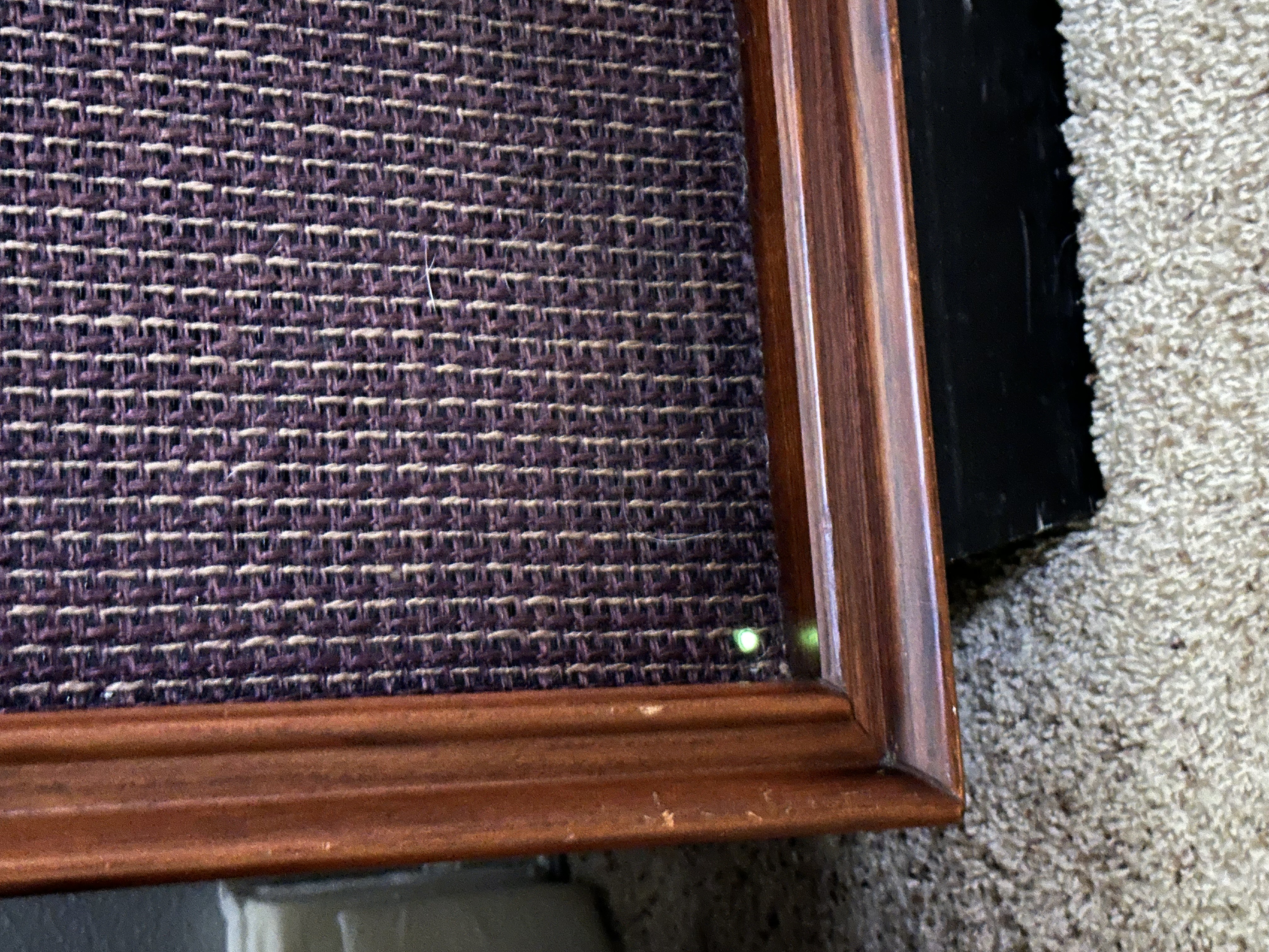

Yes I believe it is a horn tweeter. I put a 194 automotive bulb in the socket and it does light up when the unit is turned on. As for the white thing I don't think its the 45 adapter i have one of those, I added a cropped photo of the white thing that im missing, I also included a pic of the green light that indicates the unit is on

jkipp wrote: ↑Mon Nov 20, 2023 6:06 pm As for the white thing I don't think its the 45 adapter i have one of those,
See the 45 adapter here:
https://www.thevoiceofmusic.com/catalog ... ategories=
Posts: 5513
Re: Ann Arbor VLT-51W
Post: # 18188Post William »
Thanks Ken, I just thought about doing the same thing. His white thing is he 45 adaptor and somehow it goes into the black thing. I have not seen an arrangement like that before. I'm glad the bulb worked, now you need to be on the lookout for the white cover that goes over the bulb.
