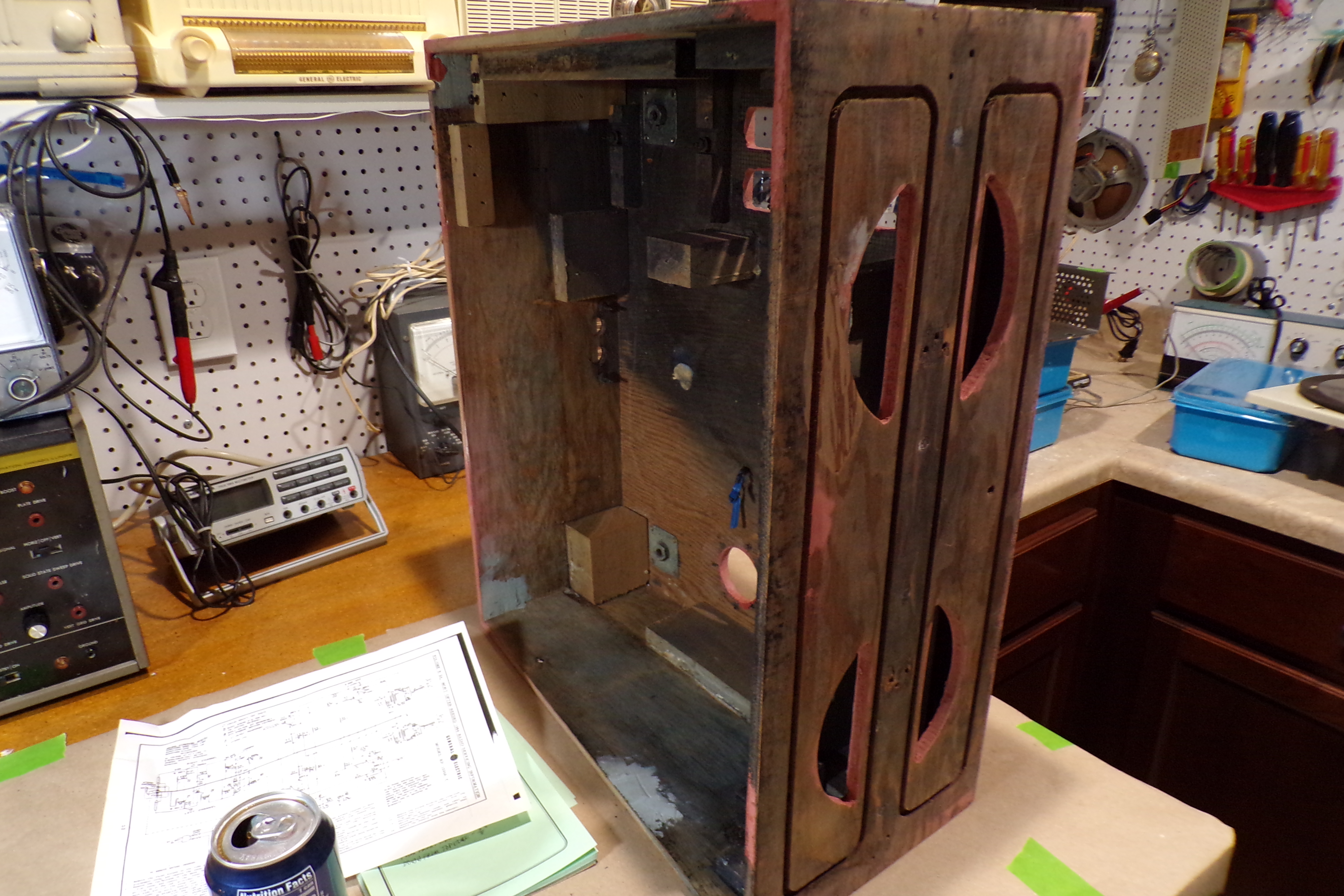

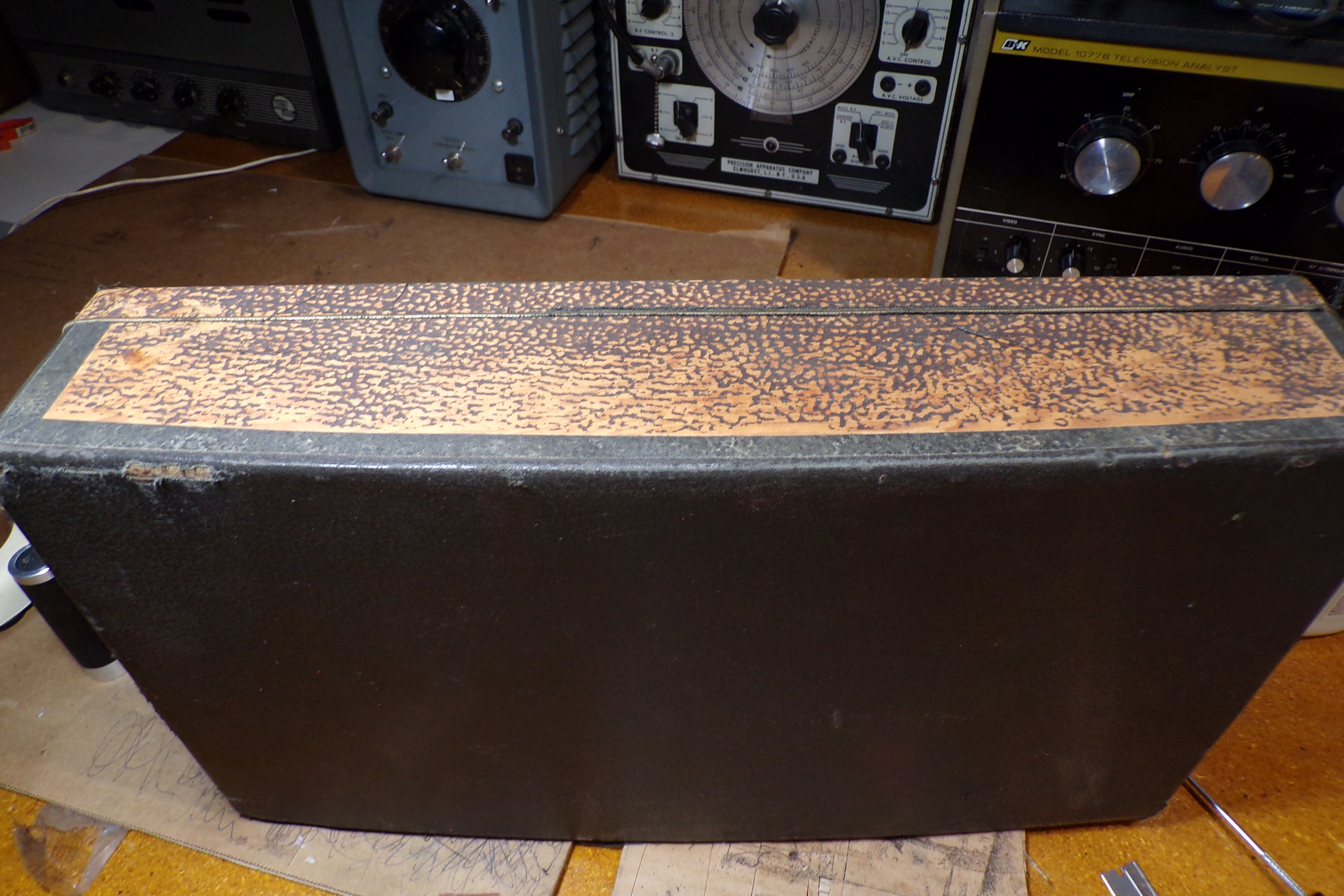

I have the covering mostly removed from the lower cabinet. I can't really do much to the lid until I get it in to the decal guy to have the decals made. I will inquire about increasing the size of the "General Electric" decals along with the "Stereo High Fidelity" decals. Rather than making one huge decal for the inside of the lid, I'll have it made in several pieces and use a piece of pinstriping. The decal for the lid will be red, the one on the tube cover will be white, the one on the lid will be either red or silver, I haven't decided yet.

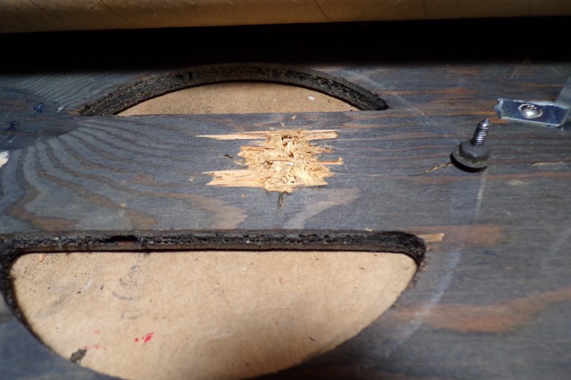

The split rivets they used to attach hardware were really buried. I had to do considerable damage to the plywood cabinet when I dug them out. The rivets on a couple pieces of hardware are behind a wooden block that is glued in and is happy where it is. I haven't decided what to do there yet. This cabinet has been wet at some point in its history. It is almost 75% covered with black mold, like the Magnavox cabinet was. I'll scrape and sand it, then see what I have. I don't want to paint the cabinet. We'll have to take that as it comes. I don't see why this cabinet won't turn out just fine, providing I set the Tolex up properly.
The next task is to finish removing hardware. Then wet and scrape with a single edge blade to remove glue, then sand, than fill the imperfections, then sand, then figure out where I am from there. I have some gluing and clamping to do. One corner of the lower cabinet has been wet, so the glue has been damaged.

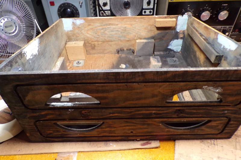

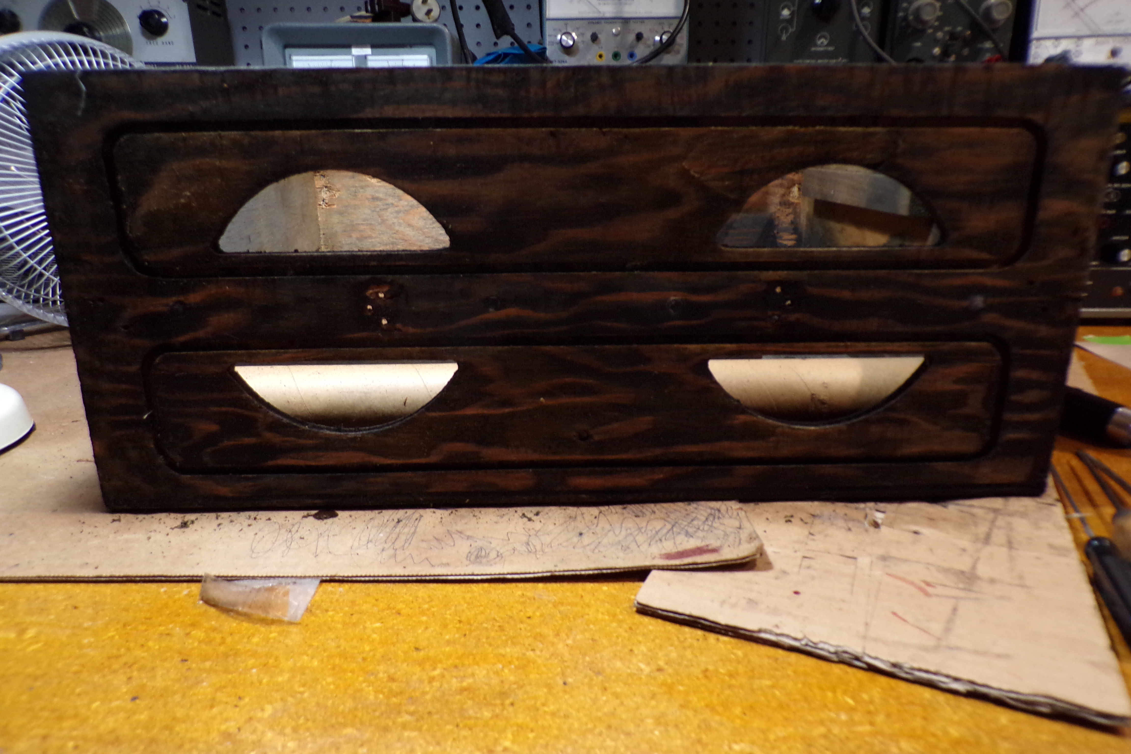

I have the cabinet cleaned and much of the damage done removing the rivets has been repaired with Bondo. Next task is to sand, then use glazing putty to fill small imperfections in the wood. I'm considering painting the inside of the cabinet with flat black paint to make it look a little better.

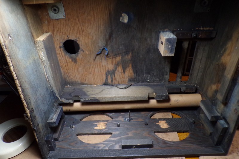

What's with the cardboard tube--speaker-wire storage?

The cardboard tube is for storage for the legs. It actually has a divider in it so the legs won't rattle. I haven't found out how it's attached to the cabinet. I think the entire end is glued into the cabinet and will self-destruct if I force it. It's not in the way and won't affect the Tolex installation in any way. I'll leave it unless I can remove it safely.

I have the cabinet sanded and also have the glazing putty on. This may be a first coat. When the cabinet got wet, some of the plywood delaminated, so there are small chunks on the edges that have fallen out. This will show under the Tolex.

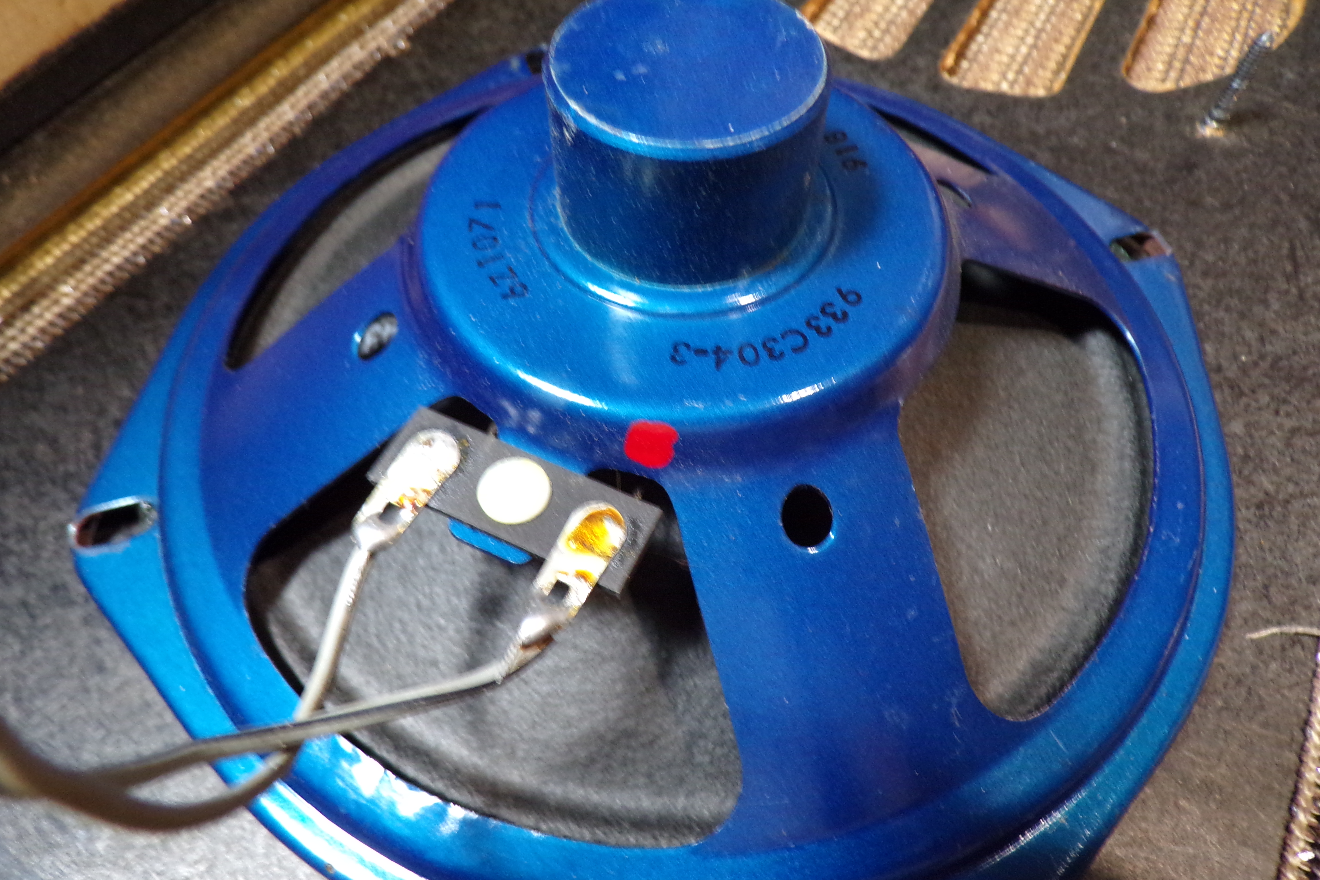

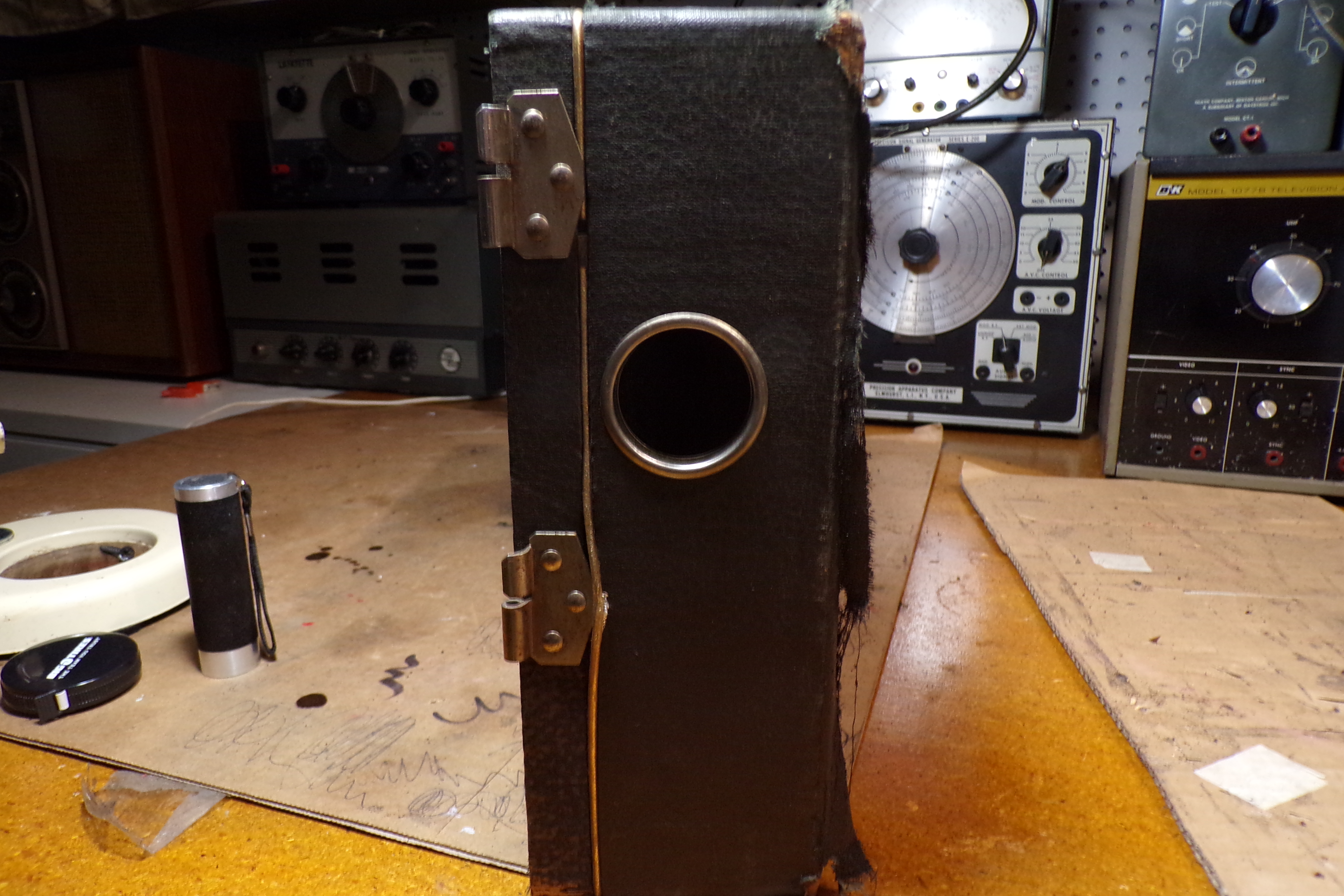

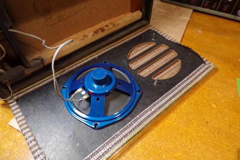

The main cabinet is ready for Tolex. I may paint the inside flat black to make it look better. The speaker enclosures have been wet where they attach to the main cabinet. The plywood is simply rotten on the upper corners of both speaker enclosures. Removing the hardware destroys the integrity of the plywood. I'm too far into the project to turn back now. I knew there was some swelling, but, after I got the old covering off, I knew it was going to be a challenge. I haven't decided the best avenue to repair them.
The speakers in the wing speaker enclosures have dust caps on them. The factory has also put red spots to indicate the positive terminal on each speaker. There is room for another six inch speaker in the wing speaker enclosures.
The wing speakers aren't in very good shape structurally. There are little gaskets in the enclosures to keep the speaker boards from rattling.

electra225 wrote: ↑Sun Oct 29, 2023 12:17 am The plywood is simply rotten on the upper corners of both speaker enclosures. Removing the hardware destroys the integrity of the plywood. I'm too far into the project to turn back now.
For delaminated plywood, I generally work yellow glue in among the plies with a thin tool and clamp it up. If it's really rotted--eaten up by fungus--then epoxy with filler works if strength is needed, or just Bondo if all you need is shape.

The plywood on the speaker cabinets is not delaminated, it's gone, turned to mush. What I did was to use some of that aluminum tape used on ductwork, to "make" the shape of the plywood. Then I scratched it with 80 grit paper, then put Bondo over that. Once I get a basic form, I can fill it with filler or Bondo. It needs to be strong enough it will hold the speaker. It would be more serious if it was the lower side, though. I should have painted over the covering on the front of the speaker box, then put new Tolex on the rear part, then blended those two materials. Once I removed the covering, I realized I was in trouble. On the top inside corner, an area about 3" long on two sides. I didn't give a thought that the wing speaker boxes would be more rotten than the main cabinet. The material they used on this stereo cabinet disintegrates almost immediately when you spray Windex on it. The glue remnants come right off with Windex. I am for sure going to use Elmer's white glue on the Tolex. If you look in the pictures I posted, you'll see where I used glazing putty on the edges of the plywood everyplace I could. I'll take more time digging the rivets out of the other speaker box, to minimize damage. Tentative inspection leads me to believe that one, the LH one, might not be quite as bad.

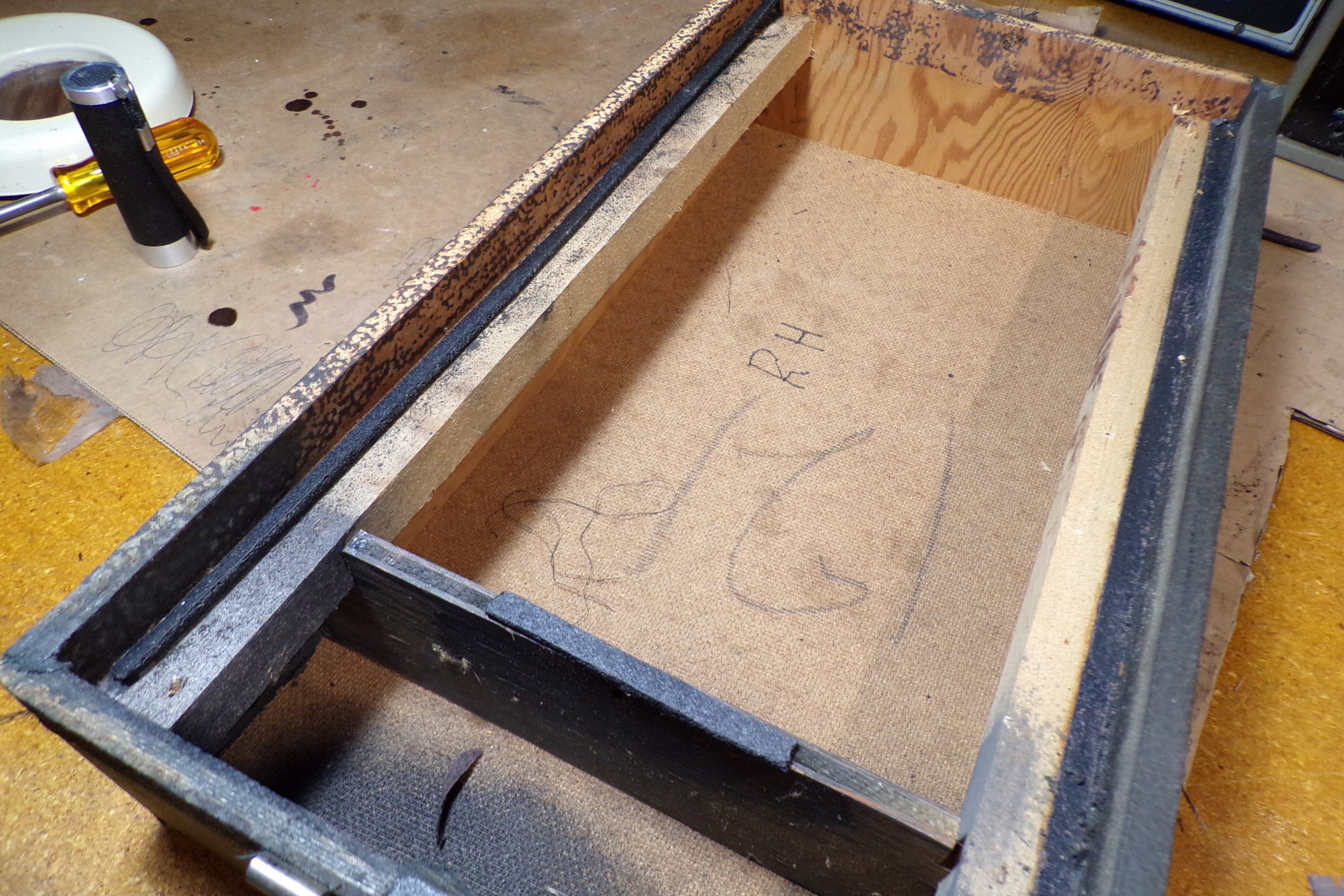

I only got about an hour in the shop today. I worked on the left wing speaker. It's not in nearly as bad of condition as the right one was. I got one hinge and the latch removed with minimal damage to the wood. This whole outfit has really bad quality plywood on it, very delicate. I had intended to get the decals to Tres so he could do his thing, but life got in the way. Maybe tomorrow.....
