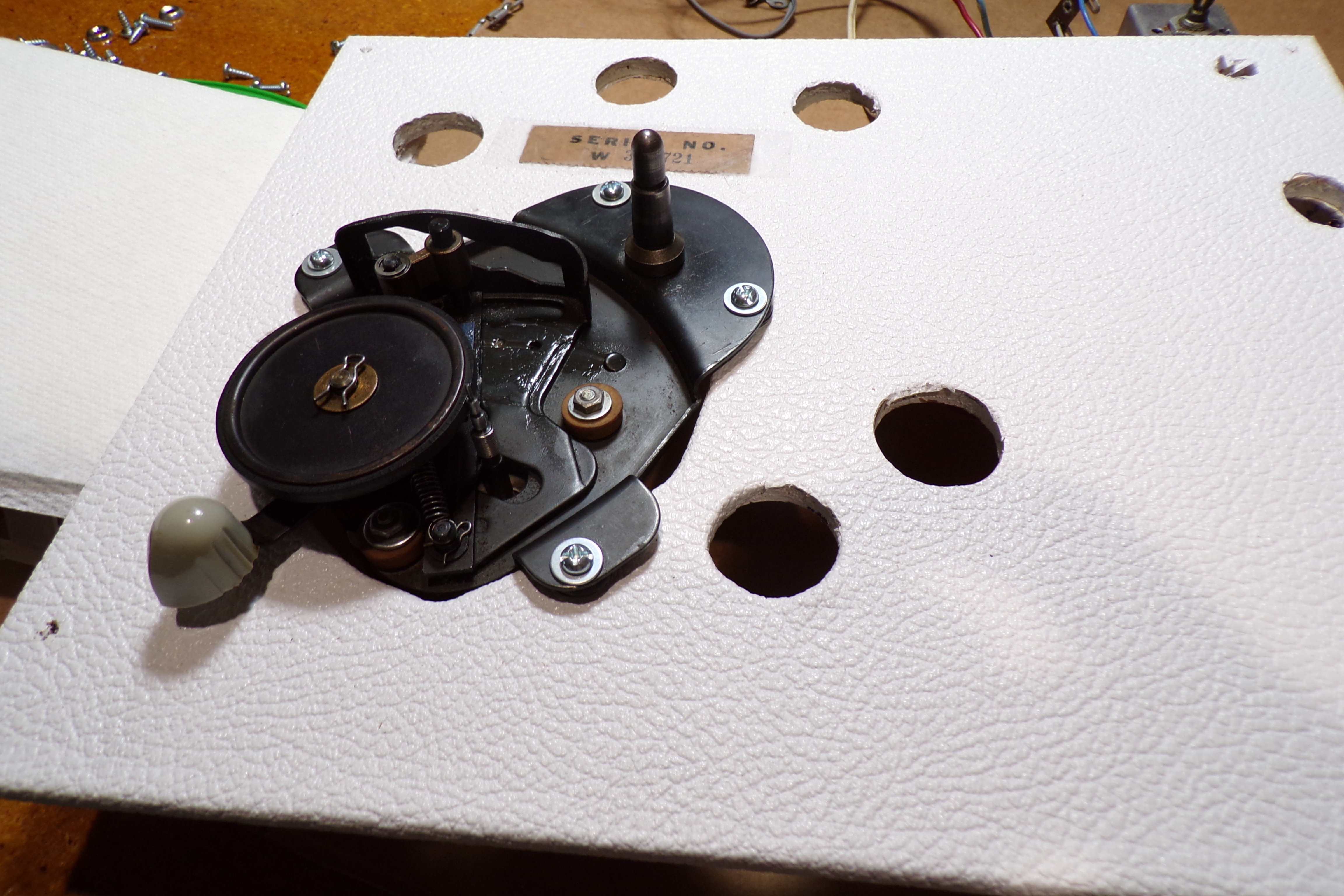

I have the mechanical parts back onto the motorboard.

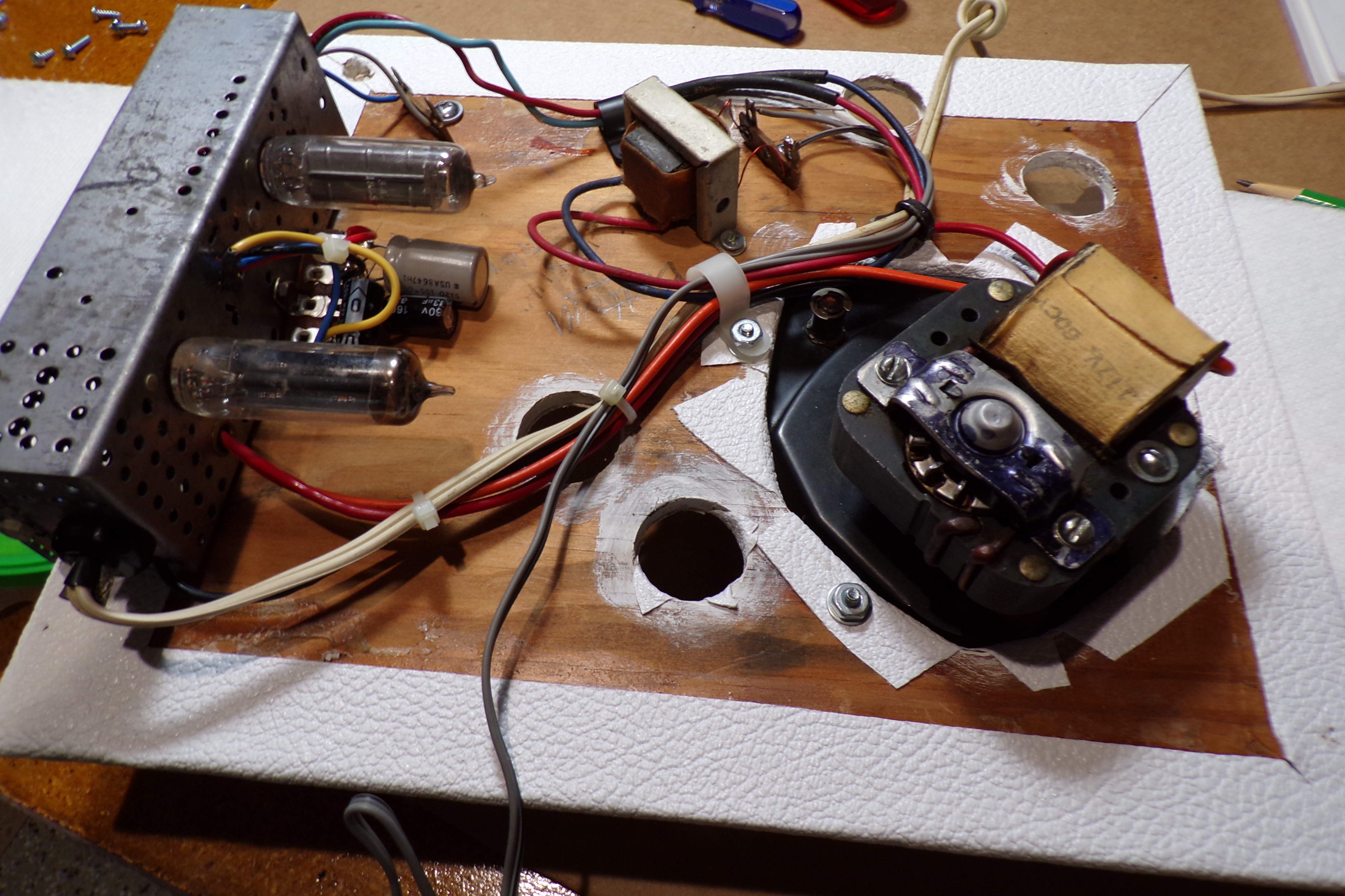

All the electronics back in place. I moved the output transformer from the speaker frame to under the motorboard. I used a terminal strip for the speaker wires and one for the cartridge wires. The cartridge appears to be dead now. I'll swap the wires around to see if I have it wired wrong. I may need a new cartridge.

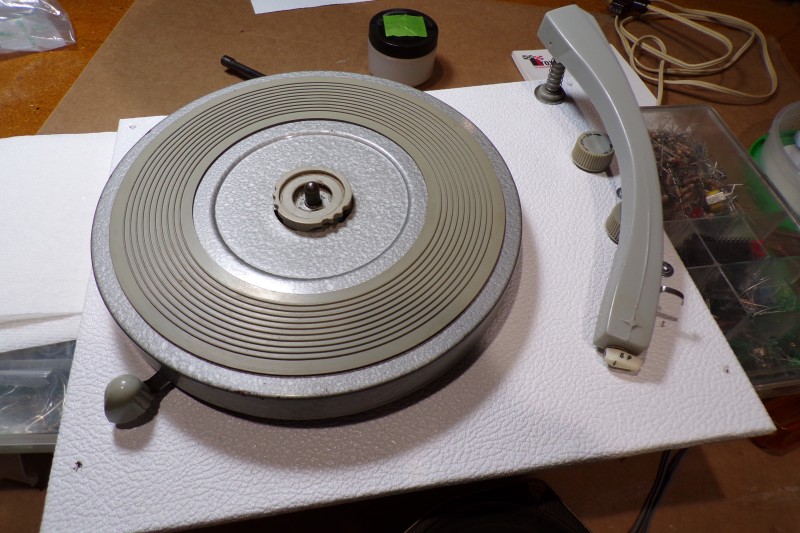

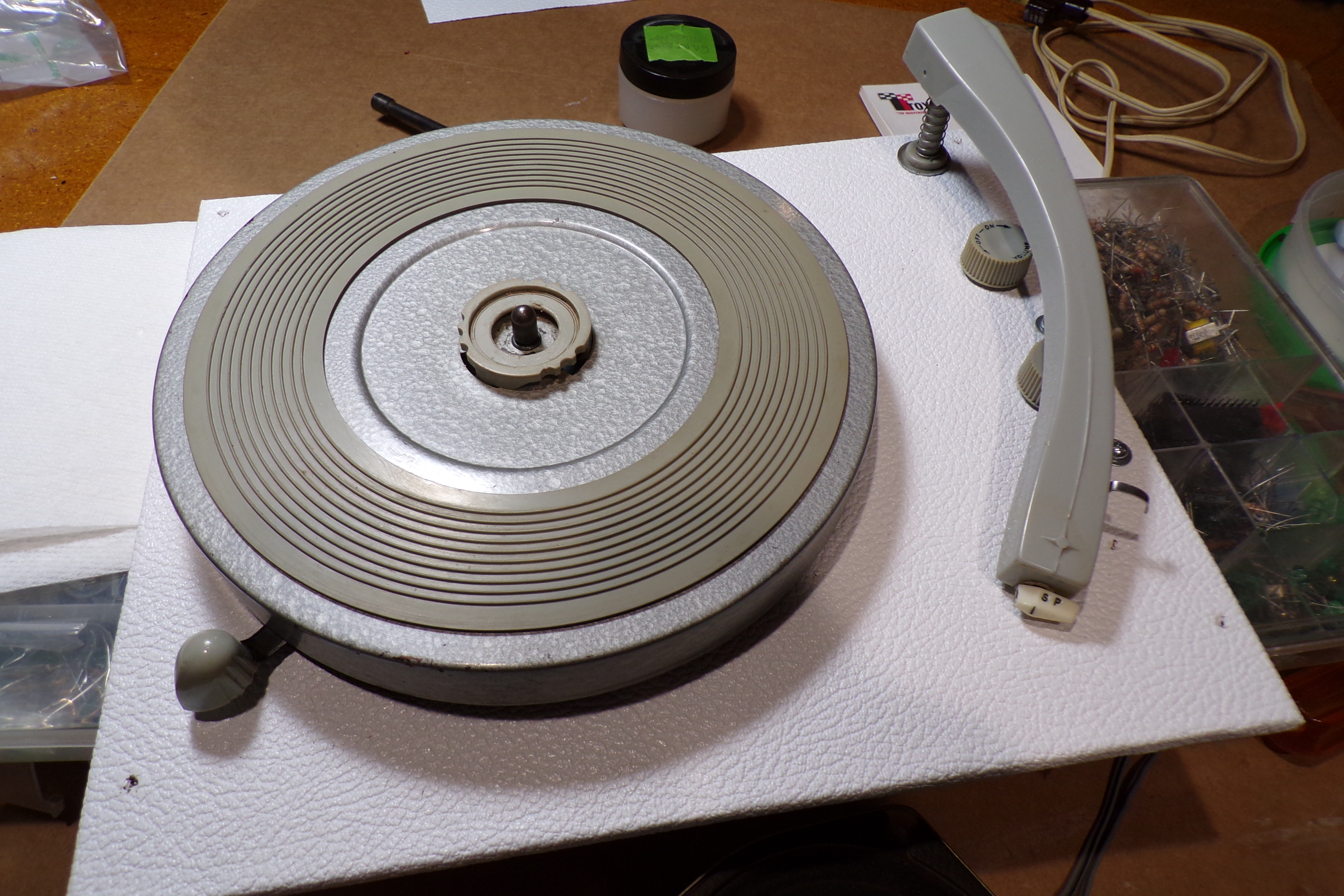

The platter looked pretty good until I replaced the Tolex. I will repaint it.
I don't have the tone arm rest installed yet. The paint was wet when I took this picture. I need to rig up a method to squeeze the speed indicator to the motorboard. Screws will look hacked. I'll try using Tolex glue to see if that makes it stay put.

Thanks, Mr. Mogul. If I reversed the wires on the cartridge, would that kill it?
- Posts: 3746
Re: Truetone record player cabinet restoration
Cartridges don't much care how they are wired, as long as you're not putting a voltage across them. They're little generators. Wire 'em wrong and you might get some hum, except you've got a crystal cart that's not hum-sensitive.

Unfortunately, Bill, methinks it is kaput. Why it went kaput when I messed with it is anybody's guess. I reckon I'll use a stereo cartridge bridged for mono. I don't see mono cartridges still being available. I need a stereo crystal cartridge for a little GE stereo I have, so I guess I'll buy two new ones. This one has a Vaco/Varco cartridge that is not listed on Gary's website. I'll reach out and see what he has.
