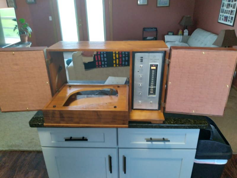

After a few weeks of haggling I picked up this tabletop fisher ... Ultimately paid 35 bucks for it and I think it was too much the more I look at it , he started out at 100... because it was his dad's and had great emotional value .... it was not clear to me that it had emotional value ... speakers gone, power cord cut, tuning string and dial indicator missing , cigarette burns on the cabinet... yep they did ole dad proud ...., the TT is original and a rebranded BSR used by fisher .... audiokarma guys claim Fisher was using BSR TT's near the end of the company ...now the problem is where do I get a schematic for this?... inputting the model and or the chassis number at sams website brings up nothing...is there a trick to looking up schematics for fishers?... there are no other numbers anywhere to be found

Pic pic pic... if it's a tube model the tubes will be worth more than $35.
I looked in SAMs Index, there's a A-19 Allegro, not sure if that's relevant.

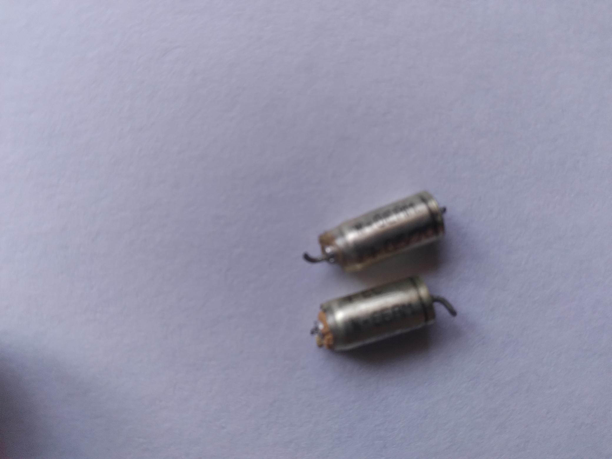

I got both channels working again...left side was dead had input into the tone control board , but nothing coming out ... turned out to be the german caps that people claim never go bad , these fishers are full of'em . I also need to find some speakers that are very narrow ... the original speaker cabinets are only 3" total depth , that ought to be interesting to find .... here is a pic of the caps oozing out the ends

If those are Frakos then I can't recall anyone saying they don't go bad.

not sure what the brand is,but one of the YT poster/ repair guys made the claim that these caps are robust and hardly need to be replaced ...oh and I will build some new speaker enclosures... only thing is the speakers are connected through the hinges... and those hinges are no longer made ... will have to come up with a solution that does not look to out of place on it ...

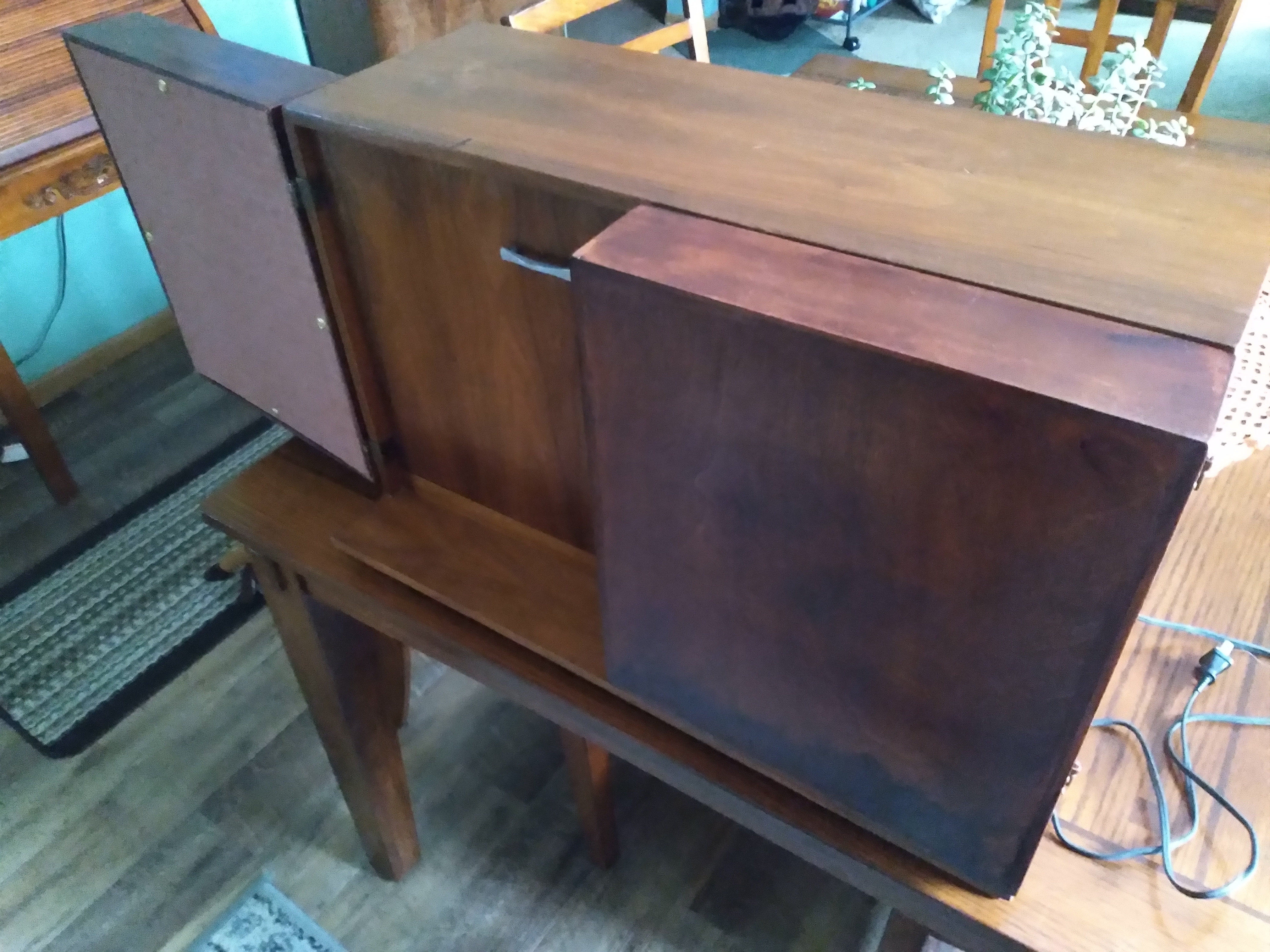

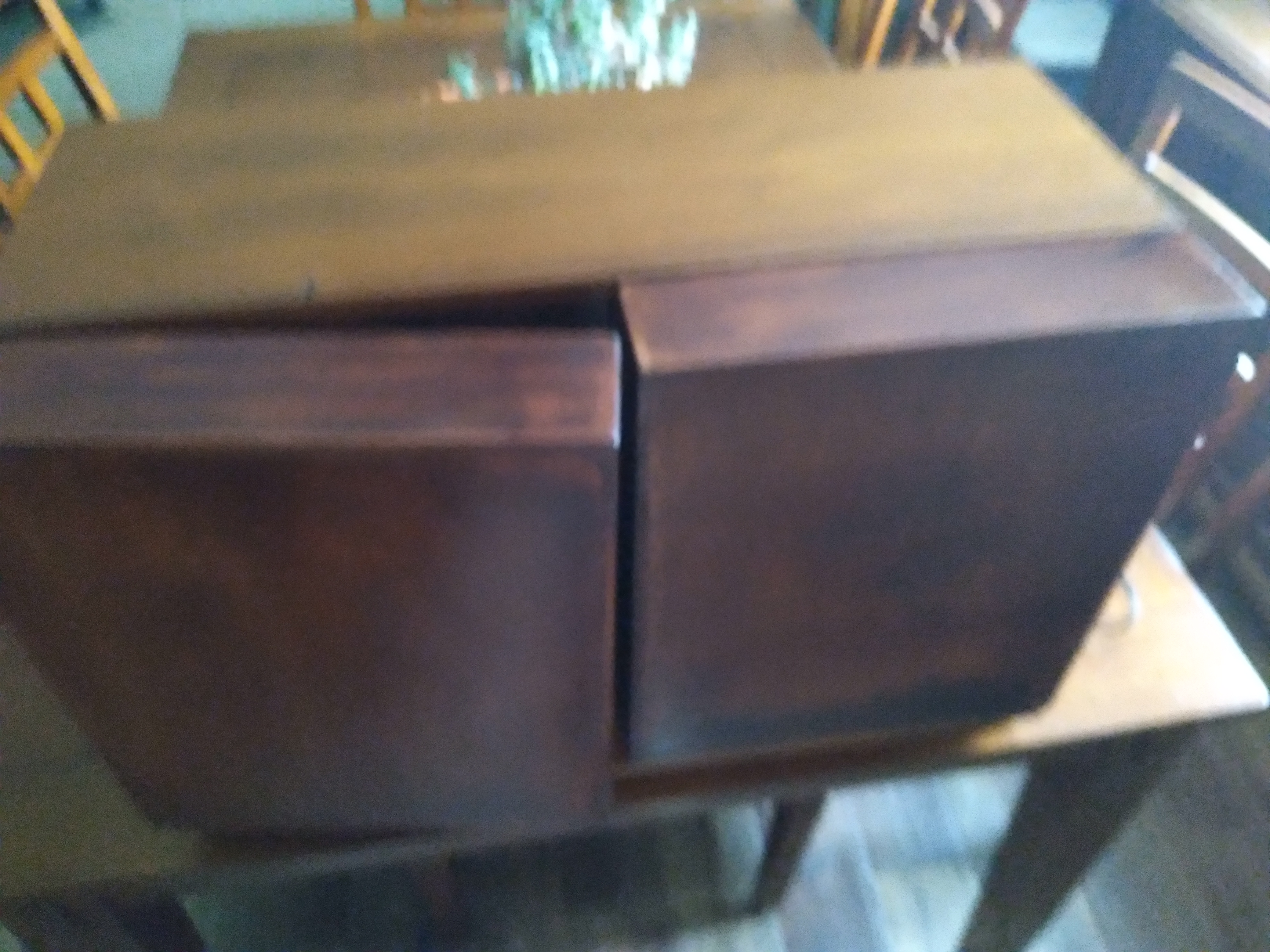

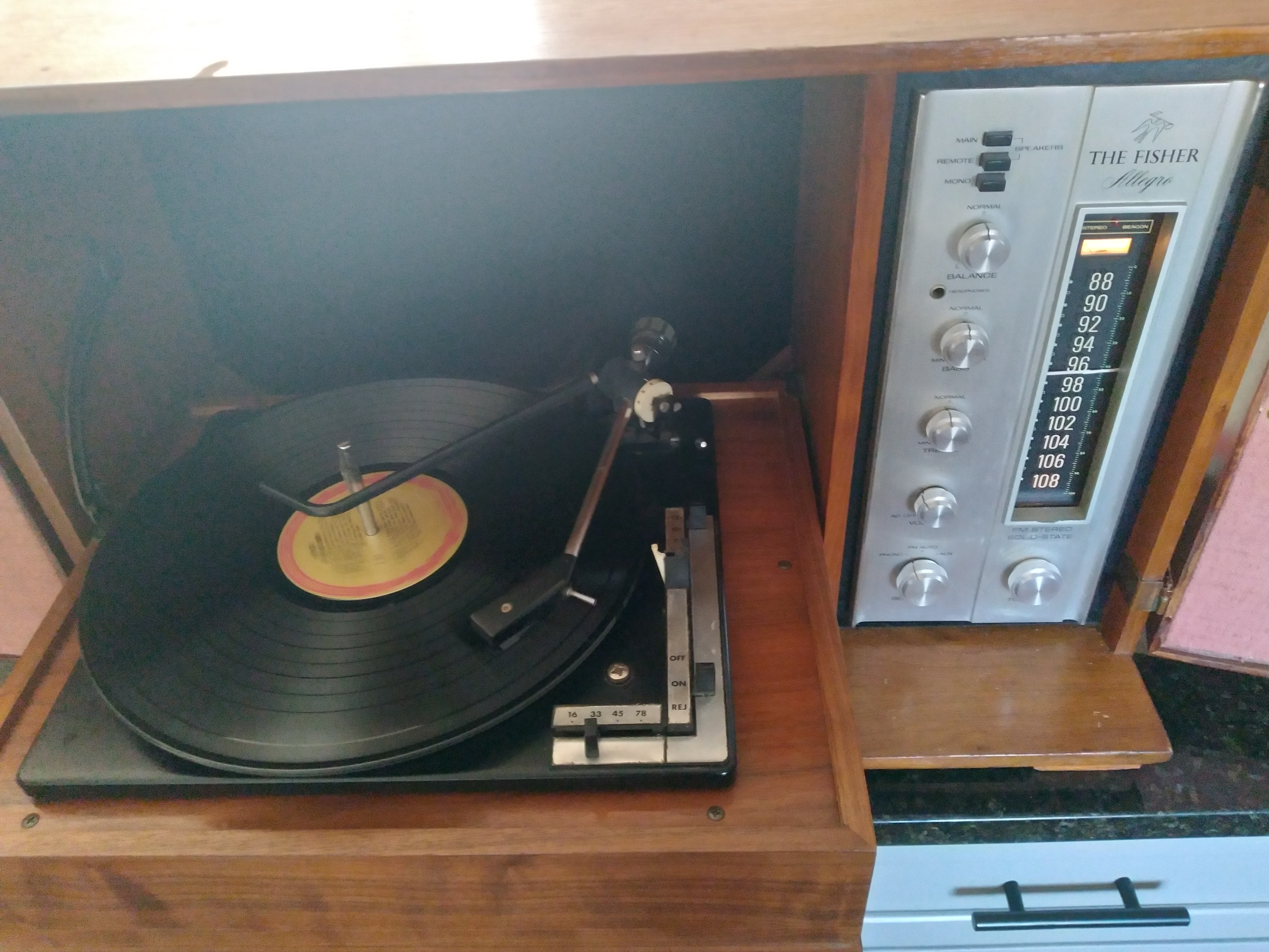

well sort of done, still got to go through the changer , my homemade speakers work OK ,but one of the tweeters from parts express was junk ... just rattled so I just cut the wire to it ...the speaker cabinets look just like amateur hour the finish I started with just ran and dripped , a lesson never use the all in one min wax stuff . But it plays great and loud , I believe it when it says 35 watts total ...once I get the changer in I will take another snap. one thing I was surprised at is there is no 45 adapter or even a spot on the cabinet for one ?...

Thanks Bill , it didn't help I used leftover scraps of wood for the finish , poplar, Luan, and masonite ... the pics show the terrible staining and color difference , I was surprised , my wife who normally does not take any interest in my hobby , claimed this set as her own , I guess she likes the compactness of it .
