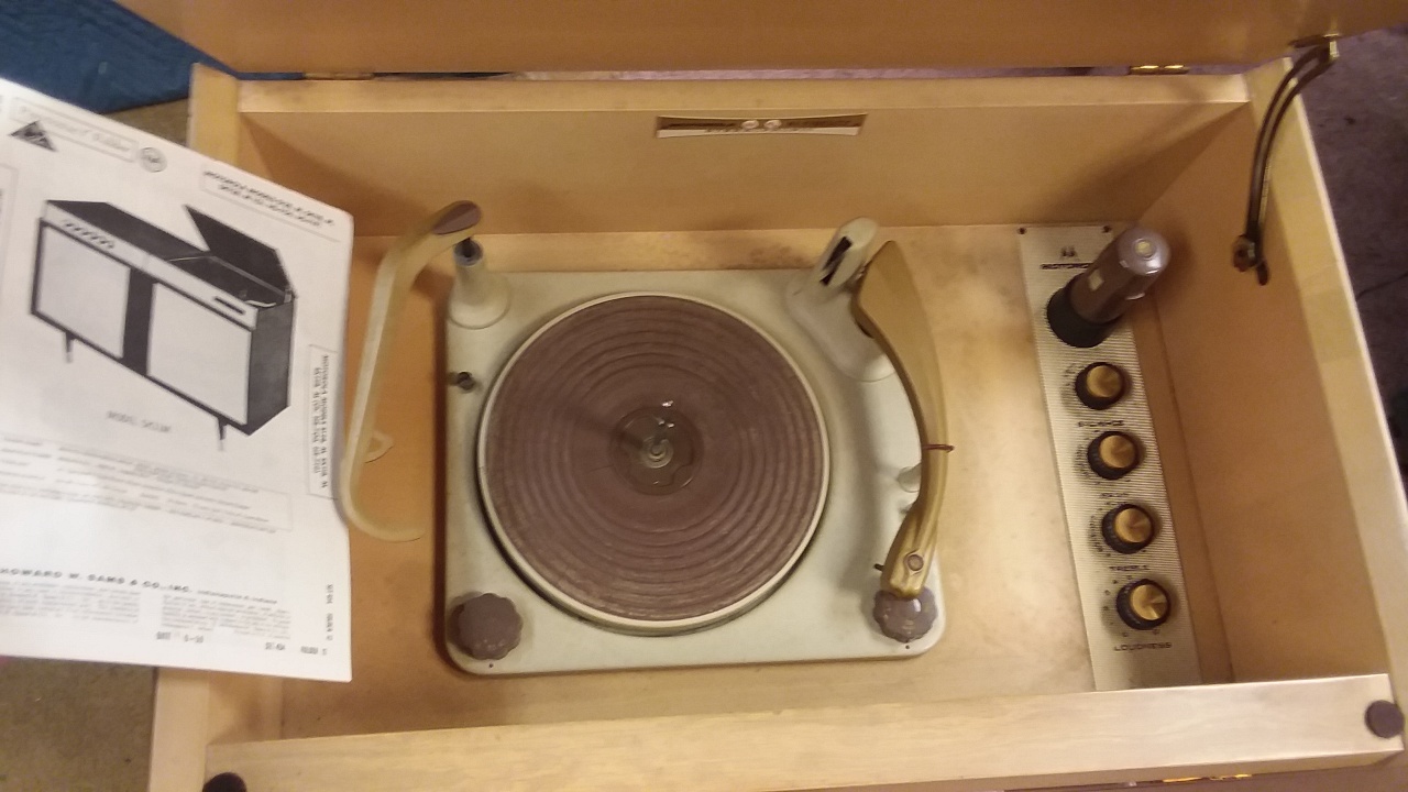

First, idler wheel was toast and made lots of noise to boot. I had a spare UA8 rom an EMUD 915, which had a good idler. Speed was checked afterward and just a tiny bit fast on 33.333
Second, changing mechanism actually works but will not shut off after last record has played, instead landing the needle as if a 7 inch record had dropped.
Third and last issue is the cartridge, which was a removable Astatic 13t. I had two more of these little suckers but none of them played well on both channels. While still available, https://thevoiceofmusic.com/catalog/par ... ategories= , the OEM tracks at 6 grams so it was just too easy to install a new Tetrad.
The tracking force is set much like a VM, but the spring has slack and getting 4 grams was a bit tricky. Tracking for the origial
I spent many an hour on BSR's later designs, removing the solidified grease and changing carts with mostly success. I don't prefer BSR specifically but I welcome any and all comments on your experiences with these workhorses.

All done! It acts so much like a VM yet is so unusual:?
This BSR was the original player installed in this console and I like to keep things original. This time, I did not regret that decision
This is a very different changer from all others, yet I was able to easily do the following:
1. Successfully clean idler pulley and have it operate the cycle with minimal slowing and no hiccups
2. I used (but inverted with cone side down) RCA-style motor mount grommets to properly align the pulley
3. I dropped/cleaned the changer mechanism by removing just three screws, two linkages and one nut for tonearm
4. I removed the record stabilizer bar to fully clean the shaft and guide tube.
5. Replaced Astatic 13t with Tetrad cartridge (.3 v output ) and micro-soldered a connector plug on original 4-wire harness.
6. Adjusted VTF to 4 grams by moving spring to a different hole. Former cart tracked at 6 grams.
