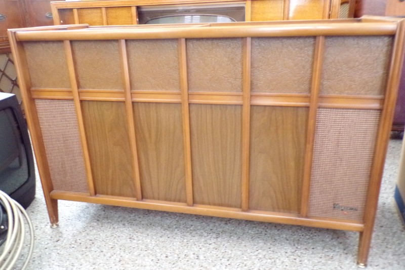

This is my smallest, cheapest Magnavox console stereo. This was/is the wife's daily driver for eons. The only thing I have ever done to it is to replace the half-dead 6EU7 in the tuner. It has most of the factory dust and cobwebs still intact. It has an unknown/un-remembered model number tuner, but it is one of the 6-tube models, typically referred to as the Series 100 tuner. This little stereo is an extremely late, mostly coded the 31st week of 1963, 1963 model. It is as close to an Astro-Sonic as you can get and still have tubes. It has an 88-03-00 amp chassis, equipped with a uniquely configured Molex connector. The amount of terminals are the same and in the same order as the older models, but the connector itself is smaller and has round terminals instead of rectangular. So it requires what is probably a late-1963 model-only Multiplex adapter. I may have to find a proper Molex connector and terminals, then modify an older MPX adapter to work. The speakers are coded Chicago Telephone Supply, the 31st week of 1963. It has a 12" and two 4" speakers per channel. It is your typically robust performer typical of the little Magnavox instruments. It suffers from horribly dirty tube socket contacts, dirty controls, and wonky FM performance at the top end of the dial. It pulls 59 watts, is rated for 150 watts. Somebody before I got it replaced the original Collaro changer with a foreign-made two speed belt drive changer with a magnetic cartridge. Volume has to be run fairly advanced to get adequate volume. Of course, they hacked the Molex connector for the changer, so I need to find one of those. I have a suitable late Collaro changer to replace the one in there now.

I think this one was a touch under $300 new. It has the coolest-running power transformer of any of my Magnavox stereos. I ran it for about three hours at 125 volts on the line and it was barely warm. I think I'll add a fuse and do a tune-up on it. Whomever replaced the original changer, also tossed the shelf between the amp and the changer. It's only Masonite, so I should be able to make another one. I need to remove the changer that's there now and find out if they hacked the plinth. If not, the swap should be straightforward. The amp has a 6CA4 rectifier that does not set right on top of the PT, so that may help the transformer run cooler.

I also really like the cabinet styling.
Re: Magnavox 2ST653 console stereo evaluation
Posted: Sun Feb 26, 2023 11:22 am
by walyfd
That's a clean style. Also like the lighter pecan color.
Posted: Sun Feb 26, 2023 6:43 pm
by Firedome
looks like the audio version of the "aircraft carrier" behind it, nice style.

The sticker says the finish is "LT WAL". I reckon that to mean light walnut. I'd say pecan, but whatever. ;)

The sharp eyes on this forum have not mentioned that the cabinet on this little stereo is a dead ringer for the 20" longer and 3" higher cabinet on the Stereo Theater.

"The sharp eyes on this forum have not mentioned that the cabinet on this little stereo is a dead ringer for the 20" longer and 3" higher cabinet on the Stereo Theater."
Ummm... look 2 posts above!
"looks like the audio version of the "aircraft carrier" behind it, nice style."

Perhaps it is I who should get some sharp eyes? Sorry Roger. That aircraft carrier is something I put more time in than I typically did restoring a car. It is only 60" long, so it's fairly compact by aircraft carrier standards. ;)
