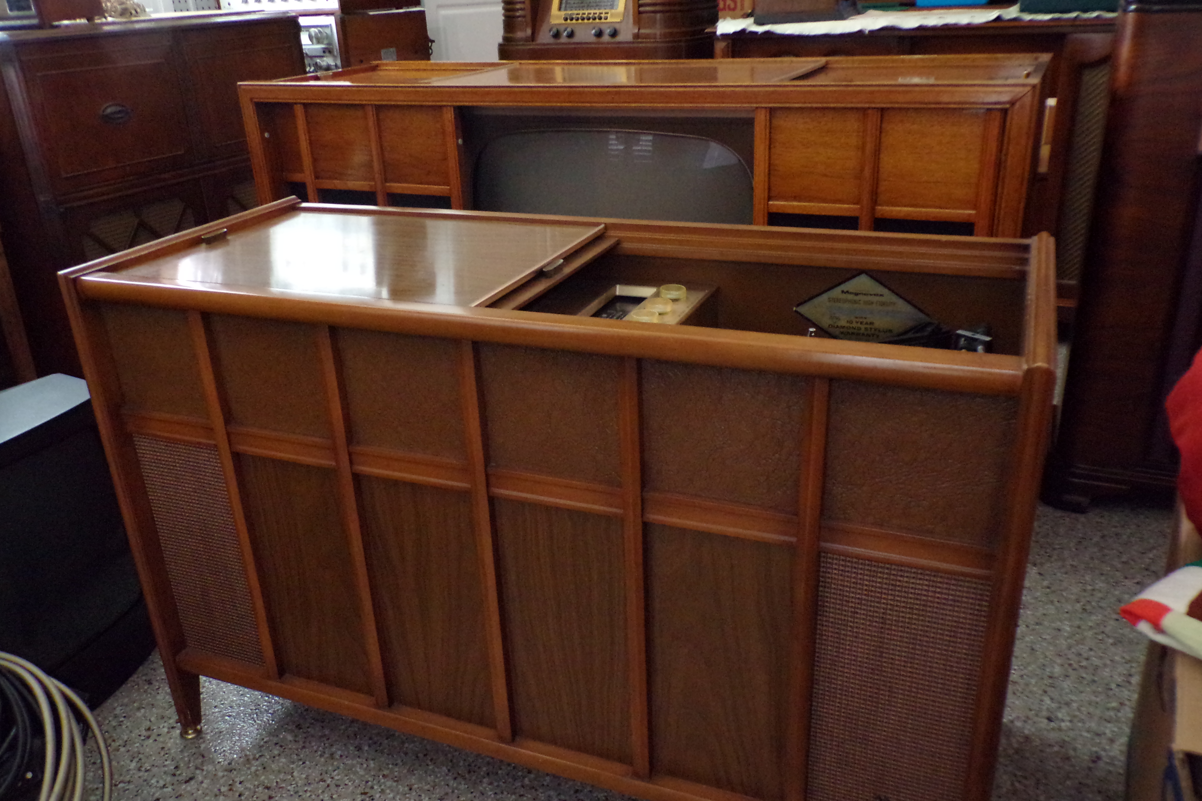

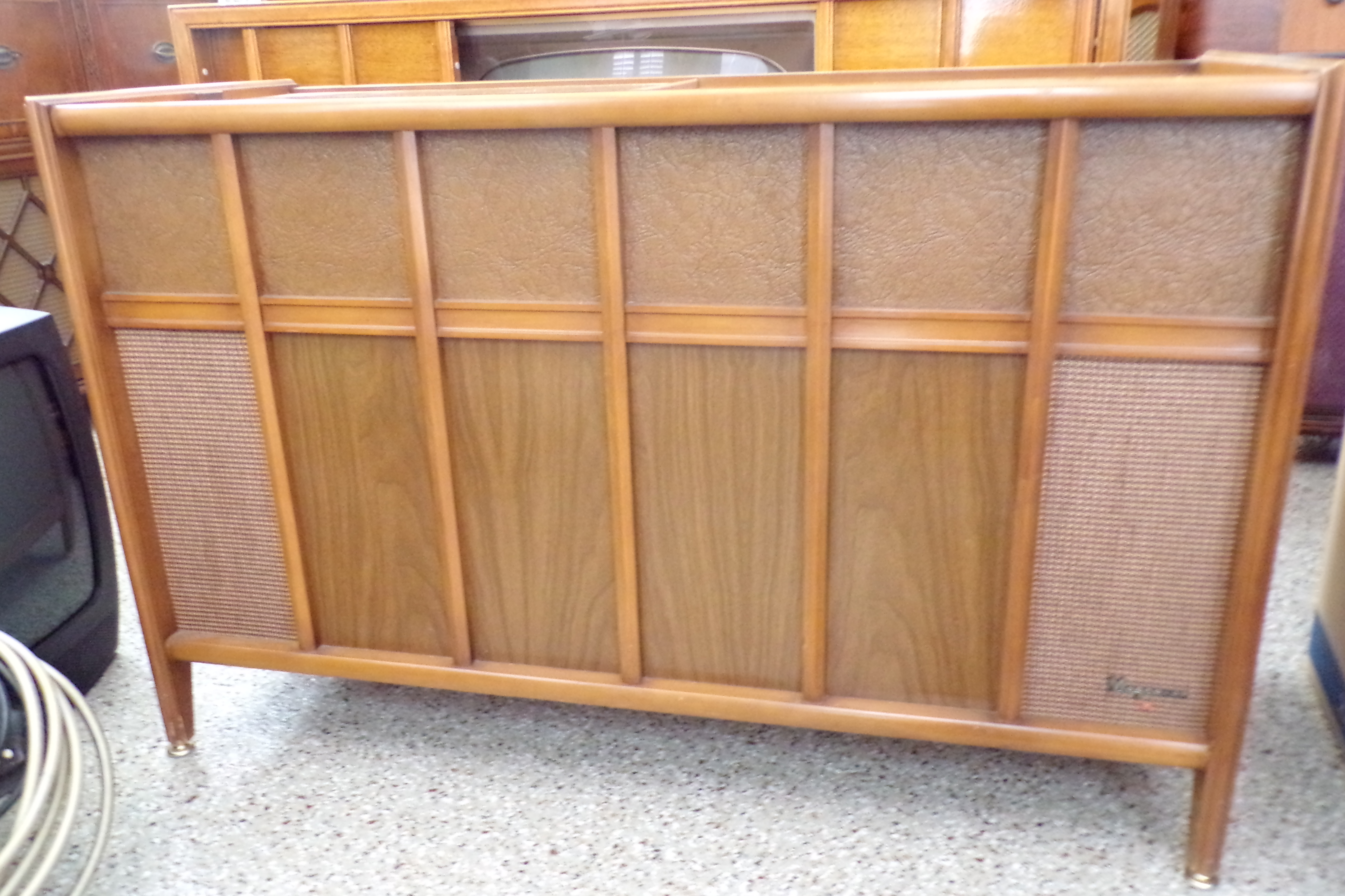

Compared in size to the Stereo Theater

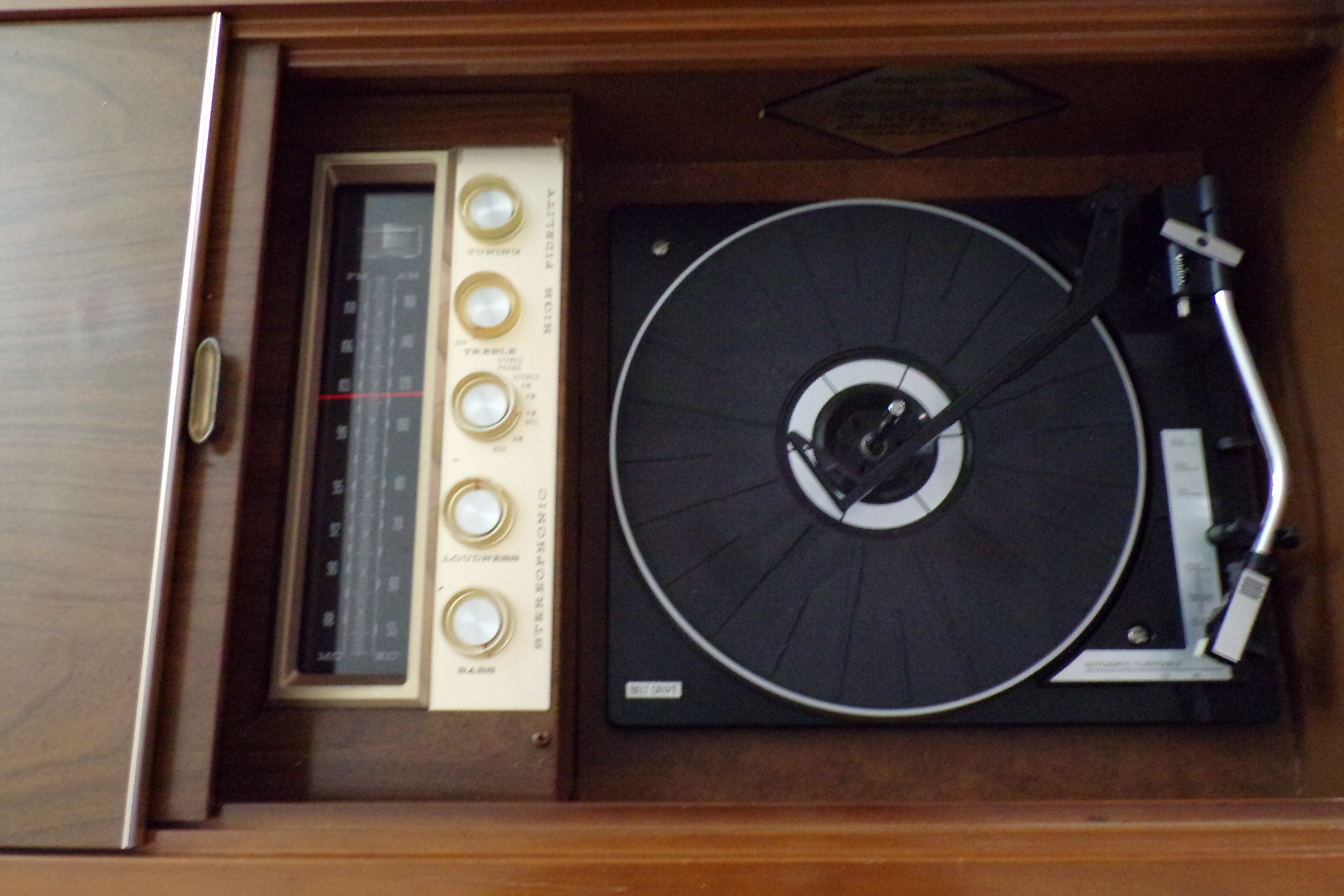

Unique knobs with Astro-Sonic trim and the aftermarket changer.

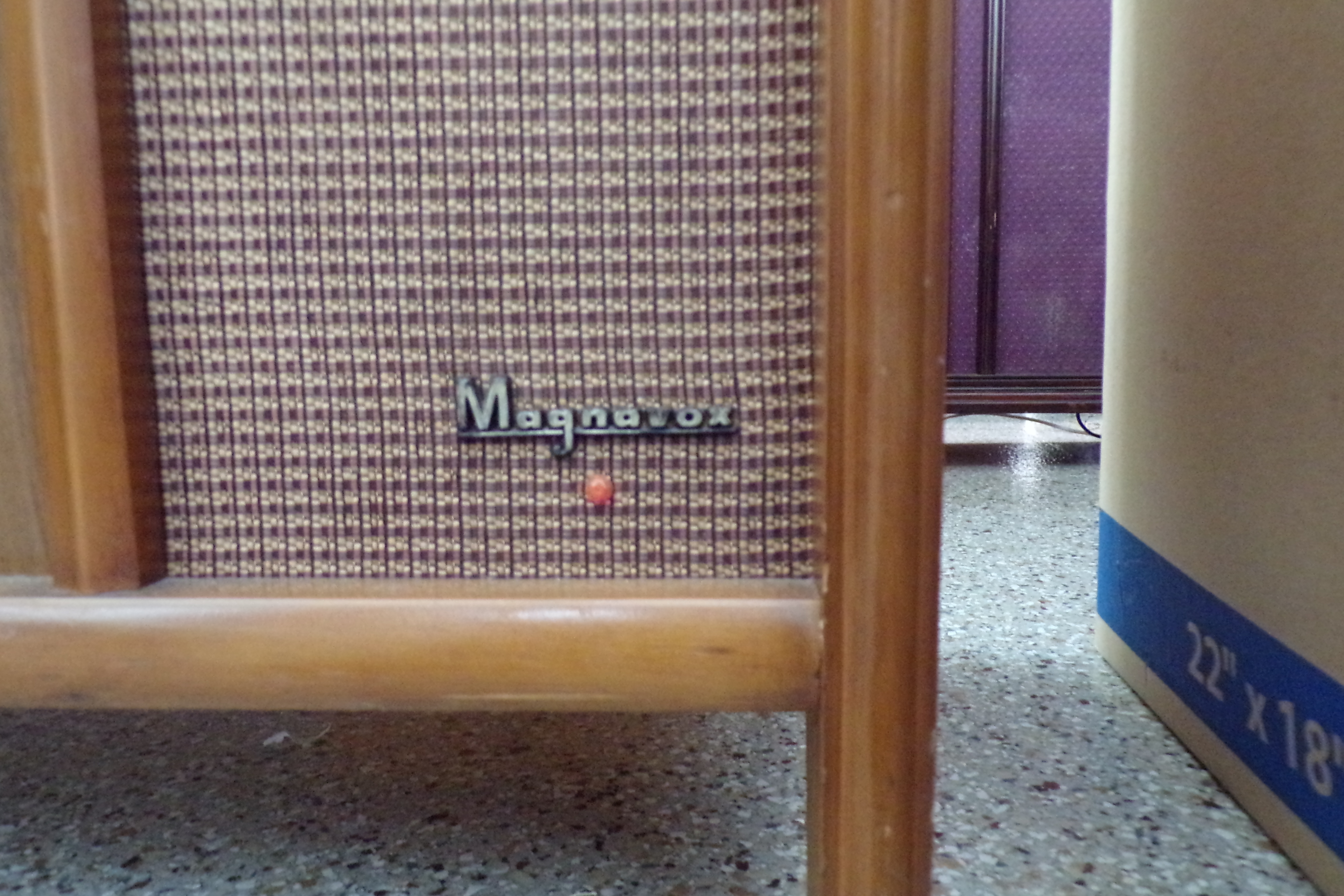

Magnavox emblem

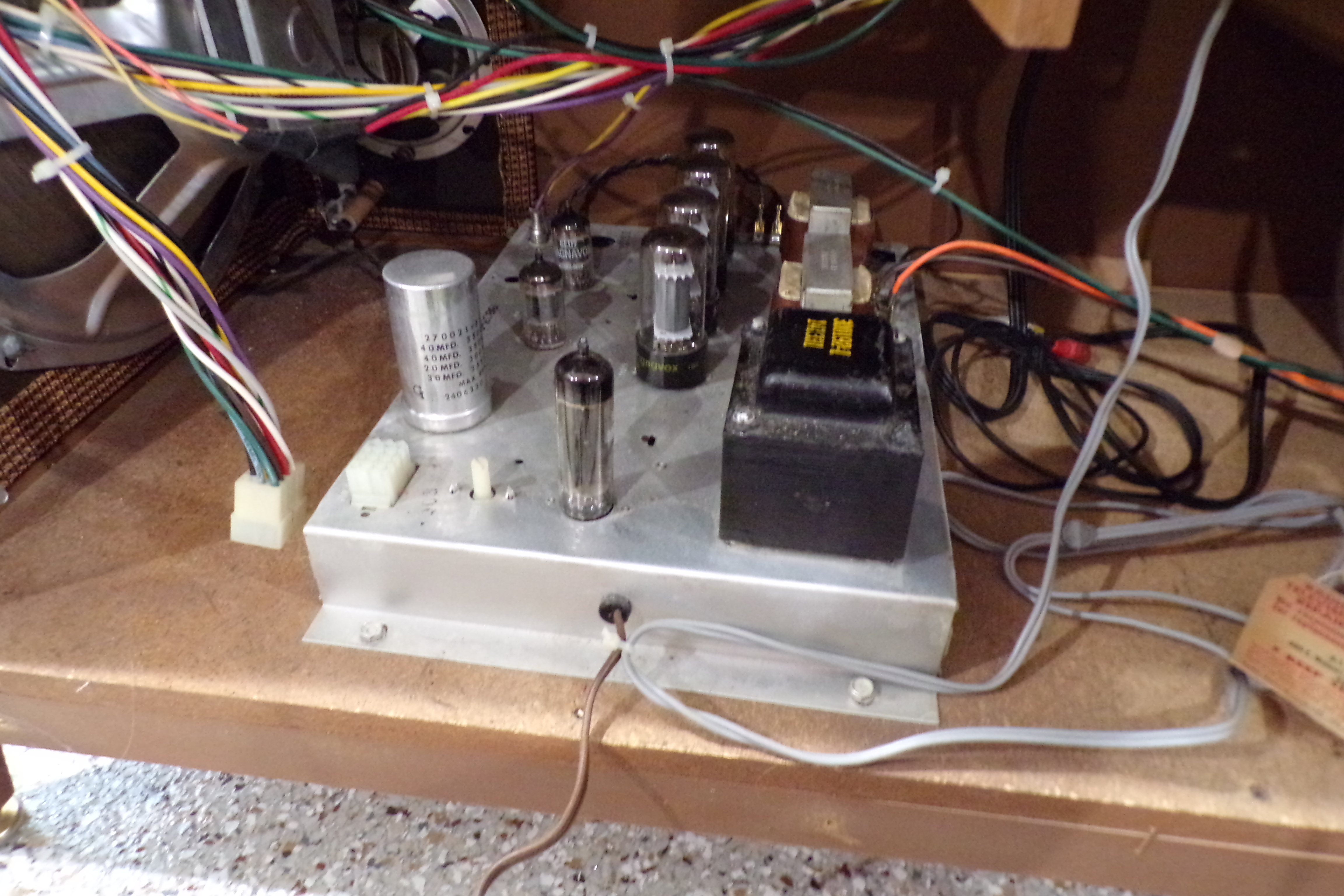

Amp chassis and dangling wiring. The tuner has connections on top of the chassis rather than on the rear apron.

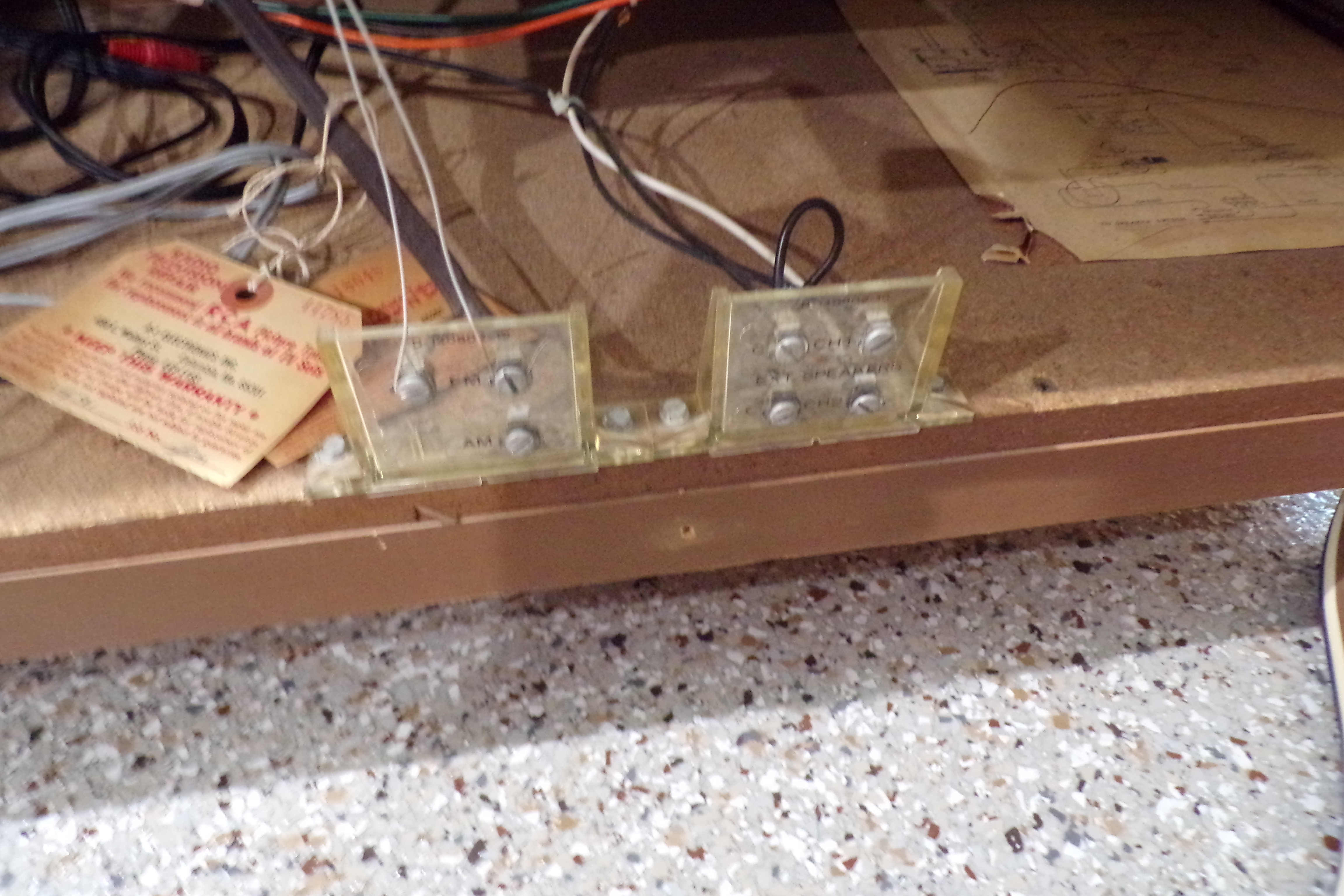

Magnavox finally put the external speaker and antenna connections in a spot not connected to the rear cover.

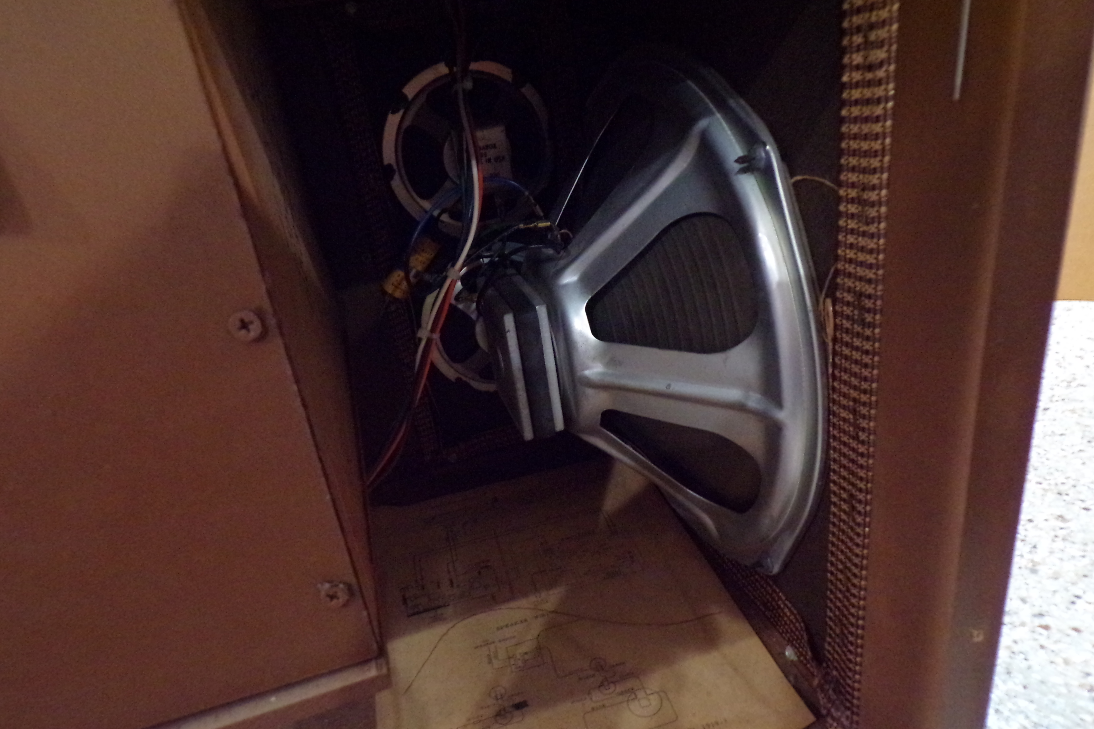

Speakers

It has the same speakers as my Columbia/Magnavox, but mine is single ended 6BQ5's. I do not have the tuner; my controls are on the front of the unit. One of these days I should look up what the Magnavox model number is. I just looked it up. It was called the Aristocrat, model 1-SC268F and sold for $199.50 in 1959.

No pre-amp. It works, just not very loud. That's why I want to put a correct changer back in.

looks like the audio version of the "aircraft carrier" behind it, nice style.

The sharp eyes on this forum have not mentioned that the cabinet on this little stereo is a dead ringer for the 20" longer and 3" higher cabinet on the Stereo Theater.

Perhaps it is I who should get some sharp eyes? Sorry Roger. That aircraft carrier is something I put more time in than I typically did restoring a car. It is only 60" long, so it's fairly compact by aircraft carrier standards.

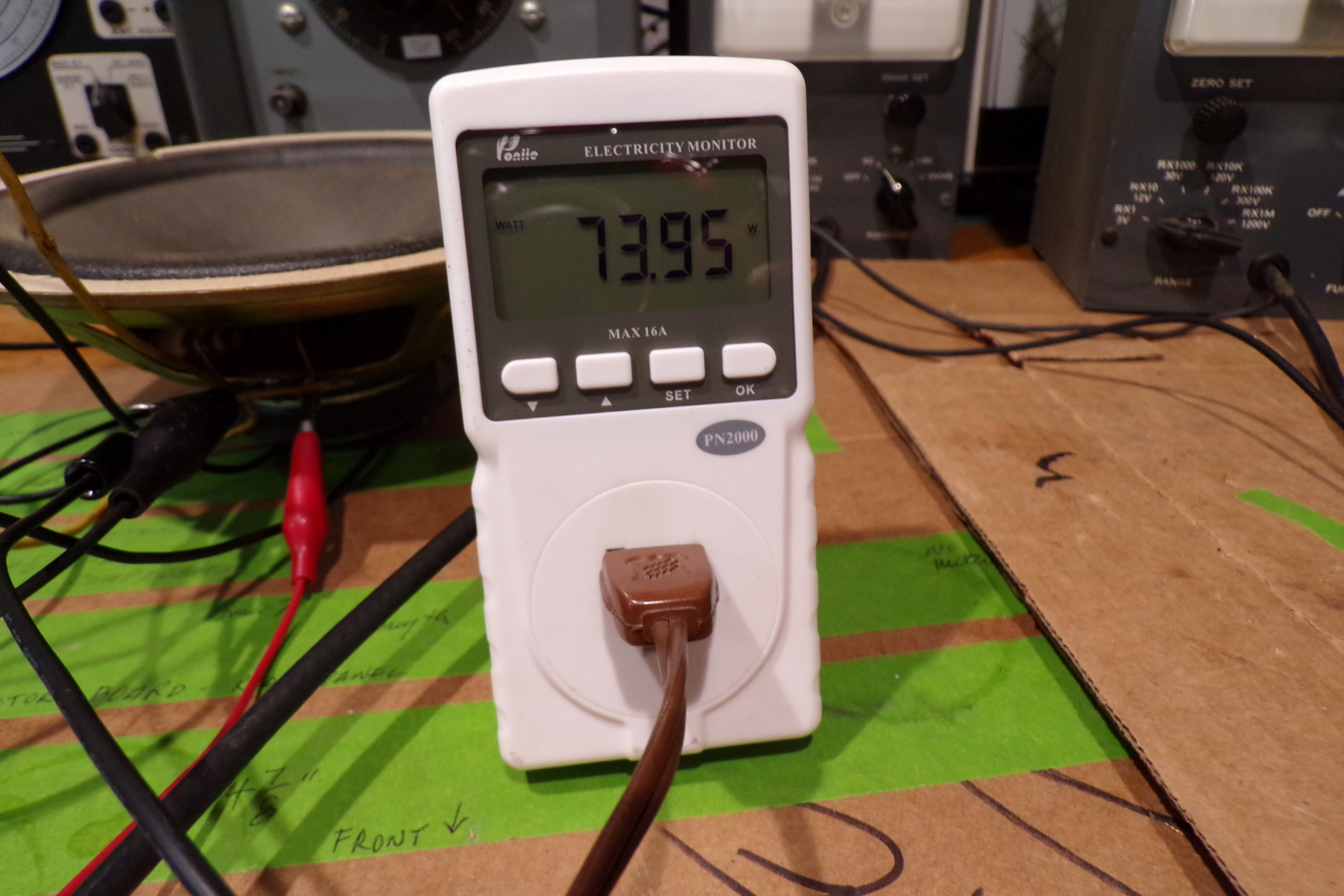

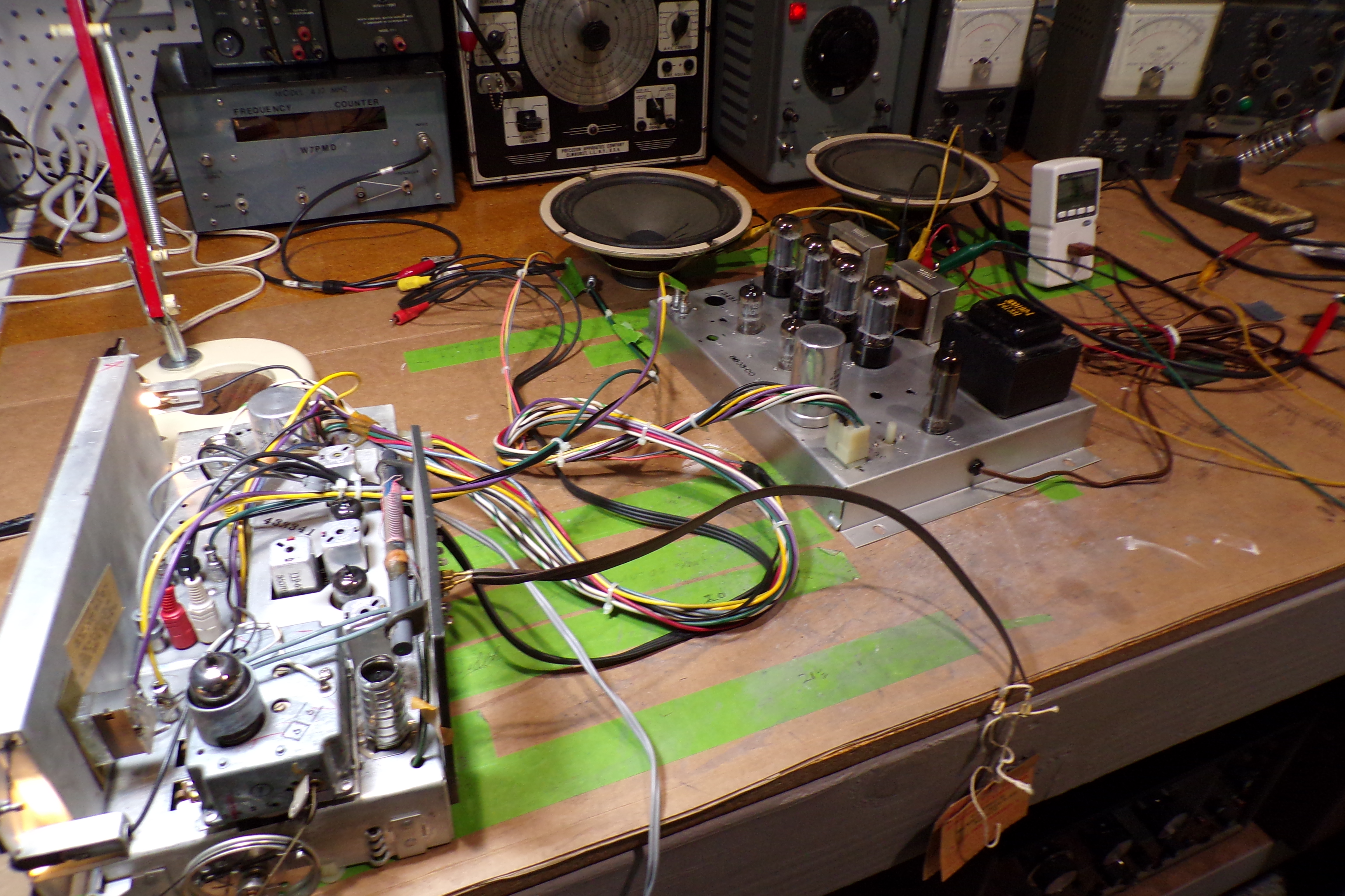

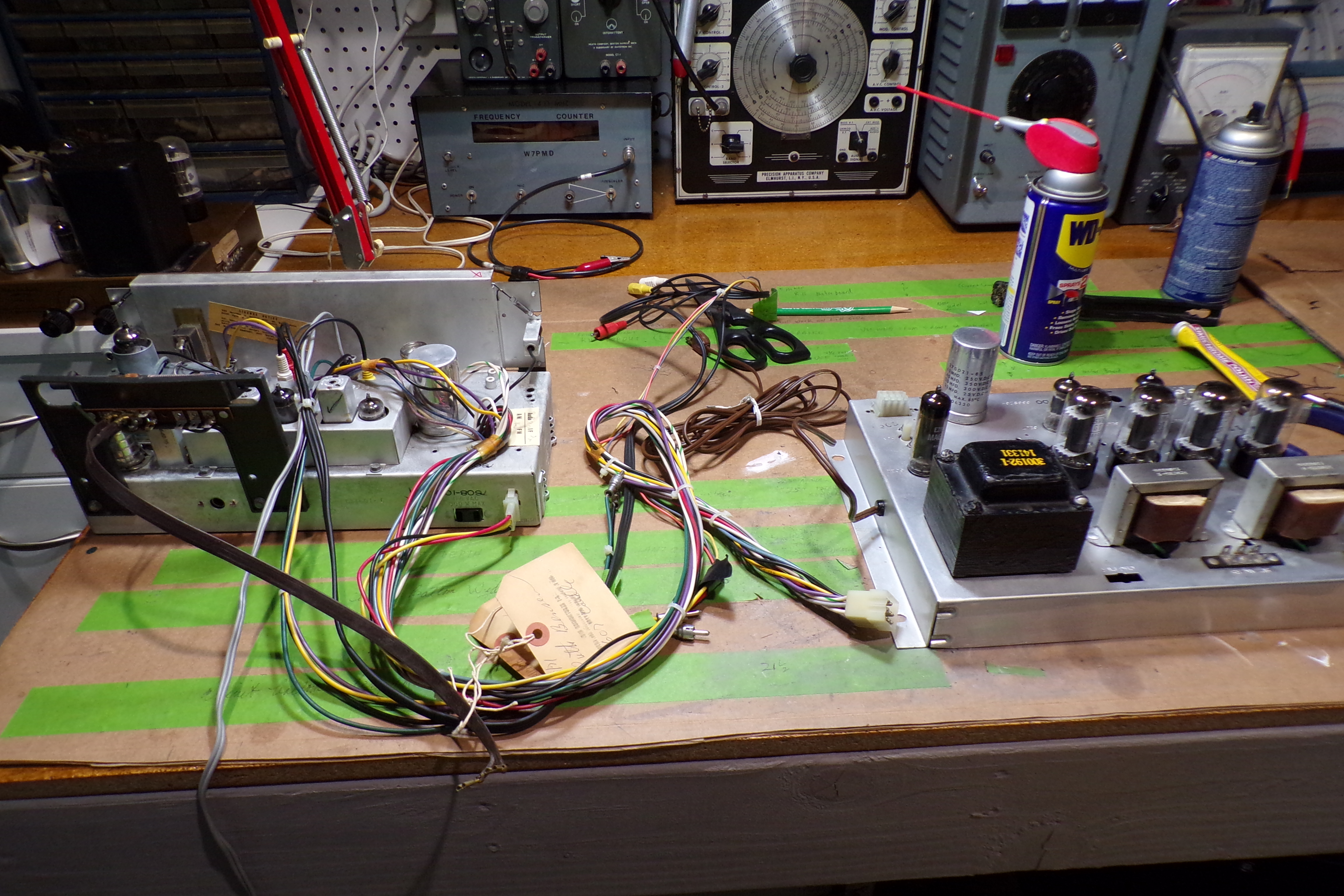

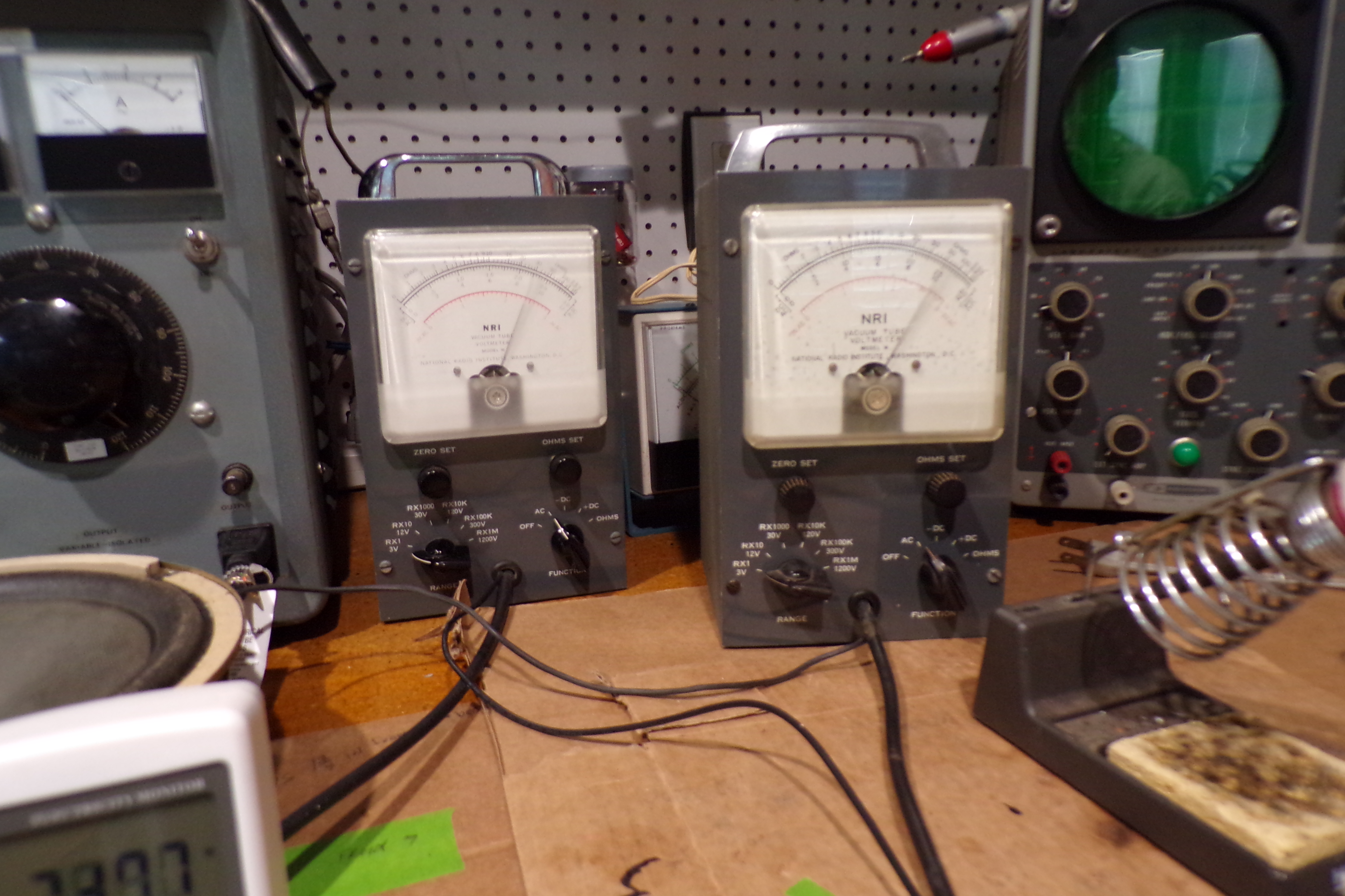

With the exception of installing a fuse in the amp chassis, I'm done with the electronics. The outlet on the rear apron of the tuner chassis is switched, both from the main power switch on the treble control and the switch on the record changer. I have the replacement changer setting in the cabinet. The original plinth was not hacked, a new one sat on top of the original. I need a Molex connector for the changer power and some suspension springs. I thought I had those, but, alas, I don't. I will try to find a stand-alone Multiplex adapter. Surely somebody has one they aren't using. I also still need to go thru the changer. I don't remember if it works or not. It's pretty nice cosmetically. I believe it has an EV 132 cartridge, but don't quote me on that just yet.
All the guts spread out on the bench.
Adjusting the balance to get both channels set right. I even used identical VTVM's...

Power outlet on rear apron of the tuner chassis to power a Multiplex adapter, switched.
75 watts power consumption, give or take, not including the changer motor.
I believe a 1-amp fuse should be about right.
