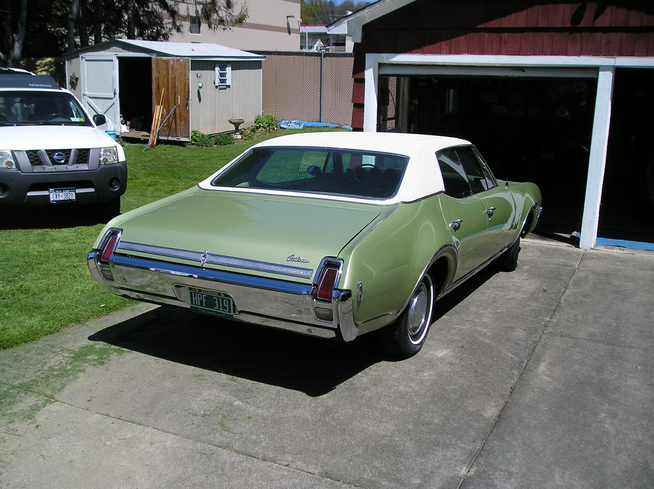

I've been using Fusick since the '80s. They're OCA members since the earliest days of the club and Mike has gone the extra mile to repop Olds parts when they go extinct, even with parts with very low volume sales. I just got a couple of GM-licensed fender badges for my '69 from them and the rear repro bumper I got last year was perfection. He's one of the good guys in the car hobby and not just in it for the bucks, unlike those big vintage parts houses, you know who I mean.
