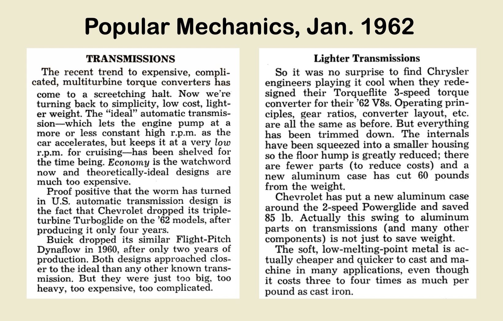

Here's a good little piece by PM I just found:
the "theoretically-ideal" design they are talking about is a CVT. It was ahead of it's time.
I don't like driving a CVT but they are more efficient (gas mileage) which is why they're being widely adopted.

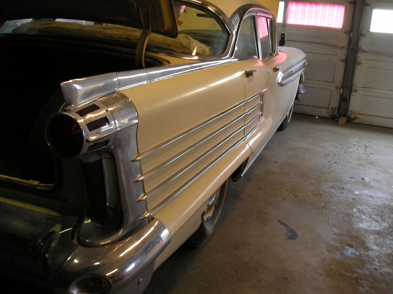

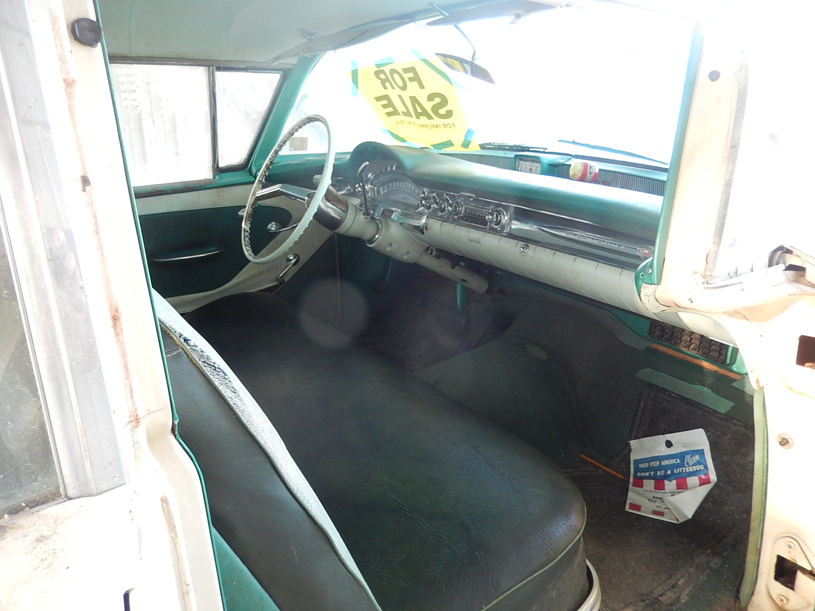

About the same time I had my '58 Olds 88, white with green/white/black interior. Had I kept it (sold because no PS and no A/C and I'm getting old!) it would have gotten this fabulous factory combo Heather and Rose Mist 2-tone with it's existing green interior...I still kinda wish I had done it.
