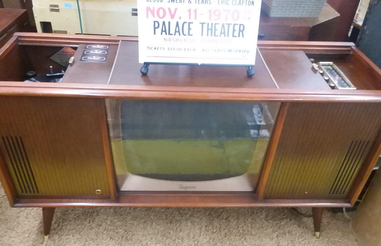

This is more of a thread about a unit that has been sold by a friend of mine. He got it in NC 3 years ago and finally had interest in buying it, so it got tested kind of. He was almost ready to deliver it, unrestored but functional and it did not power up.
It is still at his flea market booth and he asked me to have a look when I was in yesterday. First problem was the AC cord one conductor rip-separated at the interlock, not usable. I noticed a Bluetooth receiver plugged into the tape input on the series 100 (non mpx) preamp/tuner. He will need to power it and I suggest an AC cord connected direct behind the interlock also to a wall-wart for power to BT receiver.
Powering up like they tell us not to, radio worked fine on AM-FM, no hum but one side of the amplifier was almost dead. I swapped the original 6BQ5s, reconnected speakers that were hooked up wrong, none was the problem of course :roll: I need to pull it out for a test and partial recap if the electrolytic reformed. I even have a spare from a 1ST223, AMP 86 or 96? 6EU7 to 12AX7 convert?
The Micromatic record player had a new cartridge but the stylus was loose in its sleeve mount and needle was spun half around :? The motor did not spin but was getting power. I asked him to get his player repairman to give it a goin' over, so I dont have to.
Finally, the TV did come on :) and seemed to be bright with a full raster. It might just be OK if they don't plan to use it for long hours, certainly not left on over 2 hours. I will bring a signal source to clean pots/confirm all adjustments and no tubes are failing.

Had to play TV man, then found a bad damper tube after it worked last week :? then I fixed a stripped thread on one of its legs. I could supply 100% spare tubes to go with this TV, using such common types without a second thought. :lol: TV chassis C36-23-11

Here is an update with a picture of the C36 (U36, V36,etc) TV chassis, which I removed for some work in shop at home.
Compared to hand-wired chassis in 1960 1/2 Theatre model, this chassis employs the use of printed circuit boards, likely reducing labor costs.
The chassis had a few bad electrolytic caps, some paper caps in horizontal/damper circuits and 5 weak tubes, though many brown/maroon drop caps remain. While these circuits are very similar to RCA, built with better quality parts, still has some sections like the sound which are very different on a theatre model. The 6GC5 tube is used only for a voltage divider, not as the audio output. A plug-in RC network is installed in place of an audio tube using a 7-pin molded socket. This network is used to equalize the TV sound as a mono (low level) input to the preamp and amplifier so it comes out all the speakers. While I could not test the operation at home, I'm confident it will work even better than before. :P
