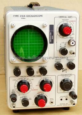

My little scope from my late uncle, also needing probes. I also don't really know what to do with it but it's cute, evidently the smallest Tek tube scope ever made and used by IBM field techs ("customer engineers"). Got all the manuals, so hopefully I can figure out how to use it sometime.

This 310a does have a steady trace with no inputs, and works, I watched my uncle use it about 8-10 years ago to troubleshoot something, but I don't remember what that was. Tek and HP scopes are incredibly well built so often work well into old age.

Firedome wrote: ↑Thu Dec 15, 2022 9:16 pm My little scope from my late uncle, also needing probes. I also don't really know what to do with it but it's cute, evidently the smallest Tek tube scope ever made and used by IBM field techs ("customer engineers"). Got all the manuals, so hopefully I can figure out how to use it sometime.
I have that same scope! It is a great little unit, a real throwback to when tube test gear was built right.
I love how the screen glows a bit after the lights go out. :P
