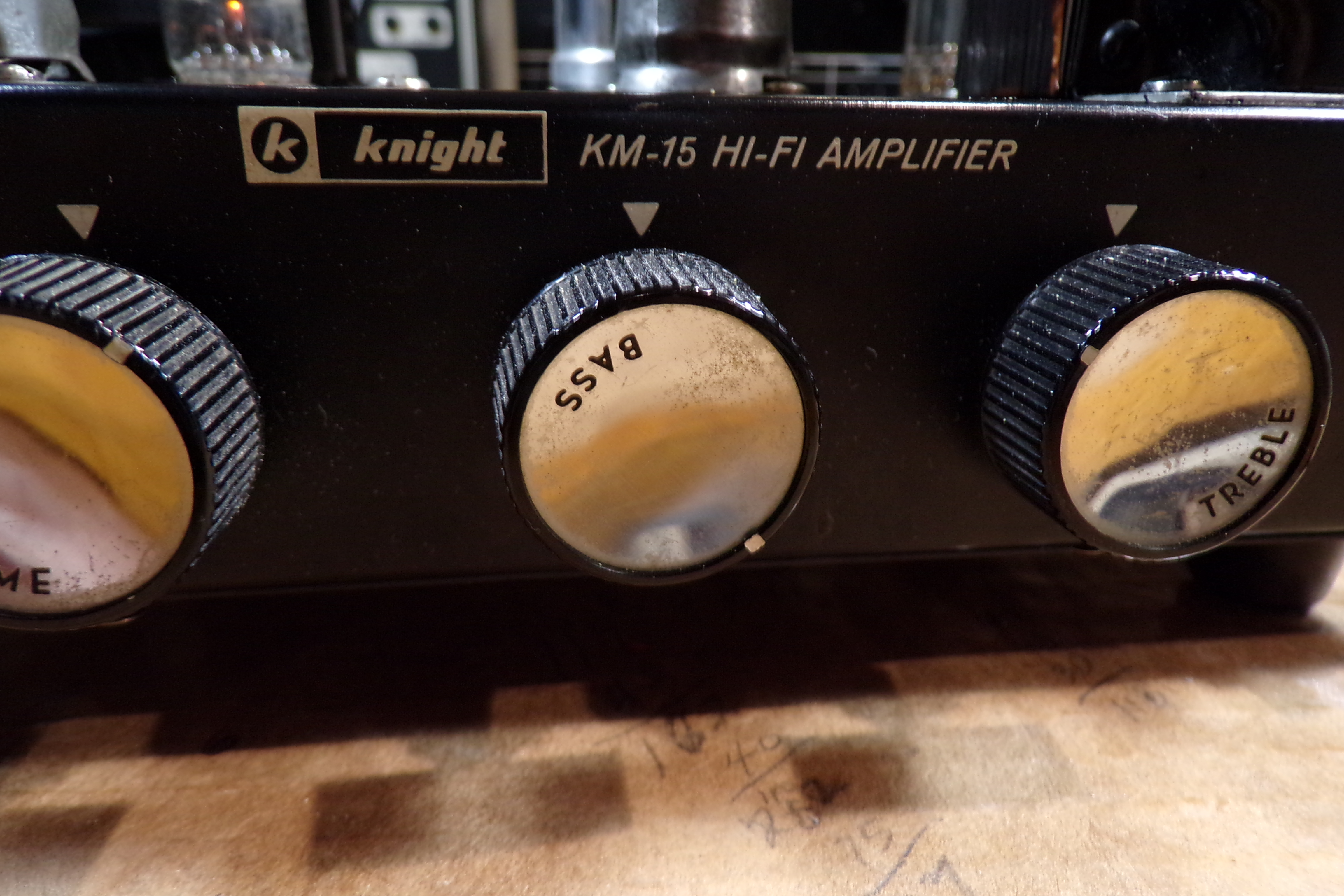

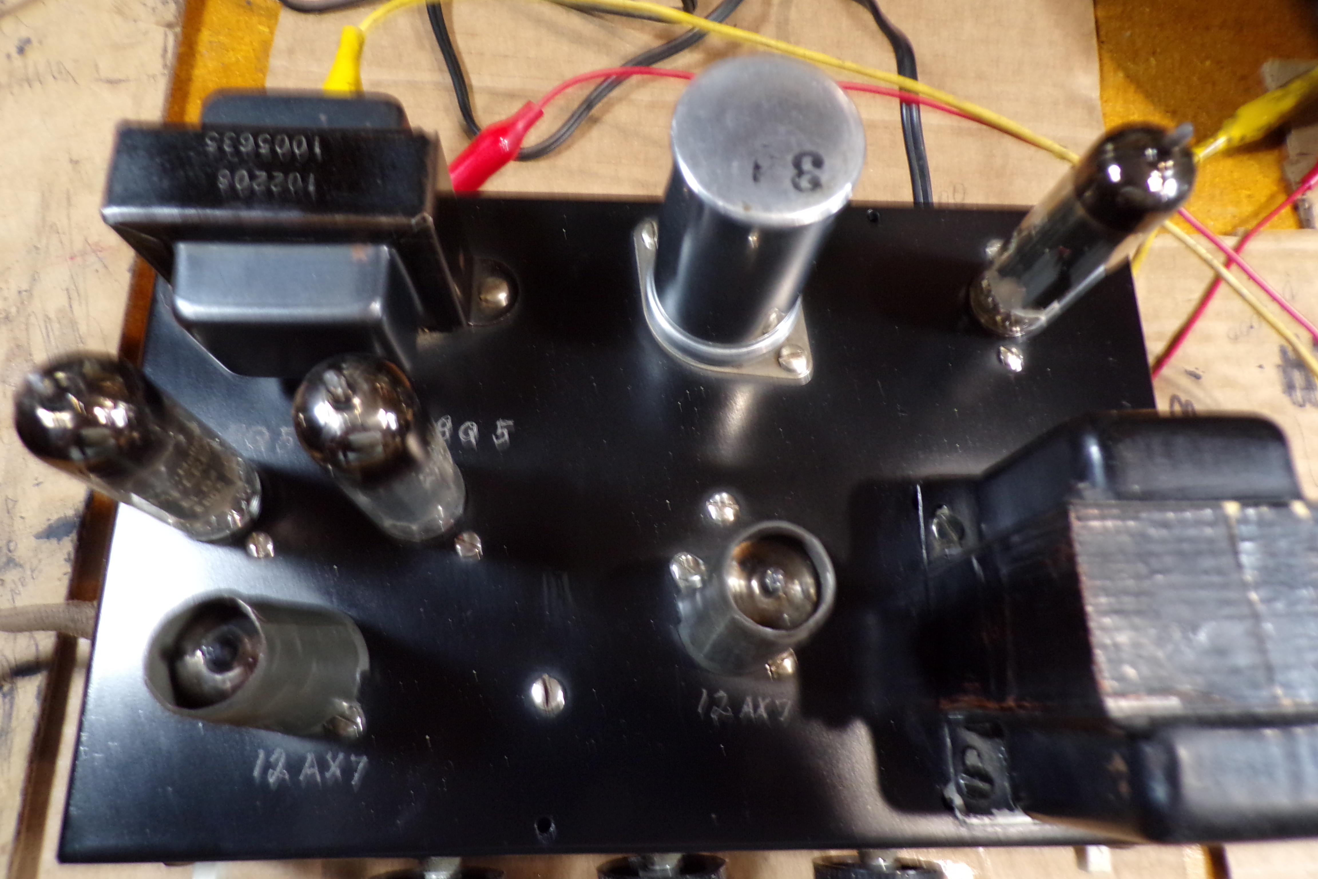

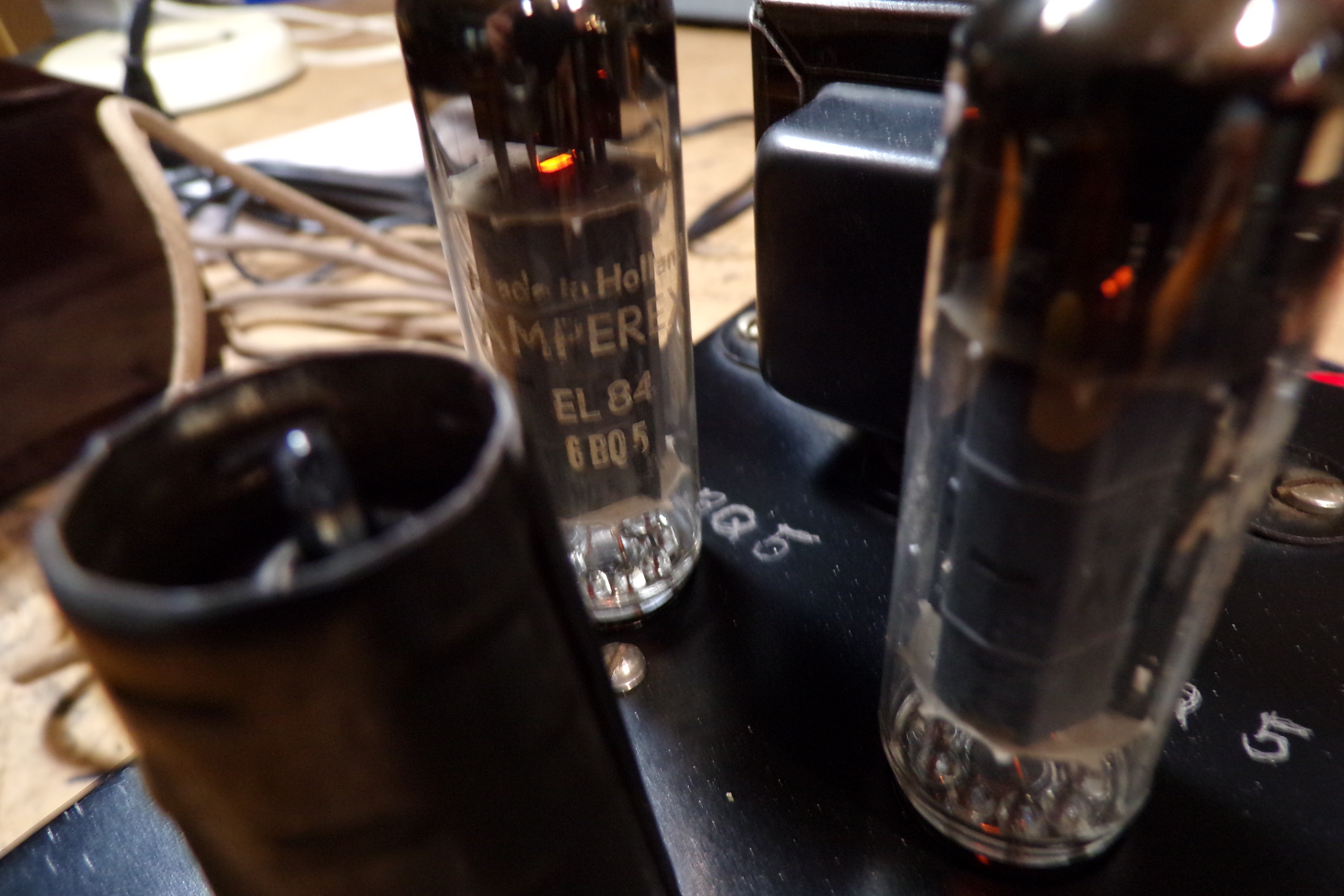

I have had this little mono amp forever. It was my stepdad's and I got it when he passed in 1987. He used it as a bench amp. There is nothing special about it, outside of the fact that it is populated with high-end tubes that are worth far more than it is. It has a PACO-branded Mullard sourced 6CA4 rectifier, one Mullard 12AX7 and one Magnavox-branded, RCA-sourced 12AX7, then a push-pull pair of Mullard EL84, 6BQ5 audio output tubes. It pulls 38 watts in full flight, has a factory fuse in the primary circuit of the power transformer. I recapped the chassis with the exception of the filter caps. I'll leave them like they are for the time being. I'll get some pictures and get them posted.

I have no idea where Sam got this amp. He may have kit-built it. The iron on it is miniscule in comparison to bigger amps. I don't know if the fuse is in all of them or if Sam put the fuse in later. I doubt it, though. That would have cost money. Sam was the second tightest person I ever knew. I can see where it wouldn't take much to take out a PT without some protection. Somebody before me scratched the tube types with an awl and put a 6X4 for the rectifier. The socket is nine-pin, a 6X4 is seven pin.

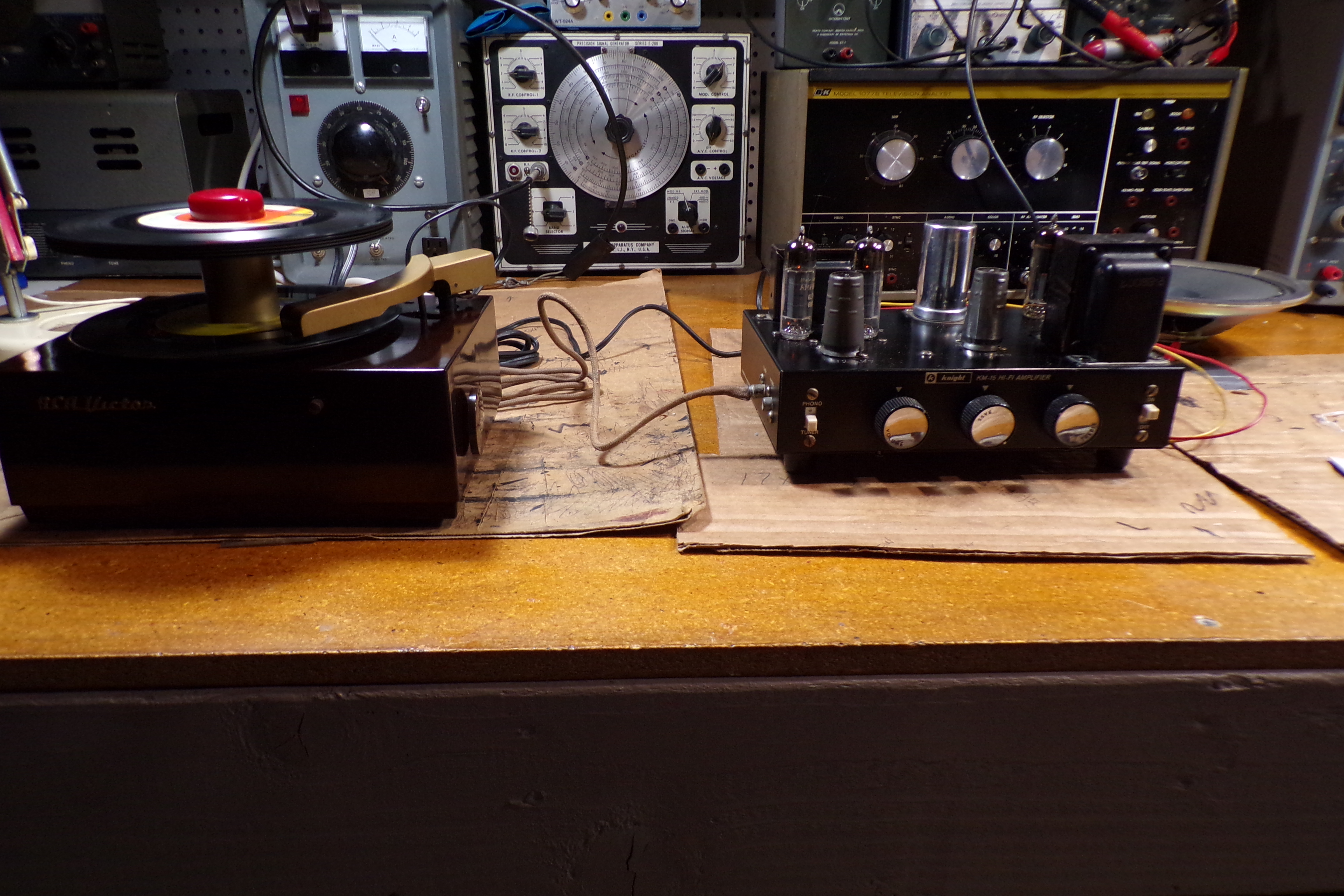

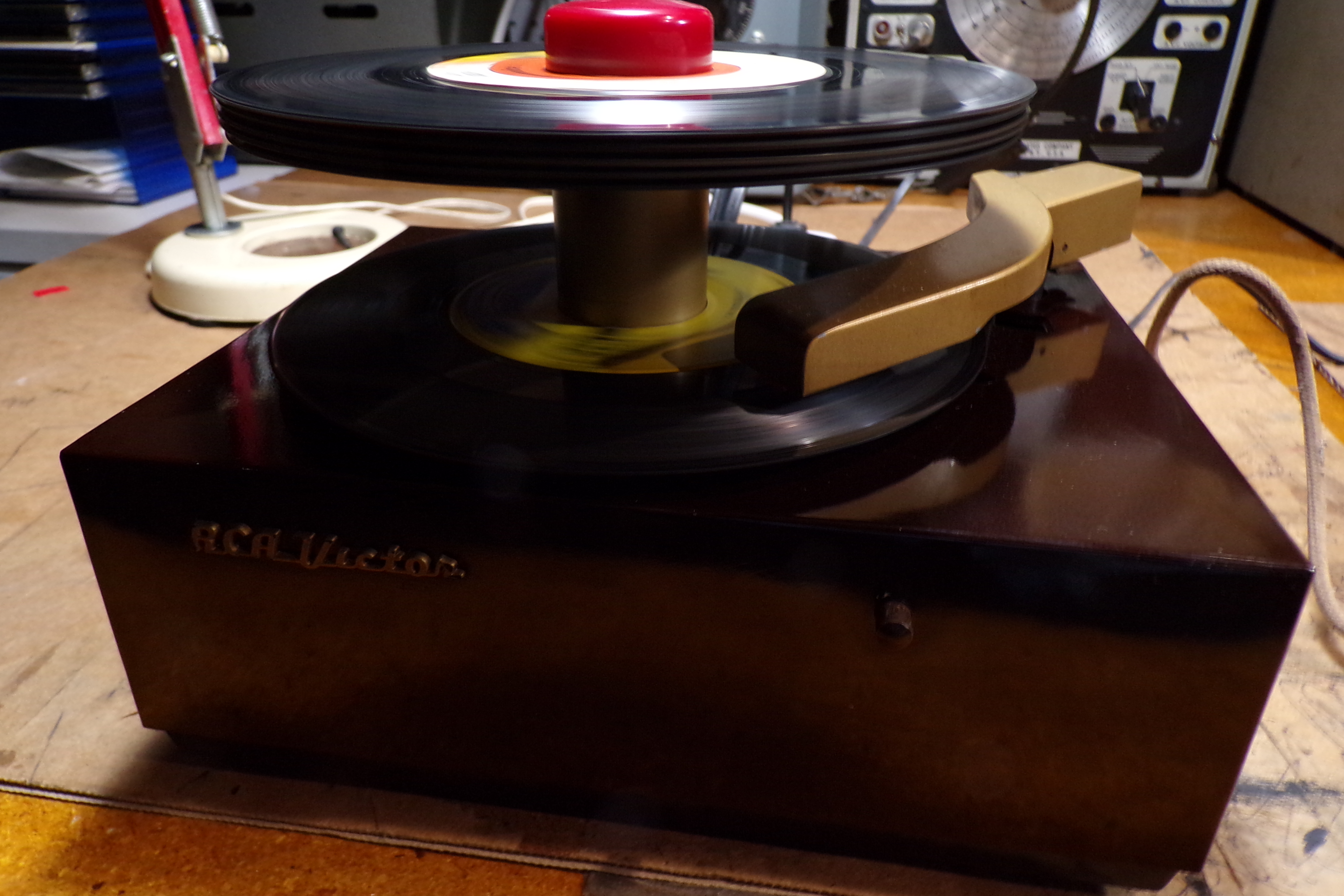

I dug this little amp out this afternoon and used it to play 45's. The speaker I used was an 8" parts speaker, just connected with test leads, laying on the bench. I need to rig up a good mono speaker setup. I fed my little RCA 45 player into the phono input. It sounded horrible, tinny, distorted. I connected the changer to the tape input. There it sounded great. The phono input must be for a low-level magnetic mono cartridge, such as the GE VR series. The ceramic cartridge in the RCA player overloaded the amp. I played 45's for a couple of hours. The little amp pulls 38 watts. I believe it would sound really nice with a good speaker. I took pictures that I will get loaded and on here for you guys.

Try a nice coaxial speaker in as big an 'infinite baffle" (not sealed up) box as your shop allows.
