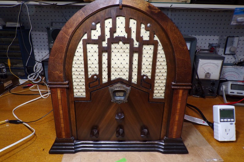

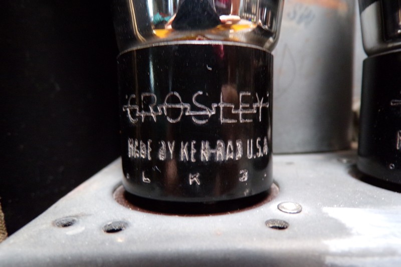

Pictures as promised. Sorry it took so long to get them posted.

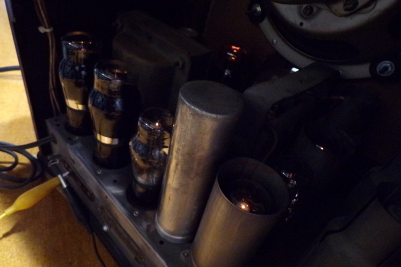

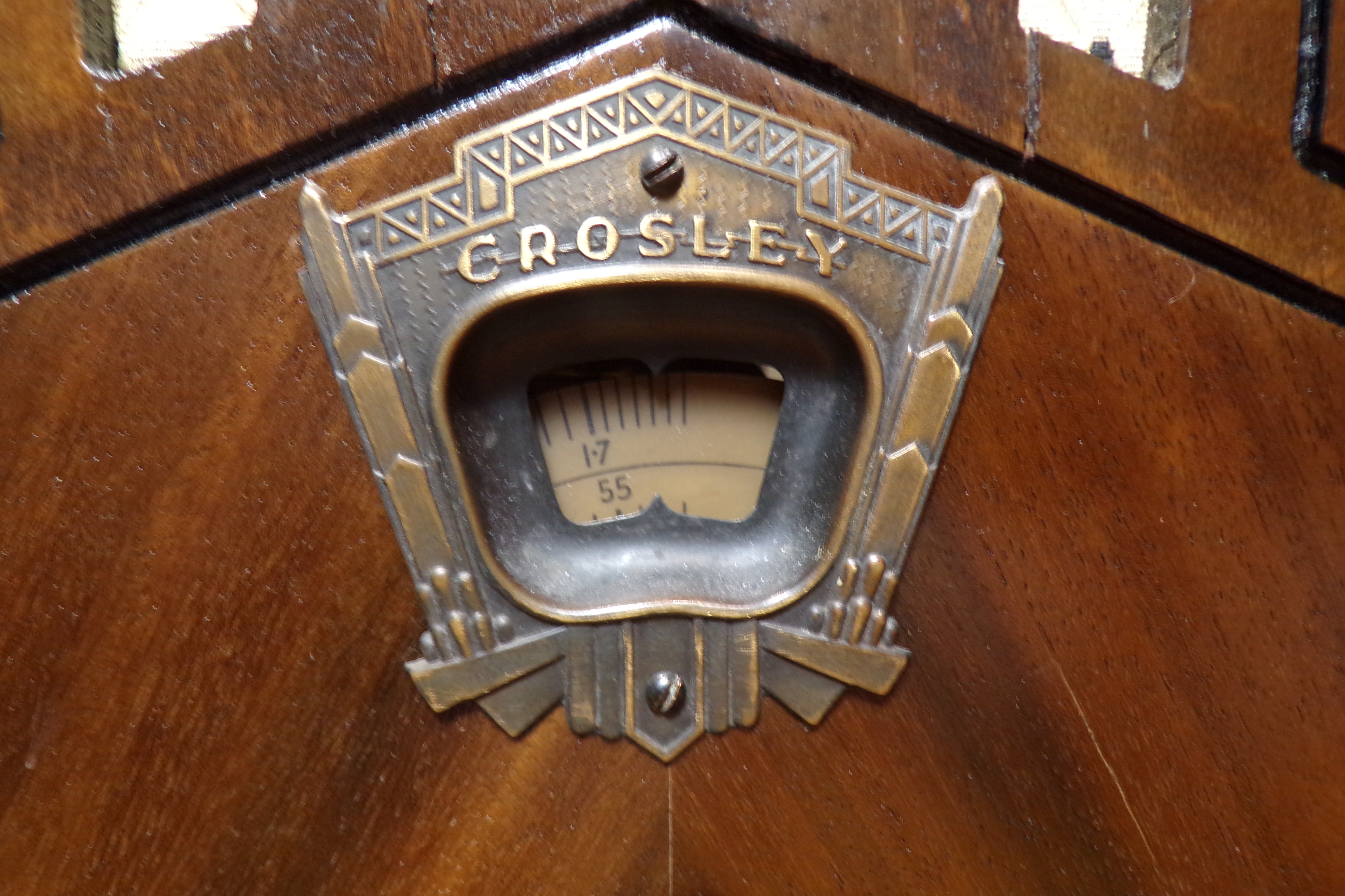

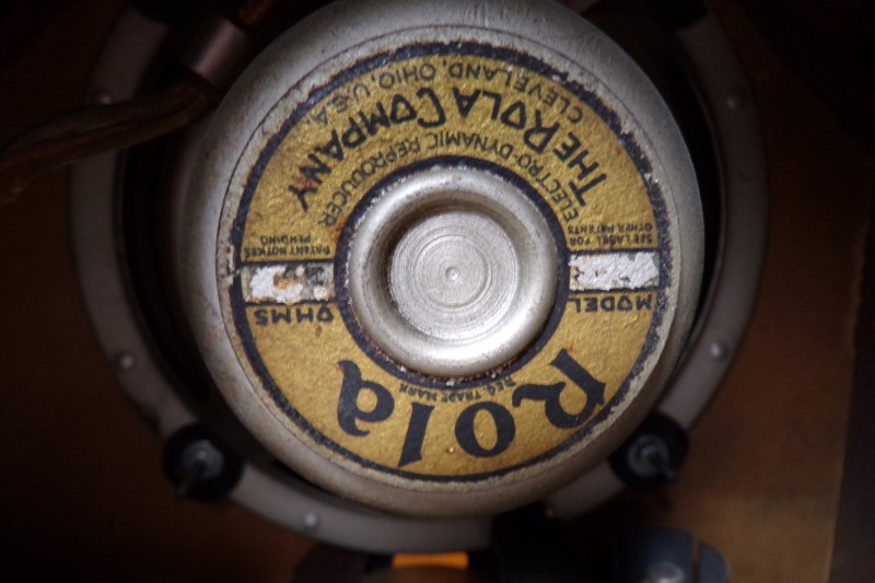

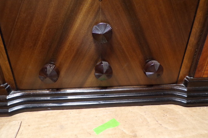

This radio still has many of the original, Ken-Rad produced, engraved Crosley tubes. I got a shot of one of the output tubes. The dial light bulb is kaput, a screw-base bulb. This is the only device I own that uses a screw base tube. I haven't decided if it would be better to have a supply of screw base bulbs I may never use, or to convert the light to a bayonet base. I like Crosley radios and this one is no exception. It's a robust performer with plenty of bass and a good tone. The controls are, left to right, volume control, tuning on top in the middle, band switch on the bottom in the middle, on-off and tone on the right. The 9" Rola speaker sounds pretty good. I have found Crosley cabinets, particularly their wooden cabinets, to not be very good. Ron made supports and pieces to stick this cabinet back together, and I see it's coming apart someplace else. I need to remove the chassis to fix it.

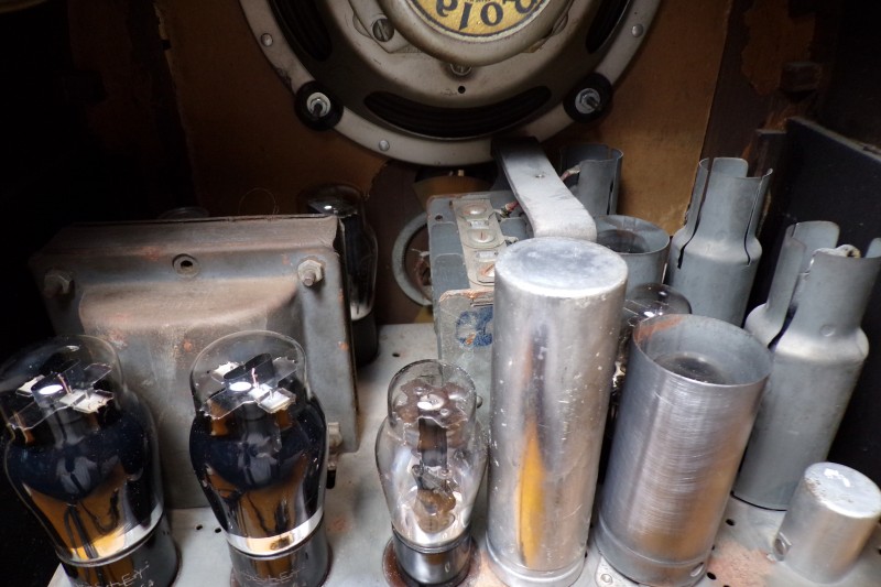

It is a good performer. It's not in the same class as the Stromberg-Carlson or even the big Philcos I have, but it is no slouch. It has a fairly small speaker. There are a couple metal shields that go over the RF part of the chassis, but it shorts out one of the IF tubes that is not an original Crosley-branded speaker. The radio has three #58 IF amps. One is a Tung-Sol replacement. It must be a fuzz taller than the original Crosley tube, because the grid cap hits that metal cover and shorts the radio signal out. I like to never figured out why the radio wouldn't work after I "fixed" it, when I went thru the chassis. I still have the shields, but I don't put them on anymore. You can see two of the thumb screws that hold them on there on the back of the chassis.
