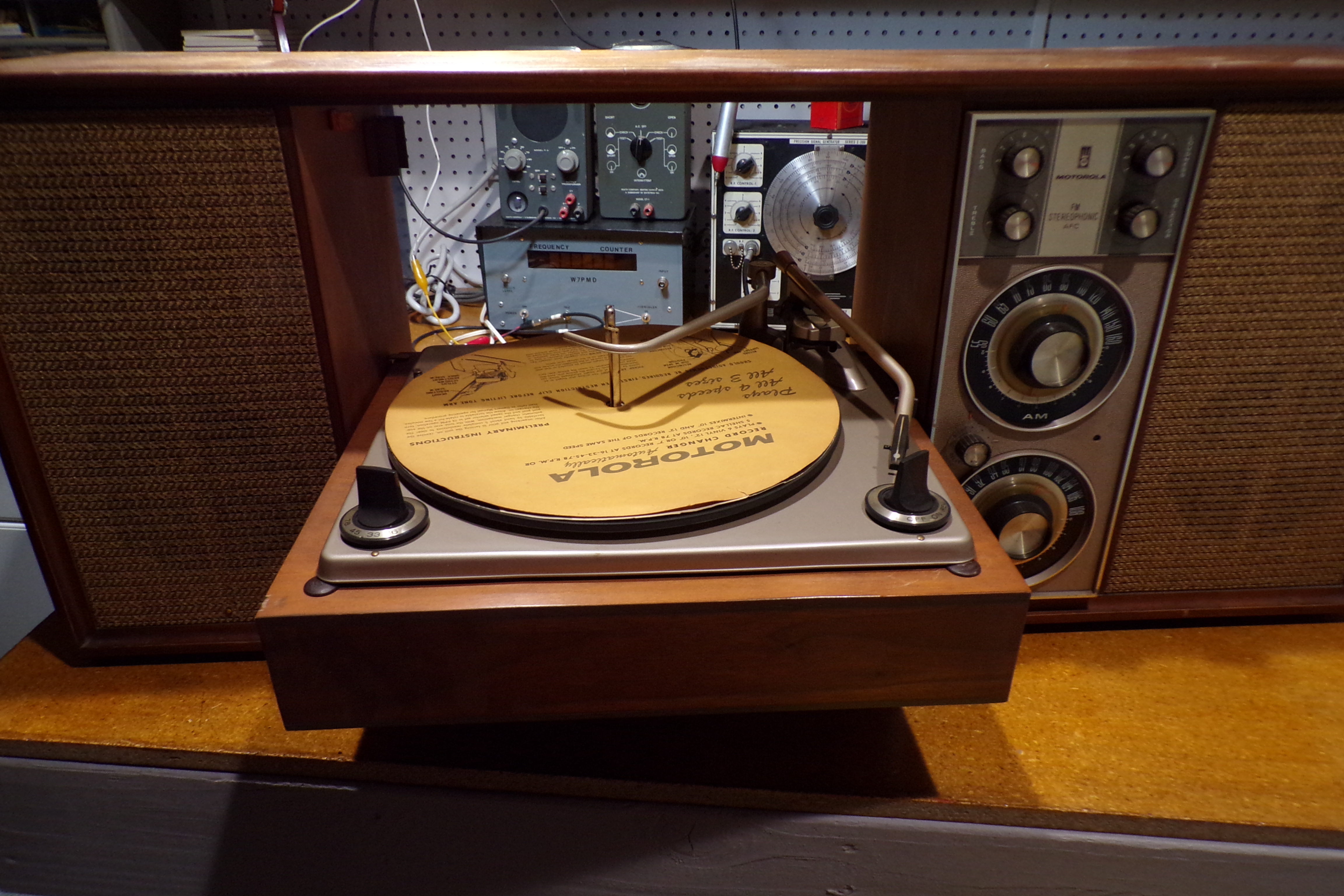

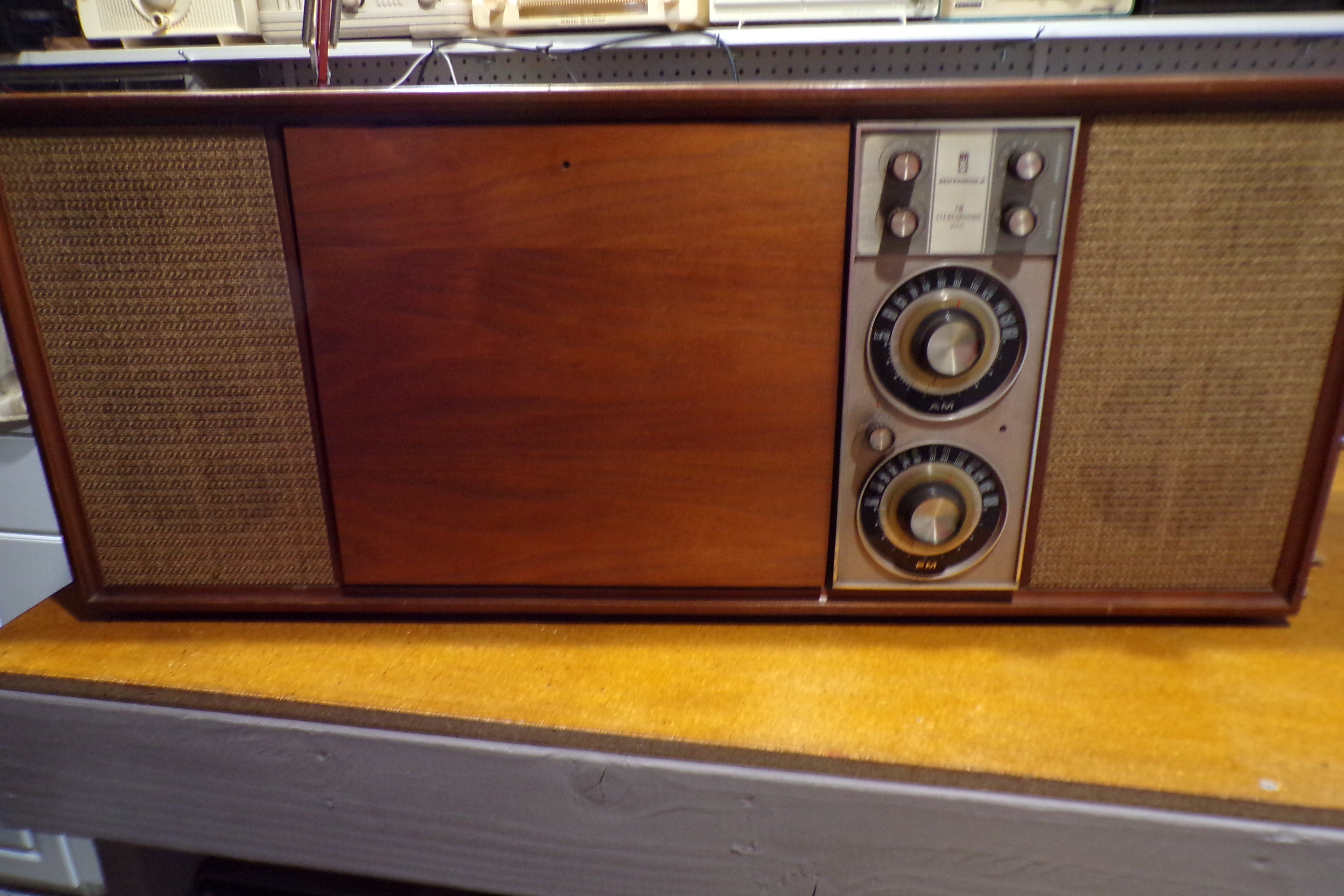

I got this little stereo in a parts car I bought. I bought a '73 big Buick wagon for the engine and transmission to use in a GS tribute car. The back of this wagon was LOADED with "stuff". There was a part sheet of paneling there. Under that paneling was this stereo. I dug it out, plugged it in and it worked, only on one channel. One of the output tubes was dead, a 50HN5. This stereo is circa 1965 with codes of the 46th week and the 48th week of 1964. I also had the console version with the same chassis as this one. It has an eight tube hybrid hot chassis. I have the owner's manual, along with the various hang tags and turntable cover for it. This thing has traditionally been a good performer, although I haven't used it in a few years. IT has a VM 1200 series changer with what I believe is a Tetrad ceramic cartridge. Single-ended 50HN5 audio, rated at five watts. It currently has an extremely dirty and intermittent function switch and the pilot light is kaput. I believe it to be a neon bulb of some kind. This thing needs a good tune-up and cleaning. Probably the changer should be serviced, as well. I have a new needle for it around here somewhere......

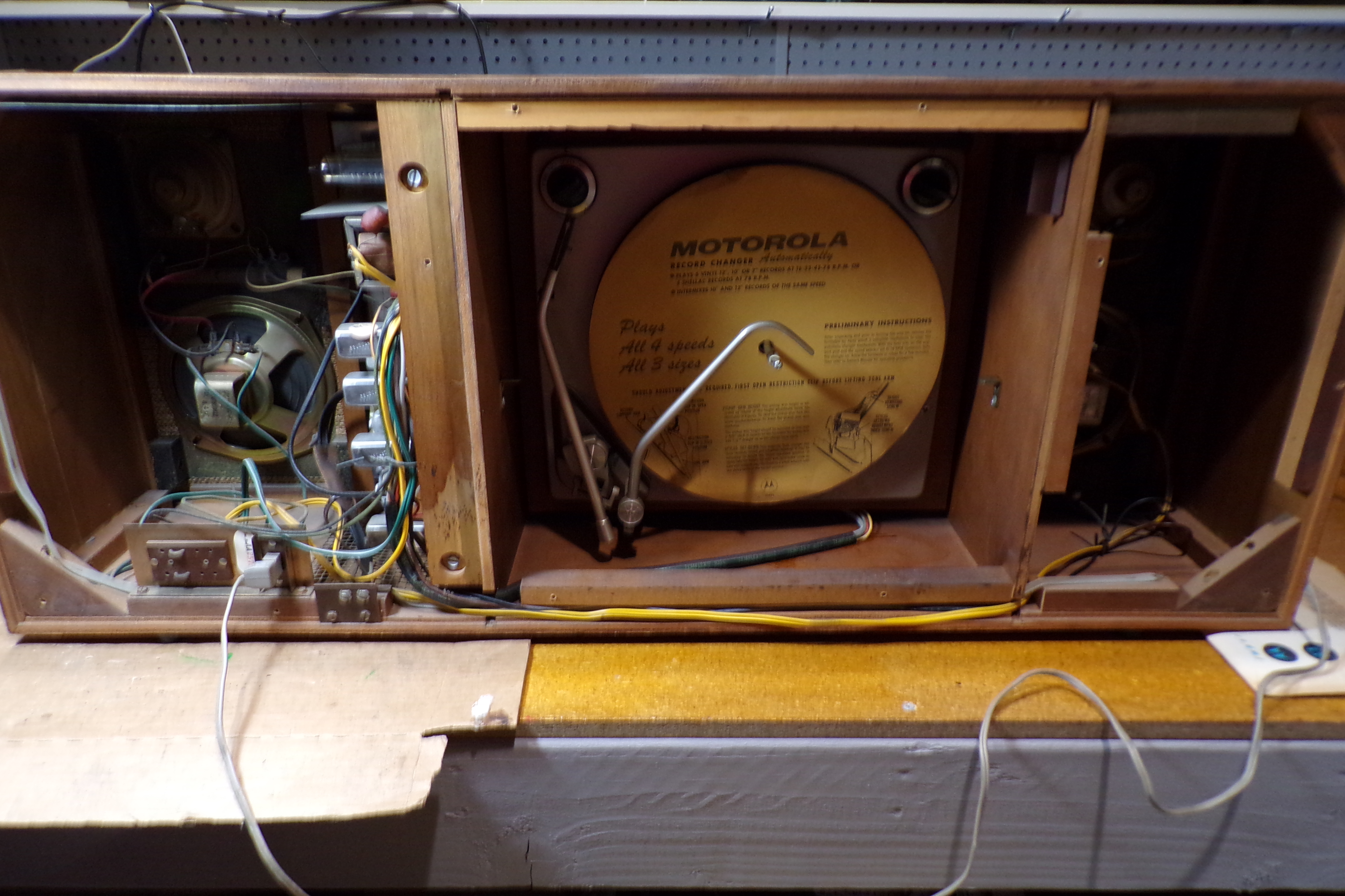

I have decided to take this thing apart and go thru it. It has a lot of little things that need attention. The good side is that the cabinet is all hardwood, no particle board at all. I wasn't expecting that. I am in the process of removing the speakers so I can dig the dust out of them. I took lots of pictures so I can put it back like I found it, and will share those. I have everything out of the cabinet except the speakers.

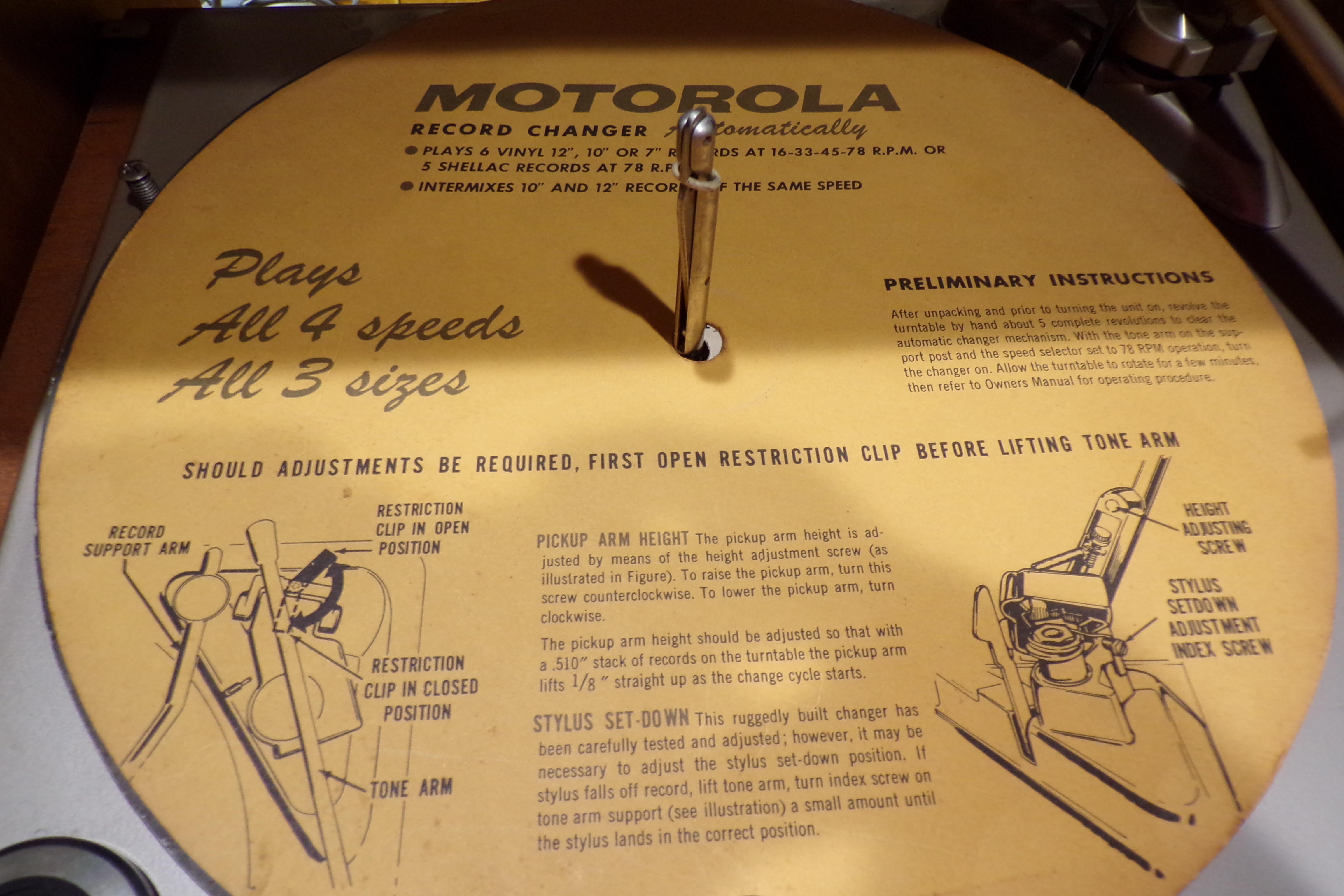

They are very similar, Bill. This one has fixed speakers, and a hybrid chassis, but those are about the only differences. The big plus on this one is the VM changer.

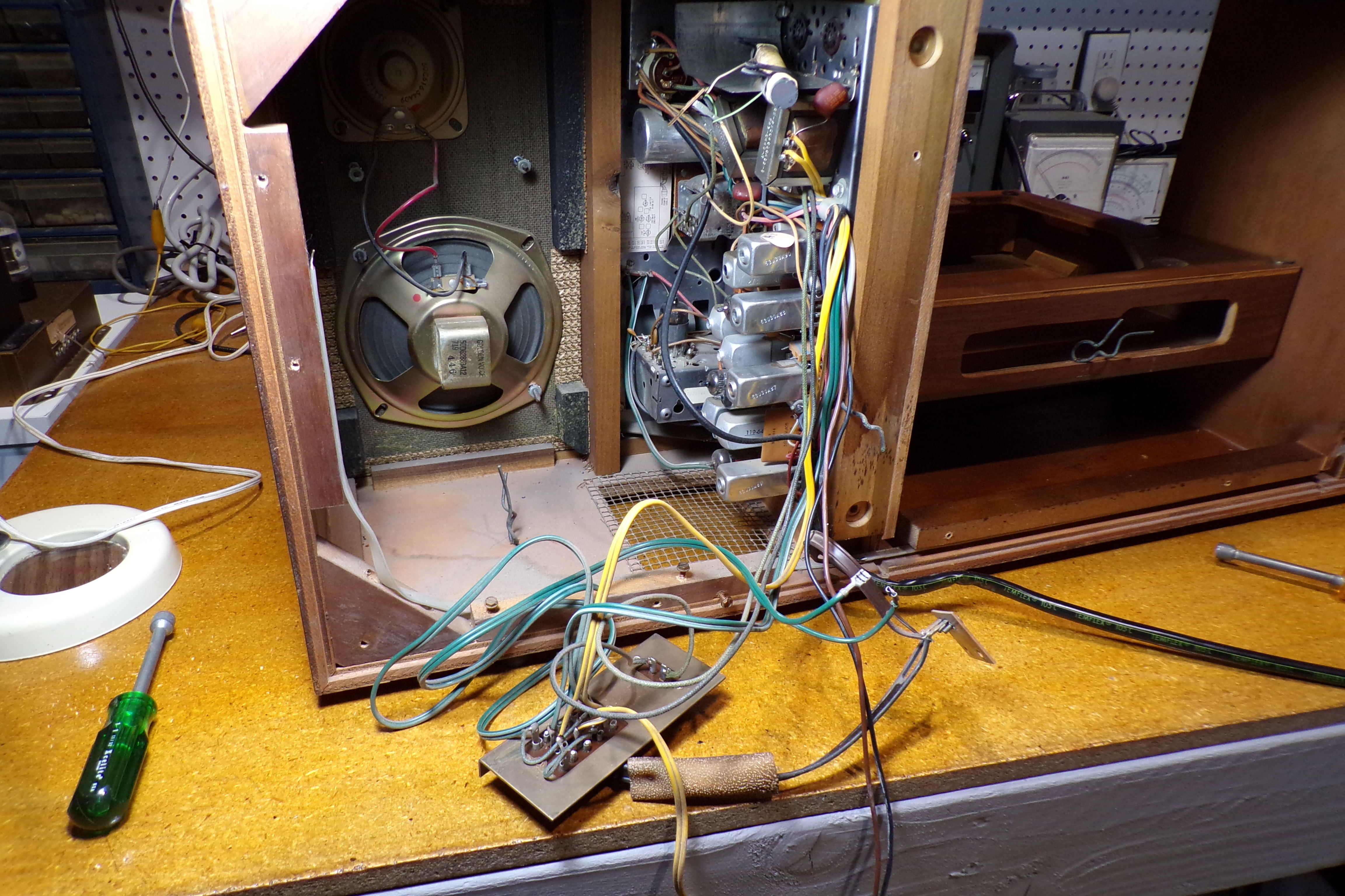

- Posts: 9074

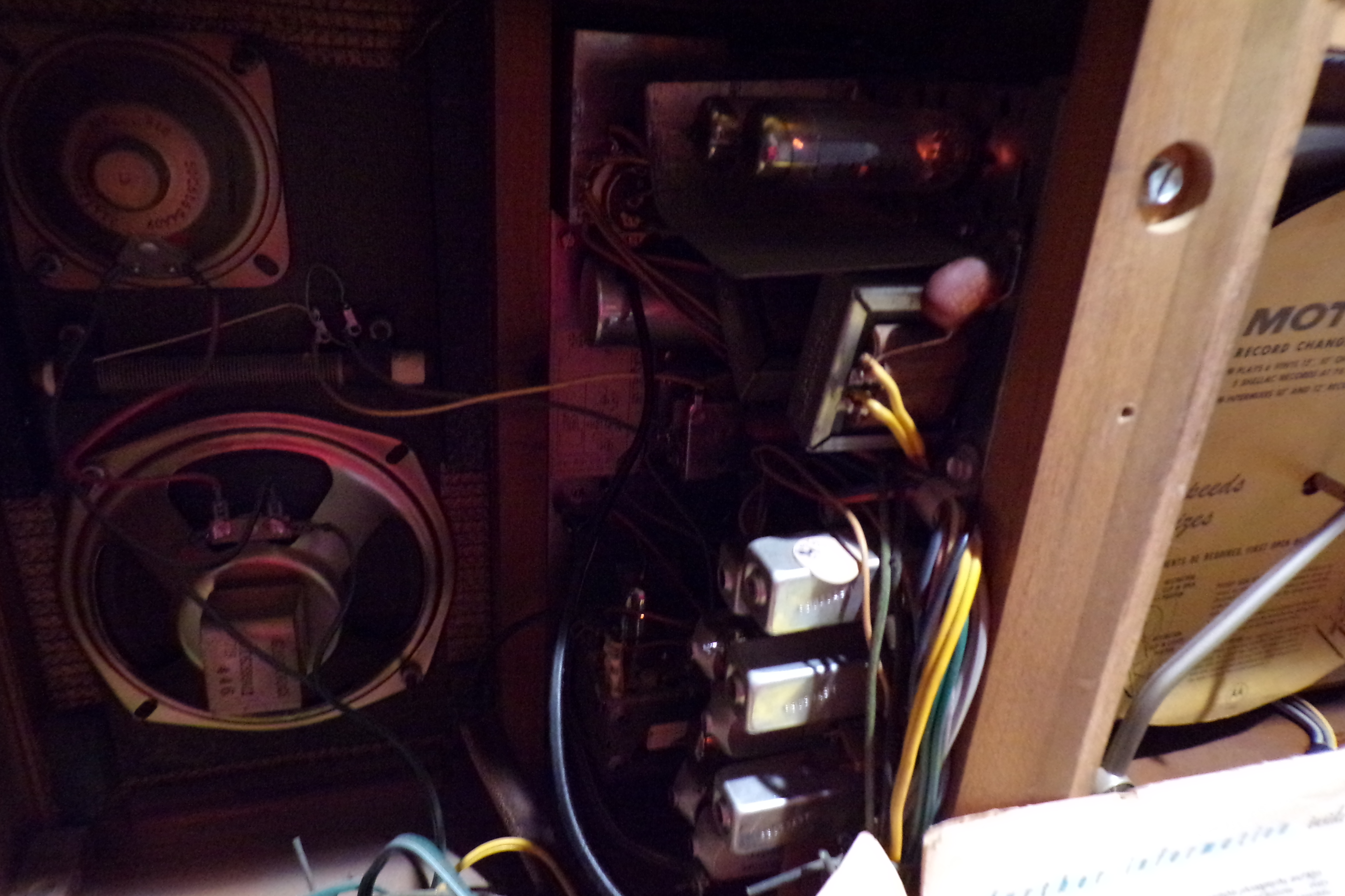

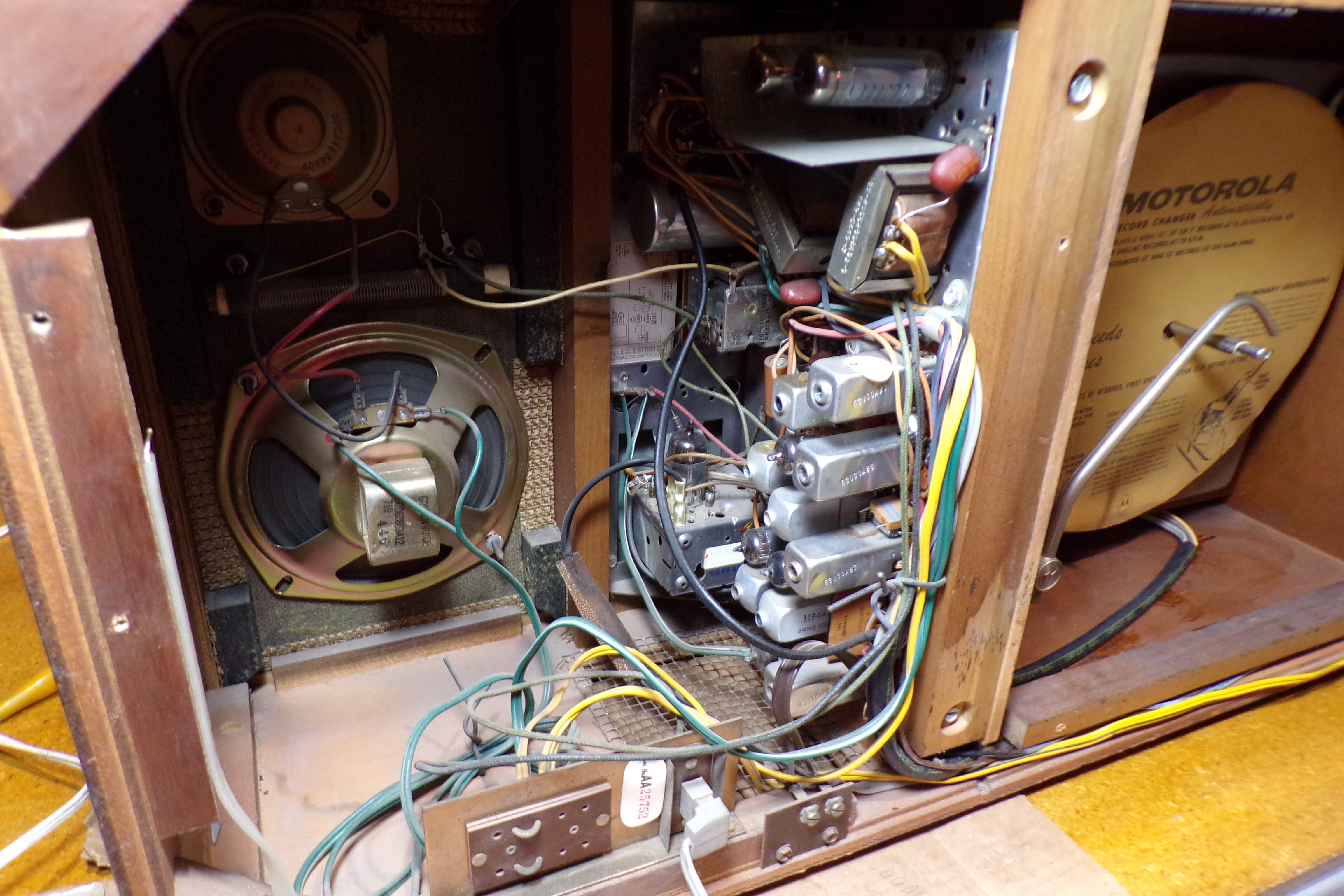

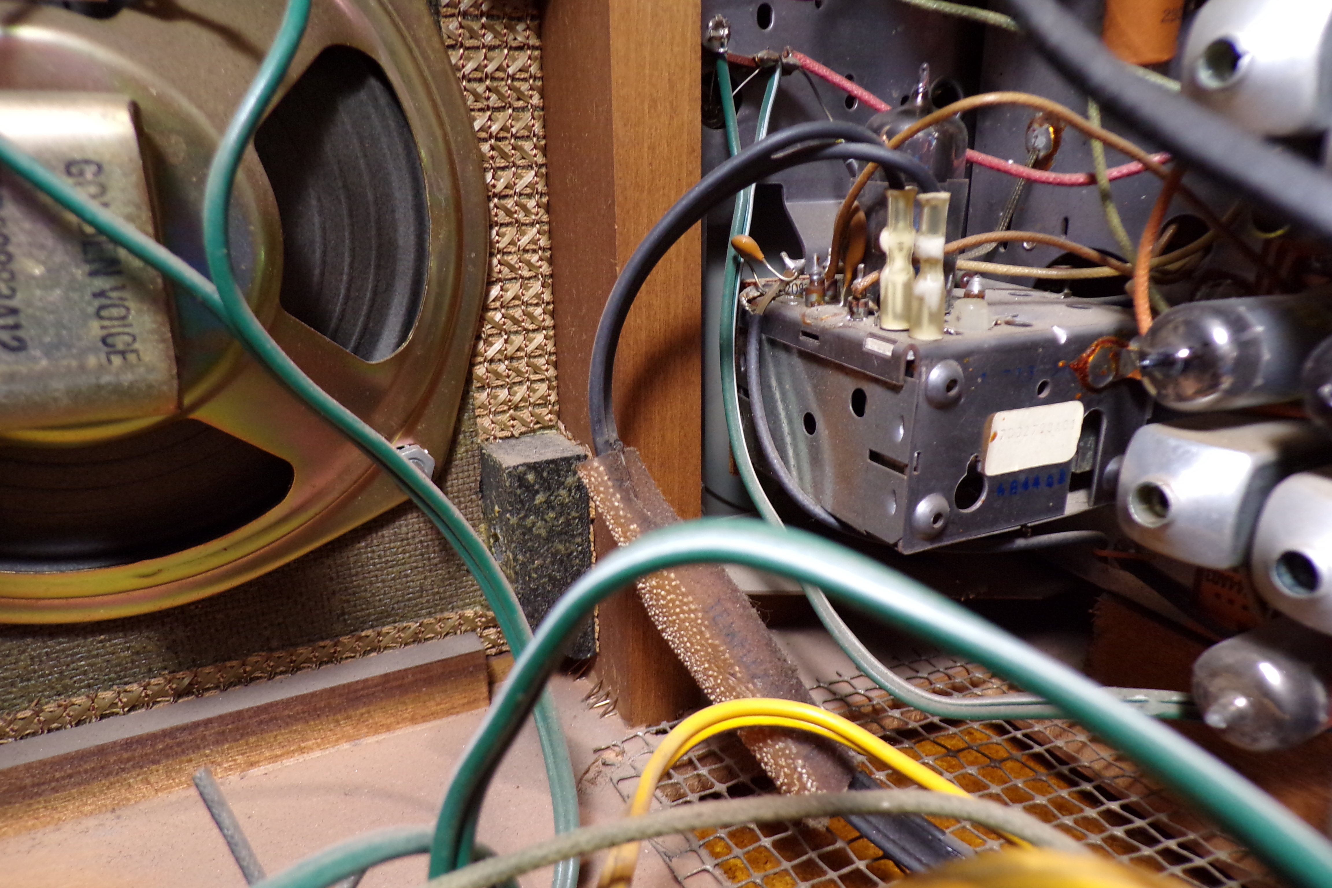

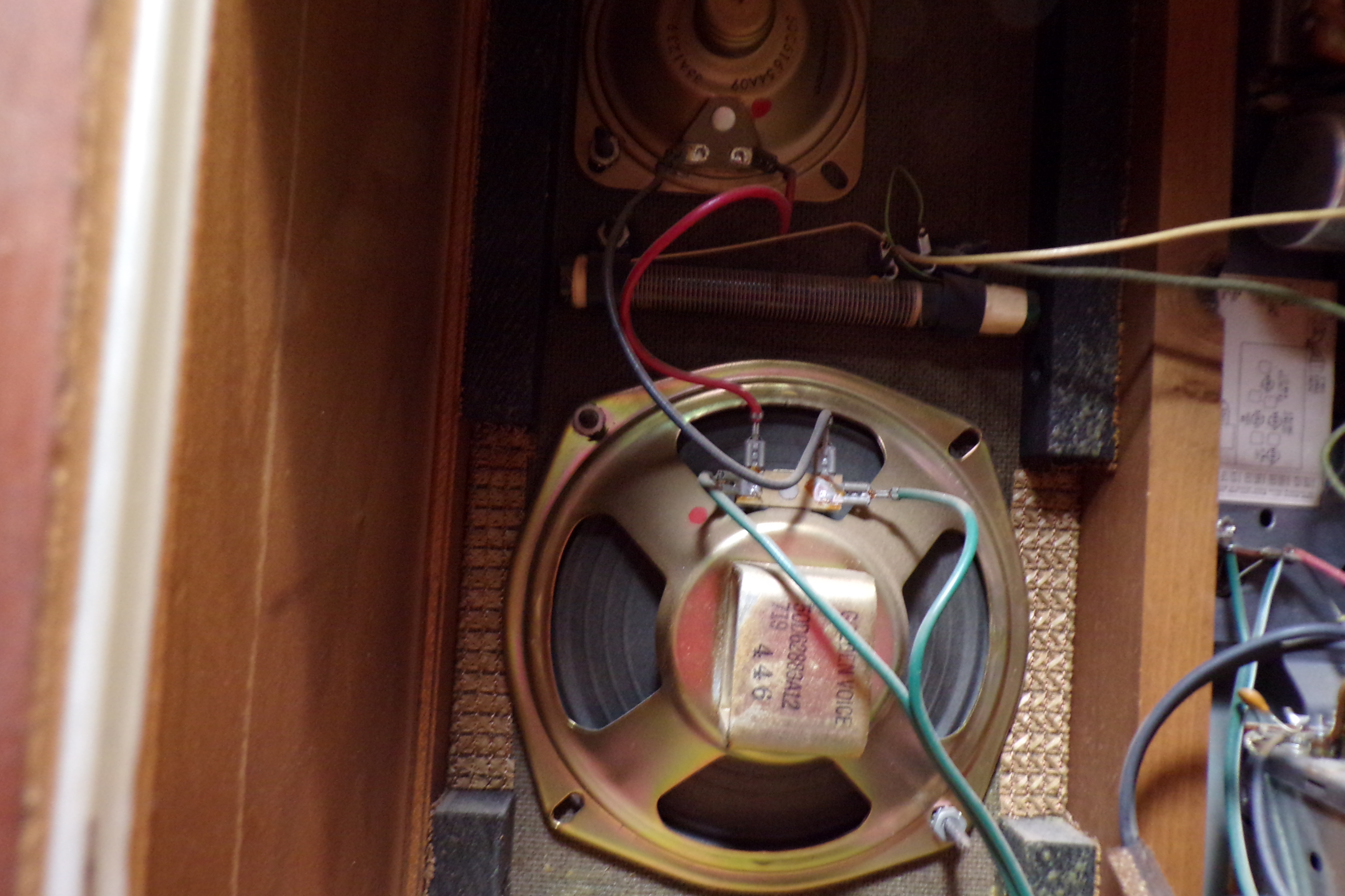

I have some pics here I'll share. This thing is almost as bad getting the chassis out as the Stereo Theater was. Wires are neatly arranged and routed, but are always under something else. I left the FM antenna alone, since it was stapled to the cabinet. Lots of one-handed reaching thru stuff to bring out the wiring.
- Posts: 9074

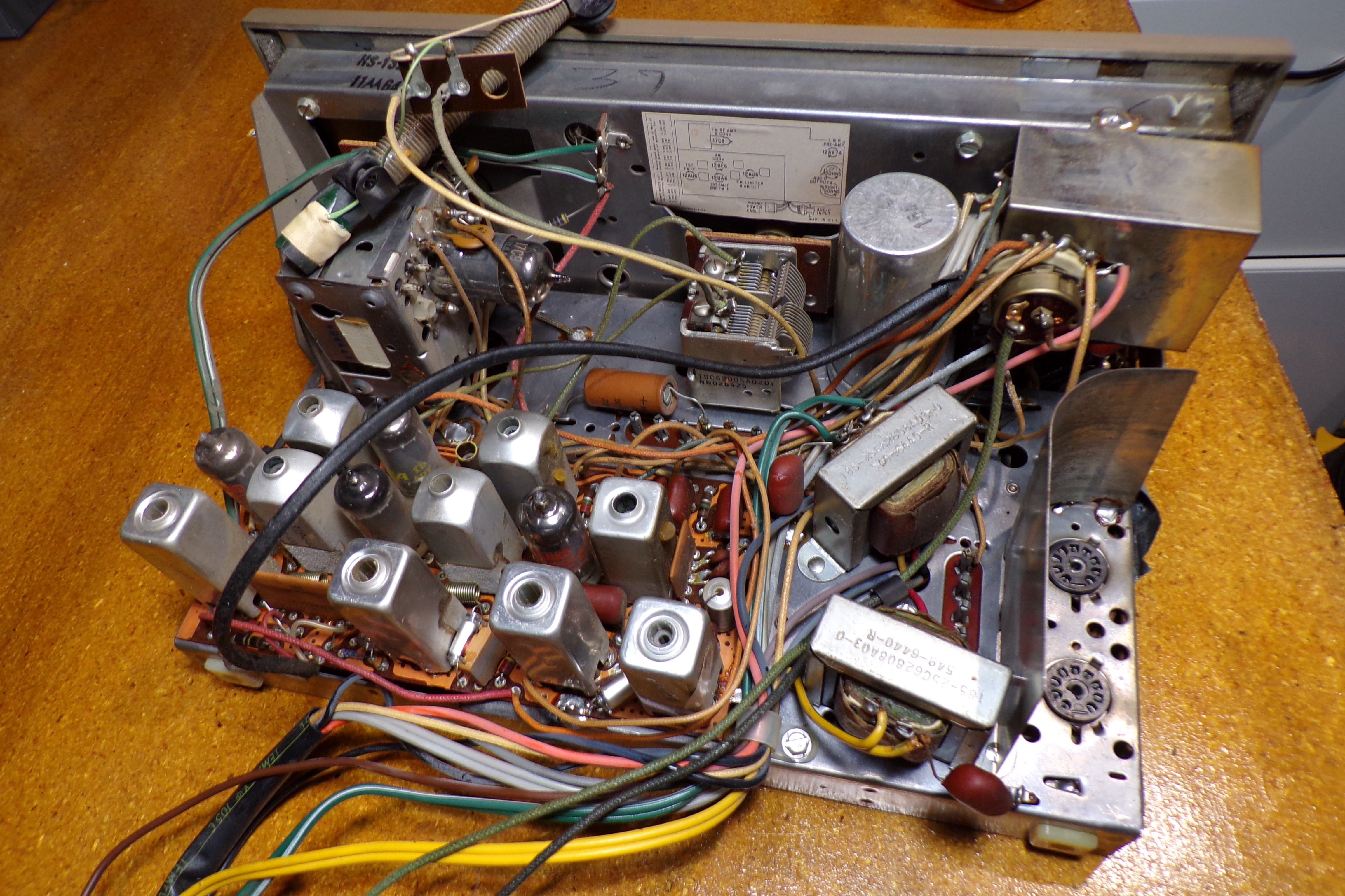

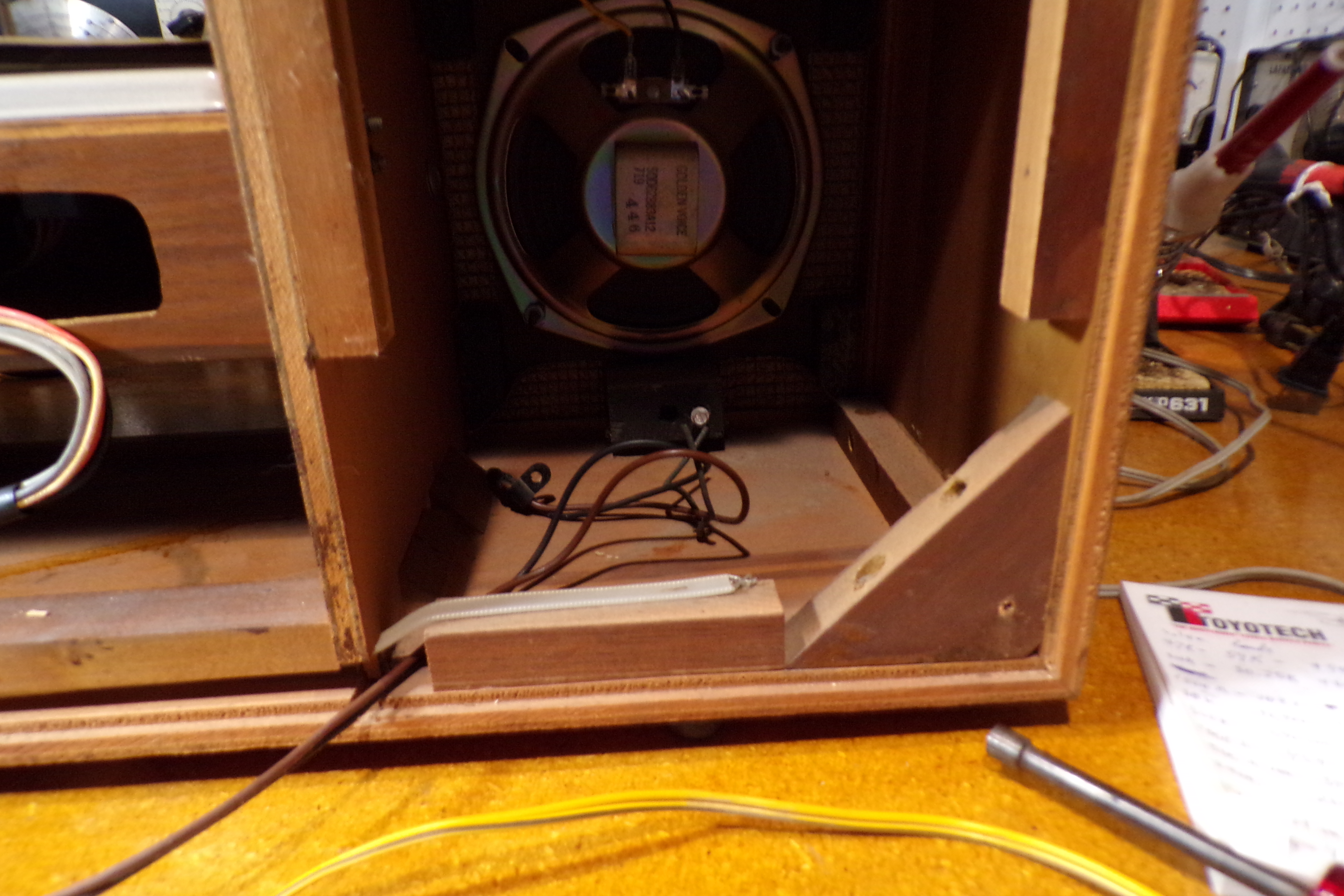

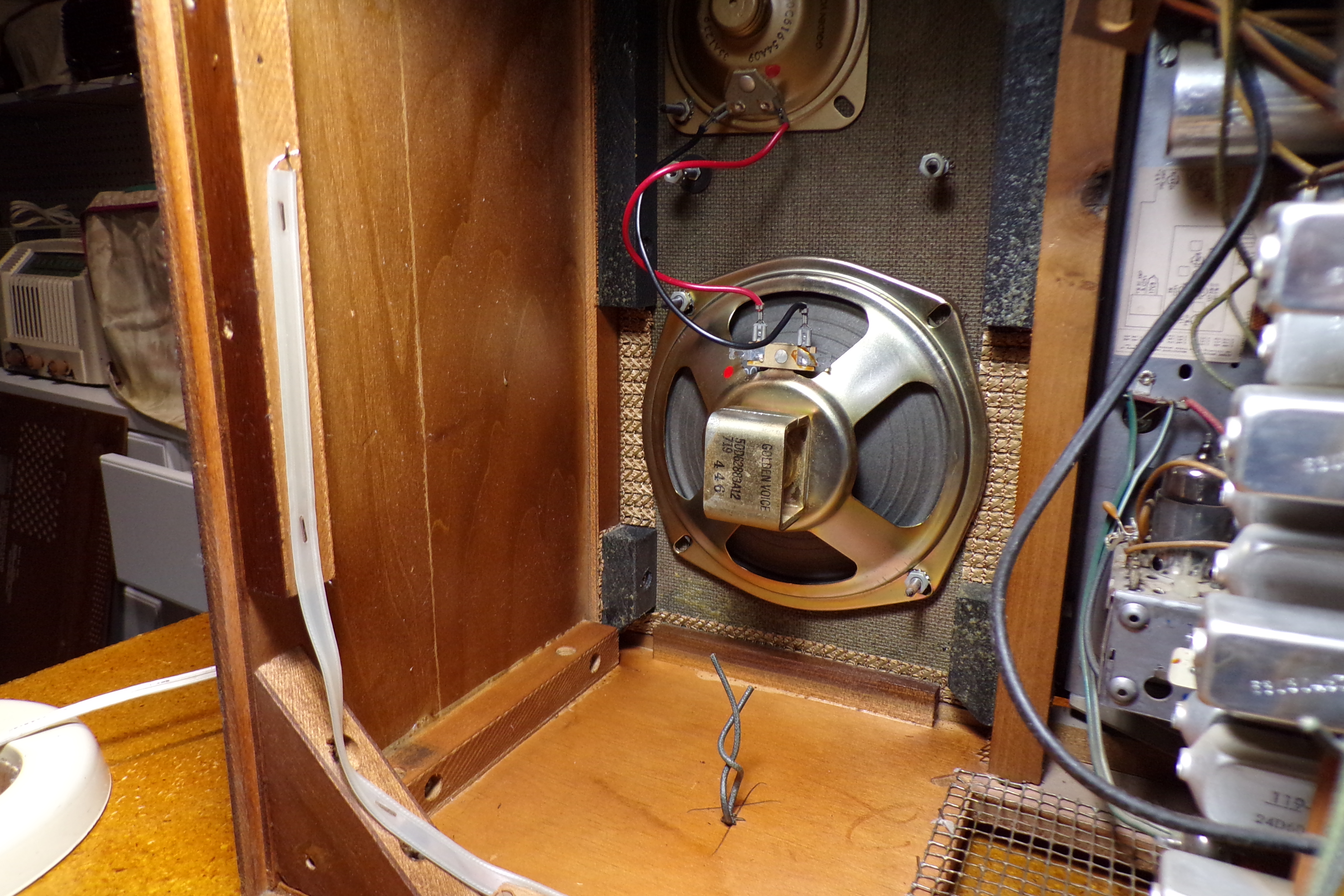

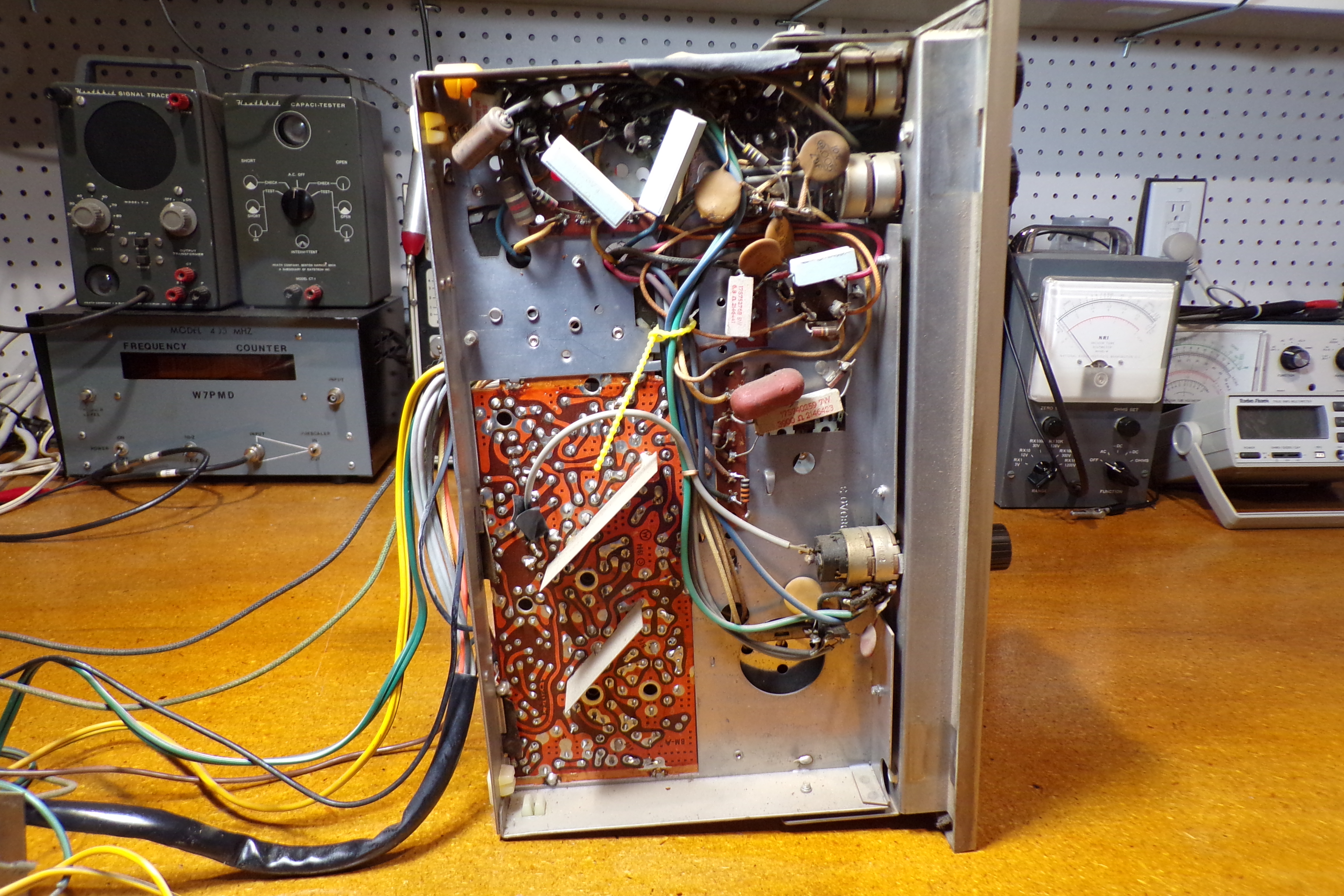

I finally got the chassis out. I decided to clean up the speaker enclosures and the speakers a bit. I removed the speakers, vacuumed the cones of dust, then, using a detail brush and the shop vac, I removed as much of the dirt and dust as I could. Then I spritzed a small amout of Glance on a rag and removed the rest of the dirt in the cabinet. I followed this will a good dousing with lemon oil. I put a dab of Simichrome on a rag and got most of the gunge off the speaker baskets. The inside of this cabinet is very similar to that of a Magnavox Imperial or Concert Grand. All hardwood, no mystery wood.
There isn't much on the underside of the chassis. There is one 100uf @ 25 volt electrolytic there. The rest is ceramic disc and couplets. There is another cap like under the chassis on top of the chassis, you can see in the pics. The filter caps check fine, so they stay.

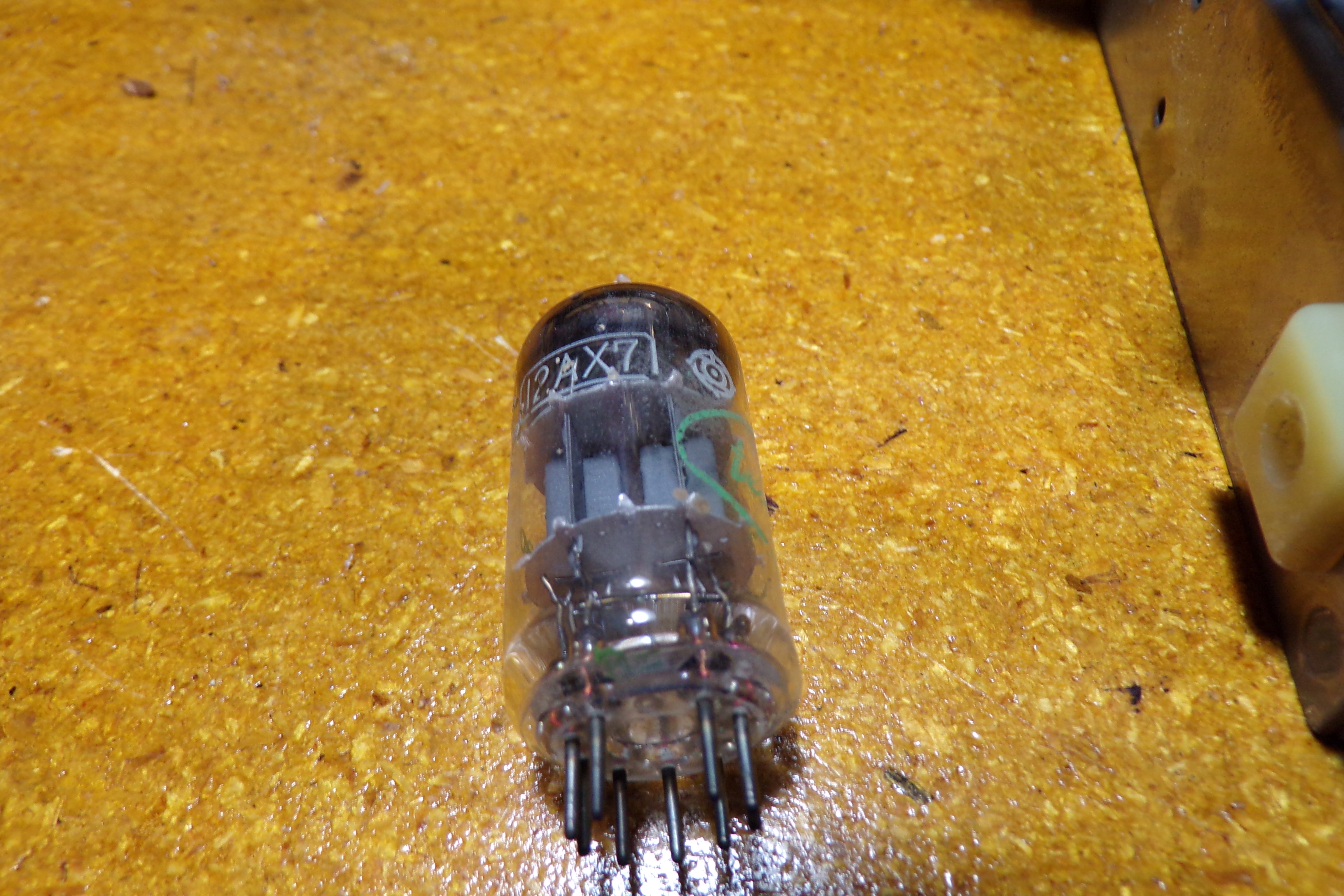

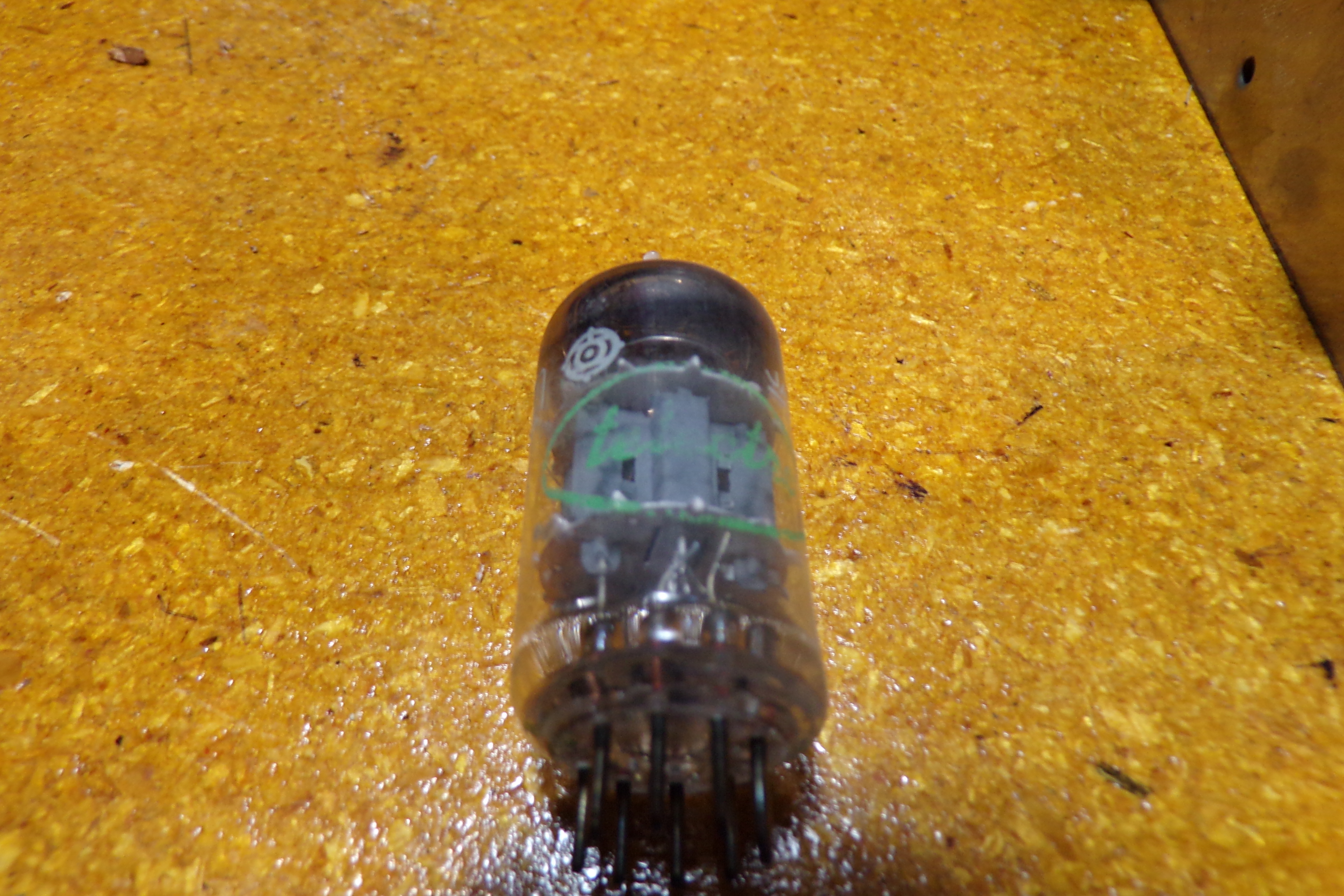

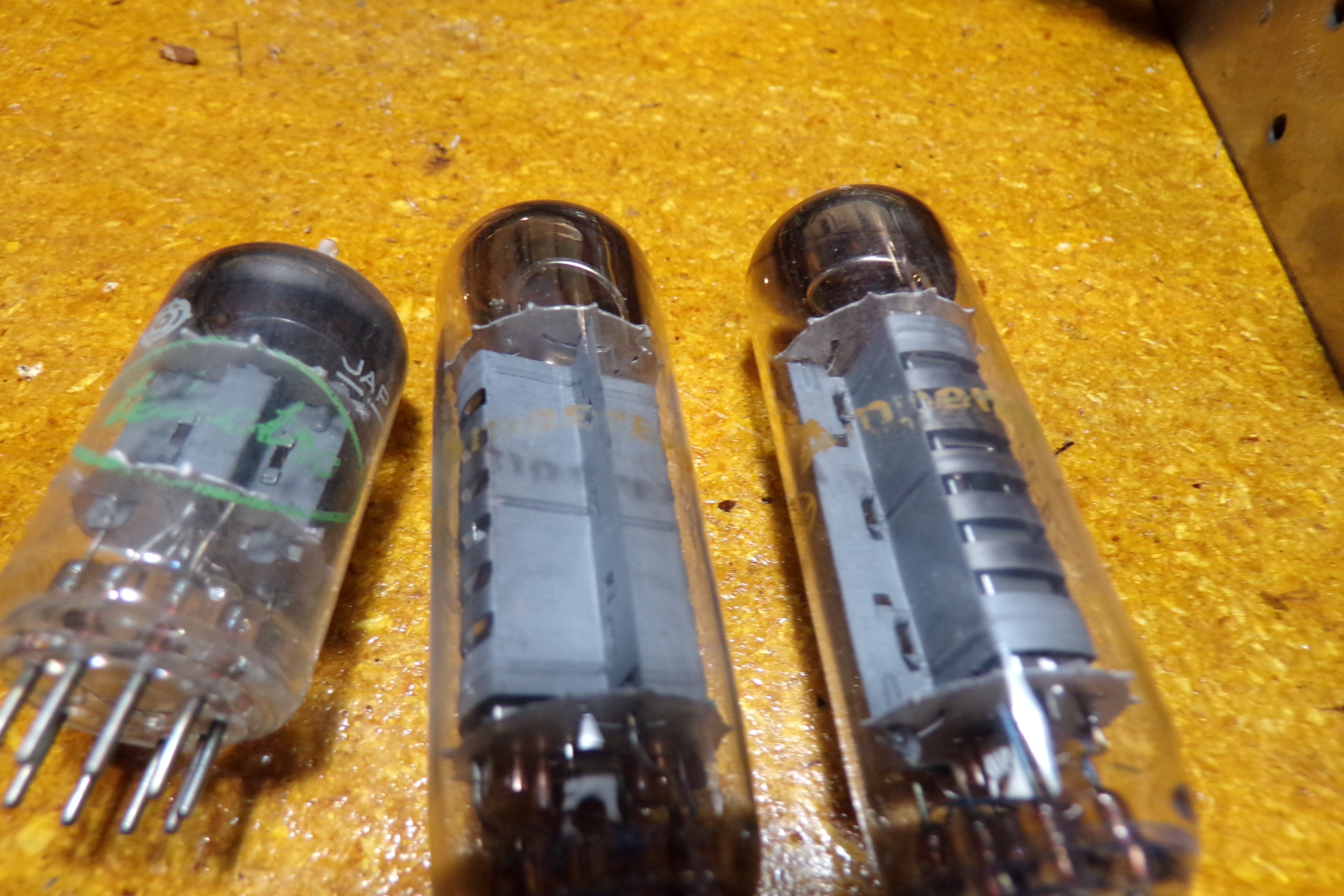

I haven't pulled any tubes with the exception of the audio tubes. The 12AX7 is branded "Telectro", made in Japan with what appears to be the Hitachi logo on it. The 50HN5 output tubes are more of a mystery. They are both branded Amperex. I don't remember putting Amperex tubes in this stereo. I remember changing one of the output tubes, but not both. The 12AX7 is in a pocket ahead of the cage around the output tubes and is nigh impossible to access with the chassis in the cabinet, at least for my old, fumbly fingers. Obviously, it is not original. I am suspicious of the condition of the 17C9 FM oscillator tube. I'll clean and test them all and check codes and that. I need to get a drawing for this chassis. I'm guessing it has two heater strings. A good AM alignment wouldn't hurt it, either. This thing has the healthiest-looking loopstick I think I've ever seen. IT is ALWAYS in the way when working on the chassis. I'll be lucky if the wiring survives my tinkering.......
- Posts: 9074
I ran around doing errands all day today, but got a few minutes with this chassis. I found a schematic in the owner's manual. No parts list or alignment instructions, so I still need to find a Sams for this chassis. Model number HS-1323-D. There is a symbol stamped in black ink under the model number for the chassis "11-Motorola "M" symbol-64". I am assuming this to be the manufacturing date code, 11th month of 64. I don't know that's right, but it makes sense. I pulled the tubes and tested them. All checked good. I still may dig out a 17C9 and sub it for grins. The 17C9 is a Japanese-made Motorola branded, the 12BA6 is Motorola branded with an RCA code, the 12BE6 is a Sylvania, both 12AU6's are Motorola-branded, Japanese sourced. The speakers are coded 719, Carbonneau Industries. One of the 100Uf caps I found is the cathode bypass cap, the other one's purpose is still unknown. I need to study the drawing some more. I'm going to check resistors and generally give it a good going over. It has eight tubes, eight diodes, plus the rectifier, and three transistors. There is an 8uf at 25 volt cap in the MPX circuit I probably should replace. There are a couple wires, one blue, one green going to both output tubes that look like parts of them has been hot. Tube heat, maybe? It is in a very tight area.
