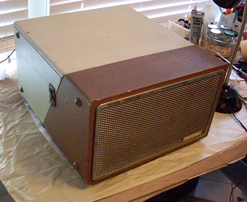

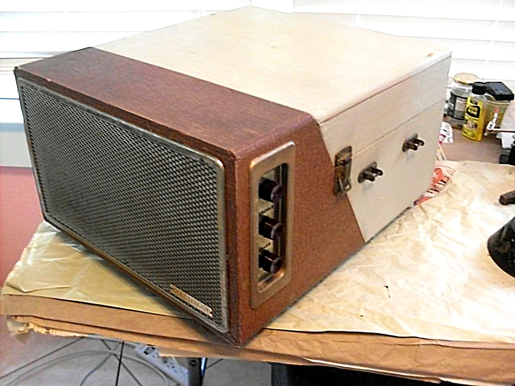

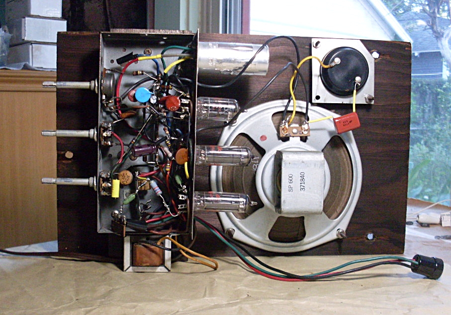

Post: # 9676Post Hi-Fi-Mogul »

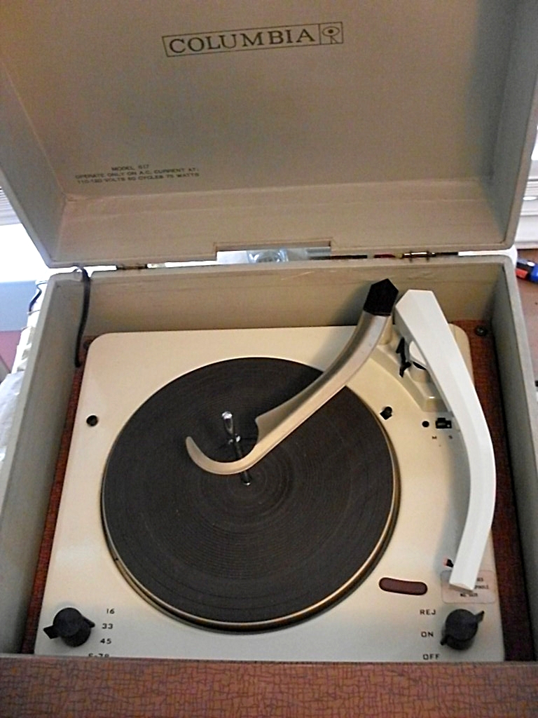

This was the other suitcase player that retained hum after
full re-cap.
I added the 10 mF e-lytic cap from B- to chassis,
and hum is gone.
This Columbia is pretty nice, with a more modern looking
tweeter, and Bass and Treble controls.
PP 50C5 amplifier.
The V-M changer is a 1210, which is stereo capable.
The Columbia has an external RCA jack, for use with
a powered satellite stereo speaker.
The original tonearm had a defunct through the end
of the tonearm turn-over crystal cart.
Because of this, I put in a replacement tonearm with
standard 1/2 inch wide mounting holes for a new
Pfanstiehl stereo cart.

The record player amp/cabinet is made by Columbia,
using a V-M 1210 record changer as I posted earlier.
Ken Doyle
