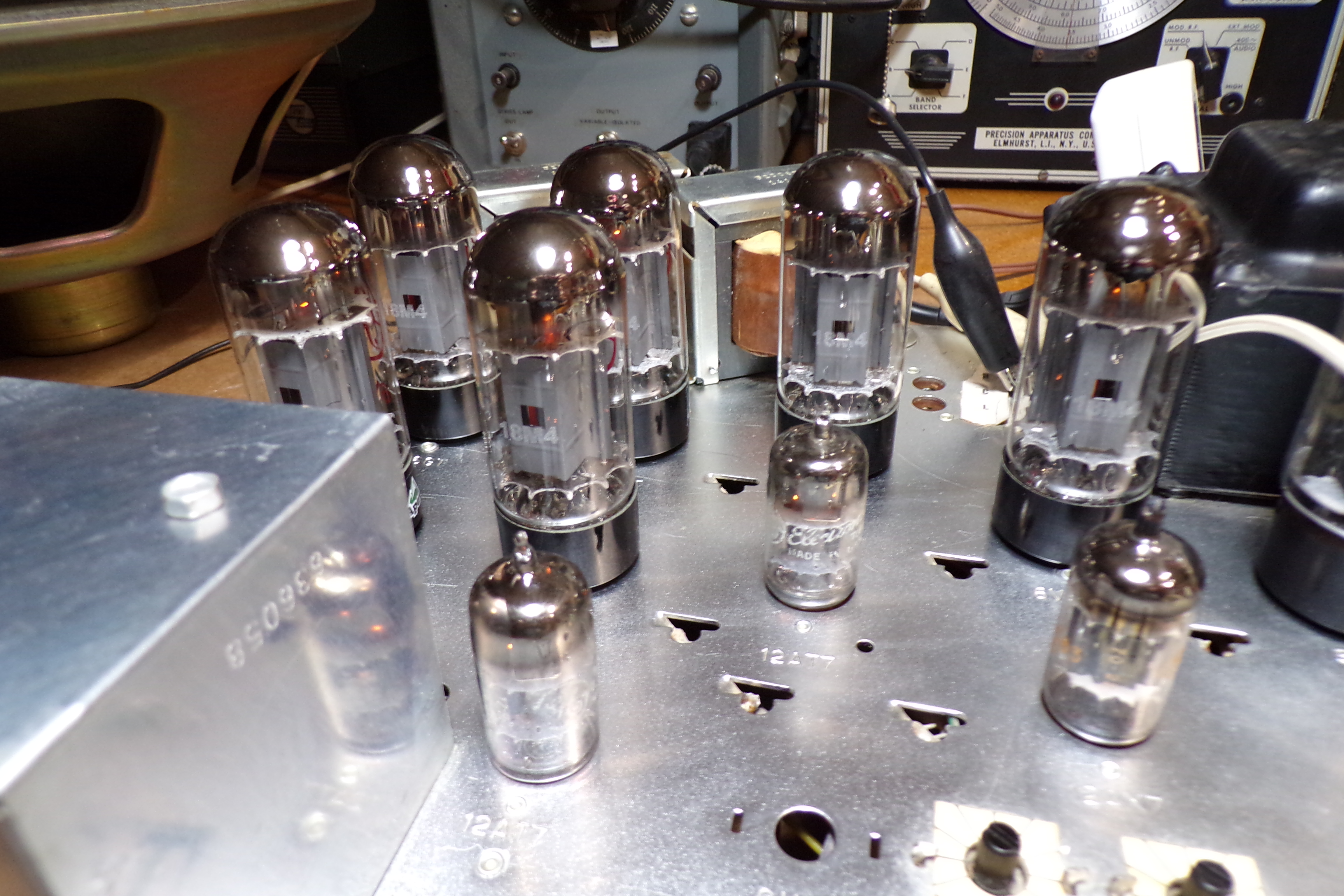

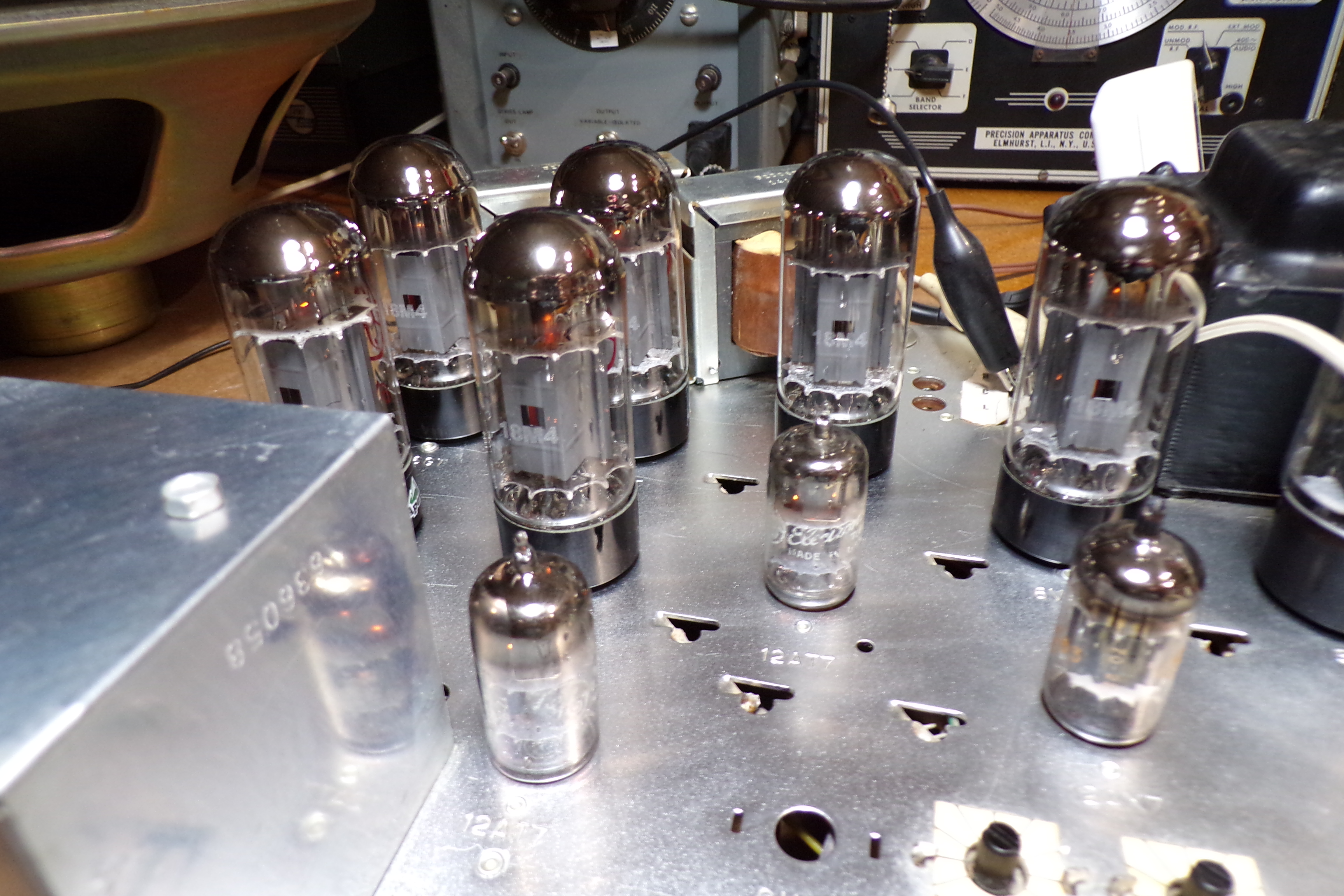

I went to AES this morning and picked up the output tubes. A matched pair of JJ 6V6S's and matched quad of JJ 6V6S's. The guitar guys say these tubes are a mix of 6V6 and 6L6. These will allegedly handle 450 volts on the plate. Wish me luck. I'll populate the amplifier with the new tubes, then check bias. I'll know in a couple of hours whether matched output tubes are a scam or not. I would never believe, not in a million years, that I would buy expensive matched tubes for a console stereo...... :oops:
The guy at AES asked me what kind of guitar amp I was putting these tubes into. When I told him I was not working with a guitar amp, but with a Magnavox bi-amp, he thought I was daft...... :cry: :roll:
Let's keep our fingers crossed......... ;)

This may be wishful thinking, but it sure seems to me like this thing sounds better. :D :D :shock: :shock: I won't know for sure until I get everything back into the cabinet, running better speakers.
I spent 30 minutes trying to figure out why the treble amps weren't working, only to find I had two dead horns. Those things are now on the other side of Rittenhouse Road, over there where they are building new houses..... :evil: Maybe somebody will run over them with heavy equipment. Note to self.....NEVER use horns for test. NEVER.....
I have some really hot biasing on the treble amps. All the voltages are dead on. All the resistances are within my 5% tolerance. My mathematical calculations say I have 85 ma plate current. The plates should be red carrying that kind of current. The bass amp tubes are all about 37ma, give or take a tenth. They all have 11 watts +/- of plate dissipation, right on the old nose. The treble amp tubes figure out to 27 watts of plate dissipation. No way are they that hot. I need to figure out what I did wrong in my calculations. I'm running between 318 and 322 volts on the plates, so that is good. Screens are all good.

While I'm not out of the woods yet, by any means, I'd like to share some observations I have made during this process.
First, Magnavox built this stereo with "sizzle, but no steak". Built for a home you would see on Perry Mason, with tall ceilings, wool carpet, heavy draperies, classical or easy-listening music. Built with beautiful hardwood cabinetry (although not finished on the bottom of the cabinet). The bean counters were hard at work killing Magnavox when this stereo was built. They used a 15 or 20-watt amplifier, so boomy bass is not likely because of the flea-power amp. Second, Magnavox bought and used the cheapest garbage parts they could find, utilized generous tolerances, producing a "sloppy and slushy" amplifier. Enthusiasts complain about wimpy bass. In reality, what this one was producing was wimpy FIDELITY. Wimpy bass was only a part of that. When this stereo was new and all the cheap parts were new, it probably sounded pretty good, good enough to get paid and get it out the door. The last 64 years has not been kind to this old stereo. It was a high-hour set when I got it and I have used it heavily myself.
90% of the resistors I have changed during this process were within the factory tolerance of 15%. They were mismatched between channels. The reason I bought the resistor kit was so I could have multiple resistors of the same value so I could find two that closely matched. The "big three" plate load, grid load and cathode bias resistors were matched between channels and are all less than .1% off spec and less than that different between channels. There are four resistors in the amp chassis that are still original. I even replaced the resistors in the feedback circuit so they would be the same. I selected resistors so the "difference" in value between channels would be "on the same side" of the specification. If one was 30 ohms high, the other is similar. I didn't put one high and one low.
I believe, at this point, my recommendation for any Magnavox bi-amp is matched output tubes. If you have a CG, you will need two sextets and one quad of matched JJ 6V6's about $480 worth. This Imperial has a quad and a pair of matched tubes, and I asked that the quad and the pair be matched. They recommended that the treble amp tubes need not be as stout as the bass channel tubes. The treble amp tubes are matched at 29ma, the bass amp tubes at 37ma. There are mathematical equations about audio that I don't understand. From a "mechanical" perspective, I am holding my own, I guess.
I love my Magnavox stereos. I believe Magnavox was king of the hill in console stereos and audio in general in their day. They have beautiful cabinetry, cad-plated chassis that look like new 64 years after they were built. The wiring is sloppily oriented, but it appears to be excellent quality, resting on hot tubes for decades with no apparent damage. They have features and doodads galore, but by the time this stereo was built, they used really cheap parts that have not aged well. If you want your old Magnavox stereo with bi-amps to sound as good as it can, you need to do a component-by-component restoration of the electronics, keeping the tolerances to 5% or less. Then you should spring for some balanced tubes. Output, audio and rectifiers. Keep the component tolerances the same between channels. Match resistors between channels. You essentially need to do what Magnavox did when they built it. Do it part by part....... ;) :D

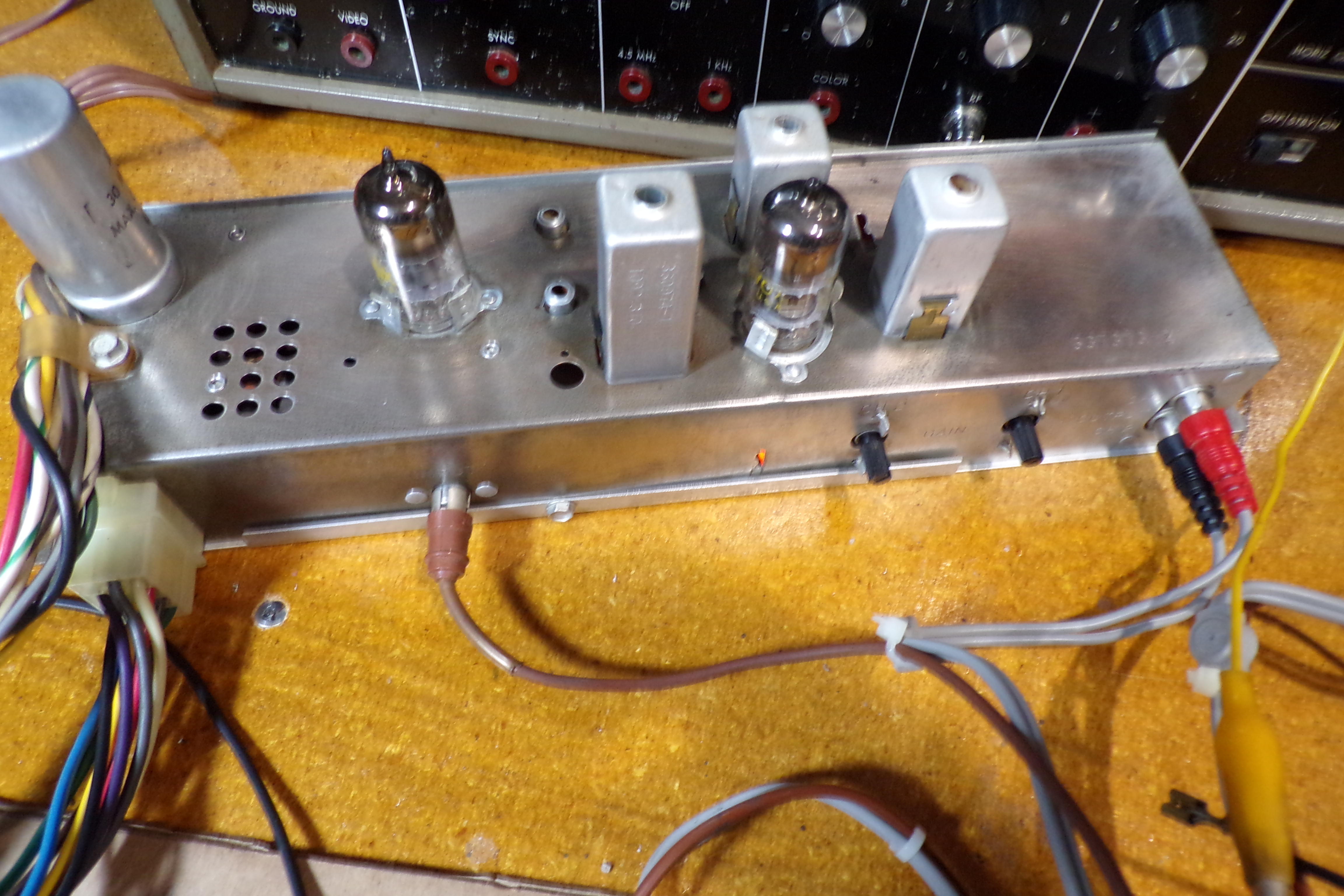

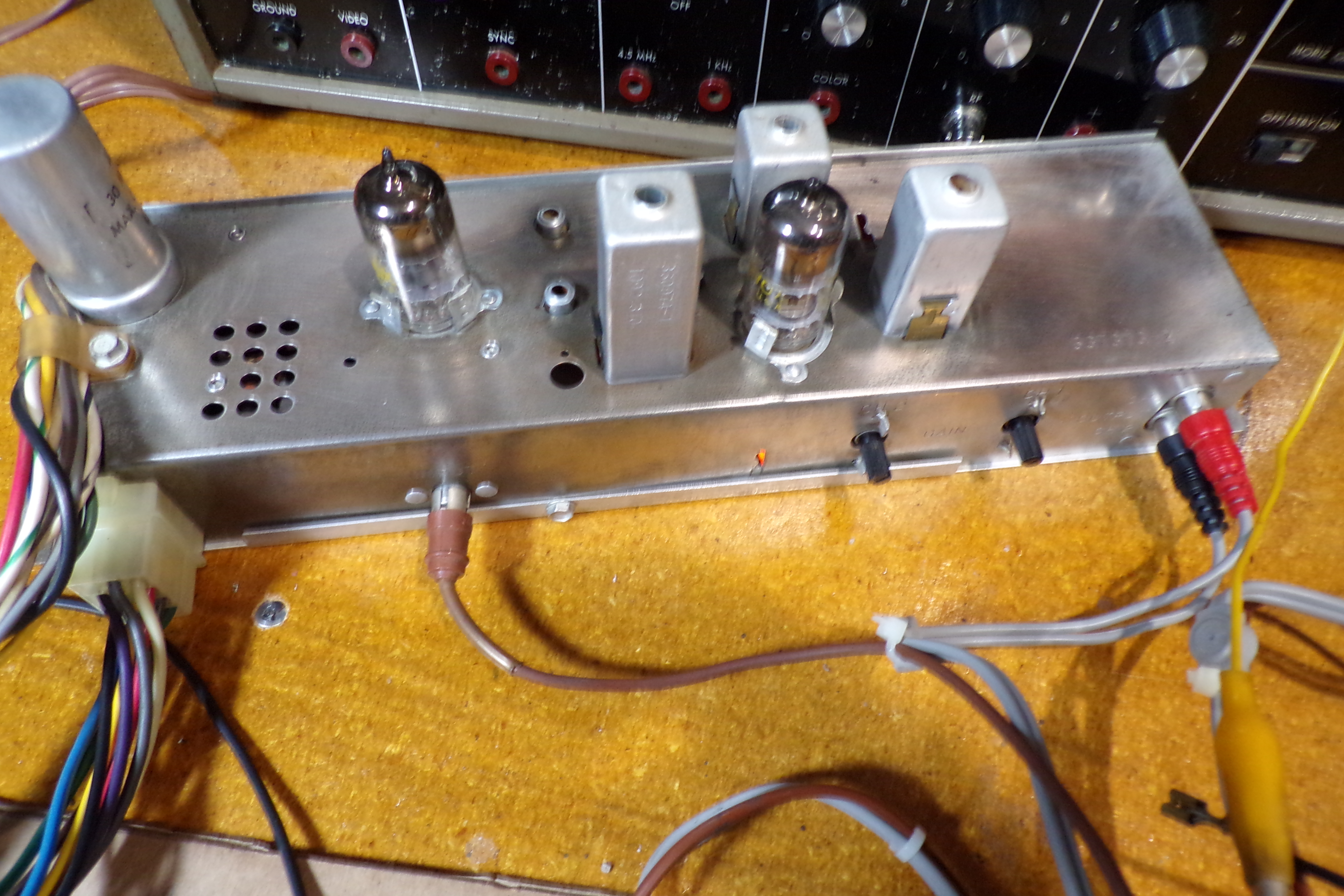

There is a plastic tang or finger on the Molex connector on the Multiplex adaptor chassis that has broken. This allows he Molex connector to retreat back into the chassis, not allowing the plug from the tuner to make good contact. I have a spare adapter, but it is not very good. I used it for parts for the one with the broken finger. My cure is to take the bottom off the MPX, make sure the tuner plug is properly seated, then put the bottom back on the MPX chassis. The MPX and the tuner will be as one, tied by their connecting wiring. I may never have to remove the MPX chassis again. I will make notes on my service documentation about this so I'll know next time.
Posts: 9059
Re: Magnavox Imperial model 1ST233
Post: # 21048Post electra225 »

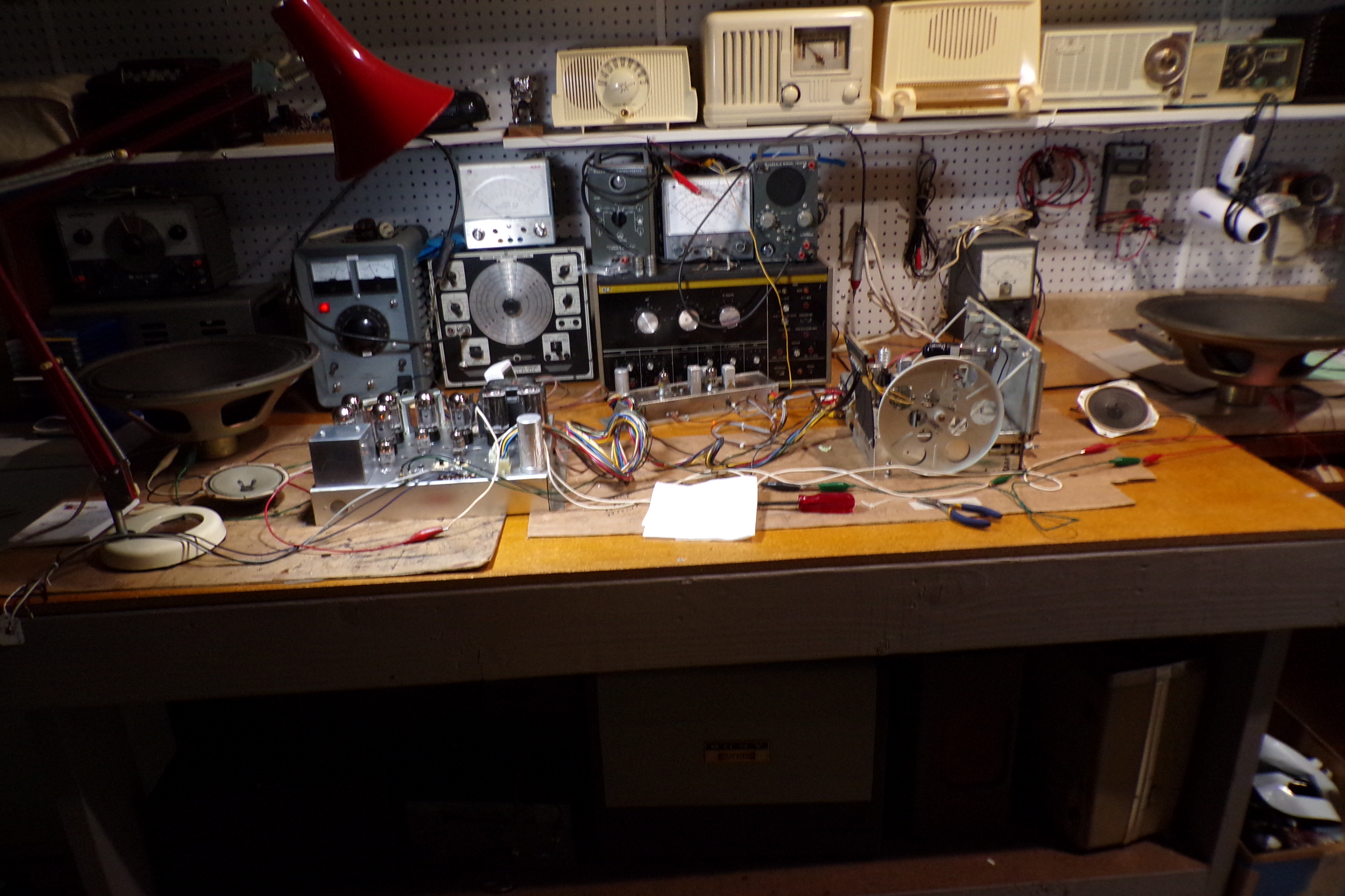

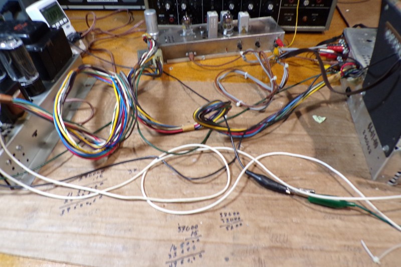

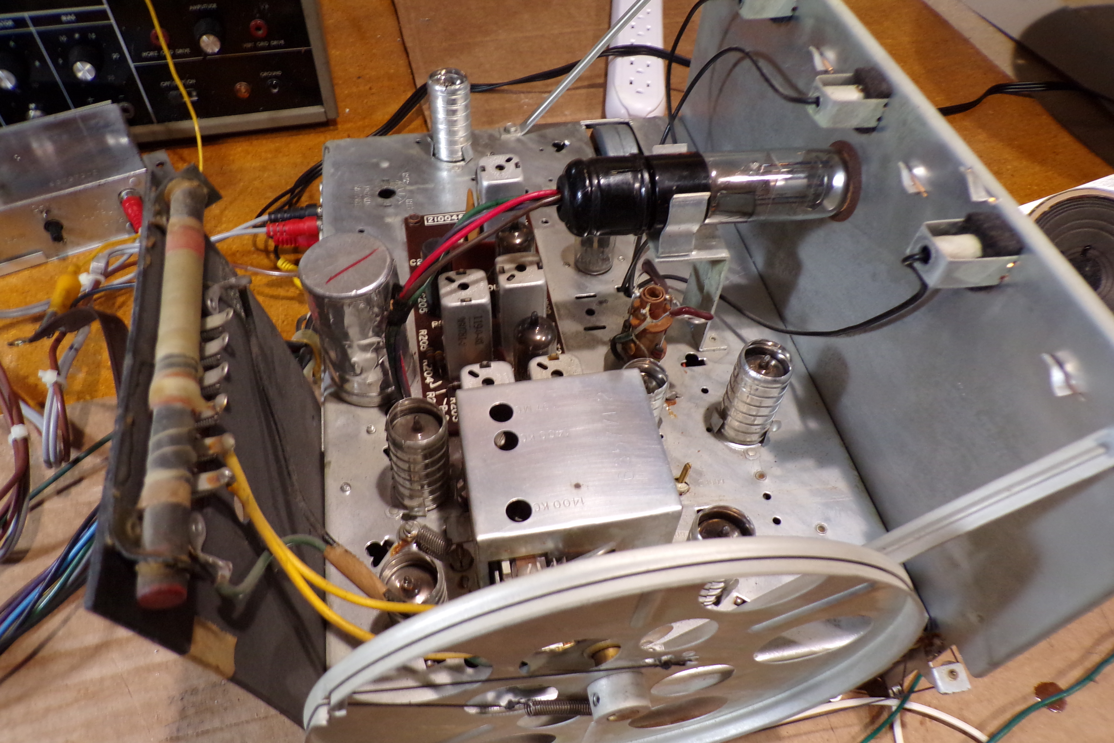

The original MPX is not going to work. There is an intermittent in the Molex connector. It may be easier to get the spare going, then work on the original. I took some pictures of the grand mess that is the Imperial chassis and related wiring. It's a thing of beauty. The JJ tubes aren't very pretty running since they don't have clear tops. The "JJ" insignia is lined up with the key on the tubes, so they are all in the same place, and that LOOKS pretty cool. I ran this outfit while I listened to Western Red. It is still working, so I reckon now I have "burnt in" output tubes.....
Posts: 5495
Post: # 21053Post William »
Those photos bring back memories of when I had mine sprawled out all over the bench. It looks great, Greg, and it is playing so you are way ahead of me with my current VM project. Keep up the good work and before you know it your Imperial will be singing like you have never heard it before.
