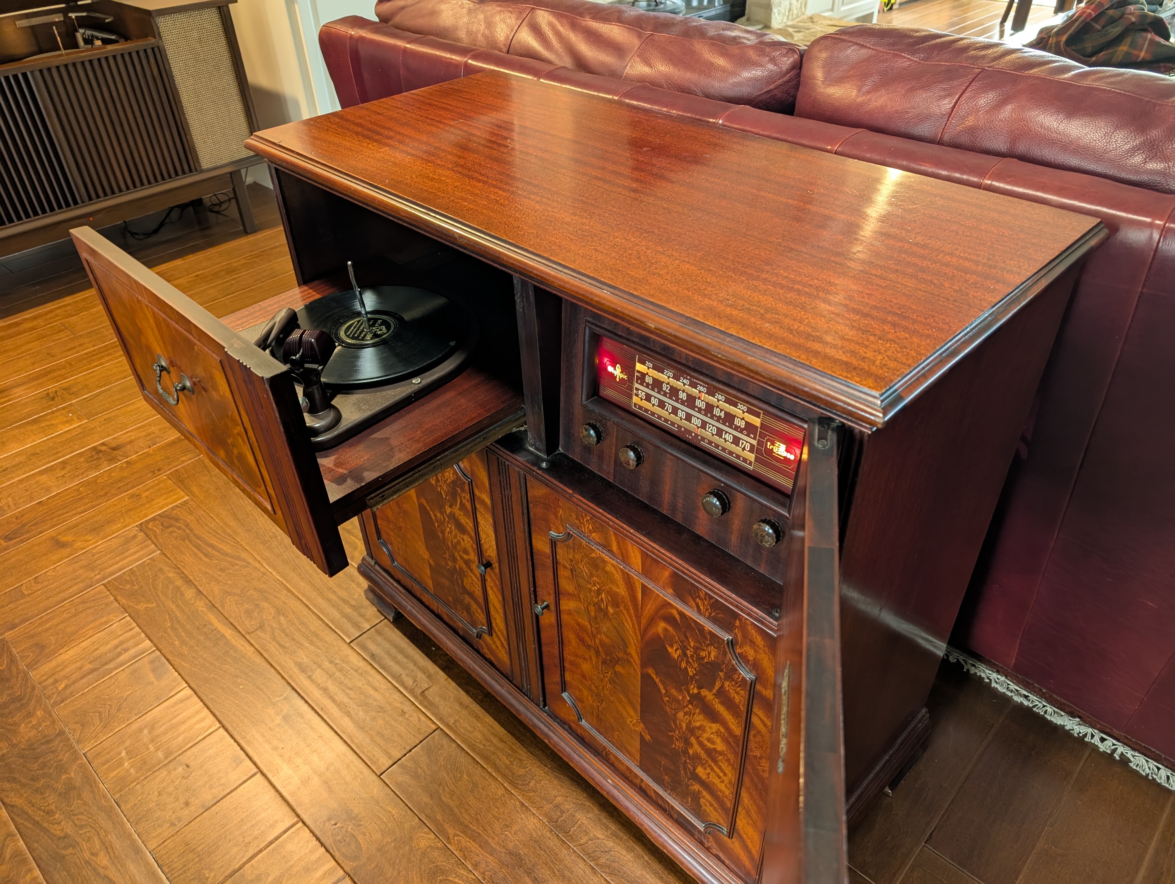

I think I'm finished with this guy for now! I deoxed the inline 3-pin connector for the stereo indicator lamp, because it seemed to be an issue--I think I forgot to clean that one before. So, the light comes on all the time, pretty much, even off-station. But, the stereo separation was virtually zero. The uploaded doc that I mentioned above has a helpful description of the way the MPX works, and alignment procedures. So, I connected a DVM to the test point, and peaked the coil and transformer as instructed, I got about 33 VDC, give or take. But to max out the stereo separation, there is a more complex procedure described which would mean I would have to open up the MPX again. Instead, I just listened for stereo separation on a strong station (putting my head centered at the back of the console), and tweaked L3 to where it seemed max, that setting was off the peak voltage, ended up around 28V or so. Not a perfect procedure, but separation is much better than it was before, and it meets my needs! Those inductors are labeled differently on other schematics that I have, but the basic functionality is the same.
When I attached the dipole for the FM antenna and disconnected the long wire that originally served as the OEM antenna, the interference from the Bluetooth adapter went away. I'm guessing that's because the antenna system is now balanced--before, the OEM wire just attached to one side of the 300 ohm antenna input which must have made it more susceptible to interference.
Video of finished restoration
https://photos.app.goo.gl/wWBDFVNypWmLgYkt9
Hopefully this link will work OK, since it is a link to my personal Google storage. Playing on the changer is the Cincinnati Pops Big Band Orchestra "In the Mood", switching to Tape input is Jerry Lee Lewis "You Win Again" (his recordings have his voice way too loud!). I also show a 4-input switcher I attached to the back. I decided to bring the tape input connection out the back to allow me to hook in other audio sources besides Bluetooth (which is #1 on the switch). The lid is still a little warped, gotta keep working on that!
The FM stereo light continues to give me problems, it is now not working at all, even thought it was OK when I buttoned up a week ago! I now suspect that it may have to do with the IF alignment of the tuner--I've read that early stereo tuners had to be redesigned to make sure the 38Khz pilot would get through on its way to the MPX, so alignment is probably critical. I'm not inclined to tackle that right now!
As I mentioned in the Changers section, I finally replaced the motor mounts after hearing the motor noise when I made an earlier video. The phone's mic is omnidirectional, so it picks up all the reflected room acoustics, but that really emphasized the motor noise, and makes the console sound somewhat "boomy". This video is made with the new mounts.

I have suspected alignment and antenna efficiency as being a part of the stereo light issue, but, like you, I hesitate to mess with that. I figure a wonky stereo light is just part of its personality......

Do you hear stereo with the light out? That would tell whether the problem is switching or just illuminating the lamp. I have a little inexpensive GE receiver next to this computer driving a couple small Polk speakers. The light came on but I was not sure until I heard something way off on the right....

Unfortunately, Chris, when the stereo light is off, it's mono, there is no stereo separation, so it's not so simple
