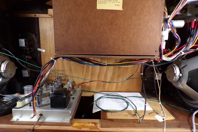

I have some photos of my speaker kluge, which is working pretty well. I've decided to replace the other lower speaker so they will both be the same. I found a wiring harness from an MPX, so I'm going to splice those remaining dangling wires and run them in a more organized manner. As it is now, the speaker wires are all suspended by the external speaker switch, which seems like poor workmanship to me. I have been playing the collection of cassette tapes I got at an auction in Missouri in 2007. Somebody went to a lot of effort making this collection of tapes. They are not all numbered in order, no idea why there would be missing numbers. I have several dozen of these. All neatly typed. Fairly good fidelity for the most part. No noise reduction, there are a few skips. The only gripe I would have is that they put instrumentals on the end of the tape, between the last full song and the end of the tape. I would prefer the dead tape. They also used TDK tape, the brand Walmart sold. Typically not very good tape, this stuff has weathered the years well. Most were recorded in the 1991 to 1995 era. The person who had the sale was a lady who had gone to a nursing home. Somebody had a huge record collection to share. The songs are all by different artists. 99% country music.

I've been procrastinating on ordering parts. I finally got that done. Drive tire and needle are on their way. I have the midrange speakers changed, have the rats nest of wiring somewhat, actually considerably, neater. The two wires on the front of the cabinet are the input wires from the tuner to the amp. The two light-colored wires on the right hand side hanging down are the external speaker wires. I'll put the service literature I have in a manilla envelope and leave it in the cabinet. We'll get the changer sorted after the parts come and we'll see what we have.

Very neat and well organized. It is too bad that Magnavox did not take the time when it was built.

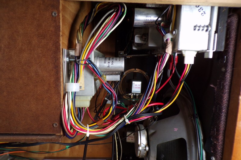

I put about a foot of wire in the orange, brown, and black wires going to the right hand speakers. That is all the extra wire needed to be able to run those wires so they don't dangle on hot tubes. This stereo has the only factory authorized installation of the Multiplex adapter so it isn't in the hottest part of the cabinet. I used white wire ties to separate the wires by component and so they would be better supported.
