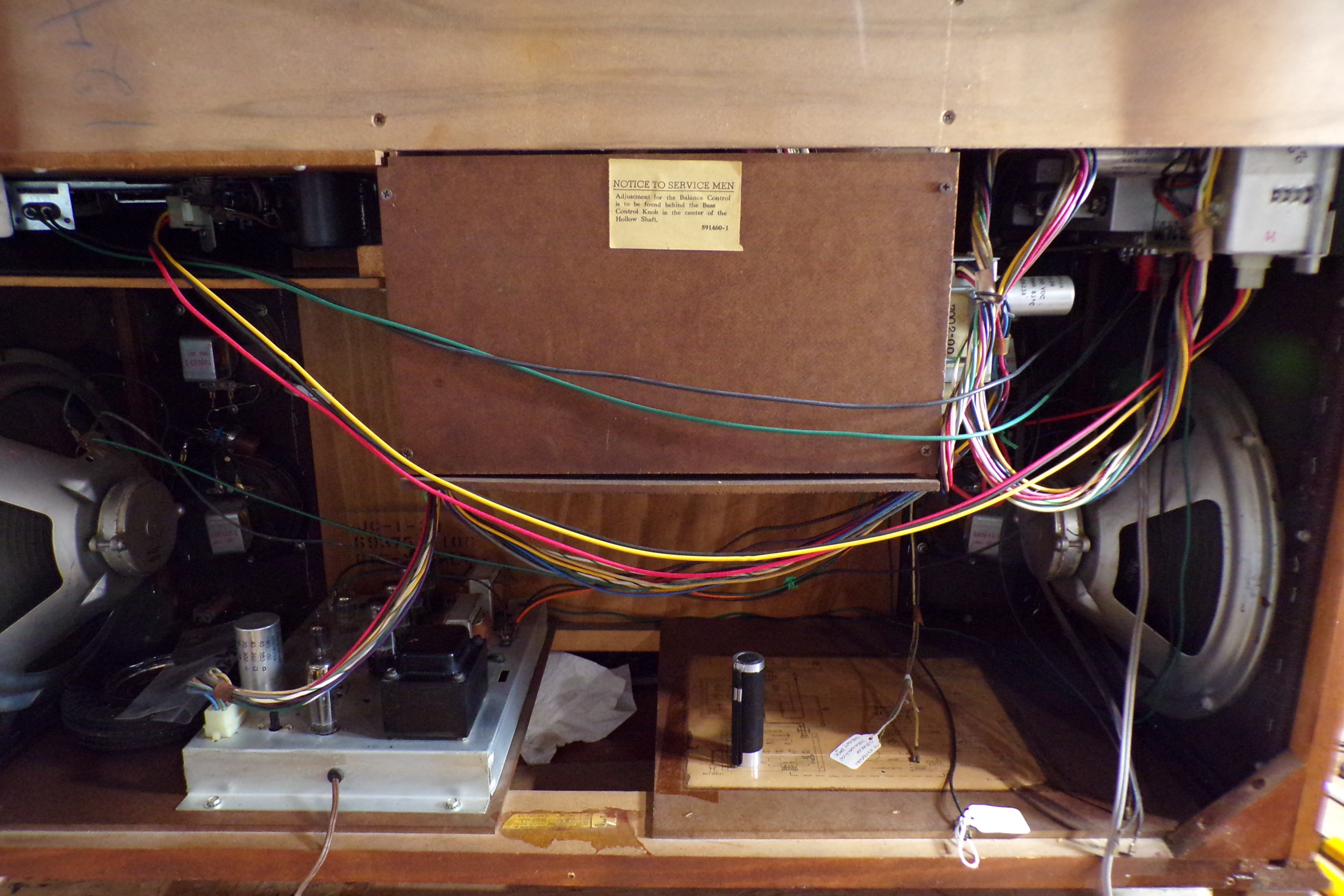

Pictures as promised.

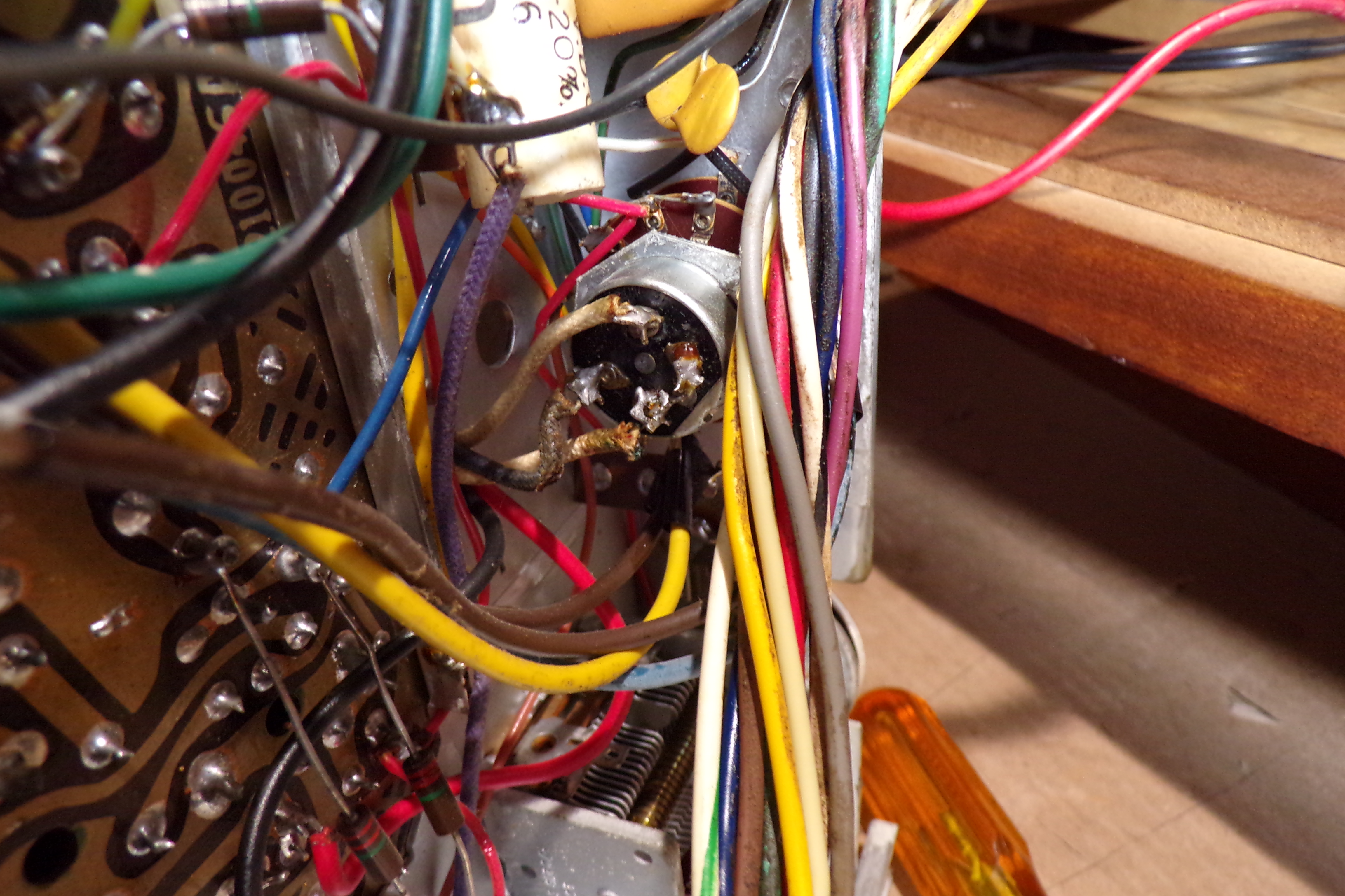

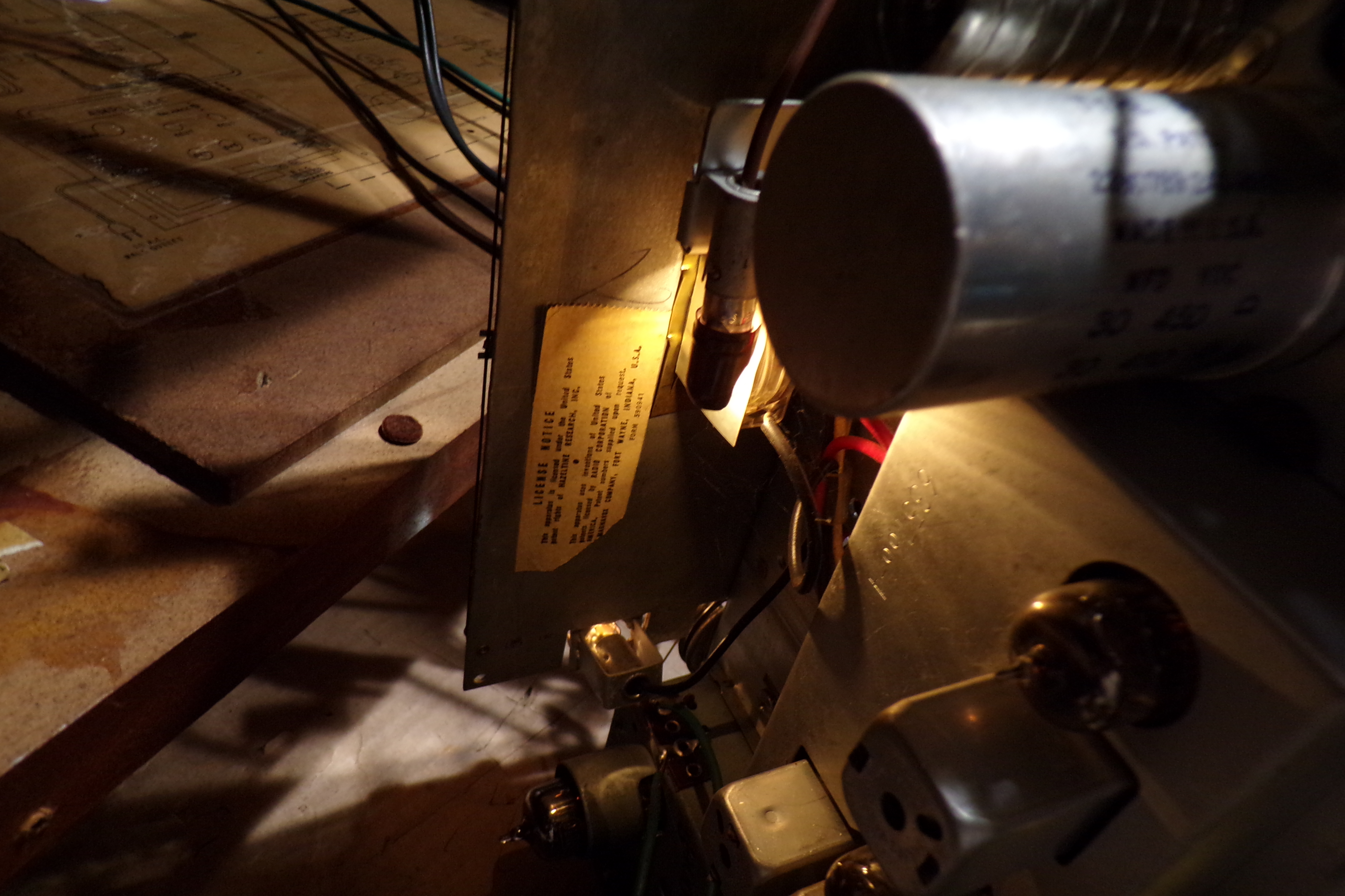

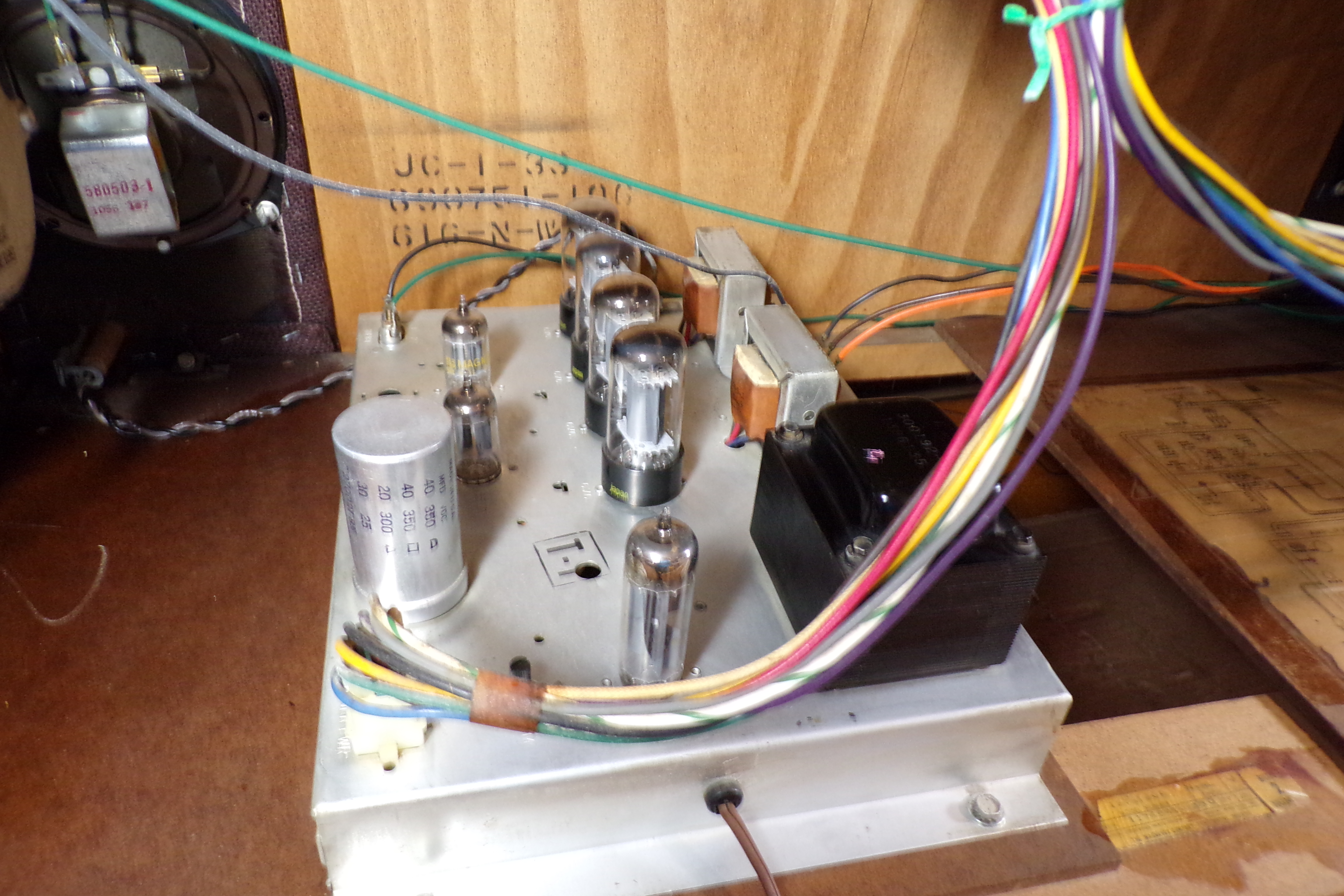

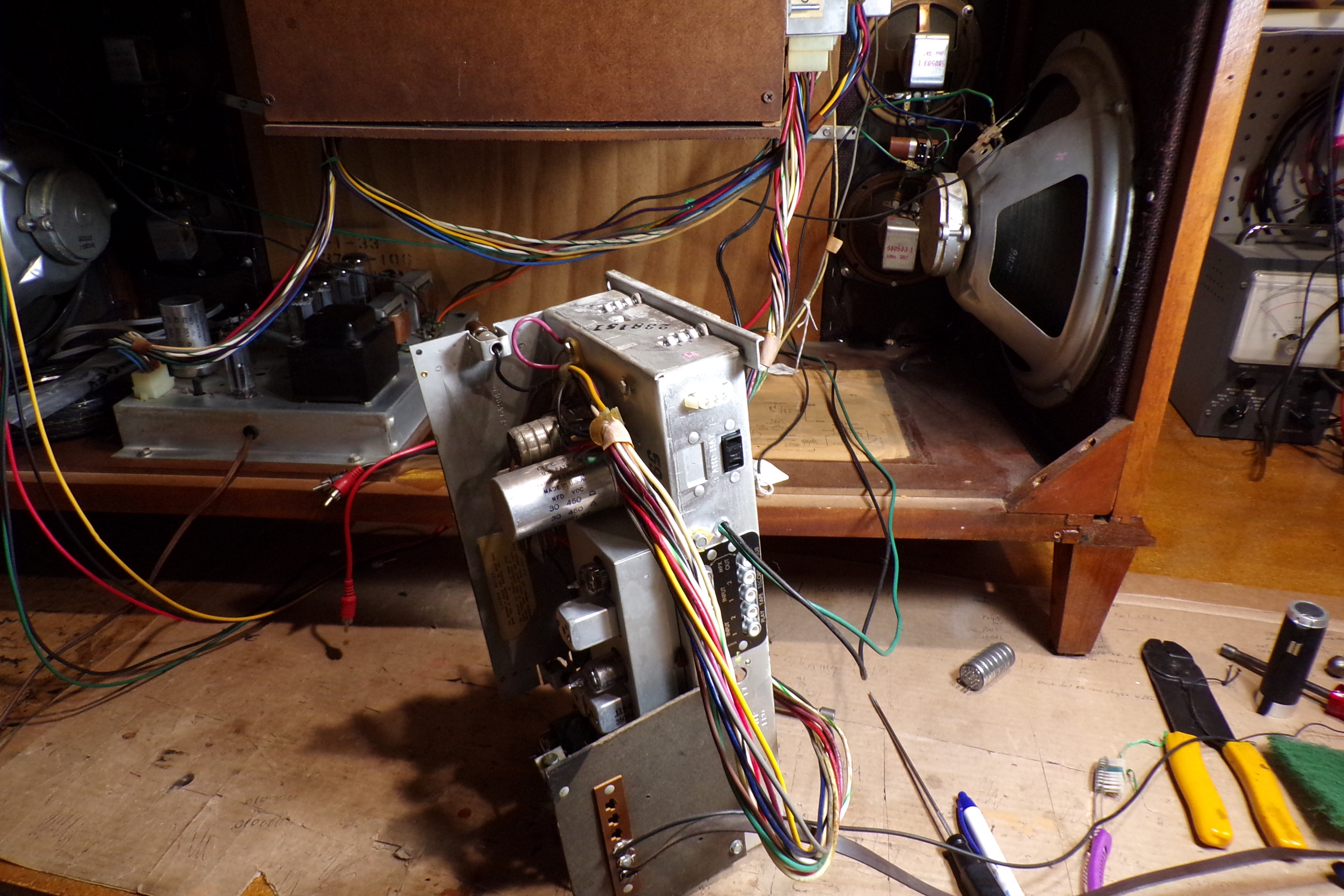

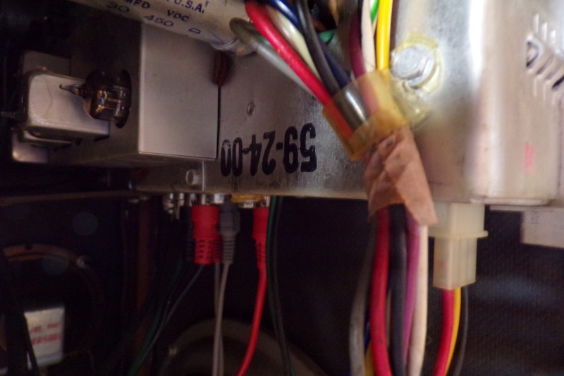

This is the victim. Nice, sloppy Magnavox wiring. Model number sticker. 88 series amplifier. Code 137 tweeters/midrange speakers, Chicago Telephone Supply. Tuner model number 59-24-00 I had to remove a tube from the Multiplex adapter in order to remove the tuner. Good luck getting that tube back in with the tuner installed.
The tuner sets on these two cute little metal brackets. Two bolts on top hold it in place.

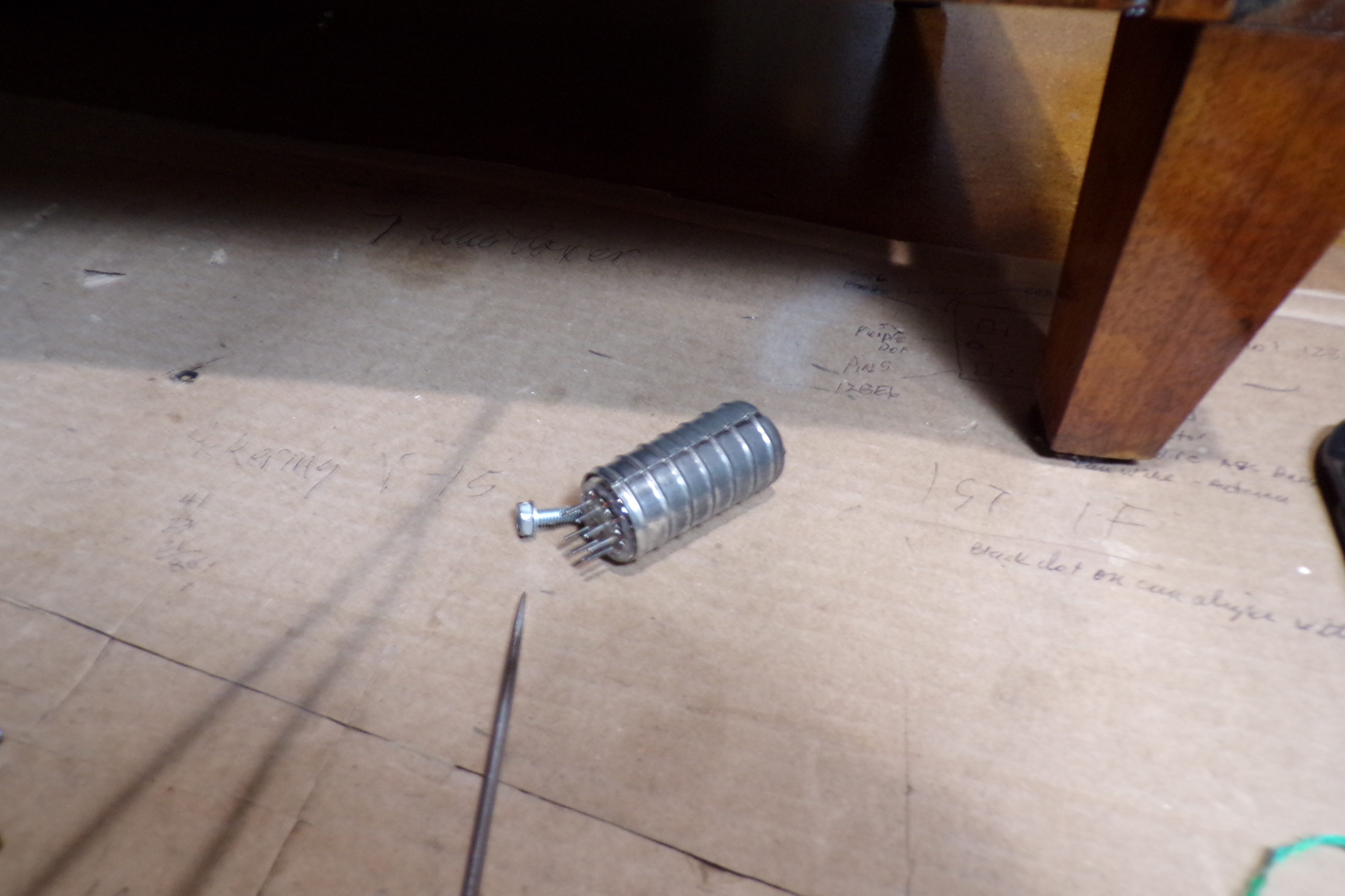

This is the switch that caused all this work. Apparently, it was just dirty and not making good contact. Time will tell how this theory works out....

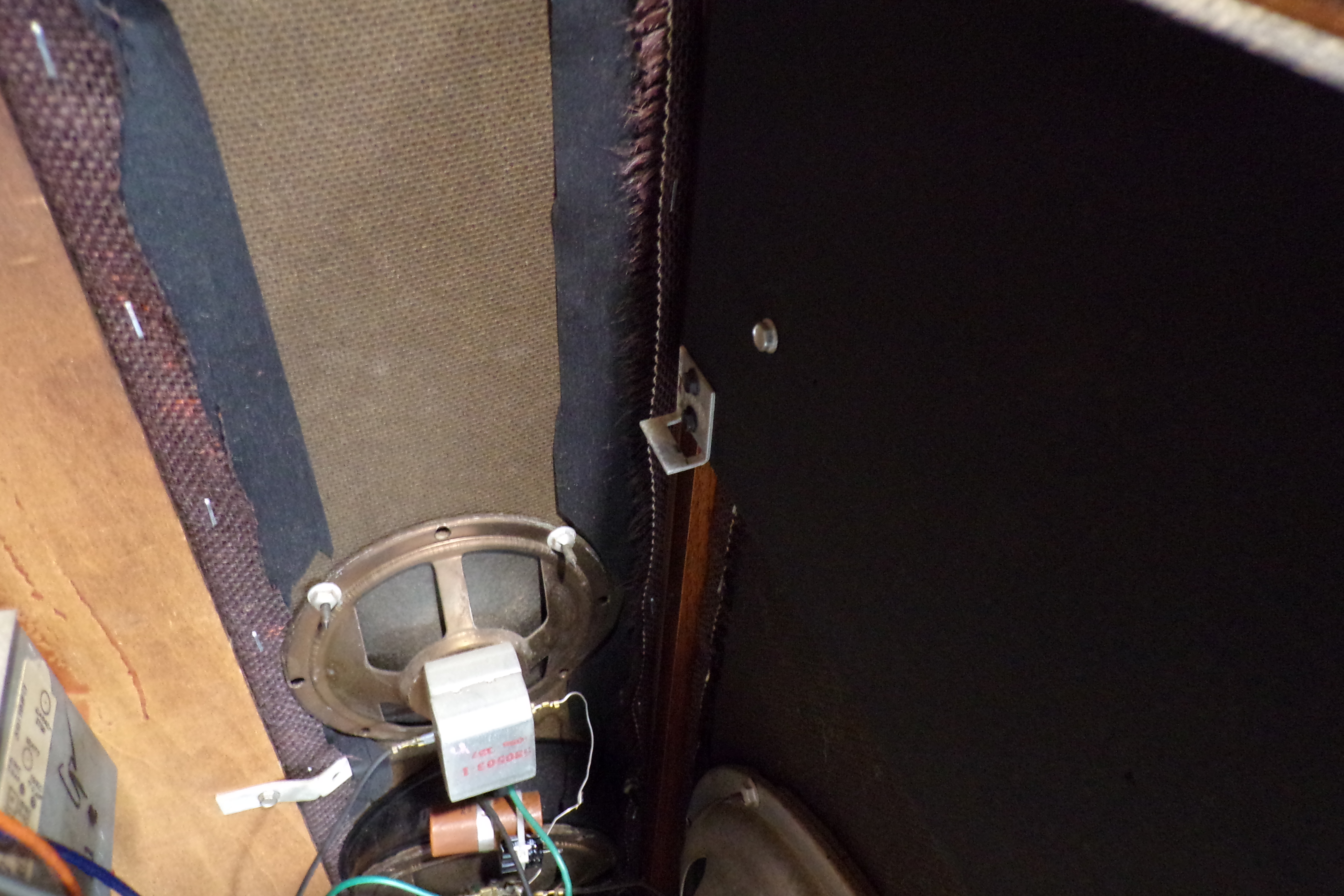

Guys, I could use some ideas. The volume from the four small speakers, tweeters and midrange, seems to be very low. I believe the speakers are okay. I can barely hear them with my ear up against the grille cloth. I connected a spare 4" speaker to the external speaker jacks and it sounds a lot better. I think my next step is to jumper the crossover caps and see what happens. Why would the crossover caps attenuate the volume so much? This setup is supposed to be a 16uf non-polarized cap for the crossover. I have two 33uf caps connected in series in their place. Something is wrong, something I'm overlooking.

Are the series caps in opposite polarities? You could jumper them with a wire if you keep the volume way down.
For the tweeters, you may be suffering from my malady: old ears with poor HF response.
- Posts: 8910
Re: Repair of 1961 Magnavox 1ST616 stereo console
I'm not having hearing trouble in this case. I have wimpy tweeter/midrange speakers. I'll jumper the crossover caps and see what happens. If I blow the speakers, I have some I can use. The crossover caps are wired right as far as I can tell.
