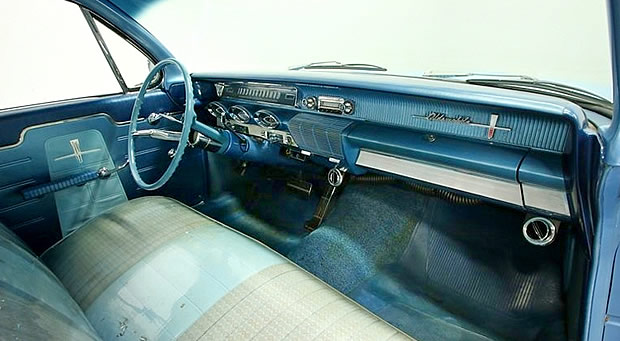

The dash has always been a major factor for me, as it's the one thing you look at it all the time.
'61/62 Cad dashboards are awesome, as is the one on the '61 Olds 98, which may be my favorite GM dash of all time, it's absolutely jewel-like when in pristine condition, this pic of a '61 Dynamic dash doesn't do it justice really. The '62 to '64 Olds dashes were kind of boring-ish in comparison, though of equally high quality.

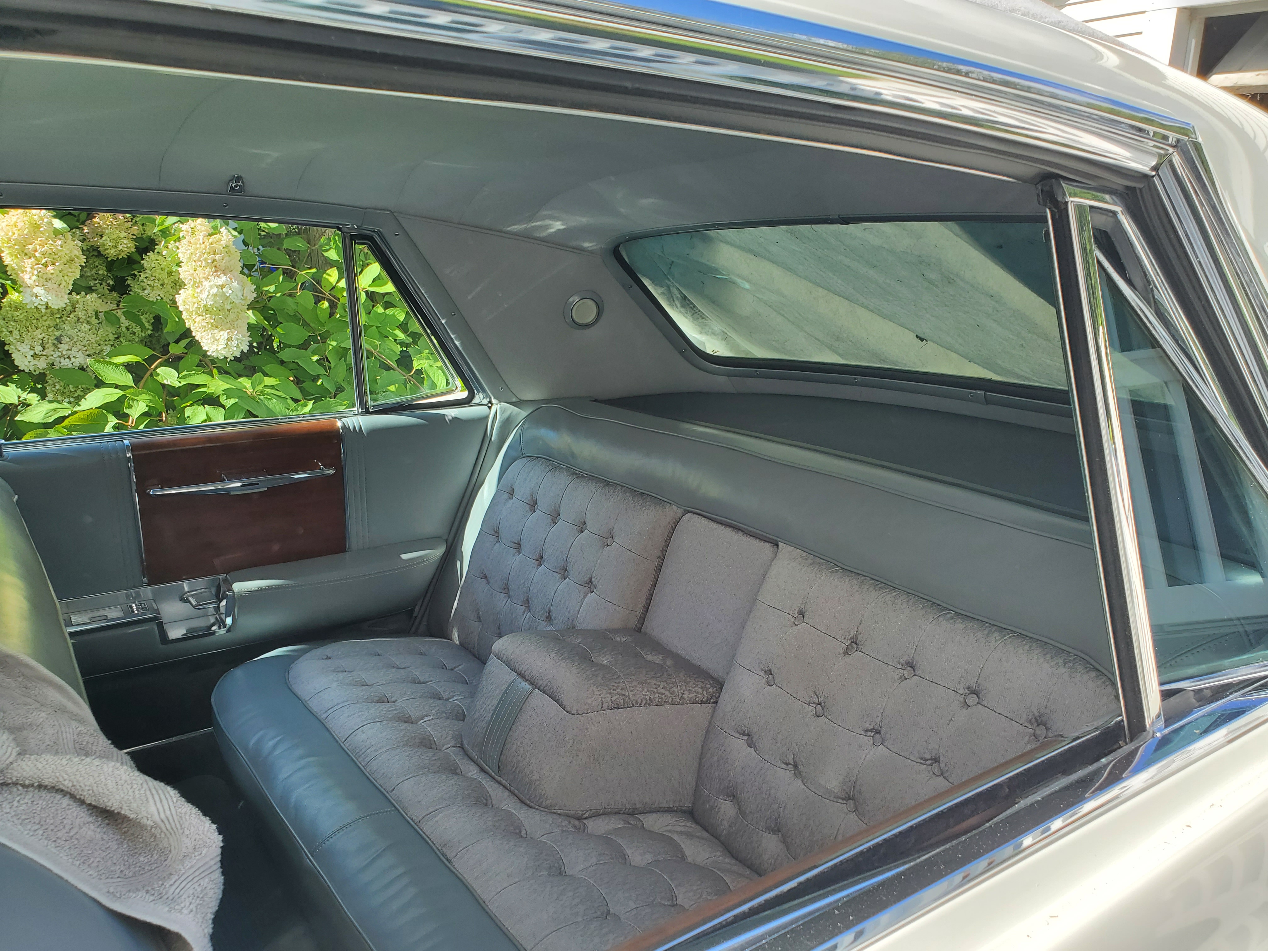

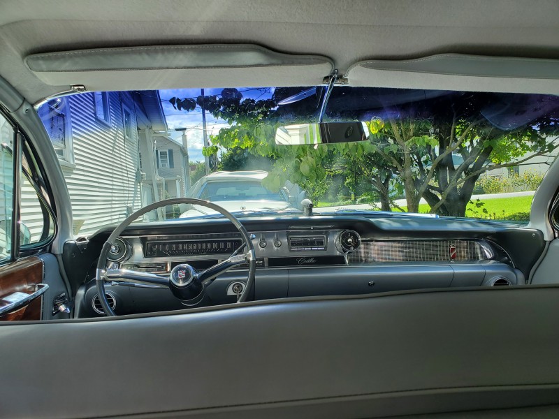

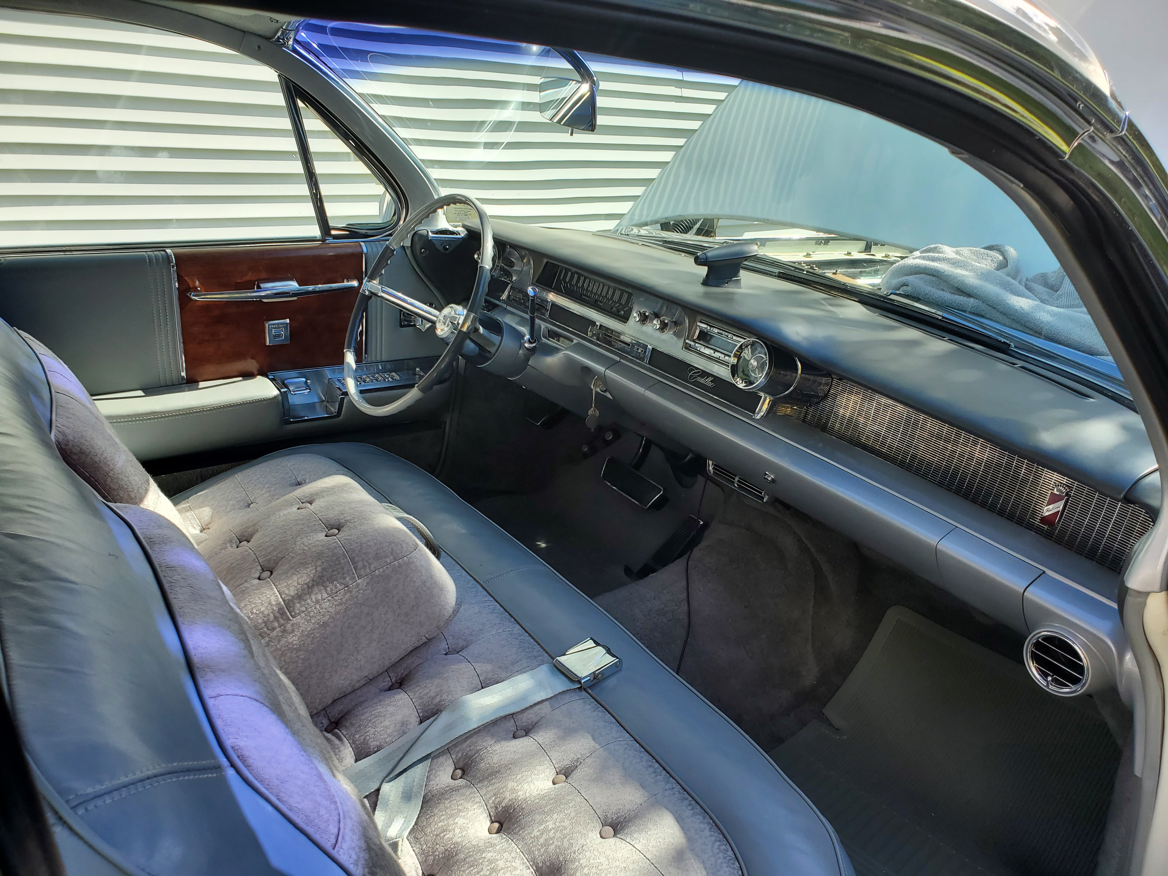

Here's some interior shots. That's makore veneer I replaced. 2 coats of sanding sealer, 7 coats of lacquer and hand polish. Replaced the headliner, too...
Of note is Oldsmobile used the same cruise control in '62. Found a n Oldsmobile guy in Canada that reproduces the dial gears that disintegrate.

No aluminum valve covers but they did do that abysmal aluminum block 4100 in '82. Never had a tach until MAYBE the Cimarron??? This is all idiot lights. There's an unused green lensed socket in the cluster to the left. I added an "engaged" light for the cruise. Pretty sure the other GM makes had cruise lights.

That Cad interior is stellar! White with blue brocade is the bees knees!

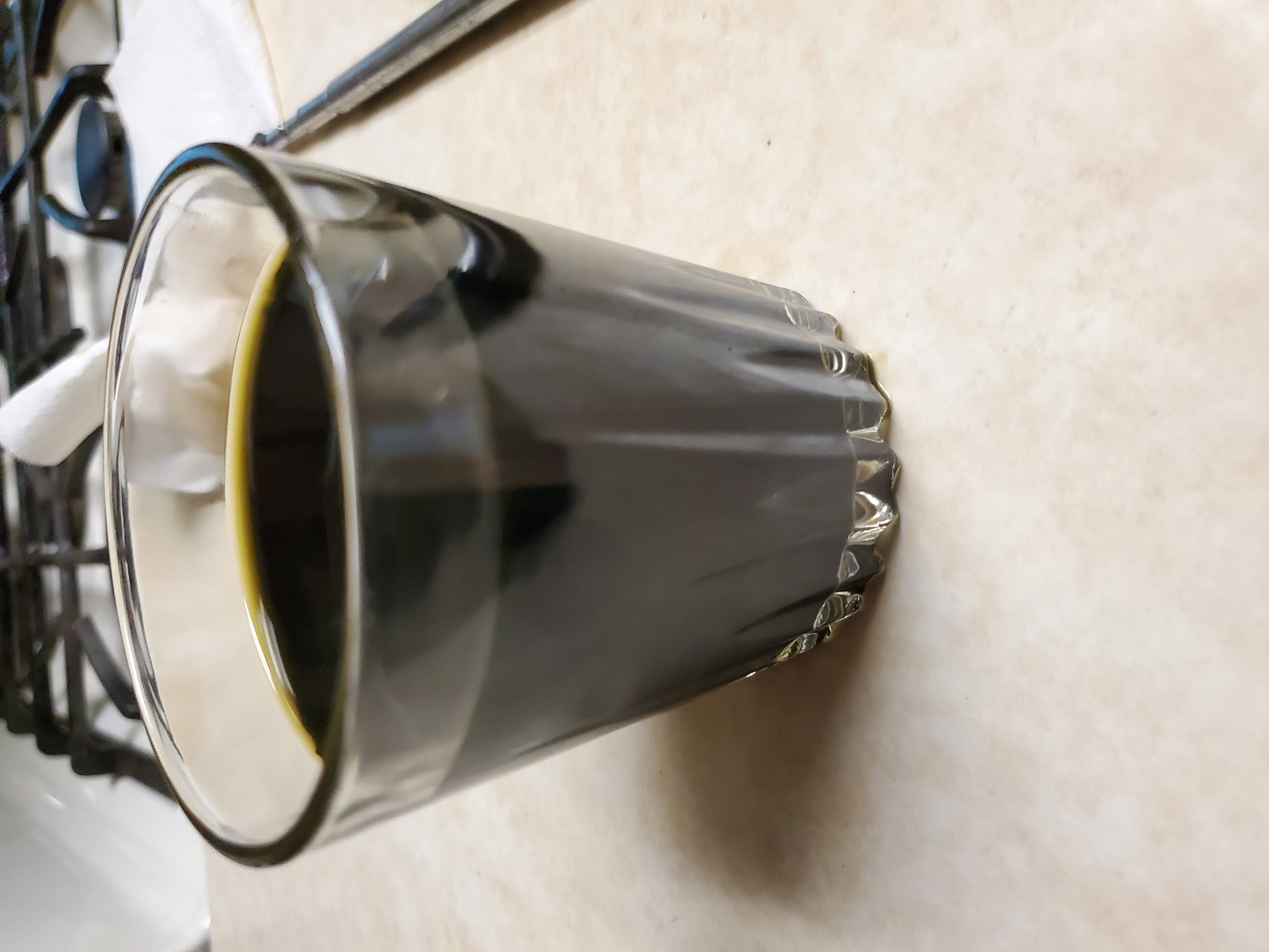

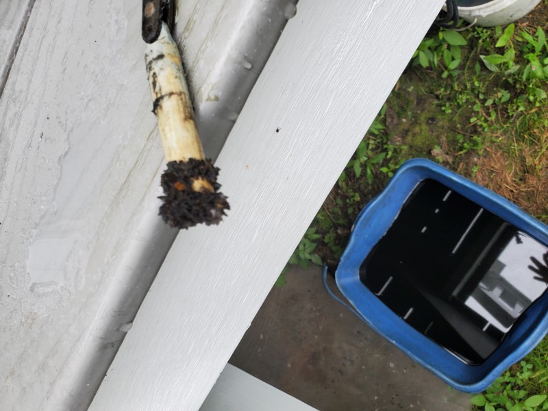

Drained it this morning before the rains come. The crap in the glass is from the radiator. The pan is from the block, so is the rust on the magnet.
I have my doubts it'll make a huge difference but I'm still impressed. Put a gallon of vinegar in it and topped it off. Plan to run that through just idling in the driveway and see if it's still black.
