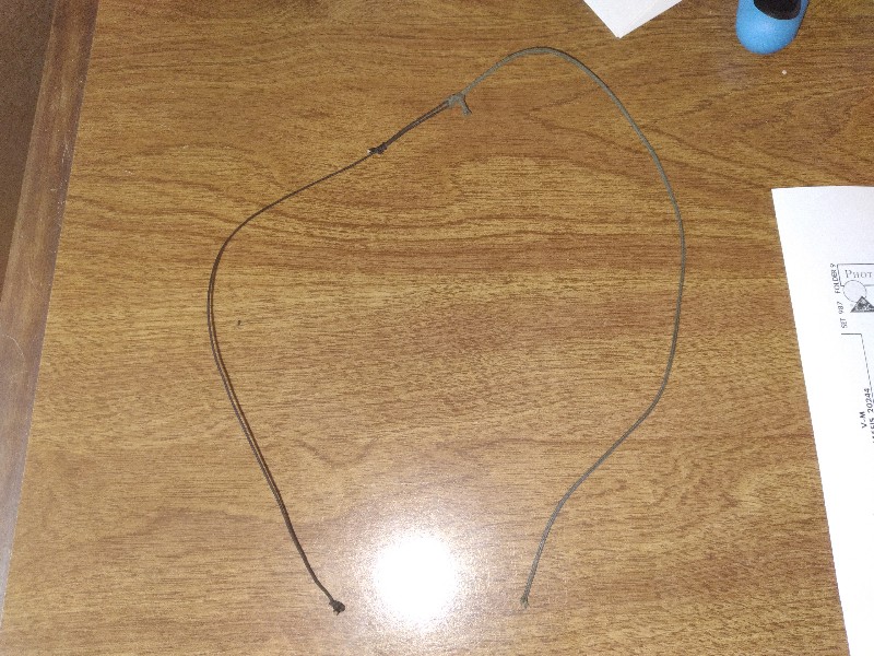

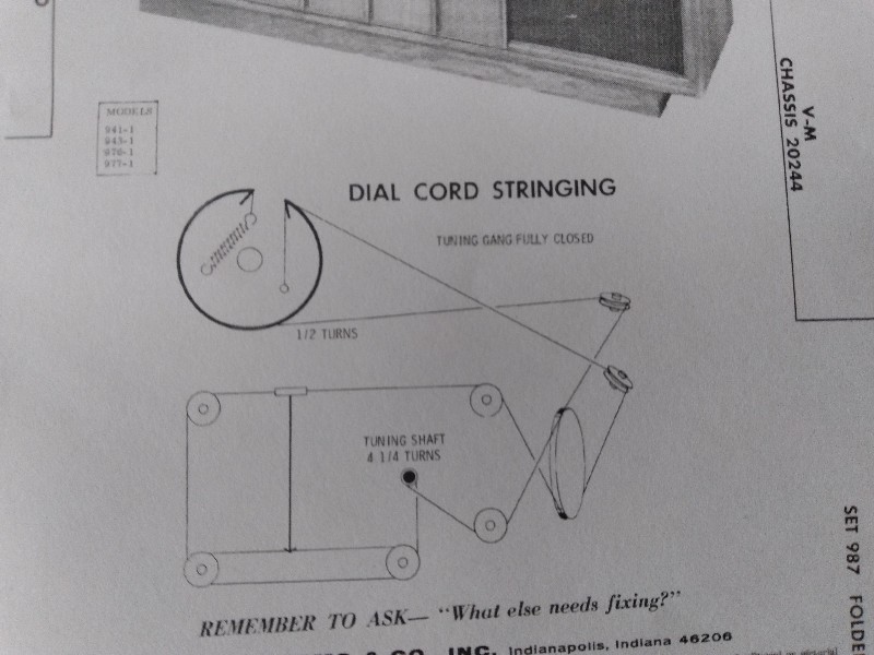

the 977 I tried to restring the dial as per the sams using the standard .08 cord it just slips , when I took the set apart a found one end of the cord with the spring attached to the standard size cord but then it transitions into larger cord... whether this was from the factory or done after is the question .. the cord guides are large like they are made for the thick cord , but can't imagine that thick cord wrapped around twice on itself on bottom of the dial indicator where it looks like a race track ... guess I will have to ask Gary if he has any insight on this one ...

I find it amusing, and puzzling how they came up with all the gyrations that make up the travel of a dial cord. Everyone is different, and to me everyone is overly complicated and bizarre. My guess, Gary will have an answer.

From your photo, it looks like somebody had to do a dial cord repair and only had some string at hand so they tied the string to the useful remains of the original cord.

I agree with Chris. That looks like regular old string, instead of dial cord. Probably why it slips. ;) ;)

Yes...it was a repair , I spoke to Gary and he confirmed that all VM products used the .028 sized cord ... since I only have about 3 feet left , i will have to order some... this tuner takes about 5 to 6 feet by itself...
