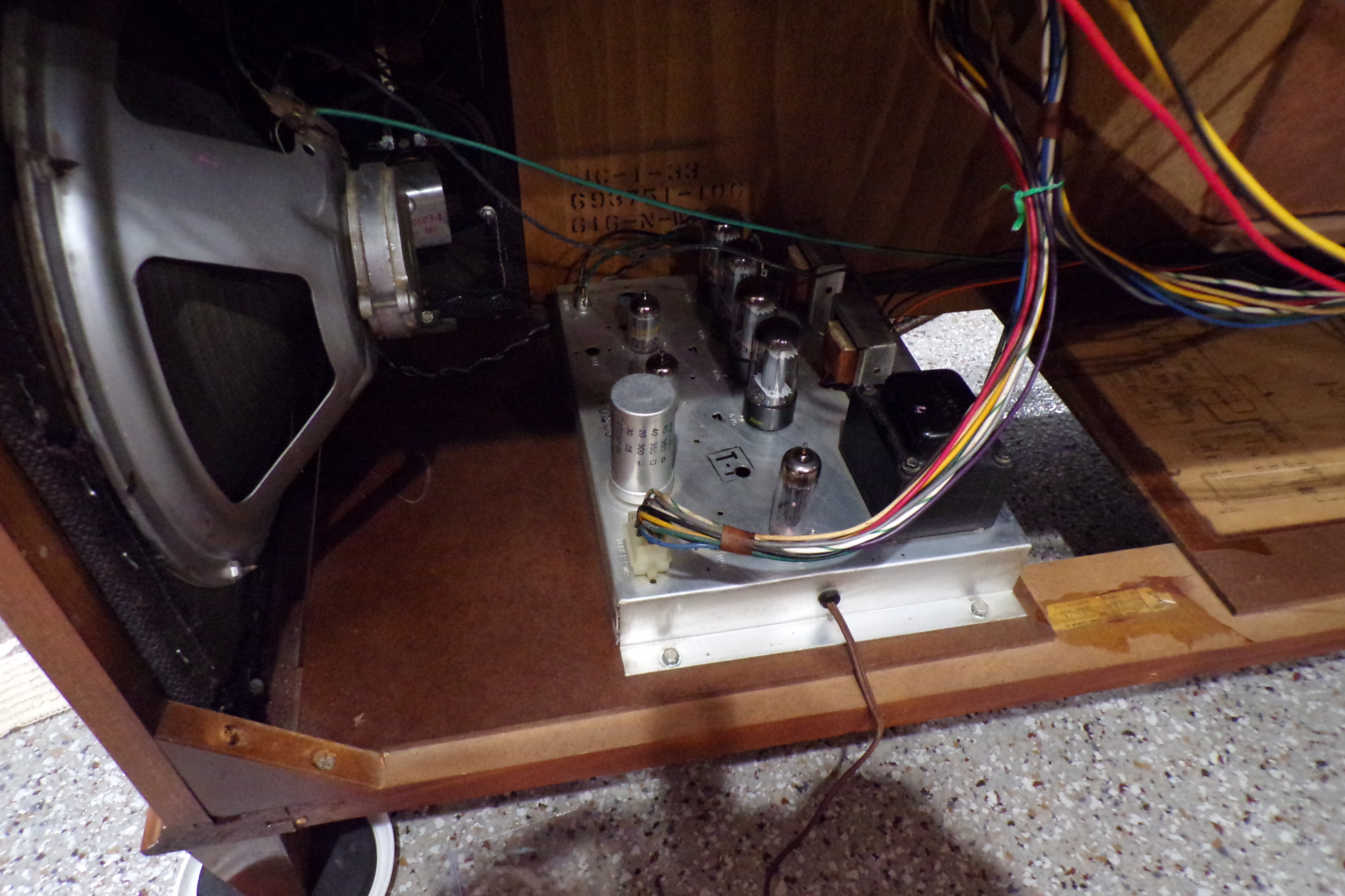

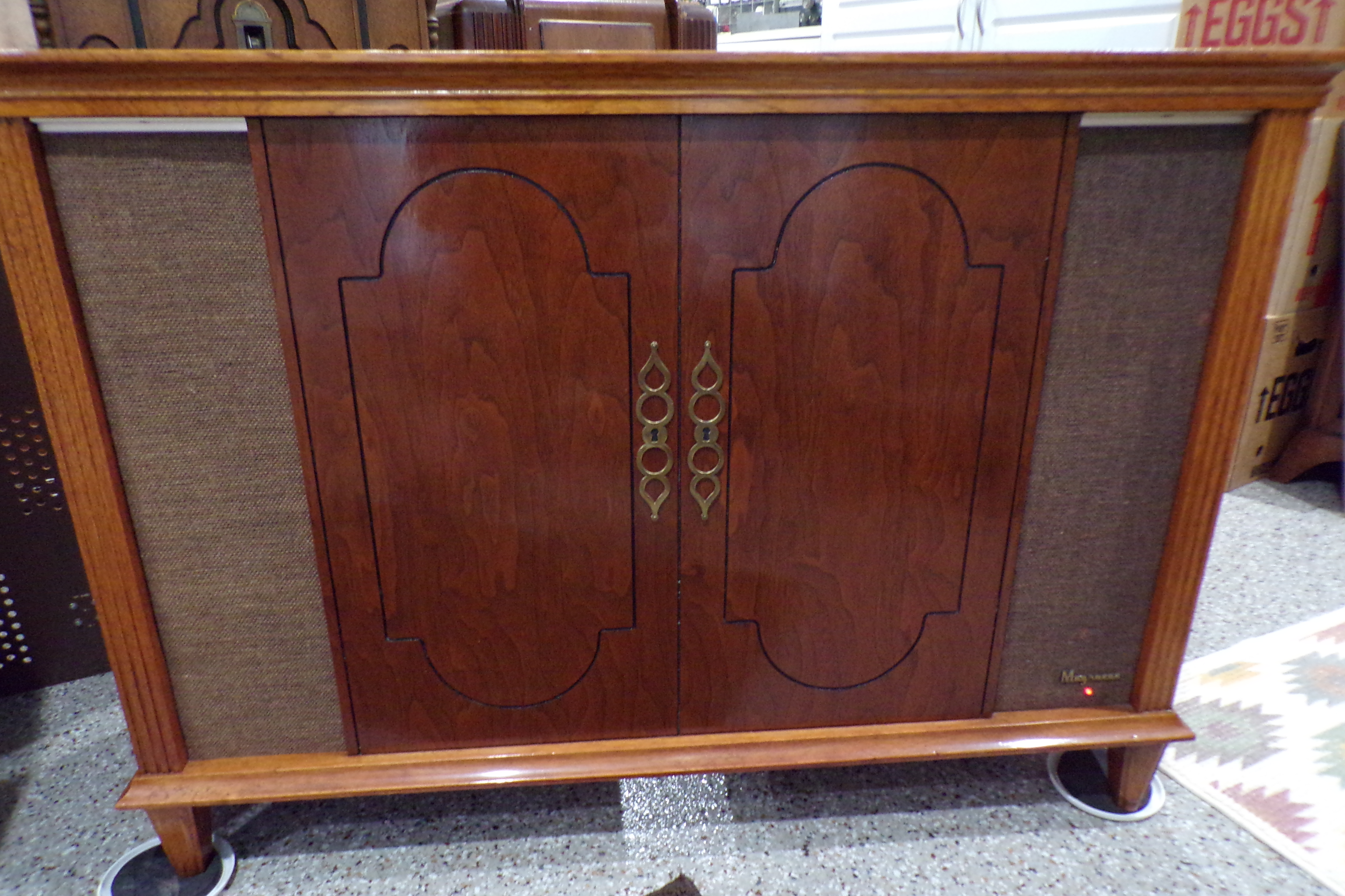

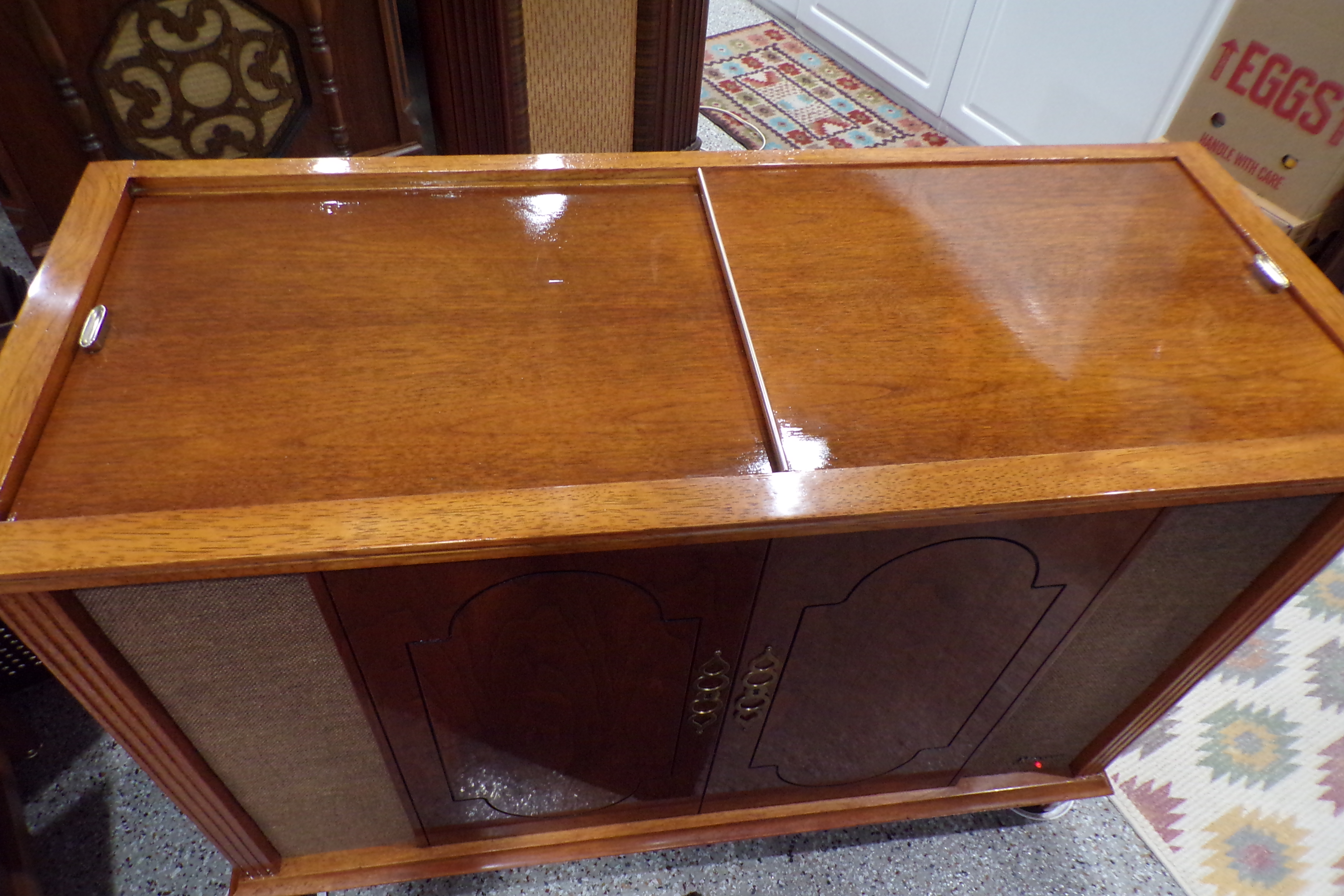

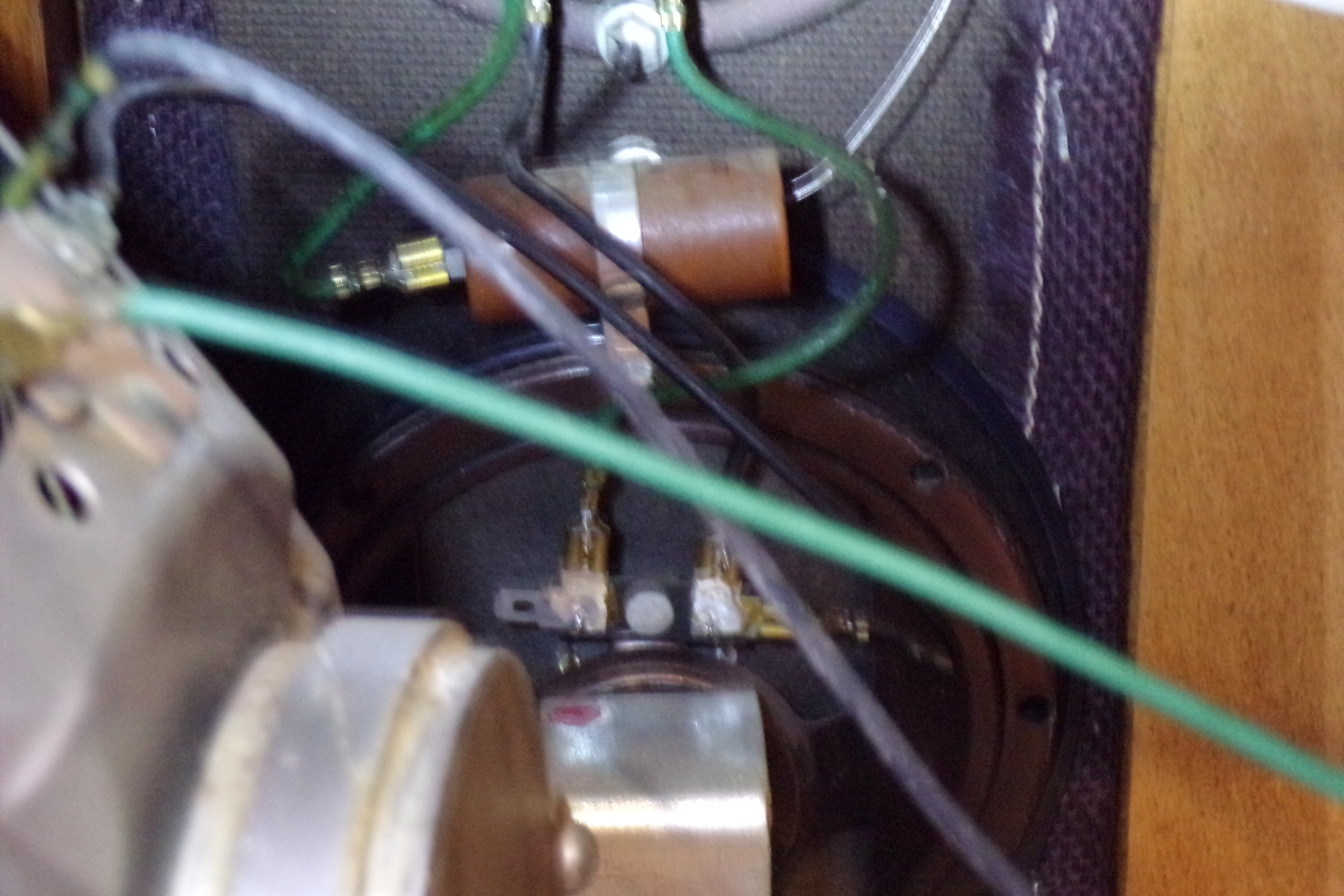

This is the second-from-the-bottom in the Magnavox lineup that is in my collection. This stereo sold for around $300 when it was new, plus $30 for the Multiplex adapter, which this one has. The tube codes are the 31st week of 1961. The rectifier was built by RCA, the 6EU7's by Sylvania, the 6V6GT output tubes in Japan, I think by Siemens. The four little speakers are coded 137, Chicago Telephone Supply, week 35 of 1961. The 12" woofers are dated the 35th week of 1961 with a 270 EIA manufacturer's code. I don't have my EIA code documents located yet, so perhaps someone here had that information. This stereo has the 57 series tuner, the 70 series MPX, and the 88 series amp. It is a particularly robust performer for one of the 88 series amps. Nice strong, firm bass. The issue I had always had with this stereo, fairly typical of the 88 series amp, is getting the treble to be bright enough. I may have found part of the problem while I had the back off. Somebody (wonder who?) whomever took this thing down to the last board, did a wire by wire restoration, but did not replace the crossover caps. What would you bet that refreshing those caps would also return the treble response? Ron the Refinisher and I had this thing down to its bare bones, put 18 coats of hand-rubbed poly over shellac. This in 2017. It has worn well. Even though it is a five-knobber, this tuner is one of the better in my collection. It has FM-AFC which is a blessing with Magnavox tube tuners. The AM performance is a tad anemic, which I'll investigate while I had the back off. And some dusting wouldn't hurt, either.

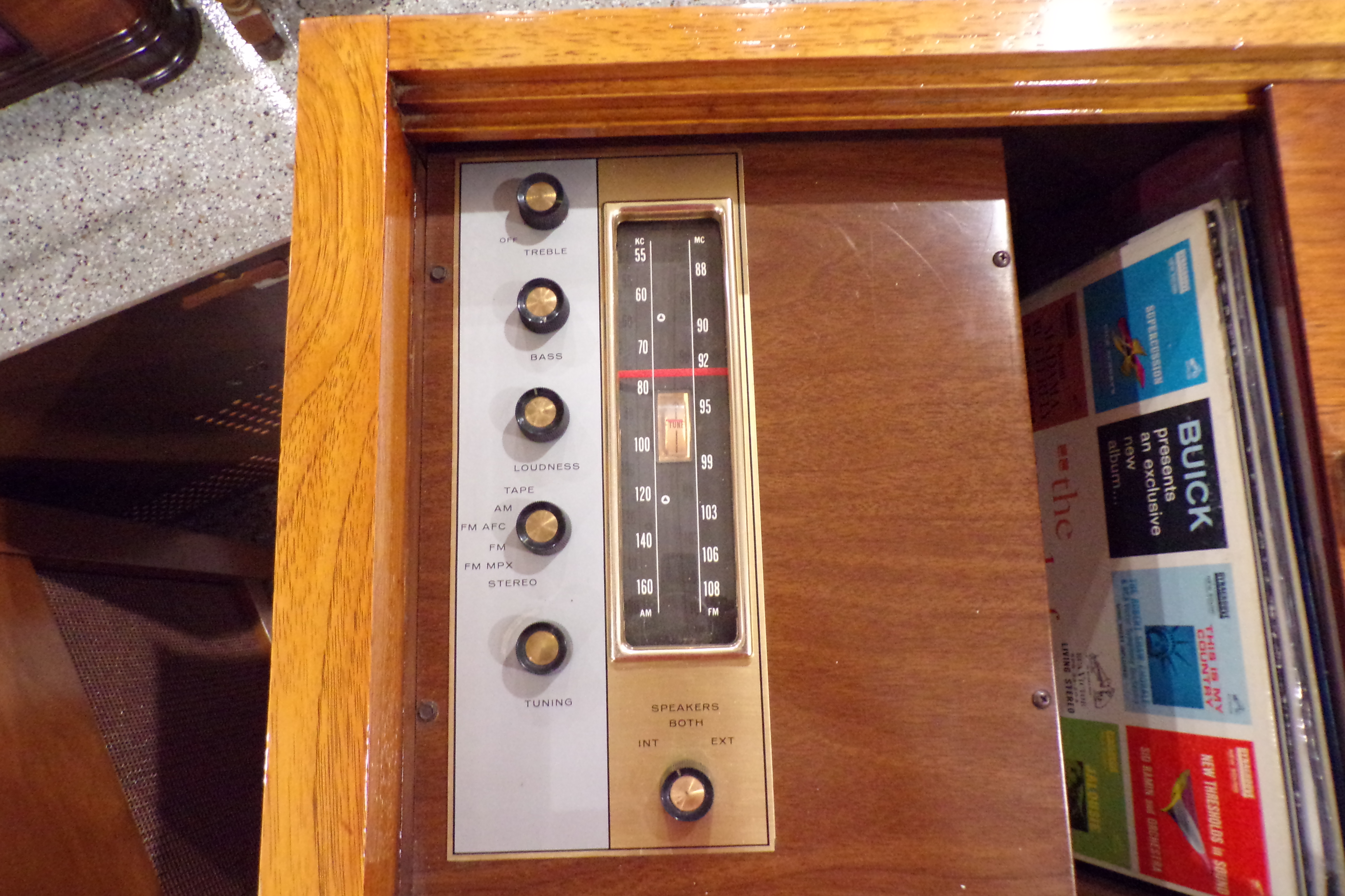

It's a good looker, Greg. It has the same tuner look as my Symphony and I notice the Buick record. I have that record too. ;) :)

Thanks, Bill. If I didn't have a Buick, I would not have that record. It's not really my kind of music. That stereo houses my collection of demonstration records. So I don't lose them....... :oops: :oops: :shock: :shock:
There are a couple RCA demonstration records with your name on them. I believe one of them might be appropriate for your Home Theater that belonged to your parents.

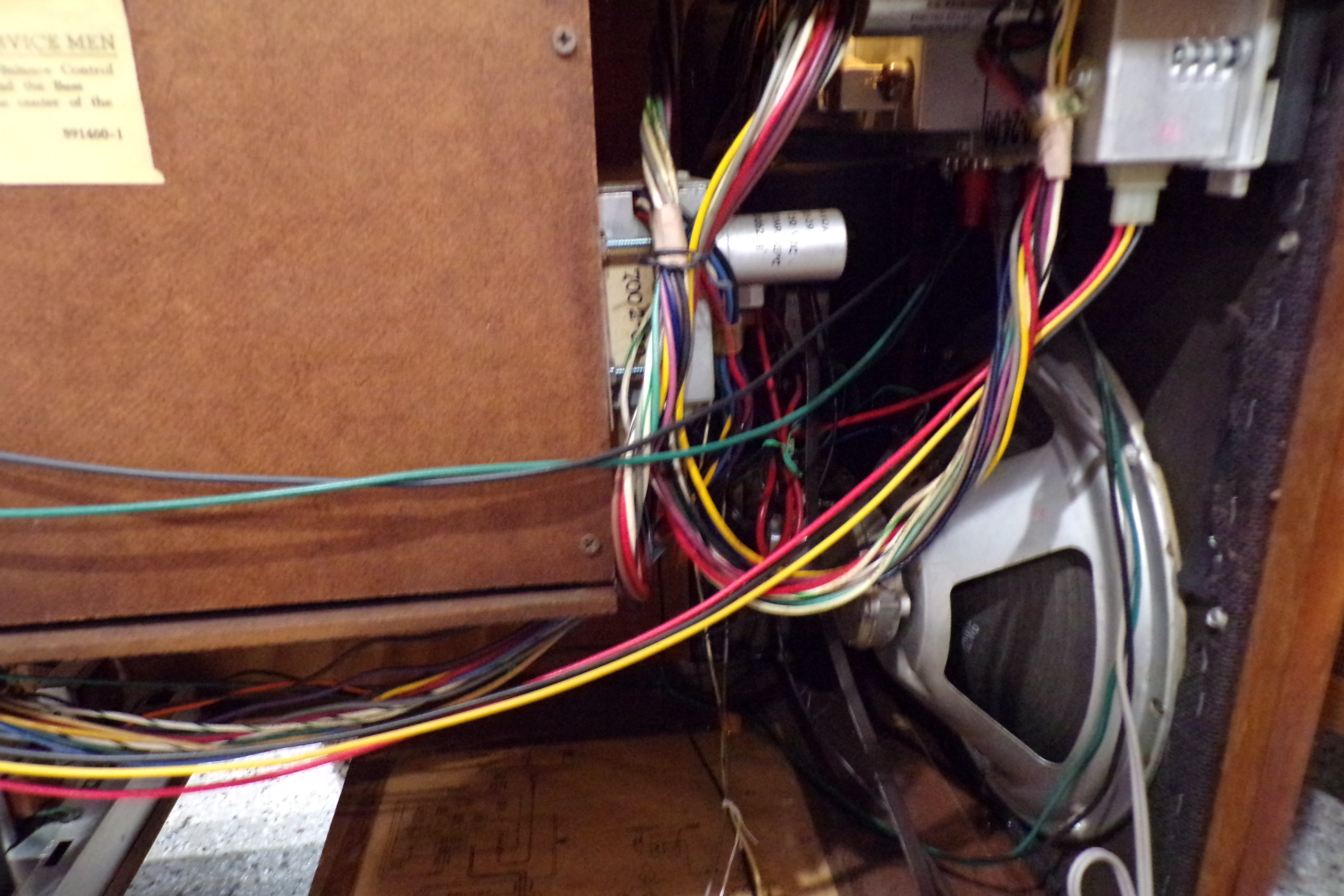

I made some 16uf caps and installed them in this stereo. IT sounds lots better. I also found the balance switch was dirty. That is the second Magnavox stereo I have found a dirty balance control on. This one is ready for a CD changer.

Yes. I paired two 33uf electrolytic caps with the negatives tied together to create one 16.5uf non-polarized electrolytic crossover capacitor. Sorry for the confusion. I'm old and I was tired and my brain had stopped working an hour before I typed that statement. :oops: :oops:
