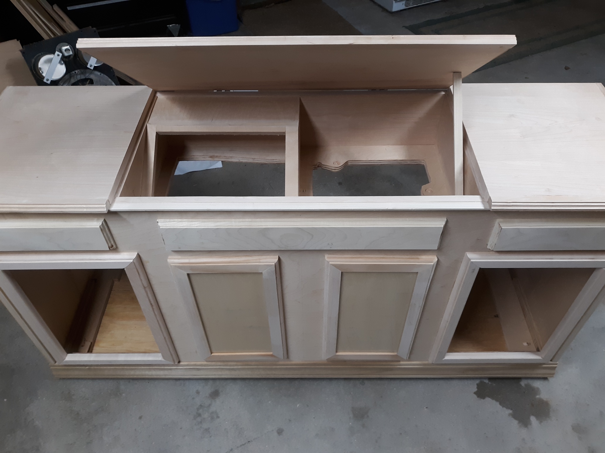

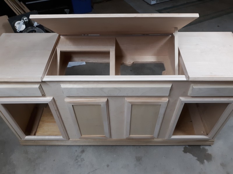

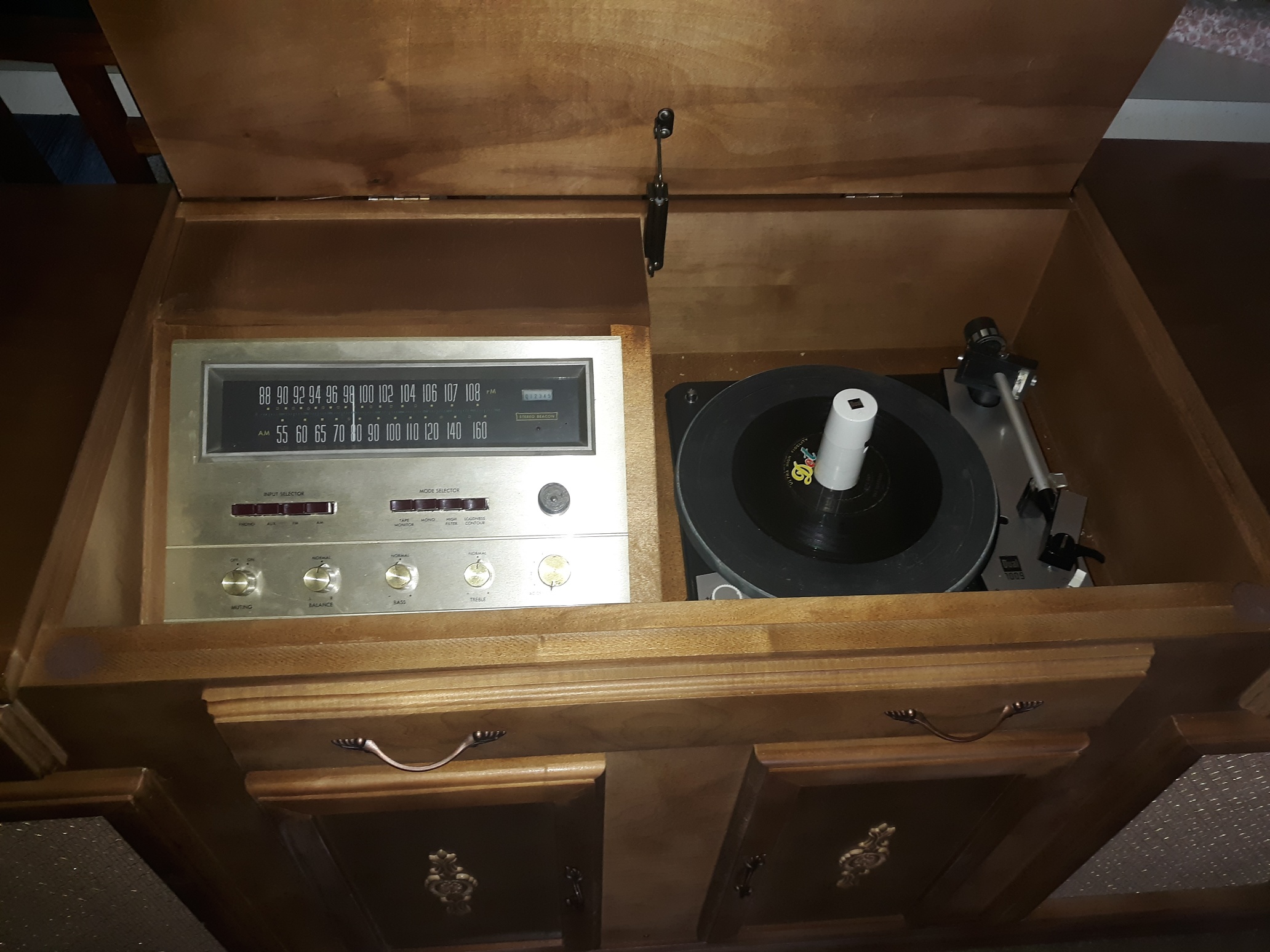

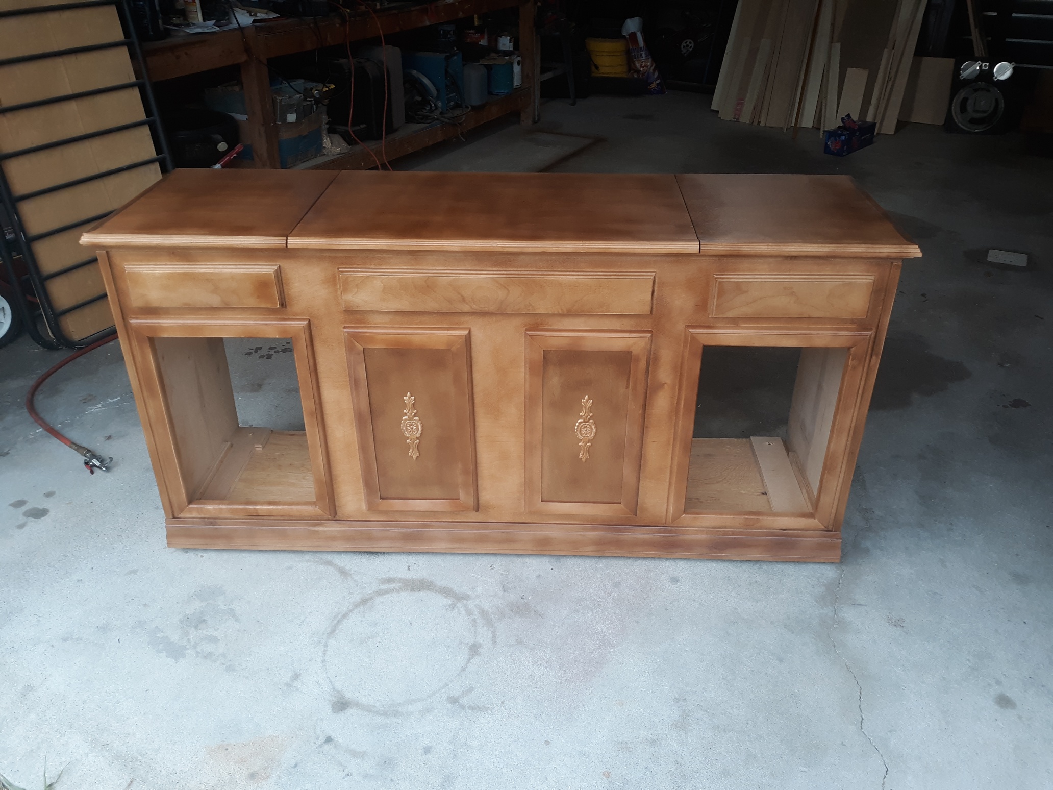

Been there done that... let me introduce my " Free Fisher" I found in a barn hay loft just the guts and the speakers ...so I built a cabinet for it, so my free set is now about 250 bucks... :lol: But it was not about the $$$$$ to me , it was something of a challenge and it was fun which at the end of the day is more important ... well worth the $$$$$ it cost me, or as the saying on the commercial says ... priceless

You did a great job, Elton. You should be proud.

Nice job, but you've also created a problem. Some day in the future, somebody's going to be saying, "I found this Fisher console, but it's not shown in any of the catalogs...."

Future?...If it lasts that long.... she creaks and groans when I move it around .... It is all glue, no fasteners anywhere except the lid hinges and the back cover :lol:

Beautiful work, was that from scratch, or using cabinet modules , or? Either way, very attractive.
Re: New Orthophonic people, a question, opinions?
Post: # 5898Post hermitcrab »
