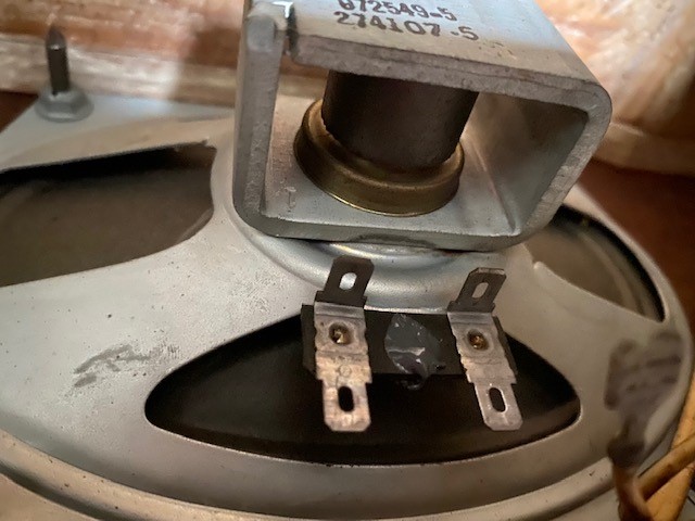

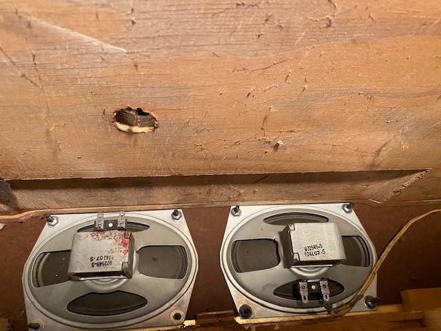

Anyone who has worked on a few RCA's knows what the pictures below show, usually it means death to a solid-back 3" cone tweeter if a push on lug is hastily removed.
Notice the missing rivets in center of the terminal strip.
spkr before.jpg (95.32 KiB) Viewed 2131 times
Hold steady -J-B weld to the rescue
spkr after.jpg (68.37 KiB) Viewed 2131 times

Make no mistakes, almost all tweeter voice coil wires can rarely be captured for repairs :cry: This afflicts RCA horn speakers on later SS models as well.
My example pictures are of a 1962 model RCA color TV's speakers, an issue in all RCA's which I have seen MANY times in 45 years. These speaker terminal boards are almost always built this way and all will fail, due to metal fatigue of one stupid aluminum rivet. :evil:

So far, Dave, I have been careful or lucky. Thanks for the warning and tip.
Re: RCA speaker terminal fix
Post: # 5278Post hermitcrab »
Yep.... that RCA I stripped out did the same thing... pull each individual wire carefully off the speaker terminals or you will be gluing the whole cardboard mount back on ...
Post: # 5307Post Firedome »
Oh my, are those from a 1962 RCA CTC-11 "Wakely" perchance?
