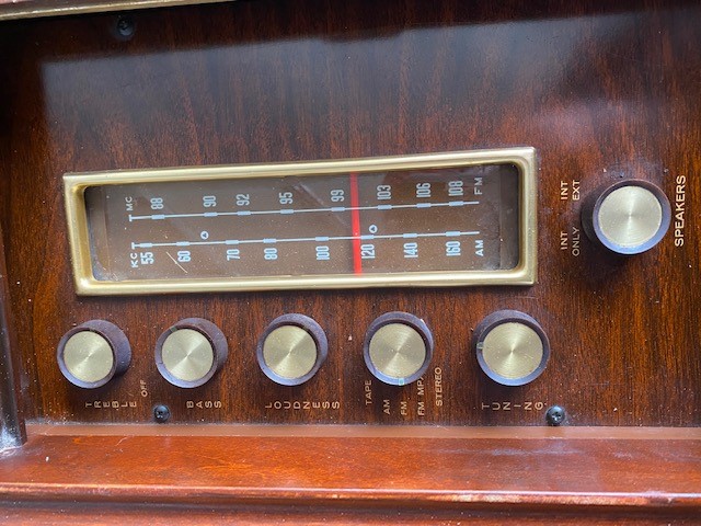

Is this a mini Imperial? it says on the turntable....located in detroit area.... https://www.facebook.com/marketplace/it ... 4cc5921ce2
Re: Maggie imperial?
No sir, it's not. It's better than an Imperial. It is a Symphony, model 1ST656. Dark walnut with factory MPX. Probably a 1961 model. "Imperial" is Collaro nomenclature for their S-600 changers with the fancy trim. This instrument has the 93 series amp, the very best of Magnavox.

So if the Turntable says imperial, that has nothing to do with the model then? I know nothing about the different models and what the differences are... I was told the one I have is a imperial... but nowhere does the paperwork claim any such thing... how can you tell just by looking at them?... Bill has seen it in person and confirmed it is a Imperial ... but you could not prove it by me either way...

Some where along the line, and, Greg will be able to tell us, the Collaro changer got named The Imperial Micromatic. That makes it very confusing as you would think with the name Imperial the model would be Imperial...Not so! The only way to tell what the Magnavox model is, is by model number. Size of cabinets is also a tell tail sign if you know the different lengths. Anyone else with Maggie knowledge please help fill in the blanks.
The only difference I'm aware of between the regular Micromatic changers and the Imperial Micromatic changers is the trim. I believe them to be identical mechanically. Perhaps the Imperial Micromatics used a different cartridge? The way we know a little Imperial is actually one is by the model number. 1ST660, 661, 662 and 665 are little Imperials. And they are also on my bucket list. I'll find one someday. I'm not picky about which one. The little Imperial is basically a Symphony on steroids. It would have the 93 series amp, MPX adapter, with 15" speakers and horns. The Symphony has the same amp, MPX optional (except the 656 models) with 15" speakers and six cone speakers in place of the horns. The little Imperial's cabinet is two inches longer than Symphony. The little Imperial and the big Imperial have little in common besides their name. The big Imperial is more akin to the Concert Grand. The 400 series Stereo Theater is basically a little Imperial with a TV set in the middle of the cabinet.
My 1ST659 has 93 series amp, horns with 12" LF drivers, same imperial changer with EV150 cartridge.
It has an MPX adapter BUT uses a series 100 tuner, much more plain looking and has no eye tube or meter.
I also have a 1ST622, same as 1ST659 but record changer does not read "Imperial". I found both at thrift stores, getting pretty stoked to actually restore an hear both, then sell one.
Either way, this one in the OP is a tremendous steal at $50!!!
