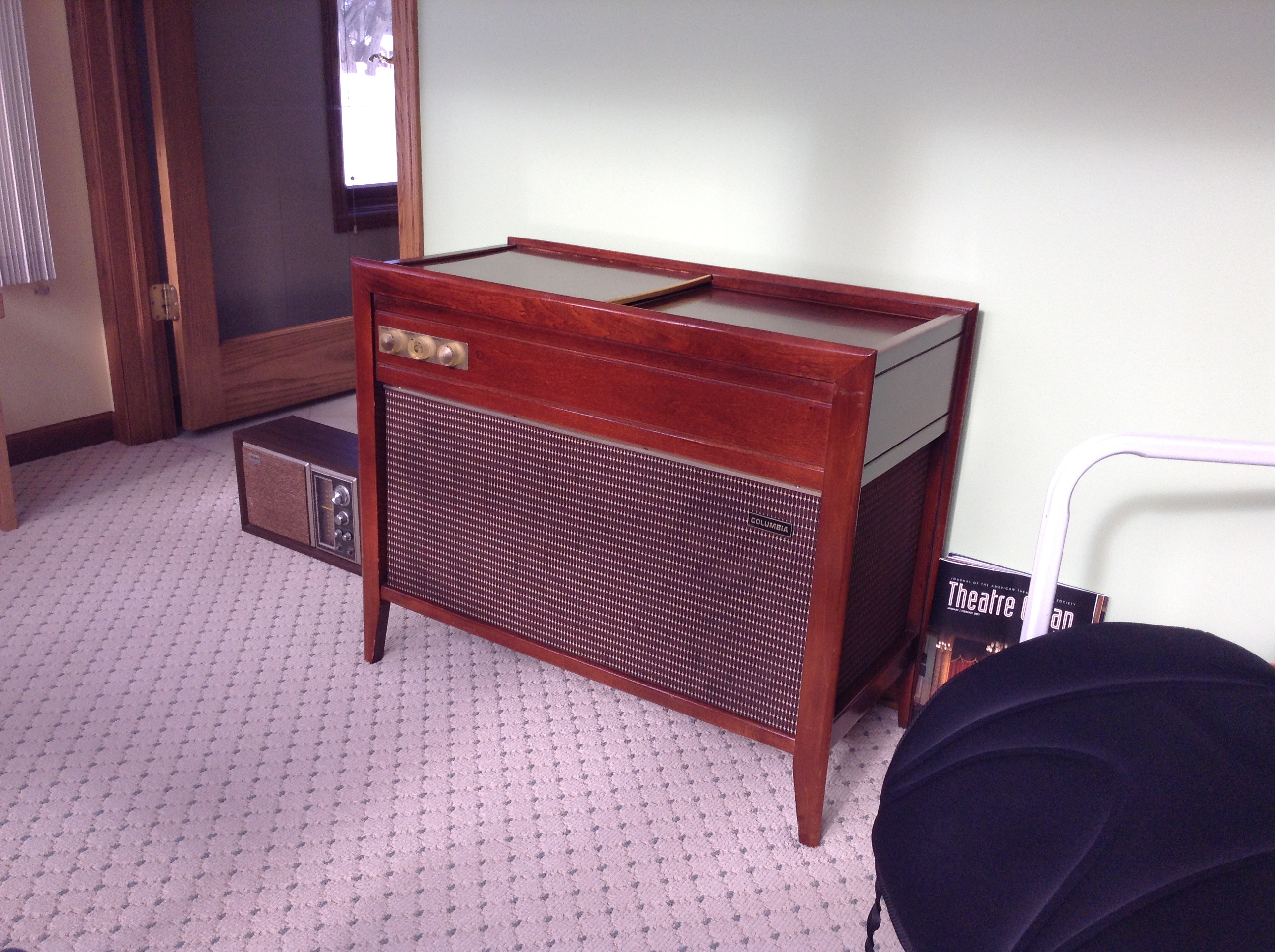

I will have worked on three of these pretty soon, two repairs and one purchase. Until recently, I had never seen the single ended stereo amps.
